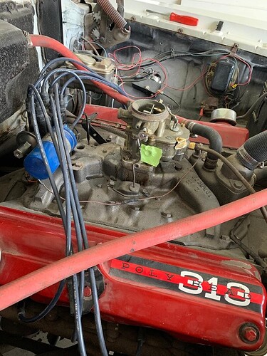

Trying to decode my car and not having much luck probably because it’s a Canadian car?
I want to be sure it’s a 313 poly before I order any parts!
[The Canadian data plate in the first pic is inscrutable to me, Gary - but the VIN plate on the door post shares the format with the US. The “M” indicates the 1959 model year; the 8 indicates the car line (not a US number - probably indicates CN Dodge); the 5 indicates the model (5 is for Mayfair, the Belvedere equivalent), and the 9 indicates that it was built in Windsor, CN. The rest of the number is where your car fell in production, starting with 100001. Yours was the 2,252nd off the line in Windsor.
I don’t know if Plodges were ever built with a 361 equivalent - another V8 option for Plymouth - but your engine is definitely a Poly as I’m sure you now know, based on the location of the distributor in the rear and the scalloped valve covers. -Dan]

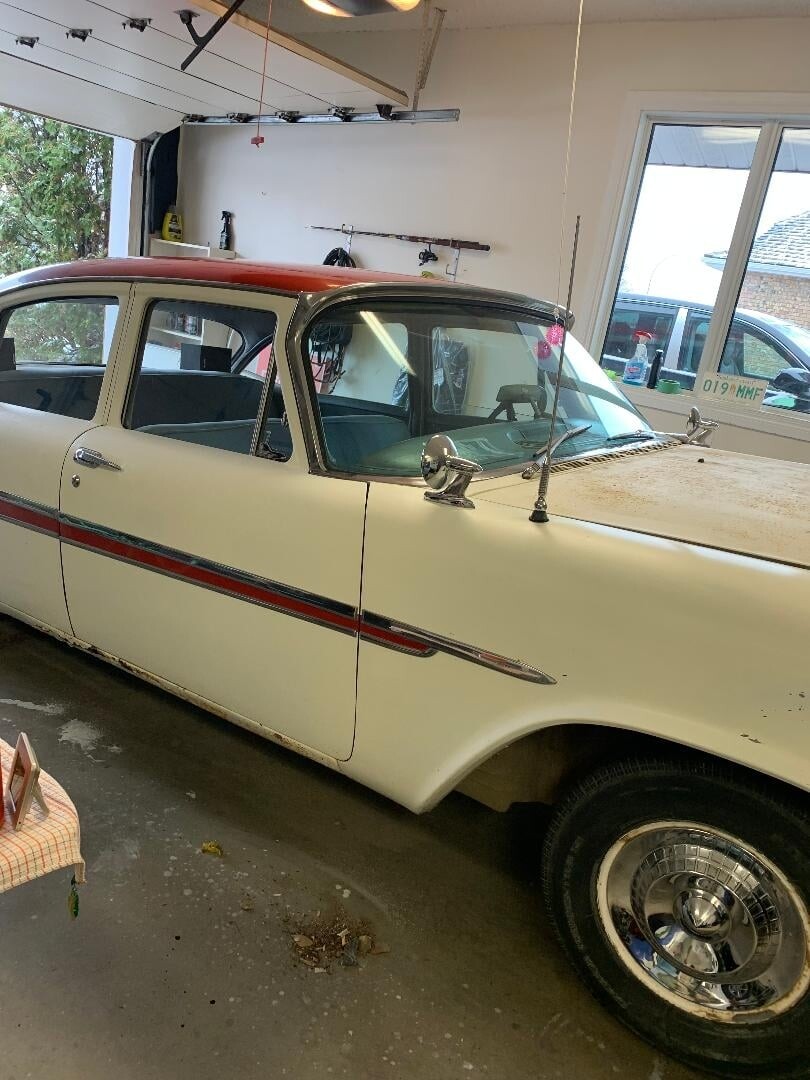

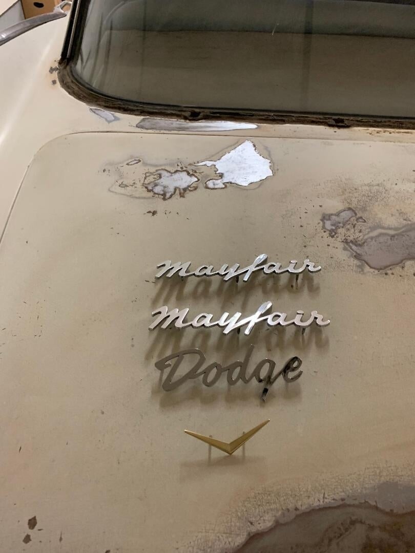

Arms are about to fall off from all the compounding, sanding and waxing…
…but there seems to be a Plodge under the dirt and oxidation.

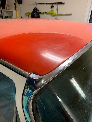

The roof is still the original paint and after removing the tree sap with a razor blade and compounding, it came back pretty good.
The hood, though, is another story

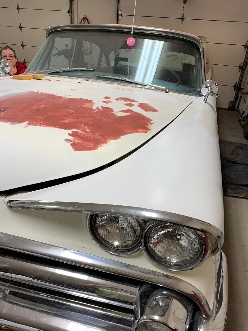

I cleaned and sanded the hood. I removed a layer of dirt and oxidation.
I cleaned and sanded the hood. I removed a layer of dirt and oxidation. Looks a little better, but lots of missing paint. You can’t make a silk purse out of a Sow’s ear, but you can try.

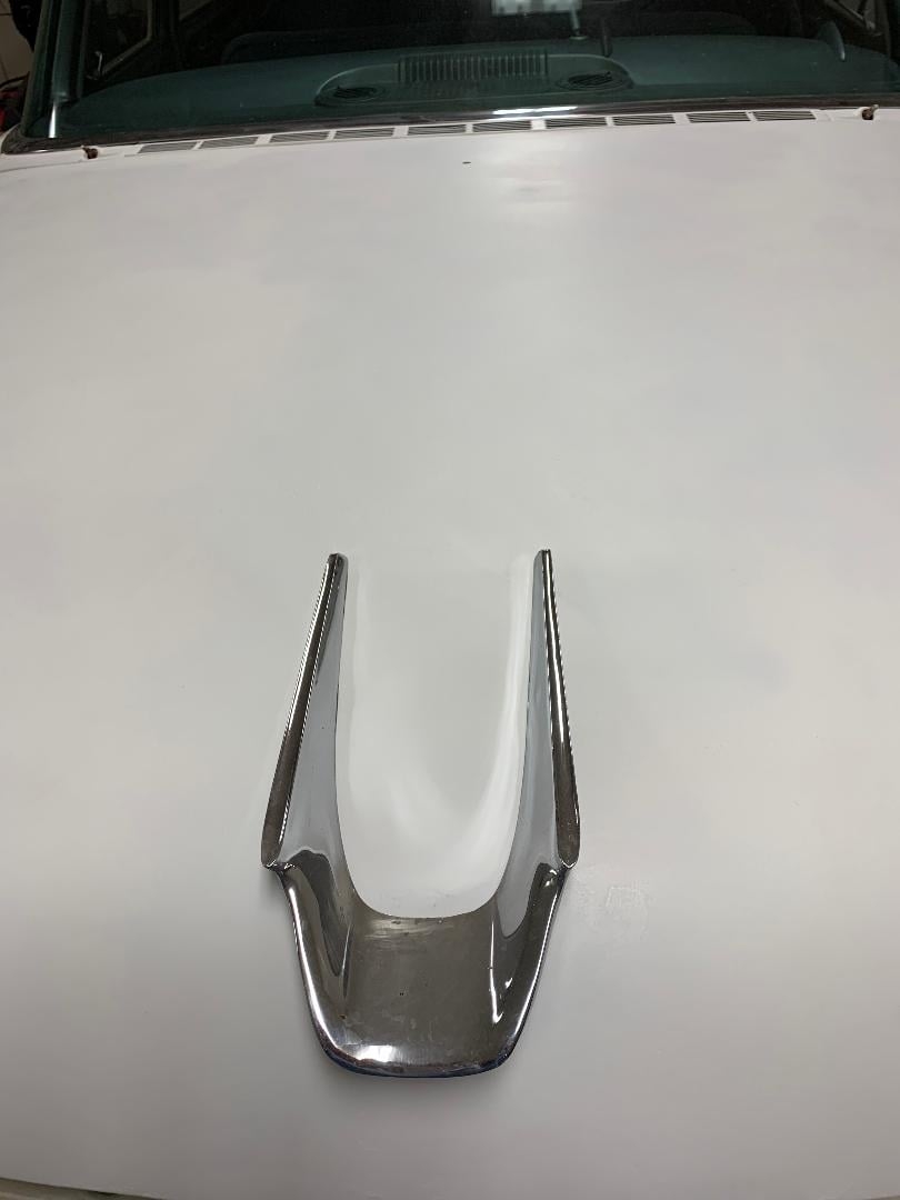

A little more progress on the front end. I’m just cleaning it up a bit for fun.
Eventually, it will have to be stripped properly for paint.

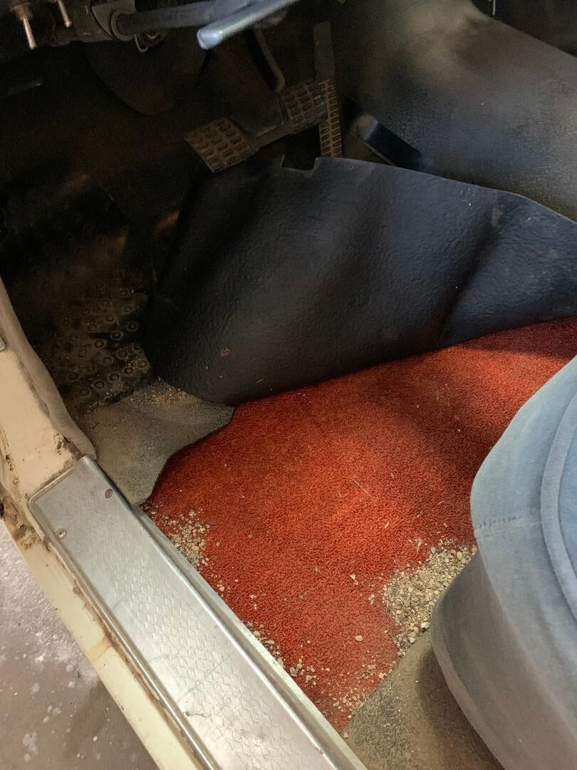

When I bought the car, it had black rubber flooring.
But I could see something red sticking out where it was torn. I pulled up the rubber flooring and the red carpet was underneath.
Sombody in the past, had to have unbolted the drivers seat, installed the correct Plodge rubber matt over the carpet and put the seat back in! Perhaps to "save" the carpet, like they did with lampshades and sofas back in the day?
The rubber keeping the carpet damp did a great job rusting out the floor.

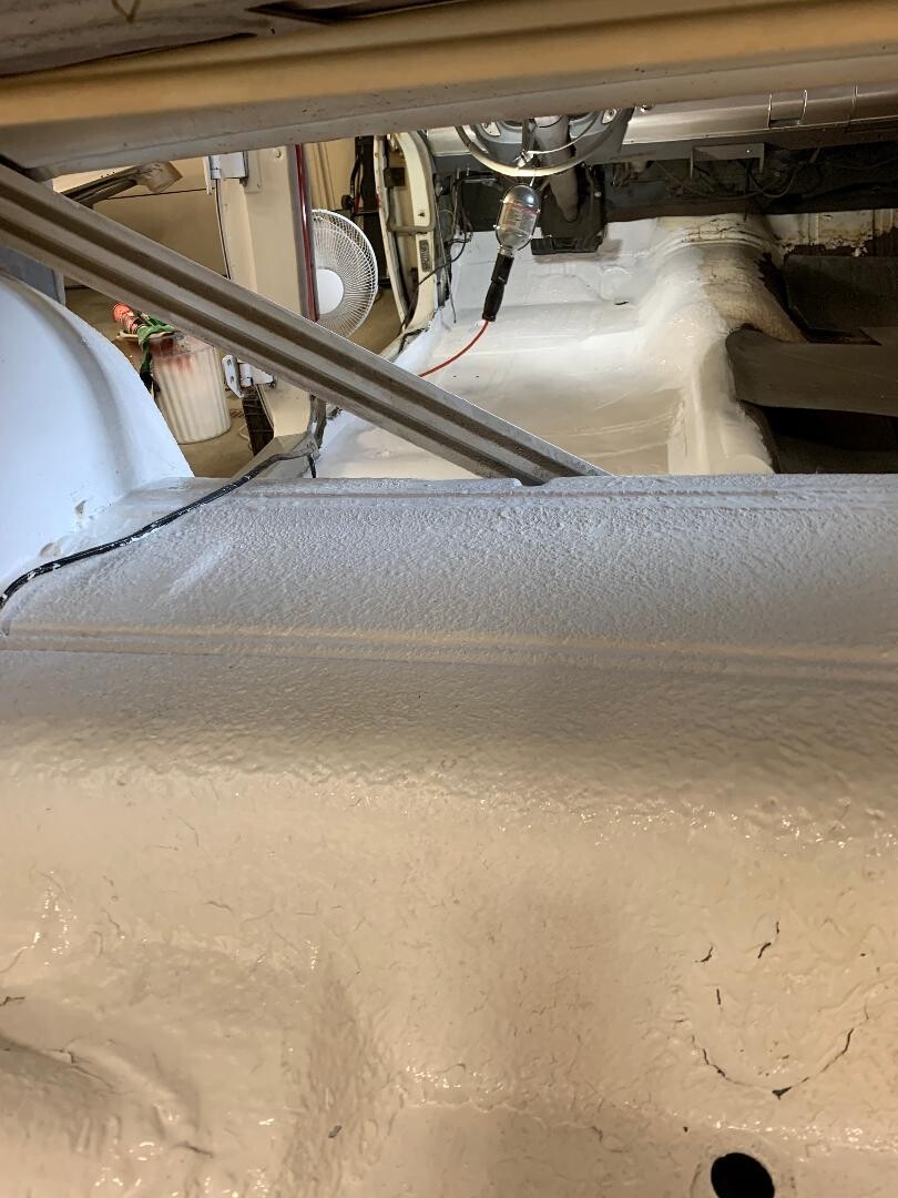

Couldn’t sleep, wandered into the garage and saw I left my trouble light on. Even looks good in the dark!

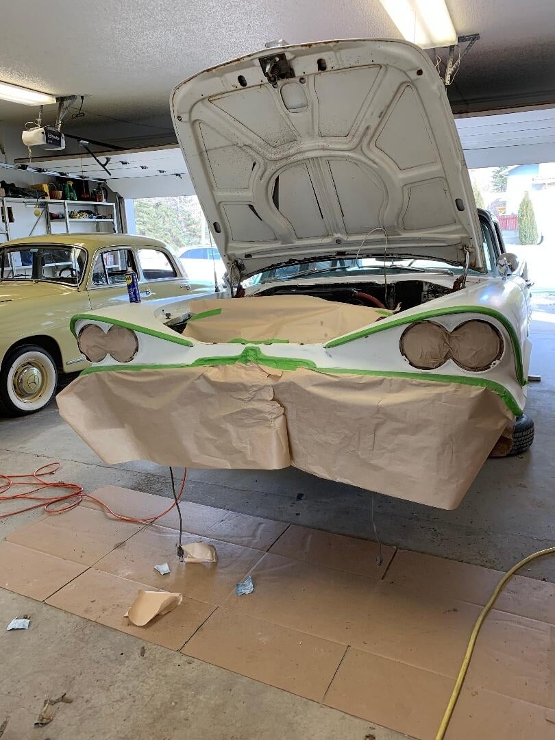

What a great day to work on the Dodge! Removed the cover,put the battery back in,dribble a little gas into the carb and varoom! Drove it into the garage and proceeded to give it a face lift…
reinstalling the re-chromed bumper
Took most of the day, but Finnegan’s front is done! I went with a Black mesh grill to highlight the chrome. Easily undone if the next person doesn’t like it.

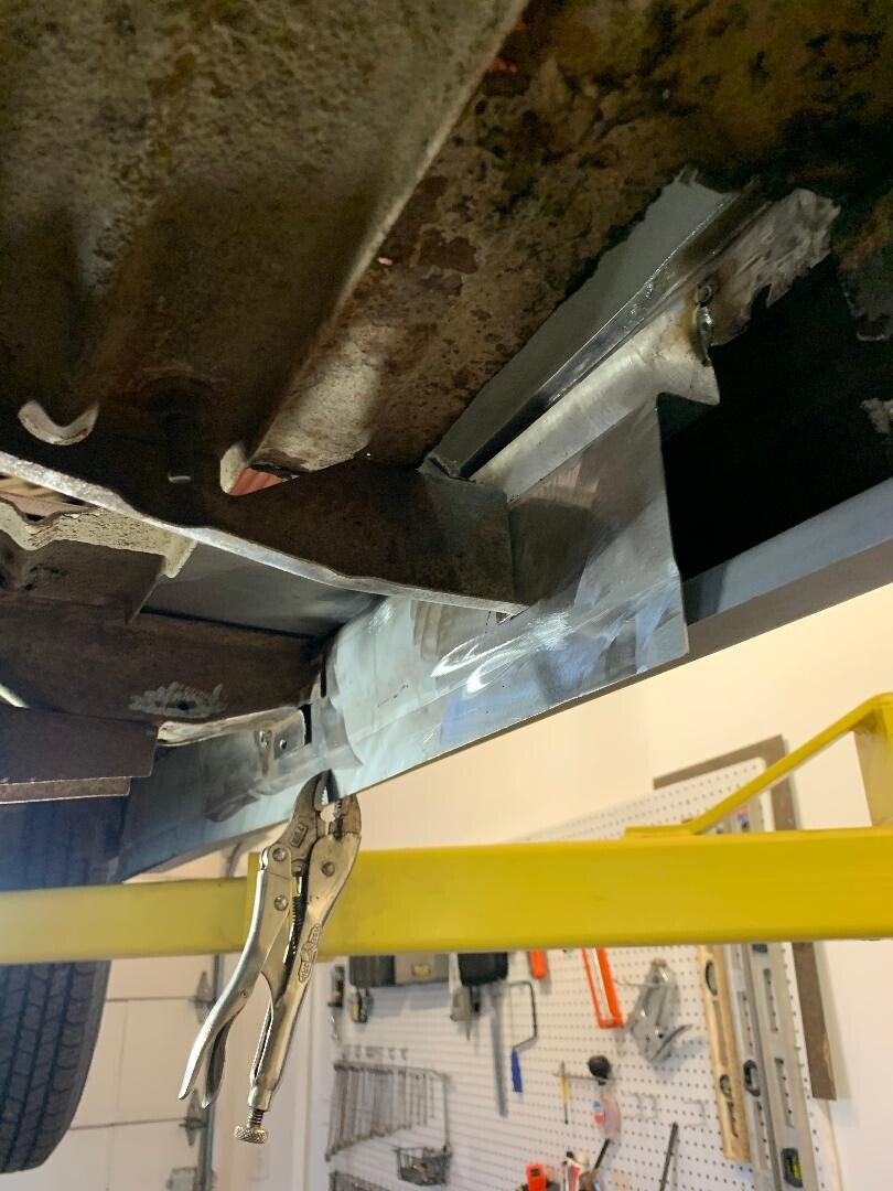

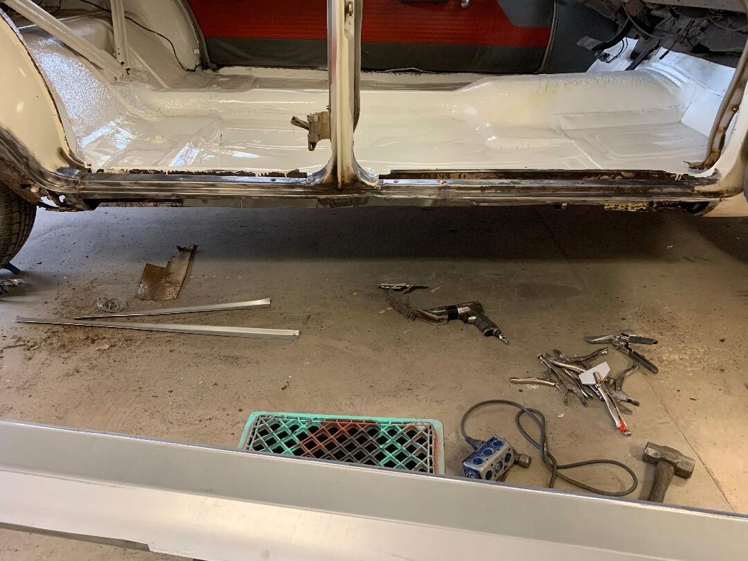

I started on the floor, inner and outer rockers. Worst rust was Lf. rear behind drivers seat. Cut everything out and replaced the aft section of the inner rocker. Cut out lf. rear floor and replaced it. Used a combination of mig and old fashioned brazing. Did it on the floor rather than up on the hoist as I could see the doors misaligning slightly when on the hoist.
I usually pick things up pretty quick, but I suck at Mig welding. Outer rocker is only a test fit. It goes on last. Have to do both inner rockers first.
The entire floor pan,(6 sections) both inner and outer rockers are all available from Classic to Current. I only have to fabricate some of the rusted cross braces.
Finished the drivers side floor!

Spent the morning Fabbing up and welding in the rusted Lf. dog leg. Not my favorite repair, but glad the metalwork is done.
New rocker fits well and the gaps under the door are good. Lf. rear Inner fender needed some love as well.

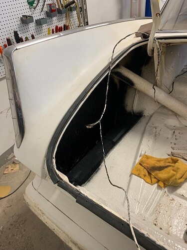

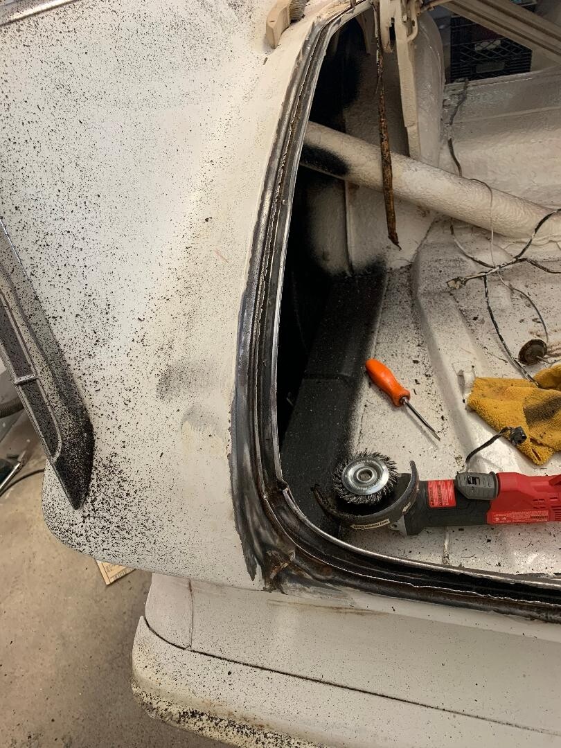

Working on the rear of the body on my '59 Plodge - the rear window seal. I cleaned it best I could and dug out anything loose and added more sealer. The is a small water leak in the trunk at the corners,not the middle. Stays indoors until I deal with it. I would prefer to pull the rear glass and reseal one day.
Wow! removing the trunk seal from the channel is brutal! To much stuff bouncing off my face, will have to invest in a face shield! Safety glasses aren’t cutting it.

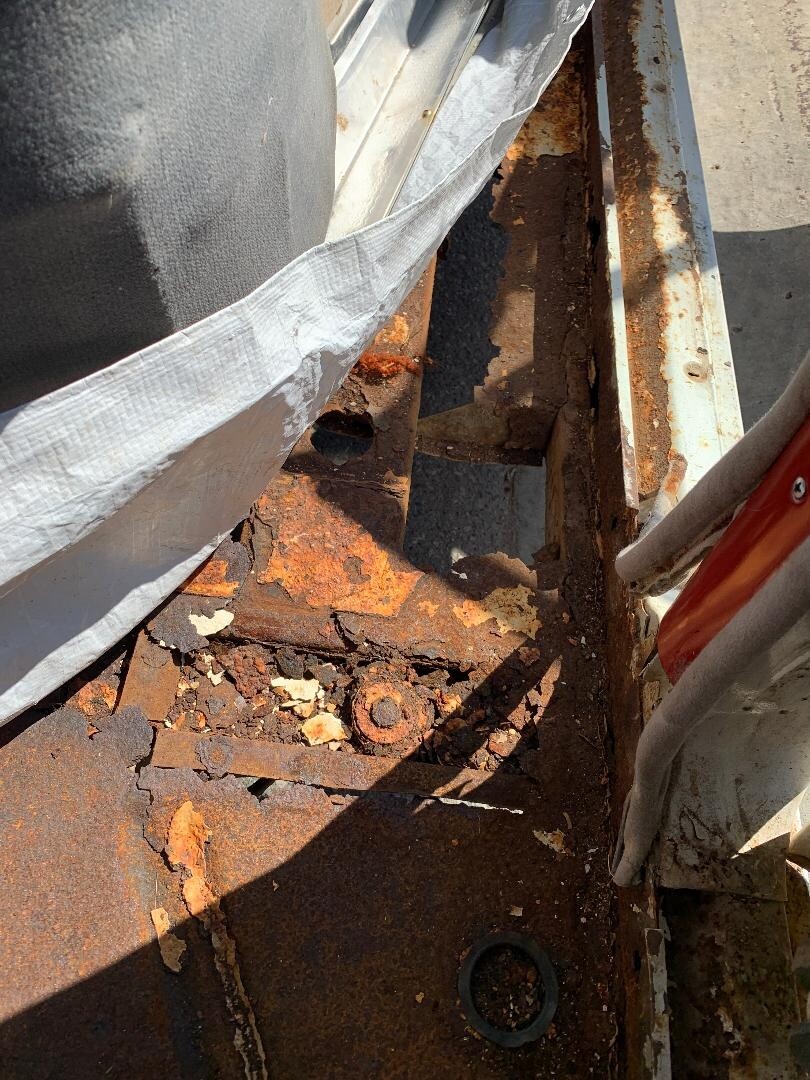

This is the part where I tell myself “Just finish the damn thing! Nobody’s gonna see that on a white car!” Stalling for time before finishing the pass floor and rockers

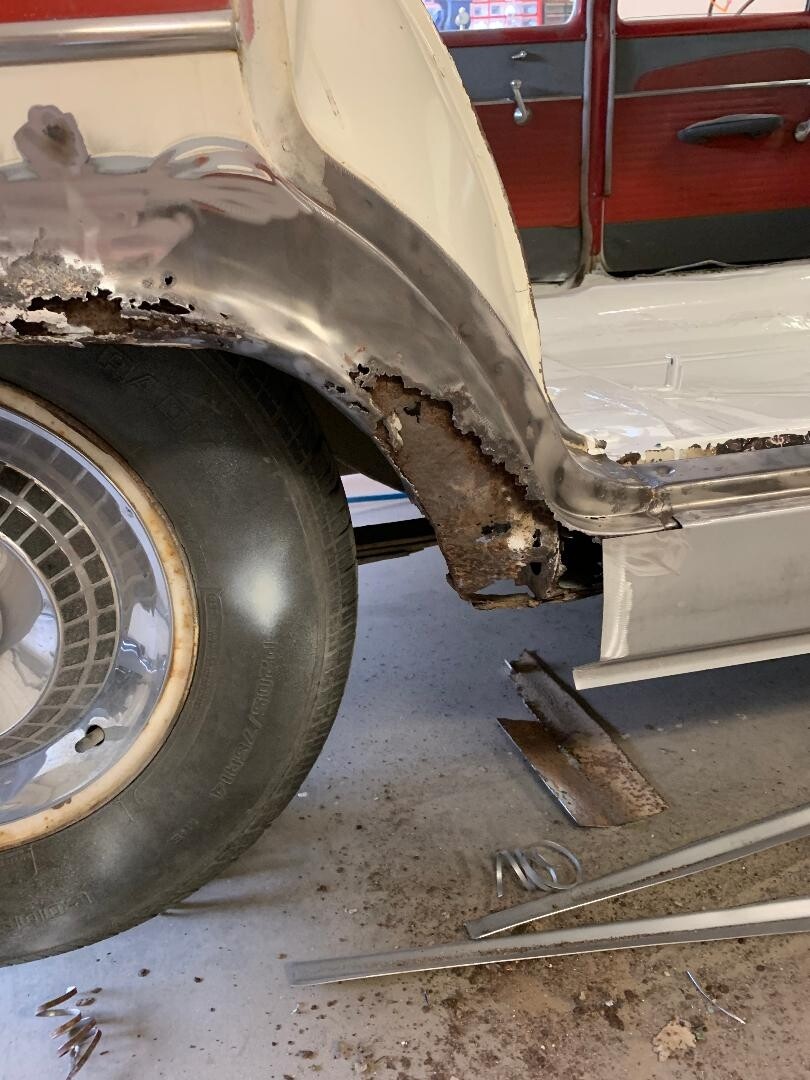

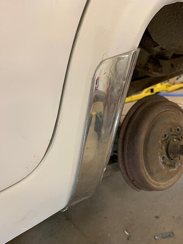

As good as the drivers side quarter panel is, the pass side is pretty bad. I need repair pieces for the area ahead of the rt. rear wheel, (behind the little chrome plate)…
…the lower part behind the wheel and especially the top of the wheel arch. Is anyone fabbing these parts?

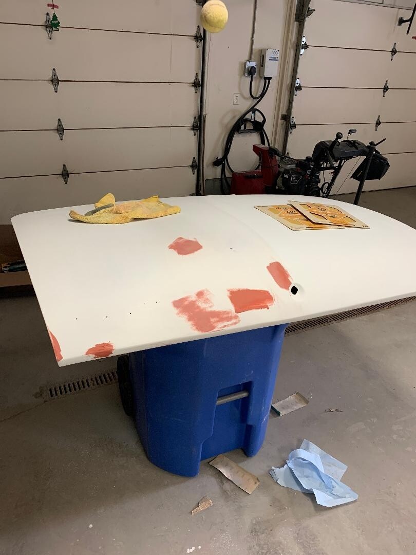

Giving the trunk lid similar treatment as the hood

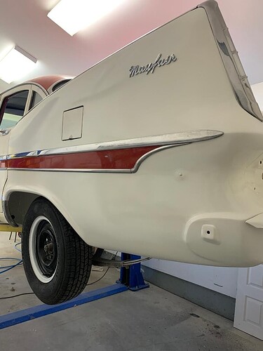

Bodywork and painting continues on the '59 Dodge
Drivers side is done except paint correction and polish. Time to spin it around and do the pass side.

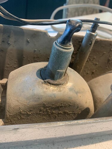

I’m getting the taillight assy’s from the '59 Plodge ready to go out for chroming and I can’t seem to remove the bulb sockets.
They look pressed in place. Do I have to break them out and replace them?
[The answer is yes! They’re pressed in, and must be broken out.]

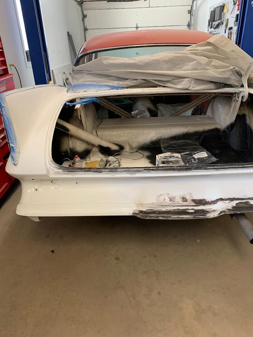

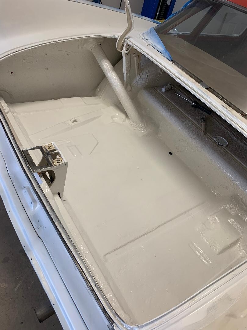

The Plodge got some lovin’ this week! Cleaning the rust up around the trunk seal and cleaning and fixing the pin holes in the trunk pan and sealing with epoxy and paint!

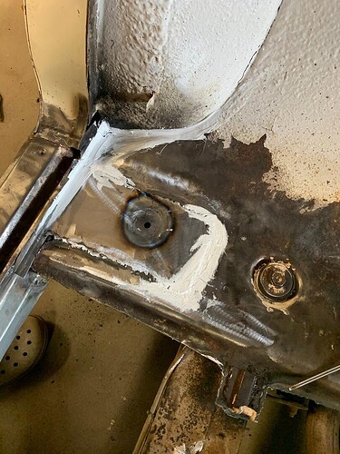

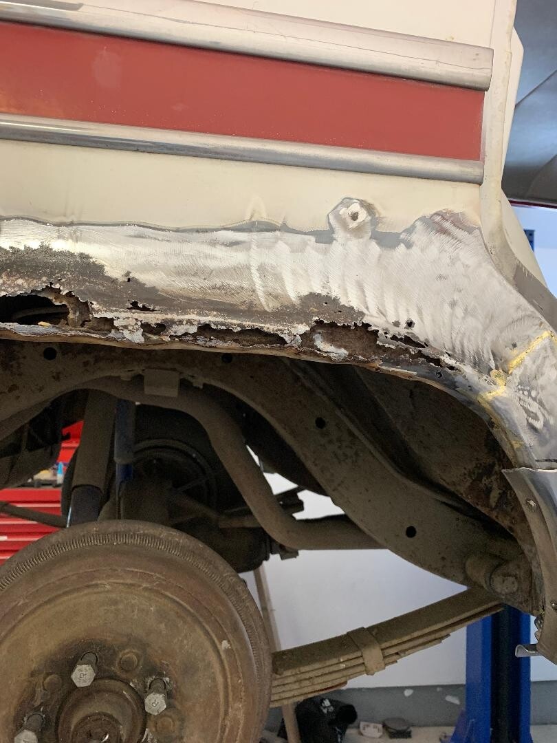

Spent the day cutting out the rust at the rt. rear corner below the C pillar. Very rusty part of the car. Rebuilt the cross member below.
Replaced the rotted metal inside the car and will reinstall the body to frame mount tomorrow. Rear section of inner rocker in place as well. Hopefully, I’ll have the rear pass pan installed by tomorrow.

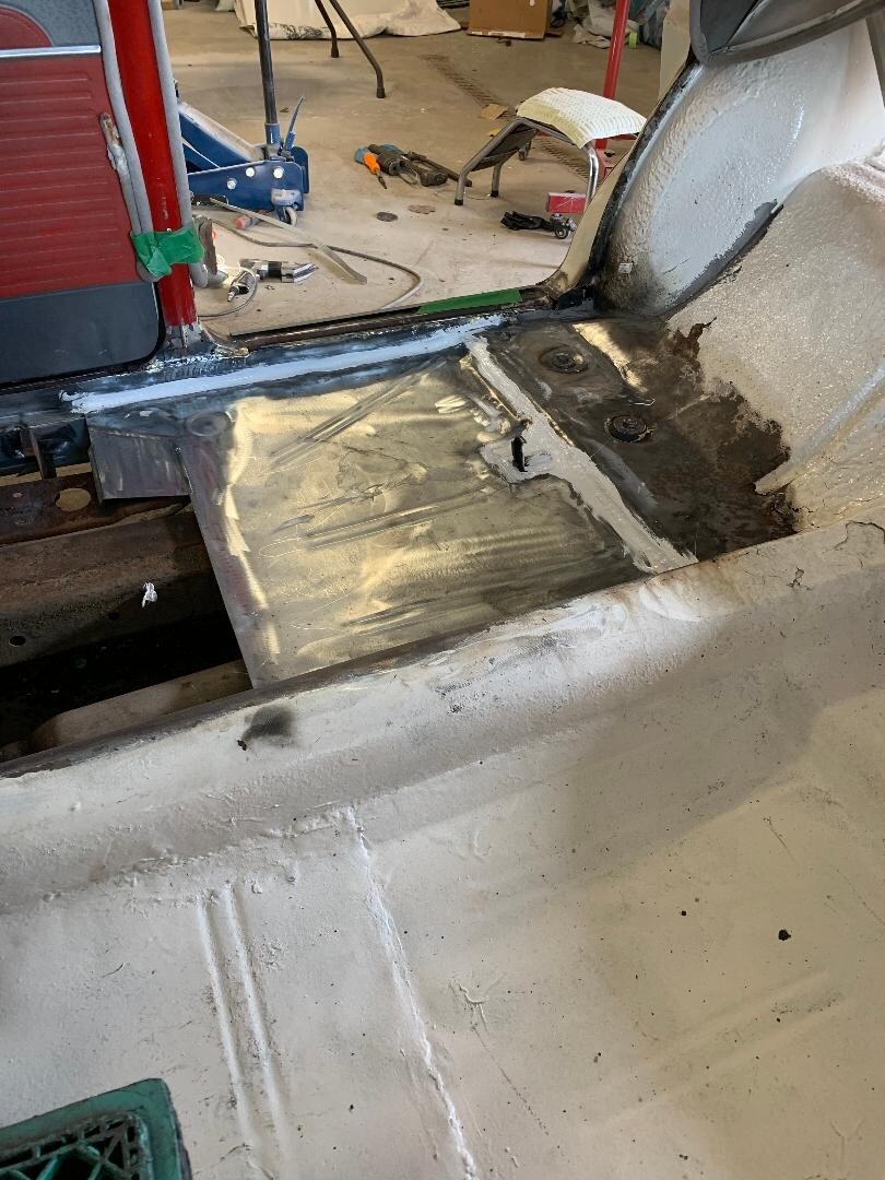

Got the pass rear floor done today on the '59 Plodge.

Well I’m Floored. Somewhere around 60 hrs, but the floor and rockers on the '59 Plodge are done.
The pass exterior rocker remains to be fitted, then on to the completely thrashed rt. quarter panel.
Rebuilding all the cross supports and seat reinforcement took forever.

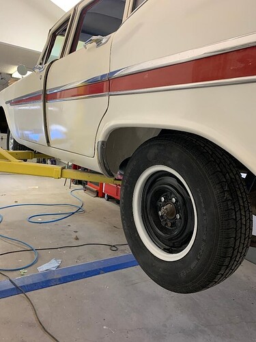

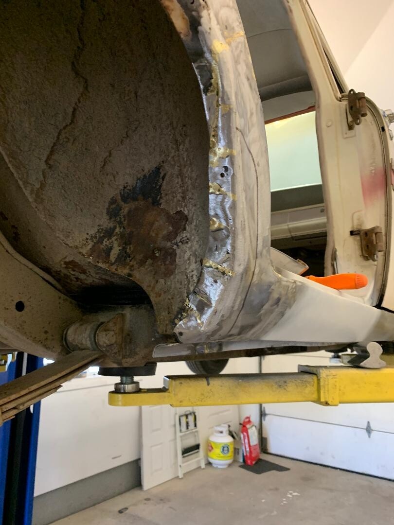

…and the passenger outer rocker is done. Almost ready to start on the wheel well from hell.
Had to support the car by the diff and the front lower ball joints to keep the body in alignment. The B pillar will droop if you’re not careful.
Left the passenger front door on so I can always check to see if it still closes with 1 finger.

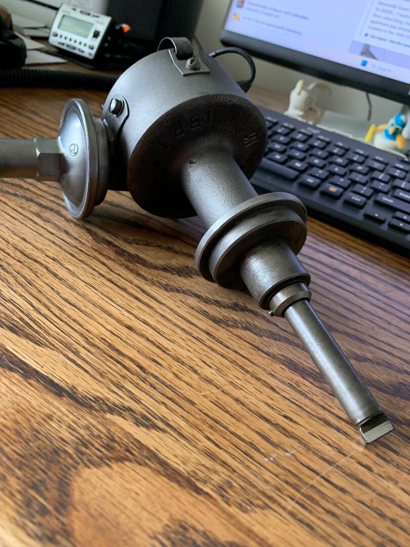

On my 59 Dodge Poly 313, I have the distributer out and I cleaned it up and will replace the points/condenser etc., but noticed there wasn’t anything resembling a seal or o ring where it goes in the engine. I’m thinking a round paper gasket of some kind should be there… Strangely, no oil leak or weep at all in that area. I did consult the Canadian shop manual for the car and it doesn’t show anything, paper or steel. I’ll give it a smear of sealant.
Distributor is back in and the car runs so much better with new points, condenser and 4 plugs (the rest were backordered.) In the process, I mislaid the metal vac pipe from the carb to the advance so I started it up anyways to see how she runs. At idle, with a warm engine, The carb is still producing substantial vacuum. Shouldn’t the carb only supply vacuum to the distributer on acceleration. Idle is set at around 750 rpm.
I find the fact it has a steel vac pipe strange as you would have to bend it to set the timing!
Thanks everybody that helped me stumble thru my tune up on the 59 Plodge. Plugs showed up today, AND I found the vac pipe hanging from the snow blower handle (by accident when I moved the snow blower to the backyard shed.) Car runs amazing!

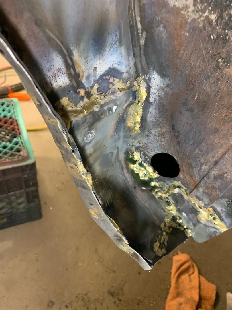

Plodge rust repair on the dog leg. Step 1, buy Rice Crispies, Eat them and use the box as a template.
Trace out the piece to be fabricated and trace out the metal.
Cut it and weld it in. Presto.
Disclaimer: Not a body guy! Retired VW/Audi/ Mercedes shop owner. Just a hacker doing the best I can with what I have. I know Brass is bad, but I suck at Mig so there’s that.

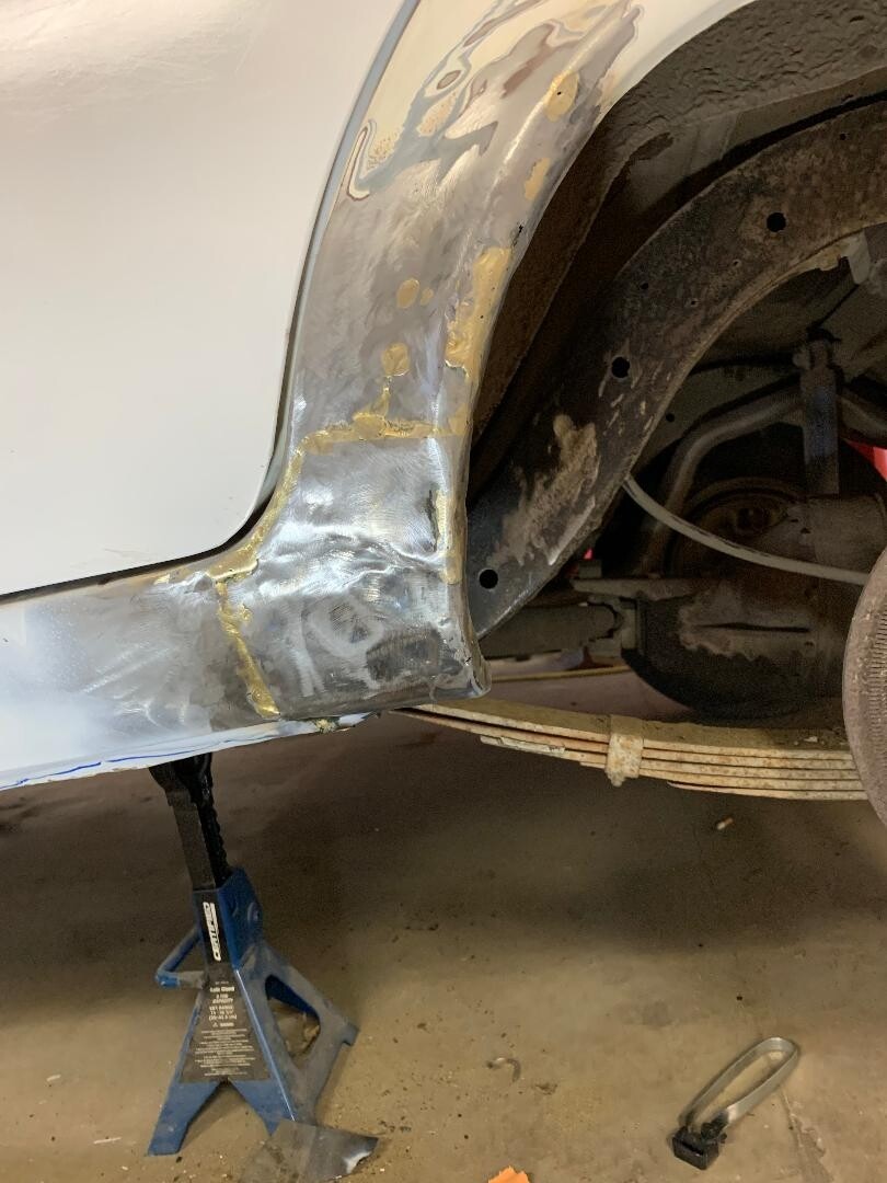

Now I’m looking for a pair of rust free fender skirts for my 59 Plodge. (Same as "59 Plymouth) I need them to act as a template to reconstruct my rusted out wheel opening. Got the dog leg done. Hoping to avoid the “Hate skirts, love skirts” discussion. As close to Regina Saskatchewan as possible, as shipping would probably be pricy.

Had a chance to start on the quarterpanel from hell on the '59 Plodge Mayfair. All the rusted metal is cut out and 2 patches are in place. The area behind the wheel was much worse than it looked and the complete bottom of the quarter will have to be replaced. 1 patch above the wheel is in from behind, but not attached at the wheel well until the skirts arrive to get the opening right. Last, will be replacing the rusted metal I cut out of the inner wheel well, but that shouldn’t be too hard. So glad the other side is done!
