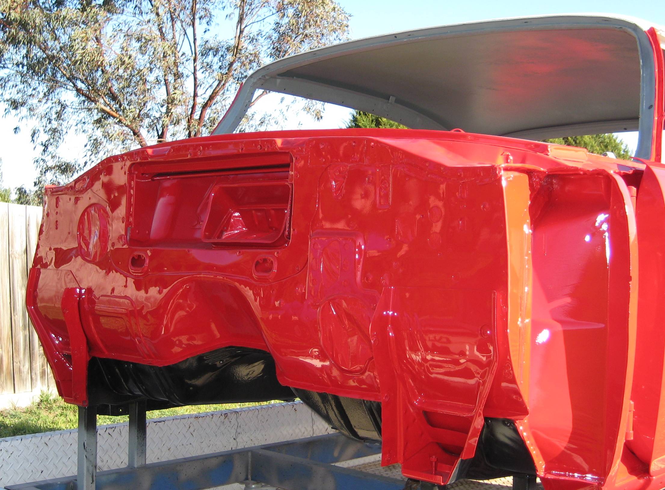

Hello to everyone,
Is anybody able to give me information on the two drainage holes below the heater box opening? :confused: (pic attached)
Looking closer at the holes, they have what looks like two smaller holes for mounting something??? is there some sort of rubber flap or mesh grille that attaches here or is that just the way they are?
Thought I’d ask the question now while I can get to them easy, before I start assembling the front end again
Cheers
Hi Daniel - There are two rubber flaps that cover those holes. You might find them at a Auto yard (Big M) or Gary Goers may have them. I think several years and all makes of mopars had them.

The flaps can be installed at any time, but it would be easier to snap them in before the engine goes in.

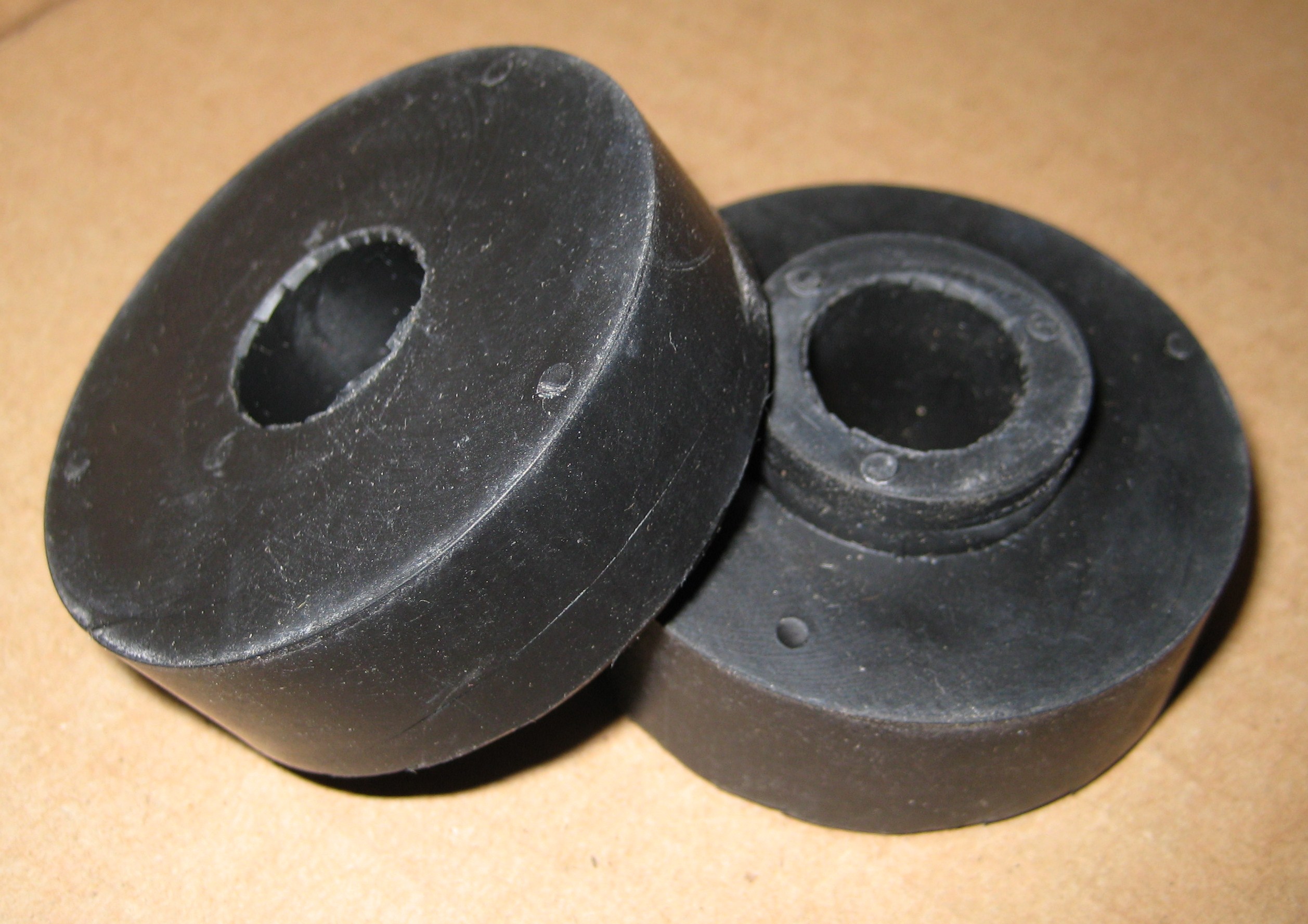

Daniel - Is there a chance you can post pictures of the body mounts you got from Birnbaum.
Thanks,
Hi Dick, here is the pic of the body insulators that I got from Birnbaums, I think by memory they were $7.50 per set, hope this helps.
Cheers
Thanks Daniel - That is exactly what I need.

John Q - I have Bernbaum Catalog #32 and they are on page 12. Part #B-140. $7.50 pr. They don’t look like the mate together, should they??
Daniel - Thanks for the pictures of the Mounts from Birnbaum. I have a question, are they supposed to mate to each other. It looks like the hole is to small in one for the other to fit into. Gary goers Catalog #9. page 29 shows #339A with a plain hole and 339B or 339C with a protrusion that fits into 339A. Which one do we use the Tall Center or the Short Center?? each one is $3.25 ea. I ordered the Short Center and received them in about 10 Days. Hope this helps.

Body mount cushions have a collar which centers them in the hole in the car’s steel frame.
This keeps the bolt from rubbing on the steel (which would make noise). :slight_smile:
when you remove the old ones, you will find a collar formed on top of the cushions. This was caused by 50 years of compression, where the rubber begins to squeeze up into the body. The collar points down, into the frame members.
At the factory, I assume they snapped the cushions into the frame, thus secured, the body could be lowered onto the frame for bolting.

John - I’m pretty sure the on-line and hard copy are the same catalog. The Birnbaum mounts and the Gary goers mounts are the same. Both for 59’s. I’m still confused as to how they are installed i.e. protrustion up or down? one with protrusion on top or bottom? Maybe you could take a look at your car and advise! I can’t tell from looking at my car, most are gone totally or only pieces remaining.
Hey Dick,
Did you not see my posts? The “protrusion” goes into the frame.
Yes Roger I saw your post - I understand the protrusion goes into the hole in the sheet metal but does it go facing down or facing up. Both pieces of the body mount have a half inch hole for the bolt but it seems the plain half would have a 7/8" hole for the protrusion to fit into but it does not. I know a big flat washer fits on both sides of the mody mount and I assume torqueing it down compresses the protrusion??? I’m thinking the half with the protrusion faces up in the hole, the other half goes on top with a flat washer on it, then the bolt is inserted with another flat washer on the bottom, then a lock washer then the nut. What do you think.
