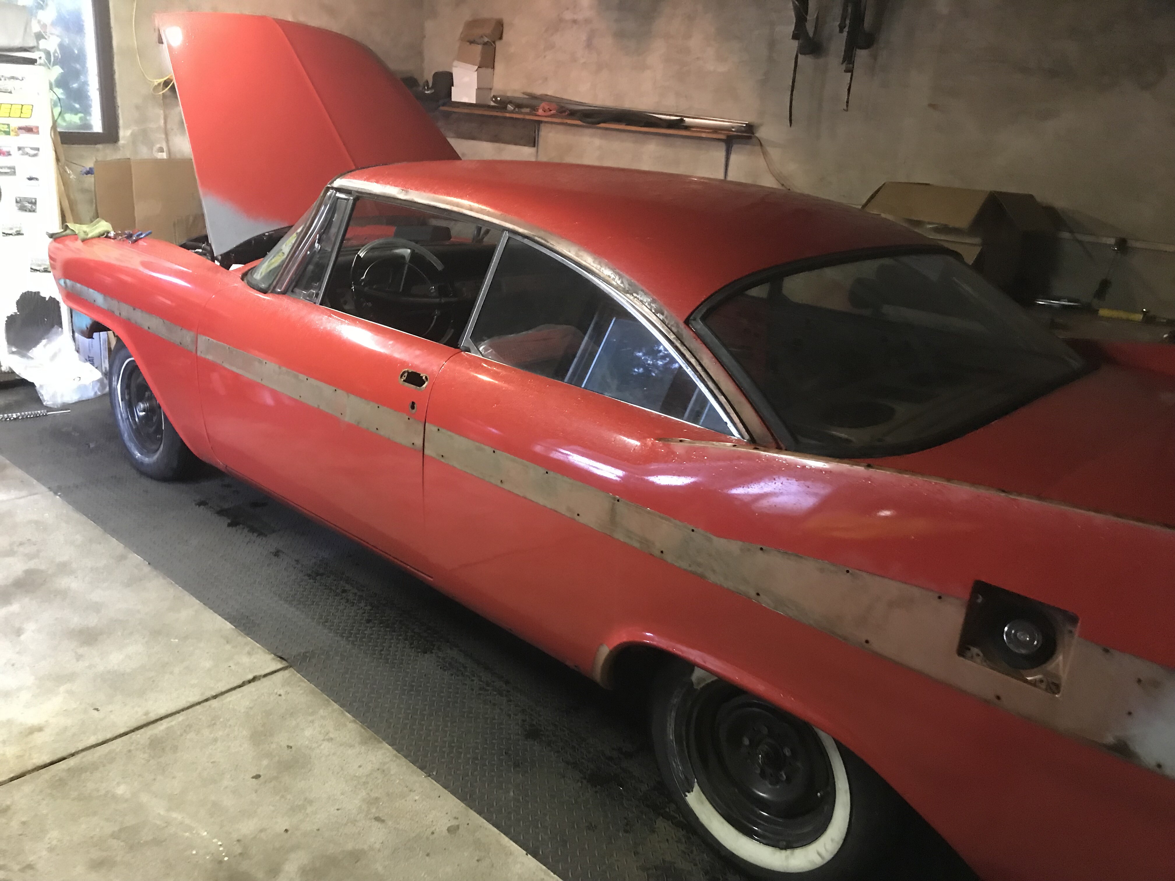

Faulkner gets a Redo
Happy Thanksgiving Dan. Faulkner does look lonley but soon enough will be getting plenty of tender living care. How have I never noticed that when the car was painted red they didn’t remove the sport deck, guessing that since it’s been covered in that spot is whole life the original paint might still look pretty good, albeit only in that one circle. Can’t wait to see it dressed fully in that beautifull color combo!
Happy thanksgiving (belated). My o my, been out of your sight ten minutes amd you go checking him out to see if he is misbehaving. Just so you know, most paint shops charge double for watching and triple if you ask questions. Besides, if you know everything it will drive you crazy far into the future. Then again he may get attracted to a chevy while there.

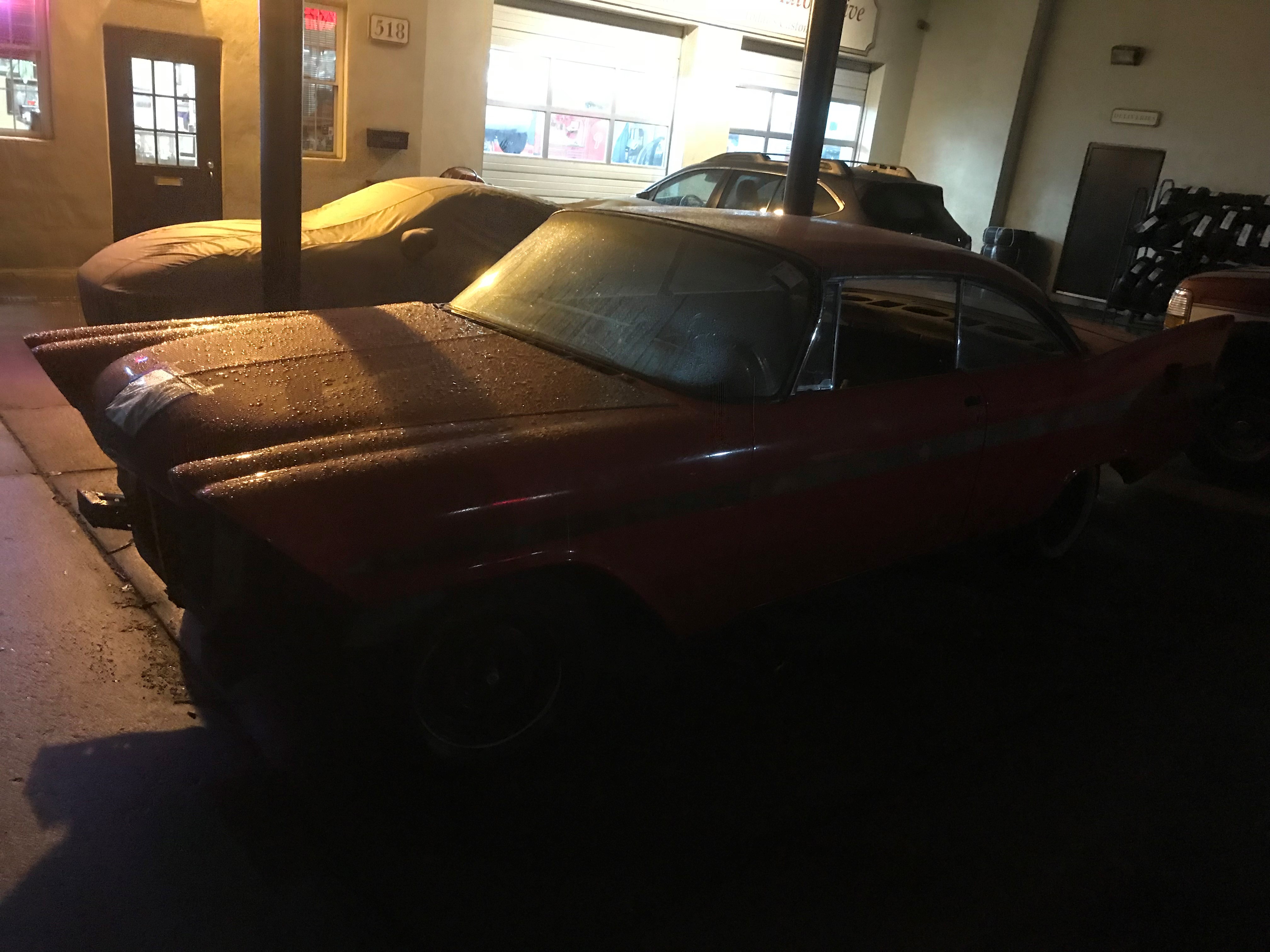

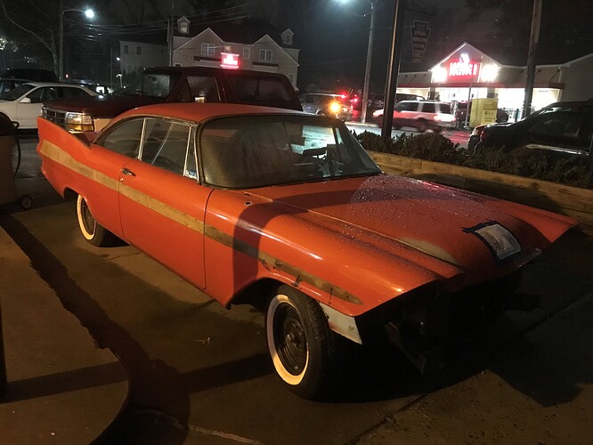

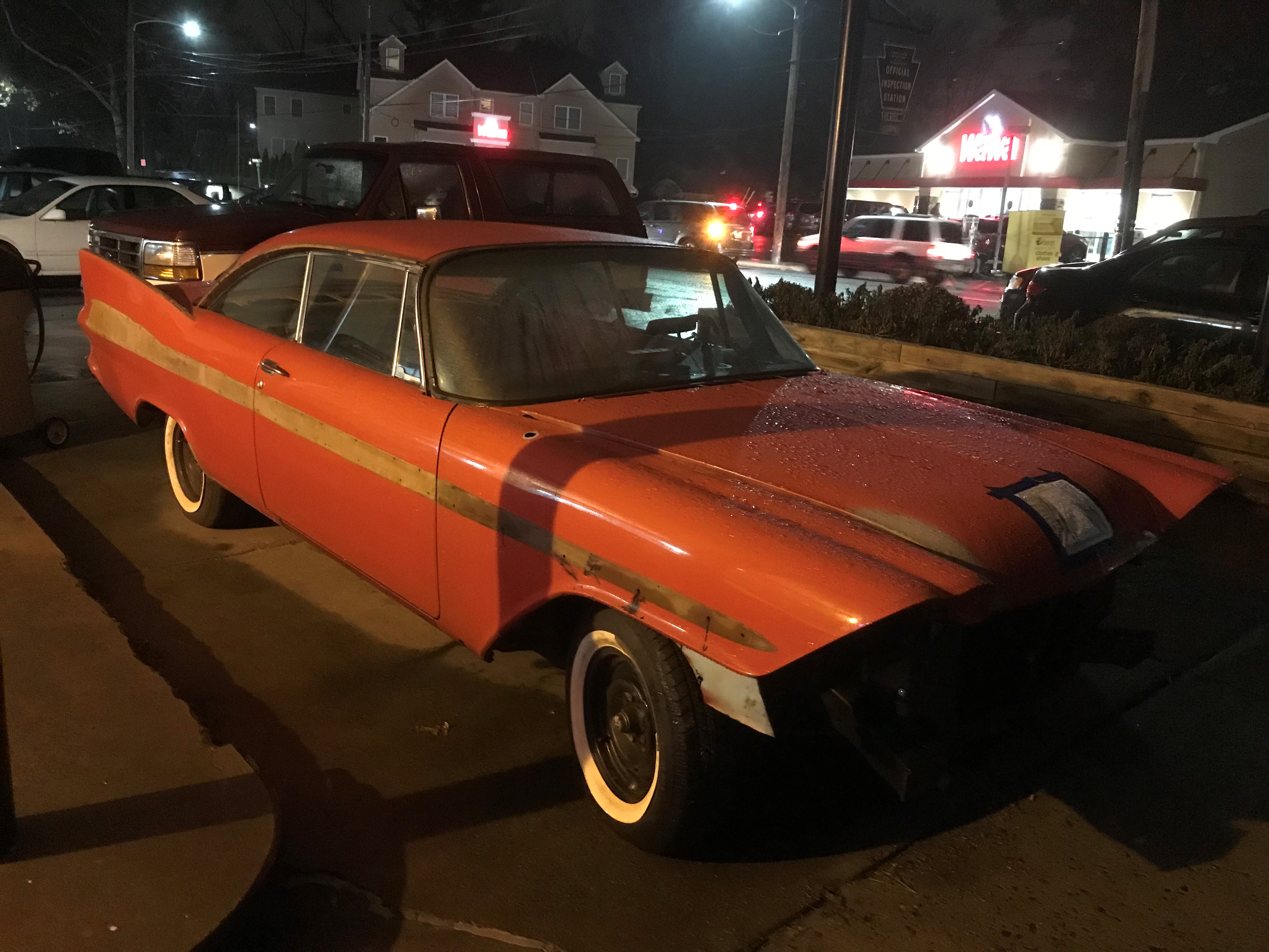

There’s a little Toonerville Trolley at the foot of my street - I love it! It brings me home from work each day, but I stayed on to go to Drexel Automotive, a few stops down the line, where Faulkner is. The excuse for my visit, was that I forgot to supply the oil pan washer I bought for the oil change. And there was Faulkner, parked outside, rained on and looking lonesome…
They explained Thanksgiving Holiday, down a man, and receptionist sick so we park a mechanic at the front desk, yada yada. It’s clear, I just need to keep my distance and let them get to it when they get to it. In the meantime… Cue Little Anthony and the Imperials:
"I’m On The Outside, Looking In"

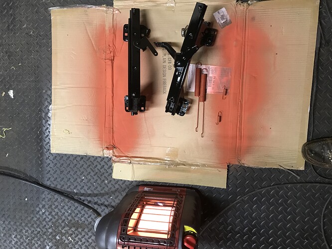

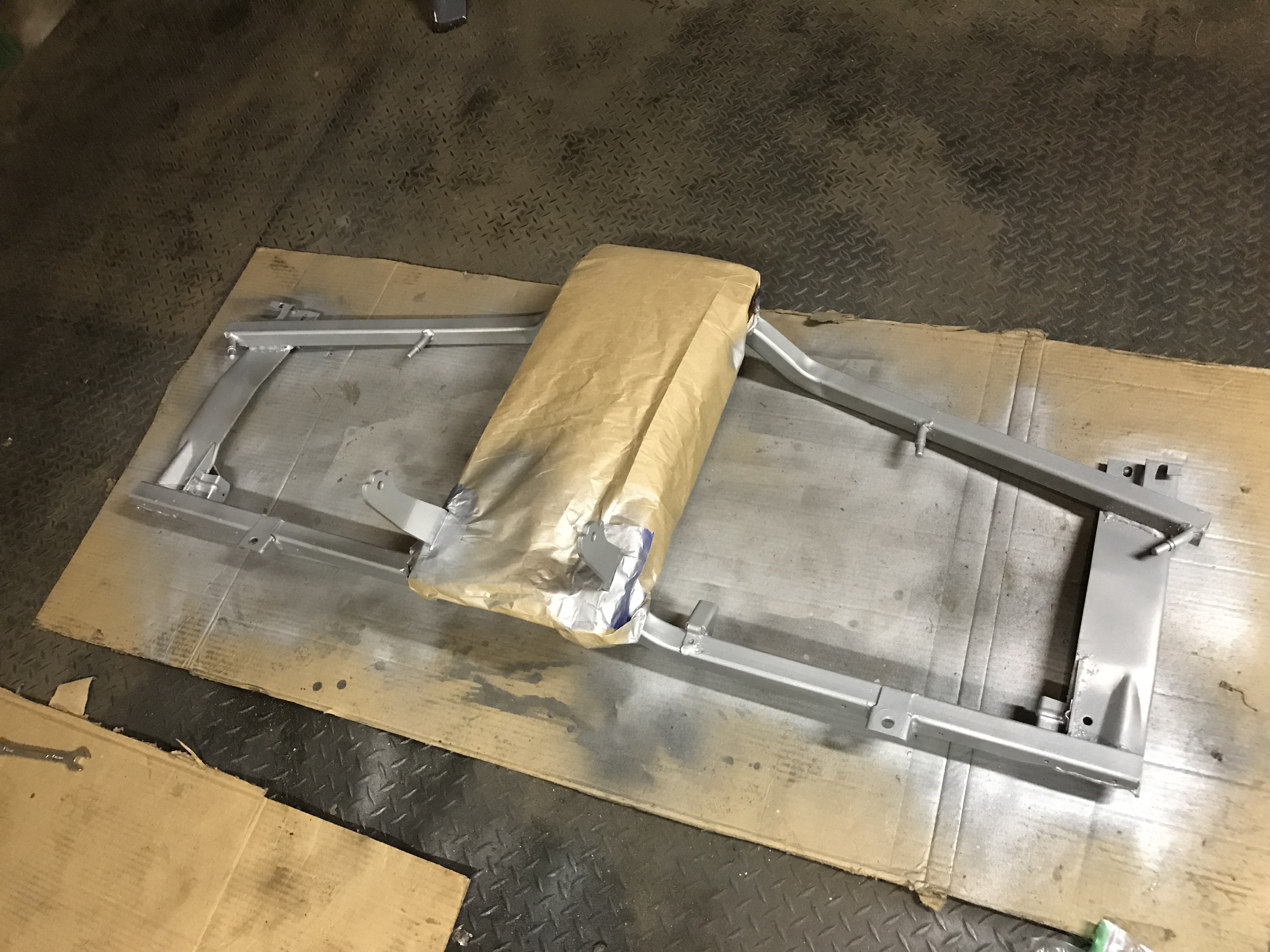

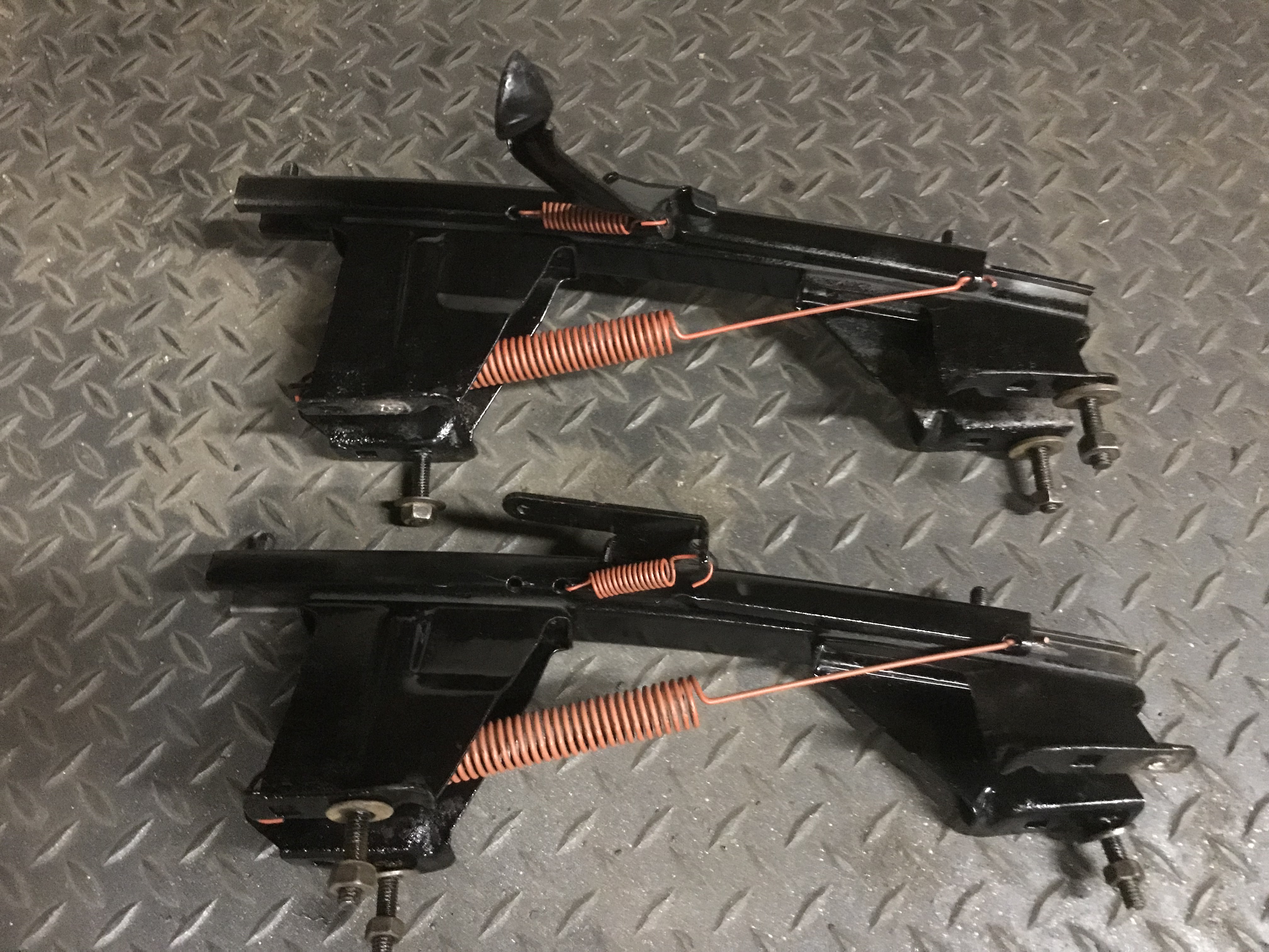

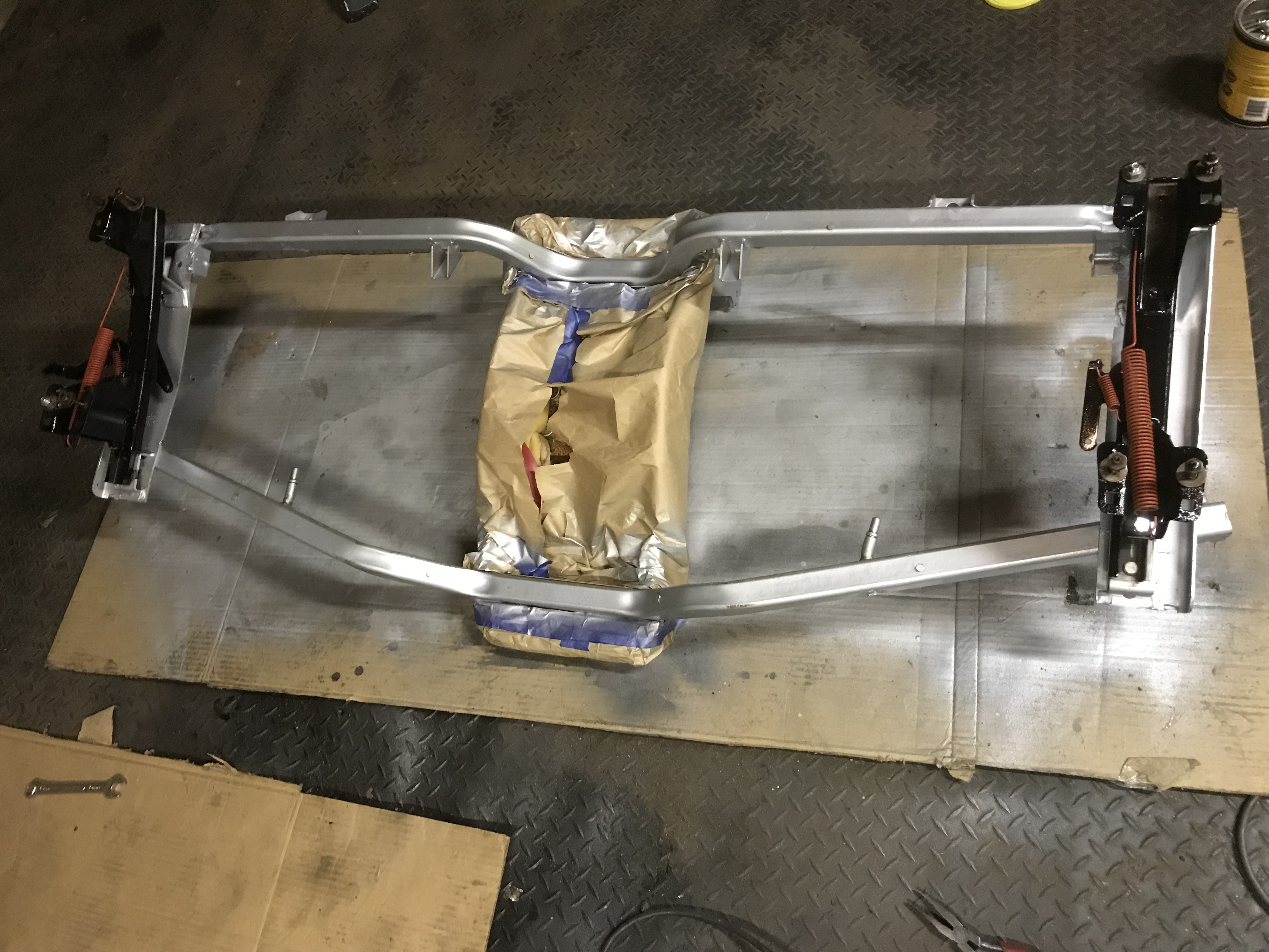

When putting on the front brakes, the shop broke a retaining spring - so Monday morning, I’ll be calling Bernbaum/Kanter/usual suspects for a set to FedEx directly to Drexel Automotive. But they put me on alert - they want to give Faulkner a driving test, and the Dick Koch patented milk crate seat ™ won’t do. They want a bona fide seat. So, I spent today cleaning up and painting the front seat frame, even though I still have to replace two broken mounting bolts. I’ll take care of that once Faulkner is home.

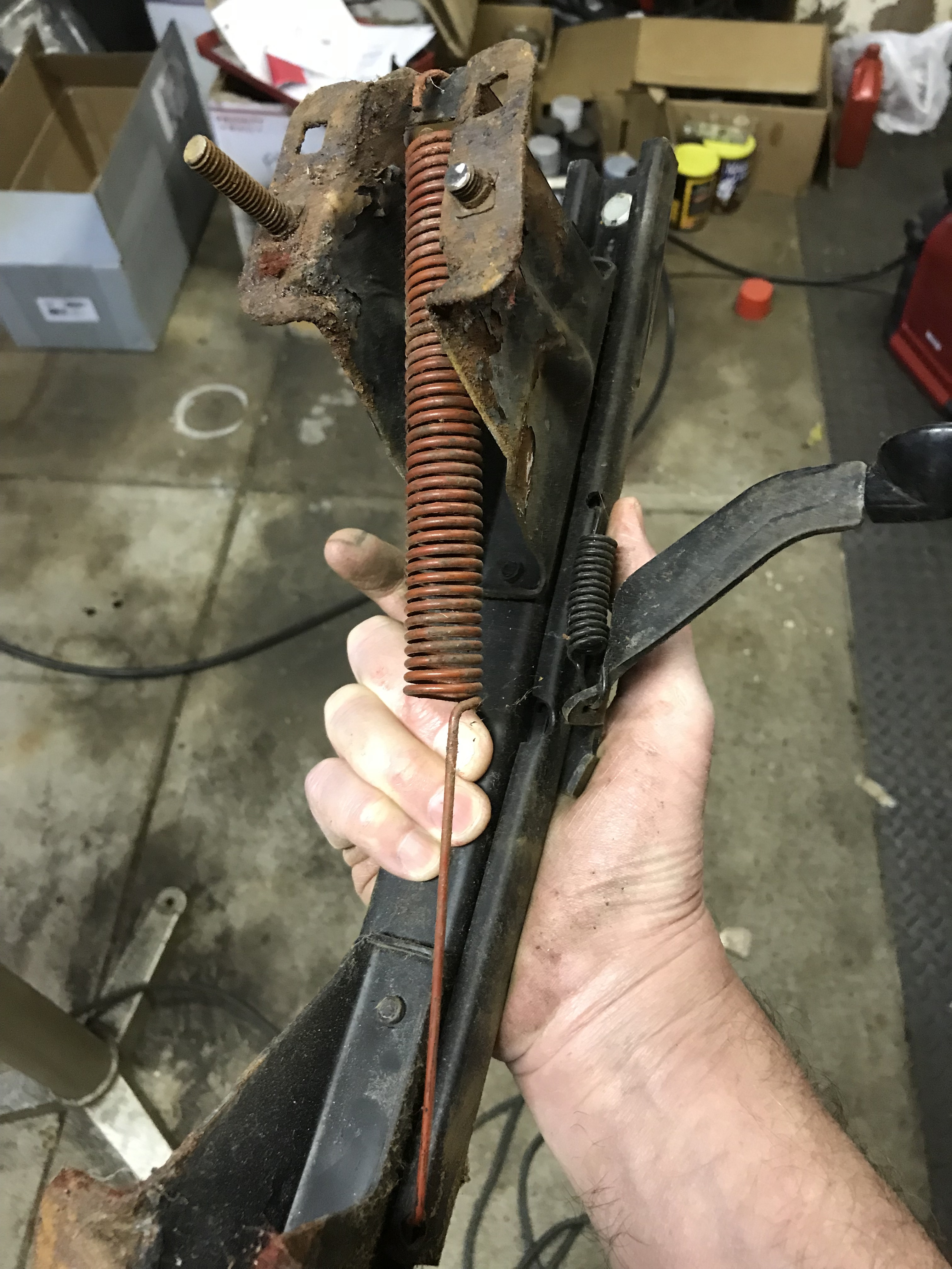

Note to self: This is how the springs go. The "poor man’s bead blaster" to the rescue in cleaning these up!
It was mild today - cooler in the Faulkner garage than outside! A little heater help with drying the paint

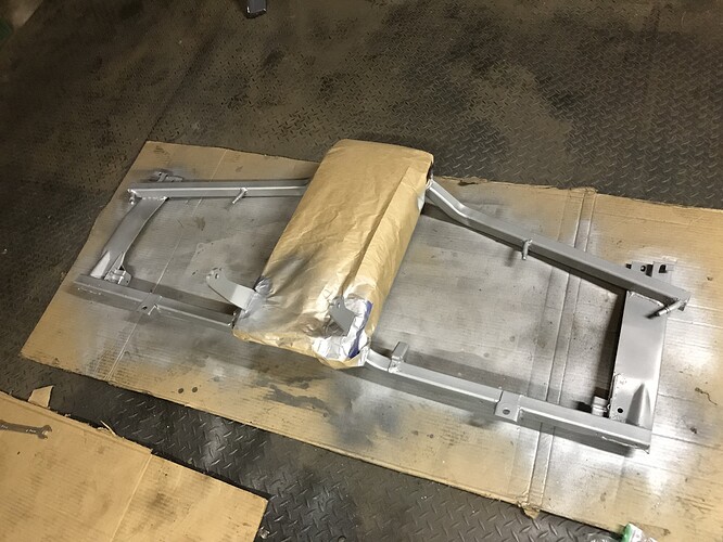

Seat frame all spruced up
Tomorrow night I’ll slap everything back together, and deliver Tuesday morning to the shop.

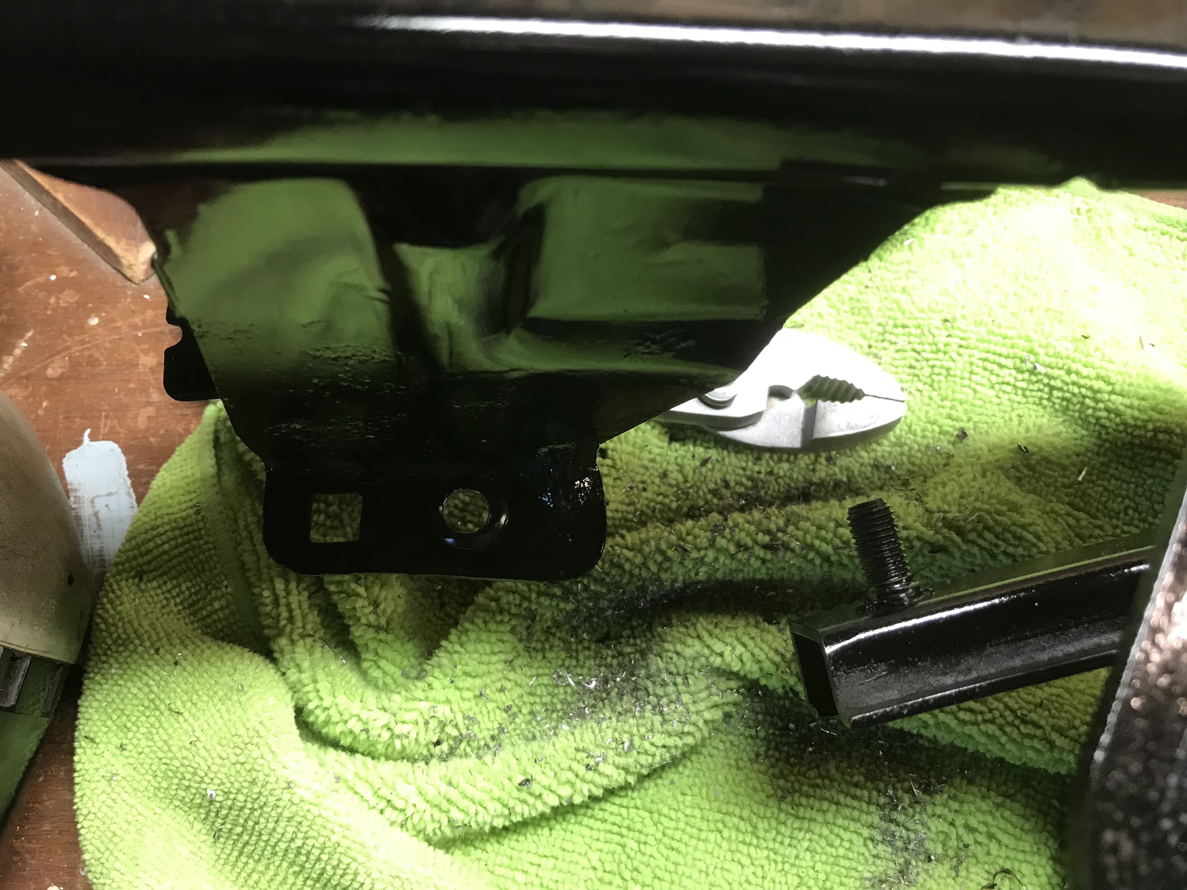

What the hell - might as well drill the bolts out now, right?
No square pegs in these round holes - 5/16" cap bolts will do
Glad I took pichuhs of the springs

Those square holes are designed for carriage bolts that have a square under the head!
I know they are, Dick - but did you ever try to punch one out?!? They won’t go. I just drilled through it; and I don’t own a drill that drills square holes. Maybe for Christmas. :unamused:
They make em you know, google it.
I’ll be danged! A combined auger/chisel. That’s pretty spiffy! I learn a lot from hanging out with old Ace Hardware guys.

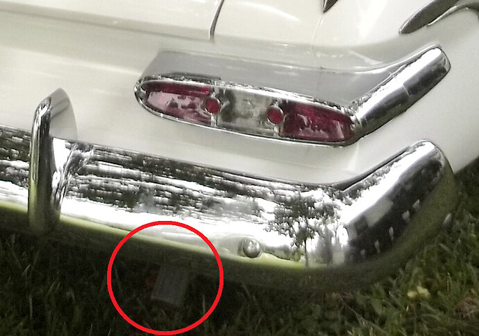

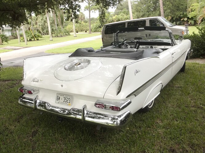

The brakes are done, they were working on the exhaust yesterday. They’re working from the rear forward (because they have to make up the lead pipes), and they wanted to know the placement of the tailpipes. There’s no bumper to guide them! I sent the following two pix of a fellow member’s car (guess who), and offered to bring the bumper over - but they said no need, the pix tell the story. Thanks Dick!

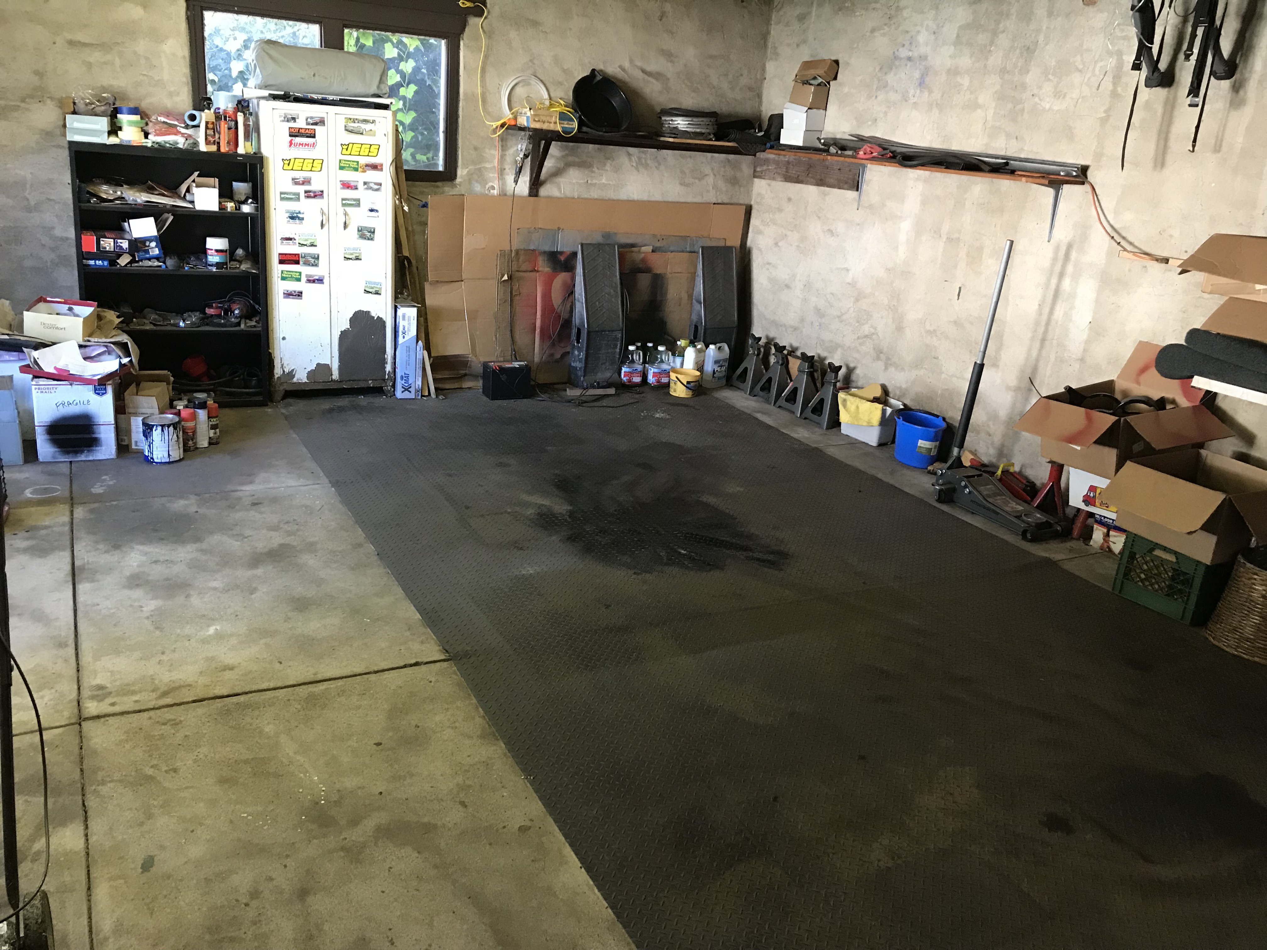

Not having any toys to play with, I spent some time in the garage tidying up and vacuuming. It sure is lonely in there…
(sigh…) And no Martha parked in the driveway. Will they be home for Christmas? Or only in my dreams?

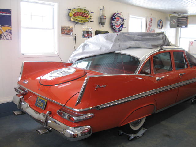

Dan; I had the same exhaust tip question when I did mine. I went with straight out the back only because I was, and already had exhaust tips. Otherwise I would have gone the way Dick did his, it looks great. To each his own. I have seen some angle to each side as well. As for the empty garage that is only temporary, sit A spell and have A Yuengling or two. Later Mark. P.S. President George H W Bush’s funeral train (locomotive) is an EMD SD 70 AC They go back to the early 90’s when they went from DC to AC traction motors. It was General Motors answer to G.E.'s Dash 9 They look similar to ours. We did A presidential locomotive in the early 70’s, don’t know what become of it ?

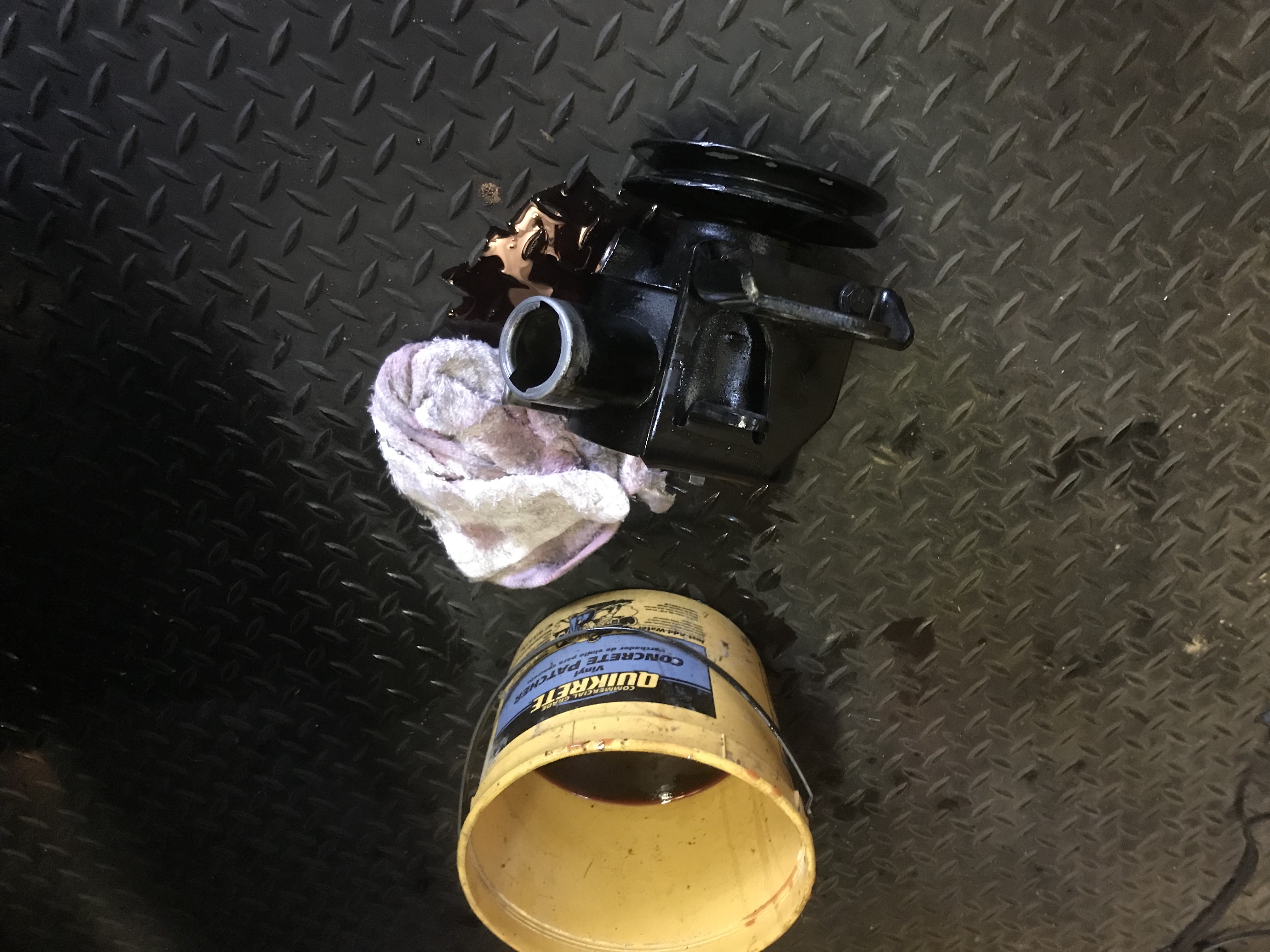

They also flushed the power steering, to no avail. It still steers like a truck. Apparently, the rebuilt pump is defective. I hope to be able to pull it tomorrow and return it to the shop for repair.
Faulkner’s safely ensconced in the garage once more! I found the receipt for the pump rebuild, pulled the pump and returned it to the shop.
