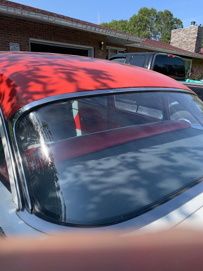

Finished up the package shelf with concealed speakers…

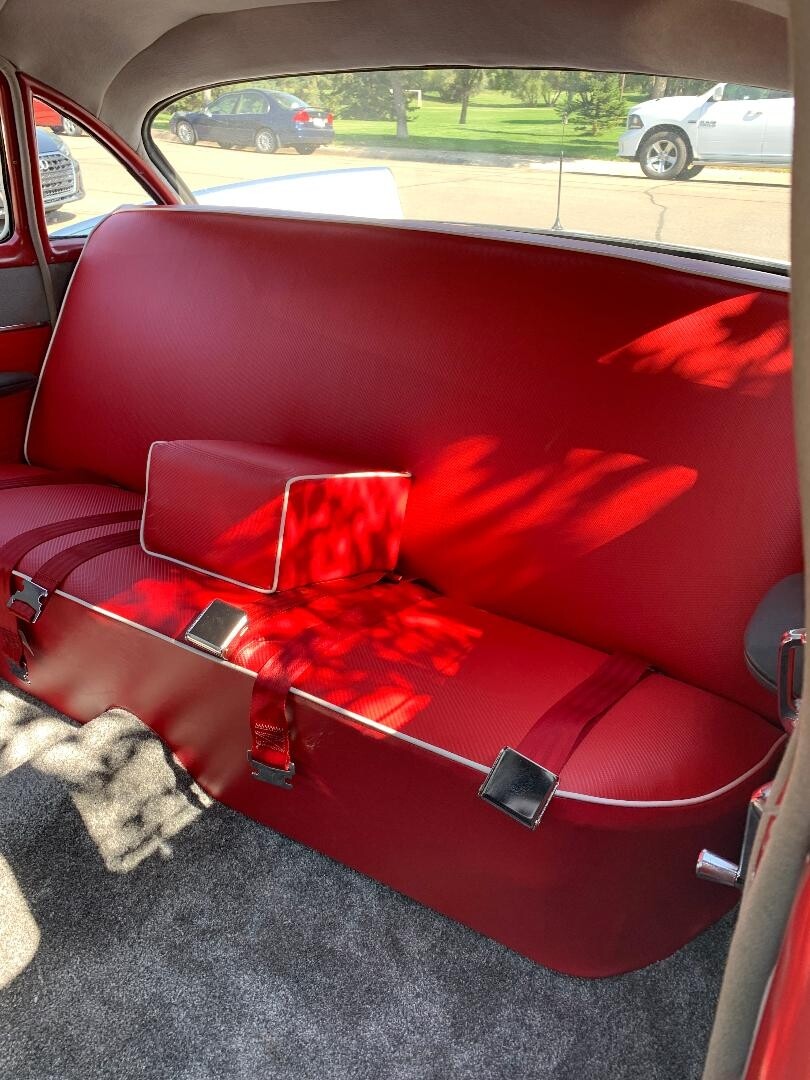

…and put the back seat in. it’s a red carbon fiber vinyl weave kinda look. Arm rest is removable for 3 passengers front and back.
How I installed the rear belts without a helper! 8^)

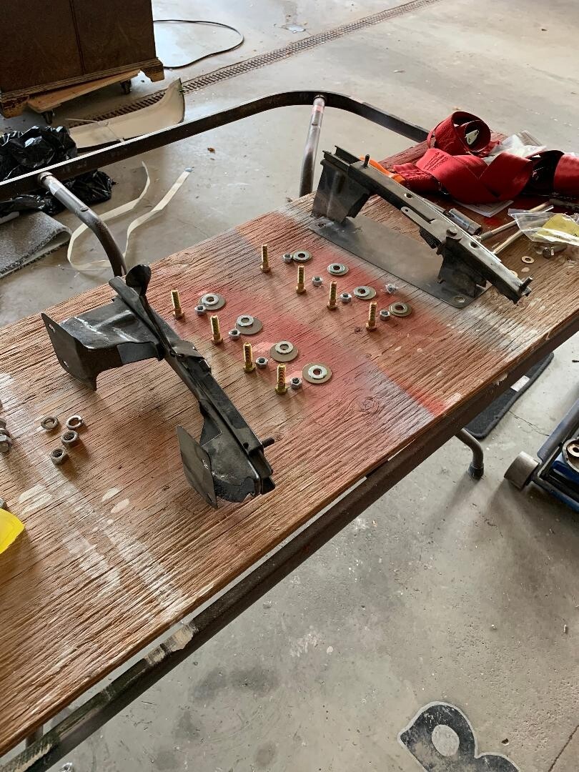

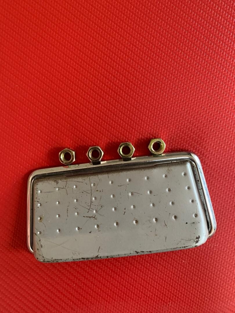

I’m amazed the only thing holding the front seat in the car is 4 5/16 fine thread nuts!
Couldn’t finish fabricating the pass front seat bracket without installing the seat in place and tacking the rt. bracket before removing and finishing it up.

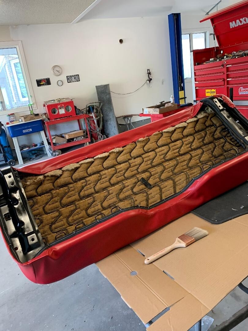

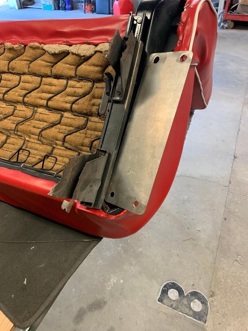

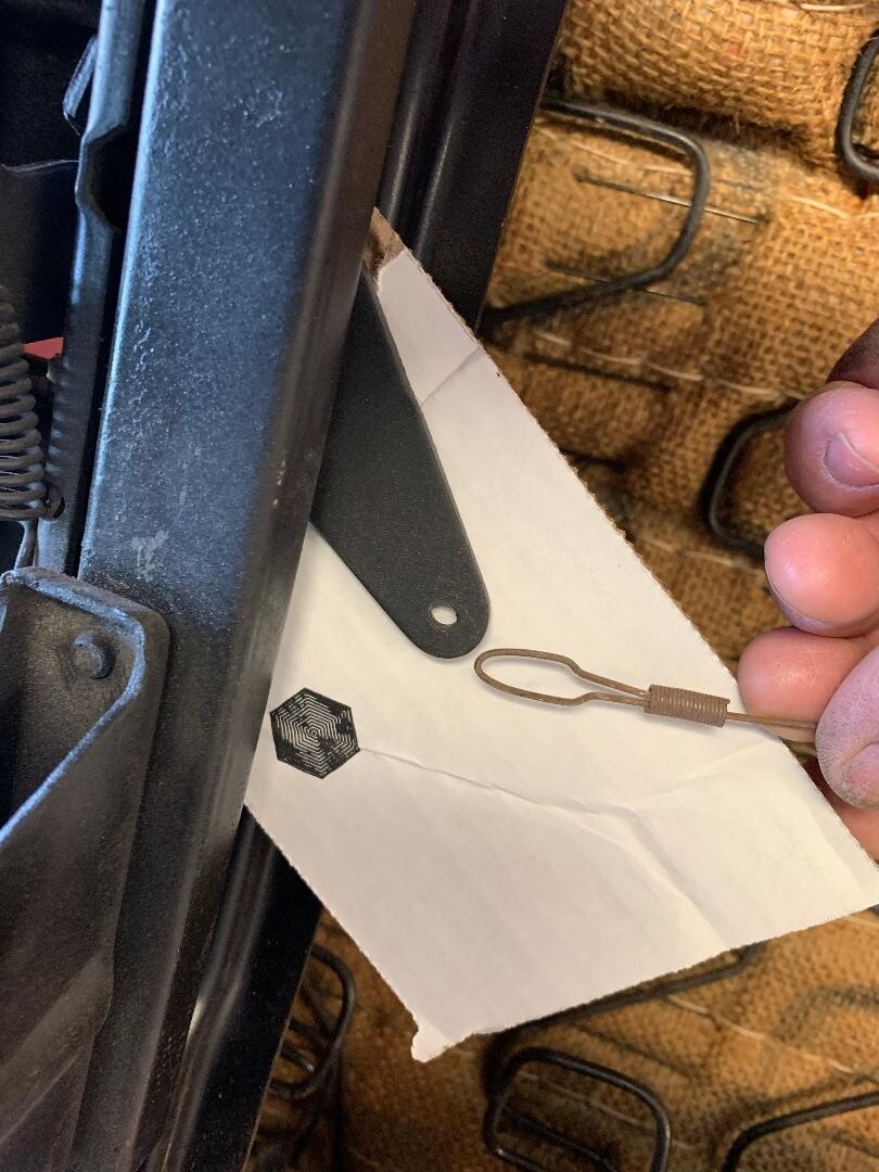

I can’t find a Ziploc bag labeled front seat, so have no idea how the cable for fore and aft adjustment attaches.

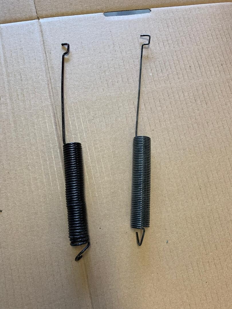

…and I have these 2 large mystery springs. One was way overextended and I had to heat it up and collapse it back in shape. Where do they go?
[I weighed in at this point: "[Here’s where the springs go](Faulkner gets a Redo - #707 by Faulkner Gary. The cable for the seat adjustment threads through that black clip in your second pic; I don’t have a pic to show where it attaches on the passenger side, but I’m sure you’ll figure that out.) -Dan]
