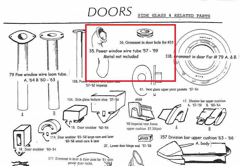

Has anyone had success with Gary’s rubber door wire tubing? I have a pair of tubes - I’m thinking, this is the time to pull the wires back into the passenger compartment, and install them with the wiring after the car is painted.
My grommets are still there, but the original tubing is split in places. I could remove everything now - I also have Vincent Van Humbeeck’s door switch housings to install after I reinstall the wires in the door.
How do the tubes stay on the grommet - does the grommet actually fit inside the tubing, and you insert the tubing inside the hole where the grommet holds it in place? Anyone have pix?

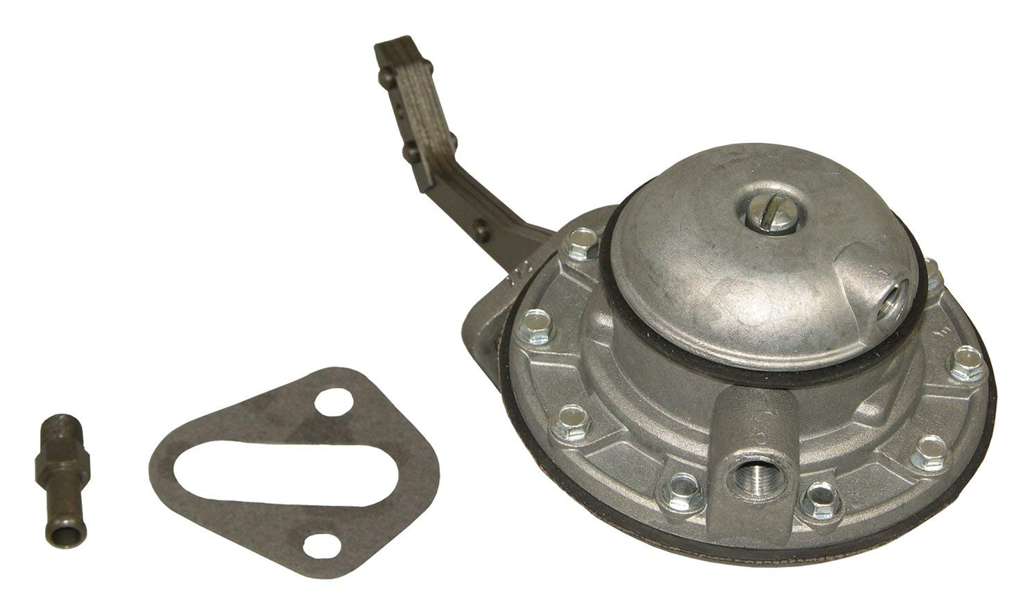

I ordered an Airtex 711 fuel pump from Amazon - 10 bucks cheaper than Rock Auto, and free shipping! You gotta love Amazon Prime…

Dick, did you replace these?
No, don’t have power windows. We have those grommets at ACE, the grommets and tubing is to prevent chaffing of the wires. A black thin wall rubber tubing like shrink tubing or split spiral tubing might work.
I have the tubing from Gary. I’m just wondering what keeps them from pulling away from the grommet - my guess is that the grommet goes inside the tube, you snap the grommet into place, and compression keeps it from pulling out. Conjecture on my part, I guess I’ll find out when I take it apart.

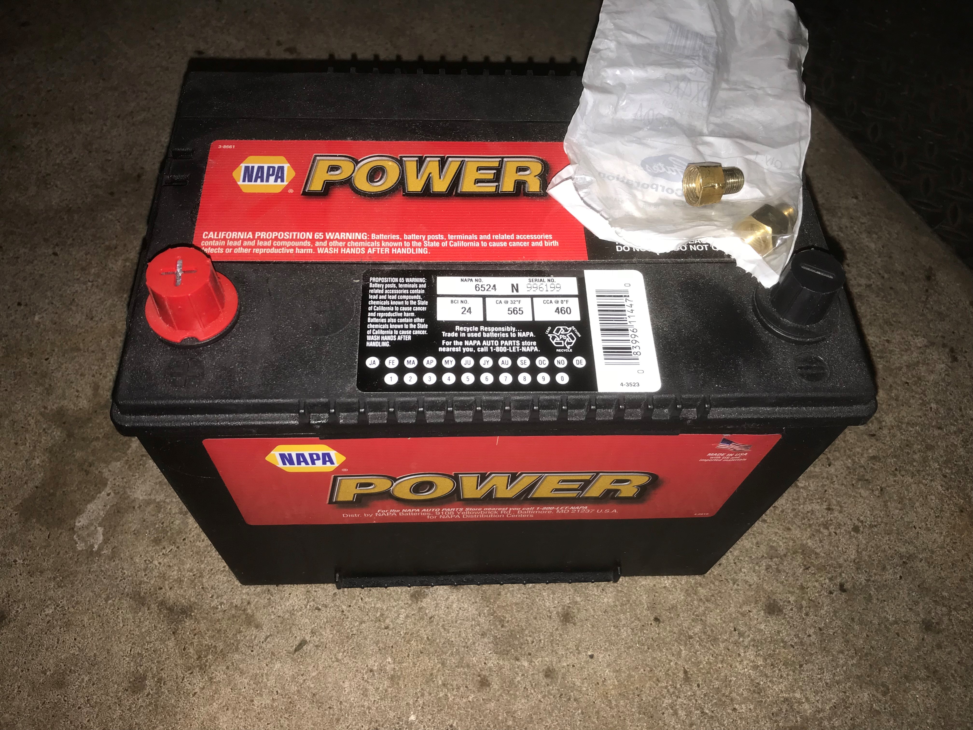

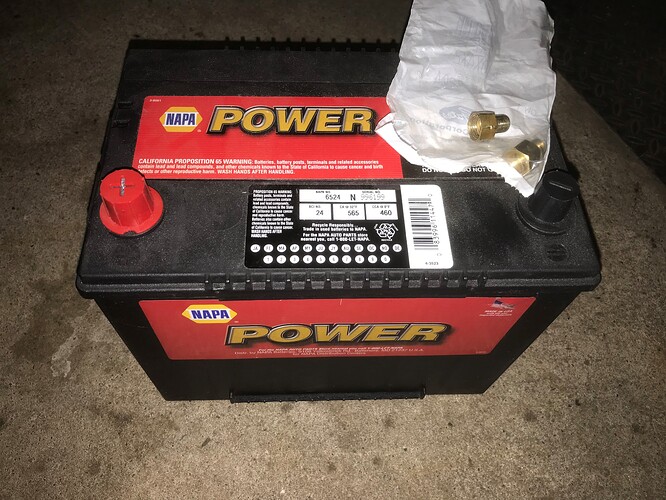

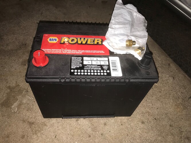

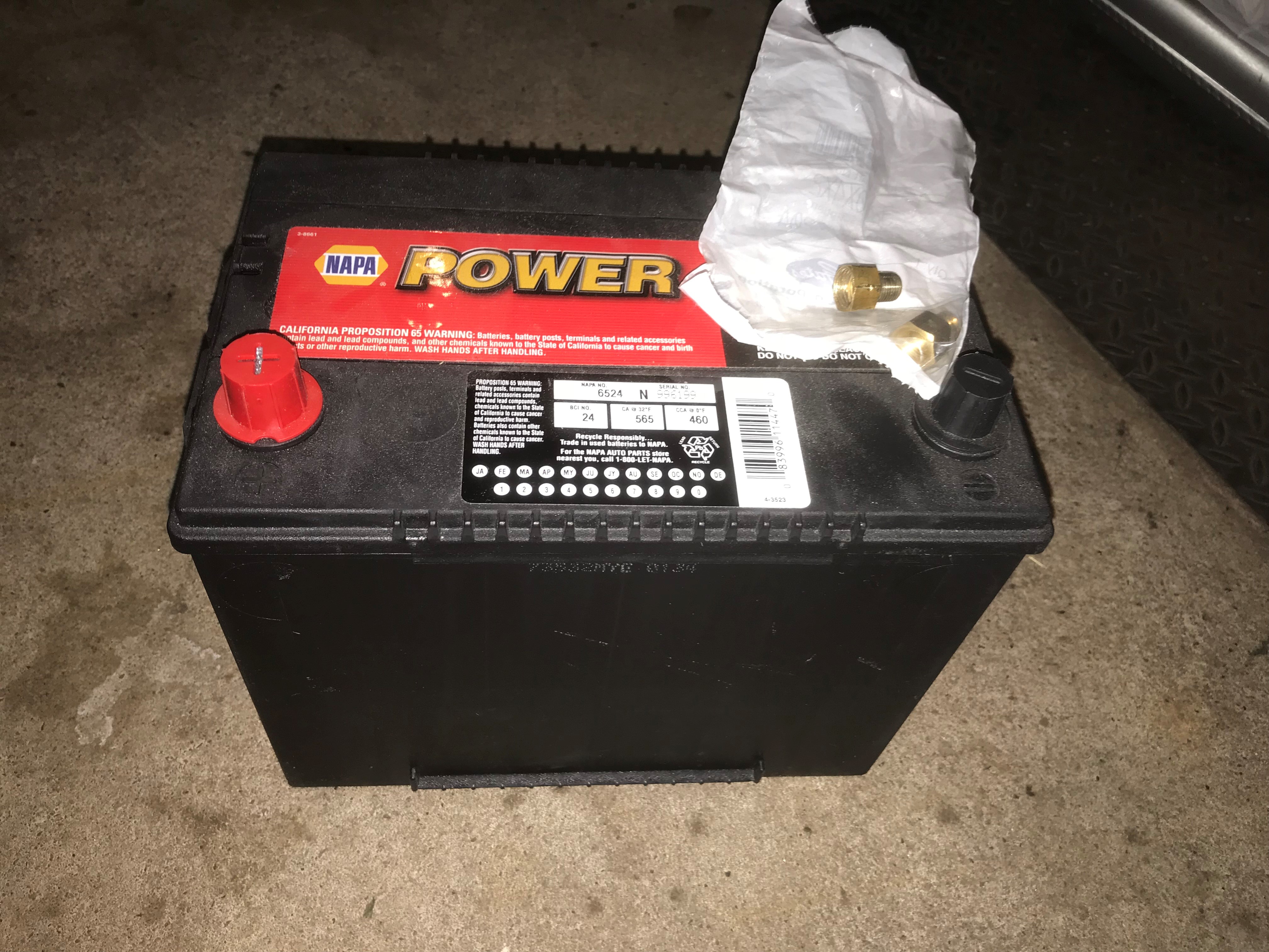

Rushed at the end of the workday to get to NAPA before they close at 6 - and after rummaging around, the guy behind the counter found the exact right brass fitting for the fuel filter. And as luck would have it, NAPA was running a 20% off sale - a perfect time to buy a flat top group 24 battery! Better yet - the fitting was free, he couldn’t find the SKU in the computer.

Just waiting on the fuel pump now.
