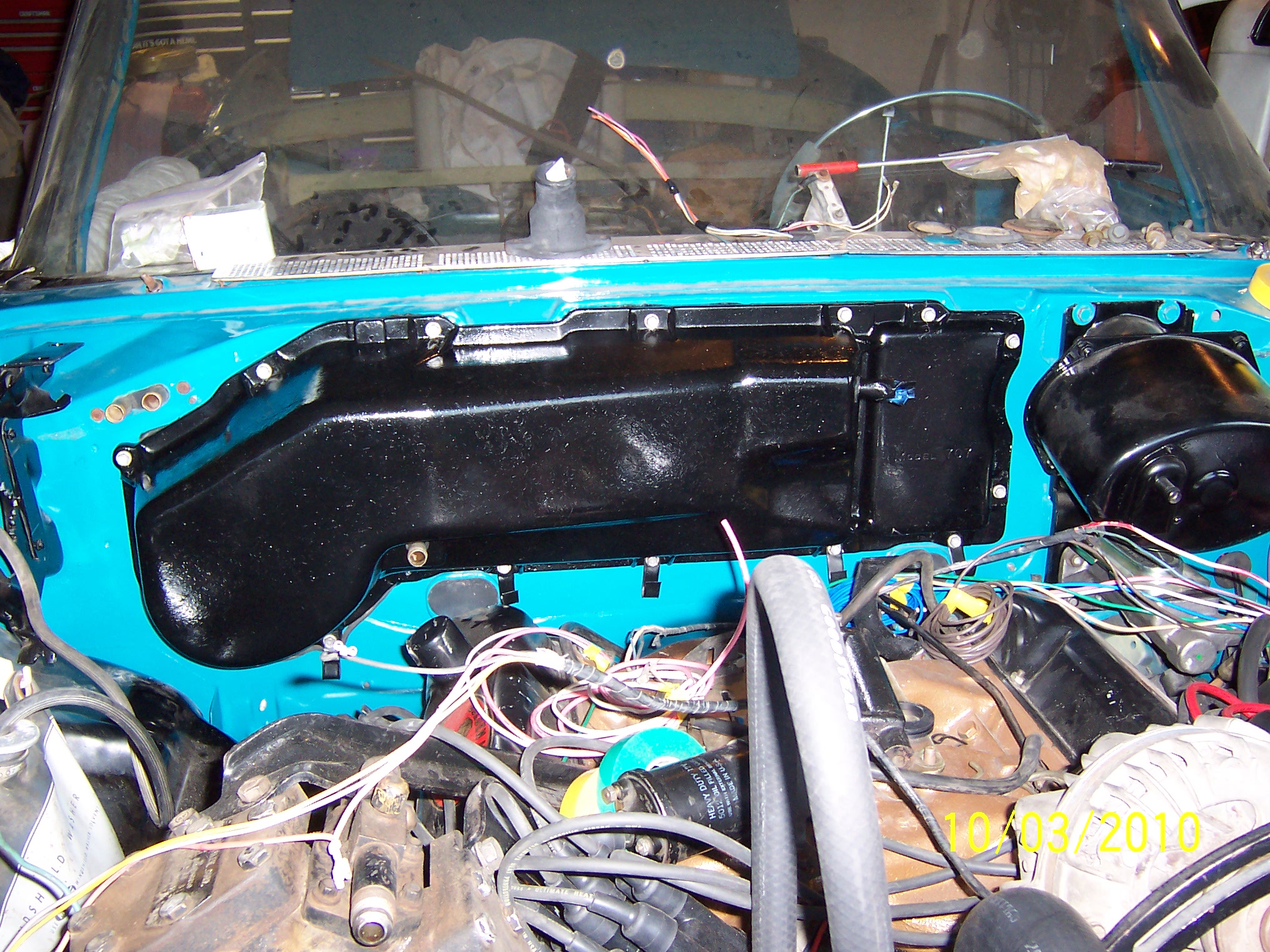

Never wanting to be 2nd best to Dick (though I am destined to be!) I upgraded by engine compartment Heater housing with “Dick Koch approved black paint”.
Hmmmm? Dick’s still looks better! :astonished:
Thanks for the tip on the paint Mr. Koch!
Ain’t nuttin wroung wid dat. (Saints talk). I will take a look at my parts car, I think I may have the wiper knob and bezel.
With the two of you going at your restorations full-bore, a question comes to mind:
How will you deal with the car’s exposed nuts and bolts? I see the bright bolts holding John’s heater box to the firewall…
With my car, I sandblasted, then painted the raw metal, as opposed to having them all plated with cadmium or what-have-you.
This method did not last for more than a few years, as the Keijs will soon discover.
I also took some short-cuts with the sheetmetal, specifically the headlight buckets, and front “pan” (above the airscoop), thus, in time, the surface rust re-appeared..I did not have access to, nor the talent to use, a paint sprayer. And POR-15 was not in the budget!
Hey Roger, the bolts I used on the heater box were media blasted in my work bench media blaster and then painted a Eastwood detail color (can’t remember which shade) and then I clear coated them. Hopefully, they should hold up pretty good in the elements. POR-15 is expensive at $45 a quart and I am on my 4th quart. but time will tell how it will hold up. From all the testimonials I have heard it should do well.
