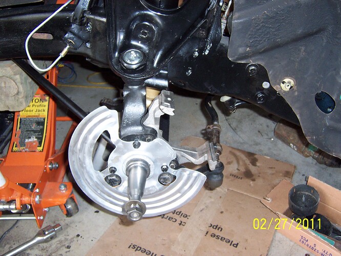

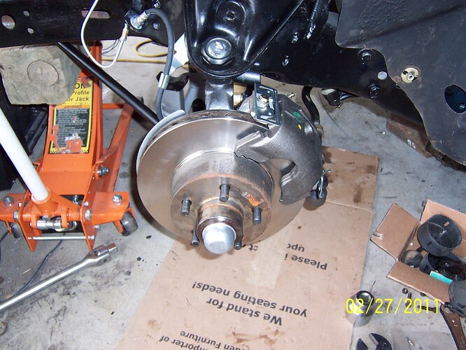

As some of you have seen in the Mini-Chat area (where I have been using it as a mini-Twitter reporting) I have been working on converting the front drum brakes over to 1978 F body (Aspen/Volare) spindles. Wanting to keep my Convertible as Mopar as possible I tried to use these F body spindles/Caliper brackets that a gentleman on the Forward Look Site (and Ebay (Tuckyman is his handle )says he used on a 57 & 58 Plymouth.
I have done a couple of these conversions on e bodies and B bodies with good results using 73 -75 Abody parts and late 80’s M body parts. Nothing wrong with AAJ conversions but wanted to keep it Mopar-ish.
Here are some pic’s of the work and the final configuration.
Parts I used were:
Spindles & Disc Brake Brackets $150
New rotors w/o bearings $40
Inner and outer bearings/races two sets & dust seals, $120
rear brake proportioning valve, $48 (not needed but wanted to dial it in correctly, front to back)
New flexible hoses, qty 2, $35
New can of wheel bearing grease $12
A body dual reservoir Master Cylinder, $65
One short section of brake line from MC to proportioning device, $15
Disc brake pads, two sets $40
Total $525
Now, I also choose to get new upper and lower Ball joints, upper control arm bushings and outer tire rods but that was an elective choice since I had those parts off for the conversion and it was best to do the swap out now while it was disassembled already. Those costs are not figured in to the above.
Total

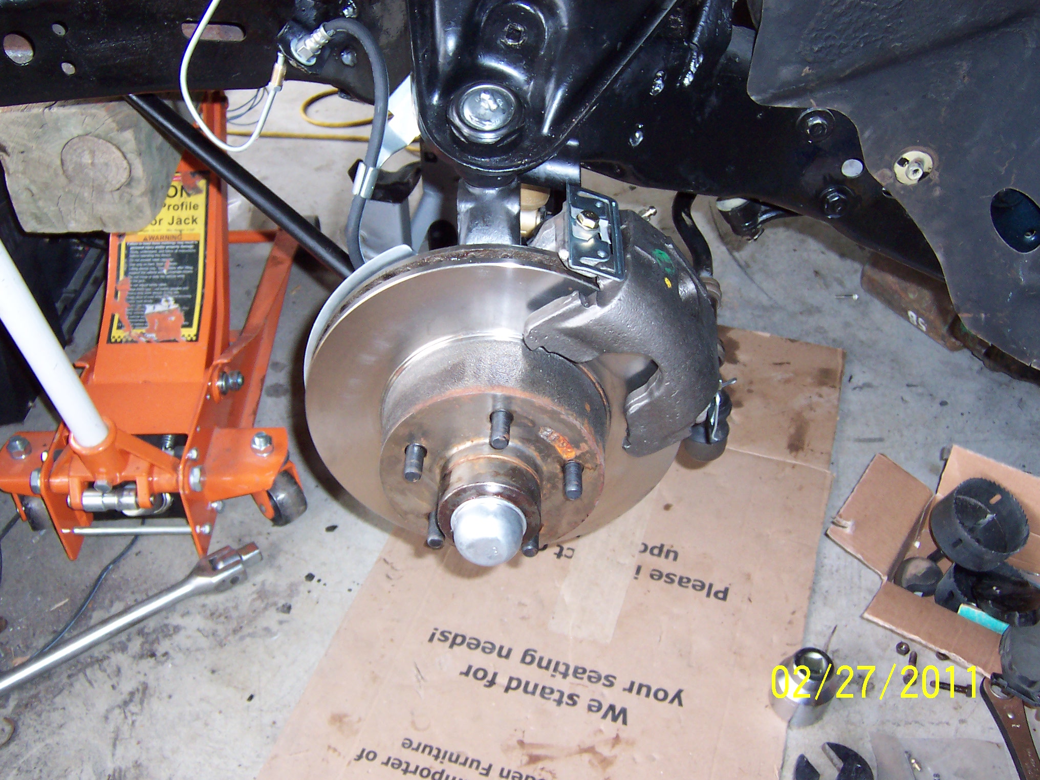

Already took the old drum & spindle off and had new upper and lower ball joints and upper control arm busings installed.

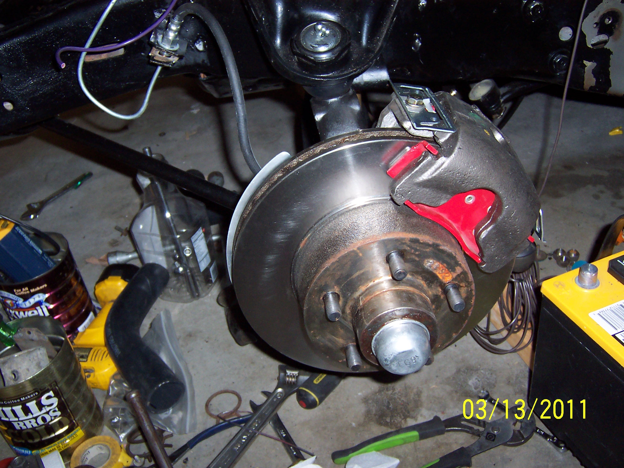

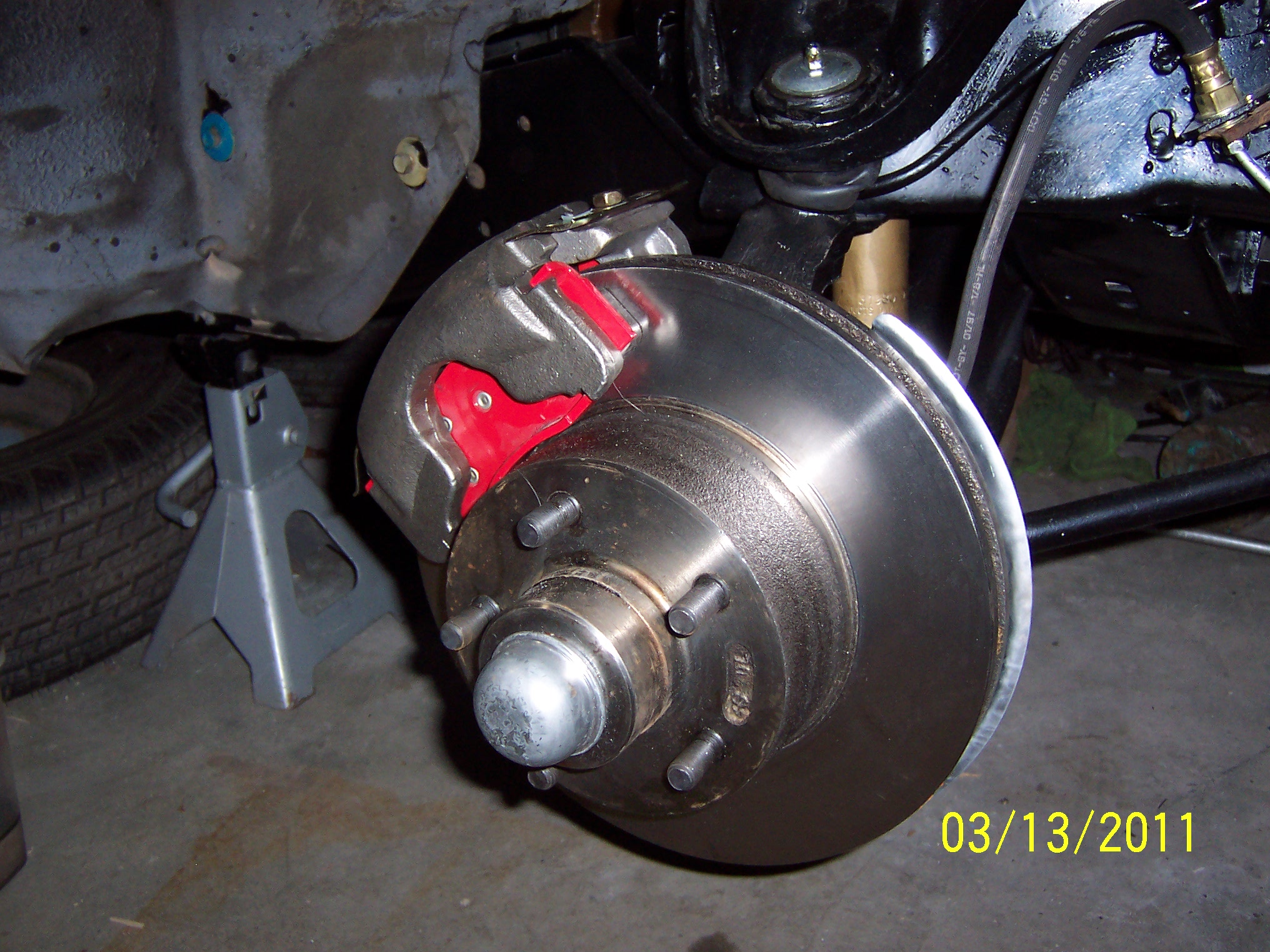

almost done but realise I did not buy brake pads yet, ran to Autozone and picked up some pretty red ones!
Passenger side, Took caliper off and installed pads. Stops better with pads! Duh!
Drives side, Looking good!

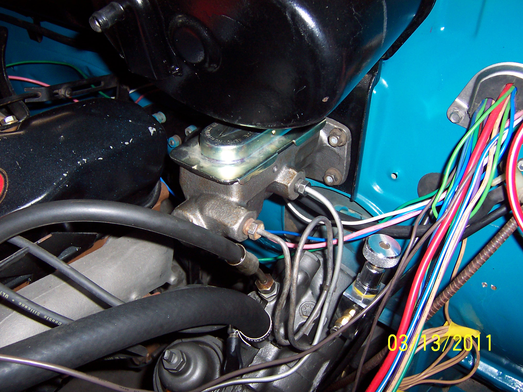

A body master dual cylinder with seperate rear porportioning device for finer tuning Front to rear braking, not needed but…

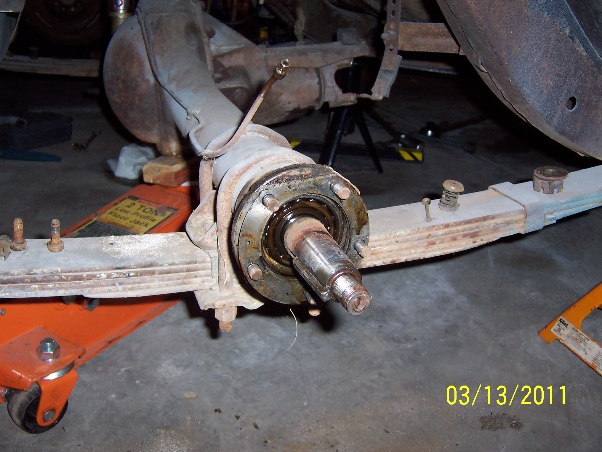

Continuing on this saga…I then tried to bleed the brake system yesterday and found that both rear brake wheel cylinders were corroded shut and could not get a drop of Brake fluid out of it thru the bleeder valve.
Put in a call to Mopar Rick (Rick Clapham) and he graciously loaned me his rear drum puller. Rick lives 15 mins from me and picked it up from his milkbox since he was heading out with his granddaughter to the Zoo.
Drums came off in 20 mins, With the right tools anything is possible! Cob webs galore and slightly crusty. Removed the corroded cylinders and brake shores etc from both assemblies, Ordered new cylinders from Autozone, be in on Tuesday.
Dropped off drums for turning at the local Car Quest Auto parts (they have the lathe) and was able to pick the turned drums up today.
Now, big problem, Napa, Car Quest and Autozone had no sources for the rear brake shoes. They are on E bay but will take a while to get here. Thought about a place in South Denver that deals in old auto store parts and today went there with my old corroded shoes and he says he has new re-lined NORS on the shelf, many pairs to be exact, So for $55.00 I have both sets of brand new relined brake shoes! Hot Damn!
Just need the wheel cylinders and I can re-assemble the rear brakes and go back to the bleeding procedure. Once done then I can put on the fenders and hood and terminate the headlight and park lights. Not saying it is fire up time, but with a couple detours…I am getting closer!

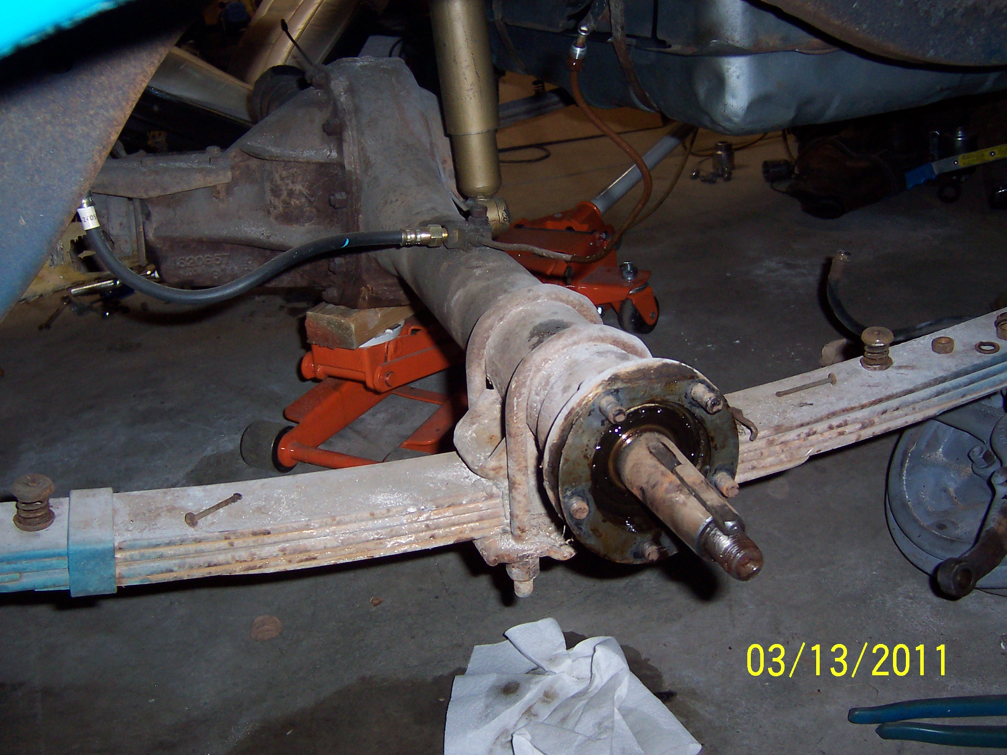

Here is a few pics of the rear axle area all disassembled. I turned up the axle brake lines to keep the fluid from leaking out to much, I only have so much kitty liter you know!
pasenger side view
drivers side view

From your post, I get the feeling you were not really thinking about the rear axle and its parts. I rebuilt my brakes all around (although Matthew will tell you I did not replace steel lines which SEEMED okay), and a few years later one line’s internal rust ruined the new wheel cylinder, I lost brakes and almost wrecked the car.
Neither did I replace rear axle seals or driveline parts, as a result I carried that on my list of worries which made it difficult to fully enjoy the car.
just sayin’… :frowning:
John - Great work, I did AAJ discs on Reddie back in “02”. Rogers right you know, everywhere you go you’ll be thinking “I should have listened to Roger”
Just sayin,
Well, you are all right! The only brake lines that I have not done so far on the car is the 2 transverse rear axle lines. When I pick up the wheel cylinders today I will pick up the two brake lines that make that part up and swapped them out.
Now all the lines and cylinders would be spanking fresh with no residual corrosion in the lines. Good comment Team! :smiley:
I will see if I can pick up the rear axle seals too!
