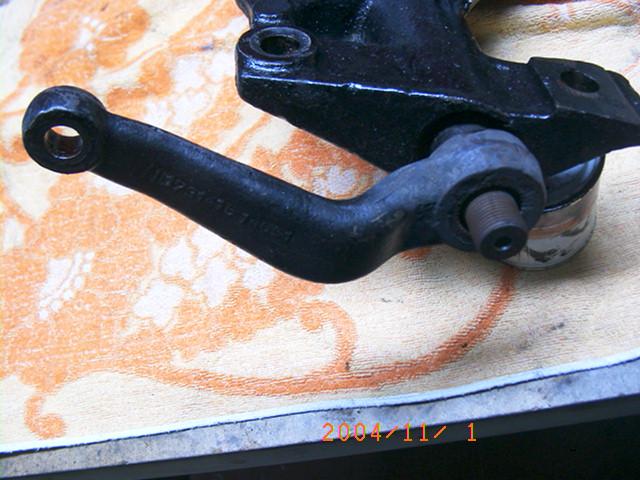

  4. Leaking PS Unit - I know a specialist in Portugal. (no kidding) If it’s leaking on the bottom seal, then it is very simply but may become very complicated. There is a big nut that holds the steering arm. Usually you can open the nut with a long torque wrench, but the steering arm may not want to come off and needs a lot WD 40 or even a puller and heat to pop off. DONT HAMMER THE SHAFT!!! If you come so far I’ll take pictures to show you how the rest is done. It’s very easy and doesn’t take mote than one hour, ok in your case one afternoon :smiling_imp: ! You get the seal from Napa or any good hardware store. I think I still have one in by garage. If you want I’ll take the size.
ATT: DO NOT remove or unbolt the PS-Unit to change the bottom seal!

So your car’s steering column seal leaks..ugh. My pump leaks. I’ve added all sorts of additives, changed fluids twice…I think I may finally have stopped it now using Lucas Sealer (Napa).

Hmmm… Hadn’t actually tried a sealer. Perhaps I should try that.

Regarding the sealer: That’s not a good idea Dan it will leak again. The seal has a purpose - do it once and do it right!
