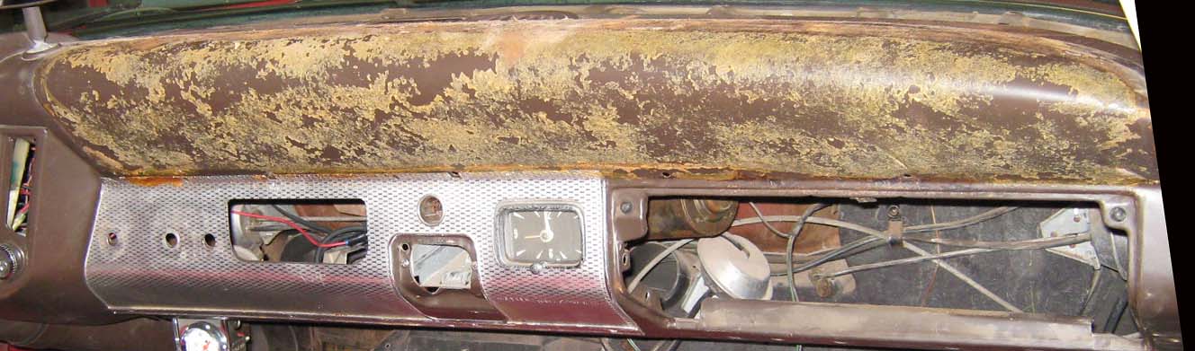

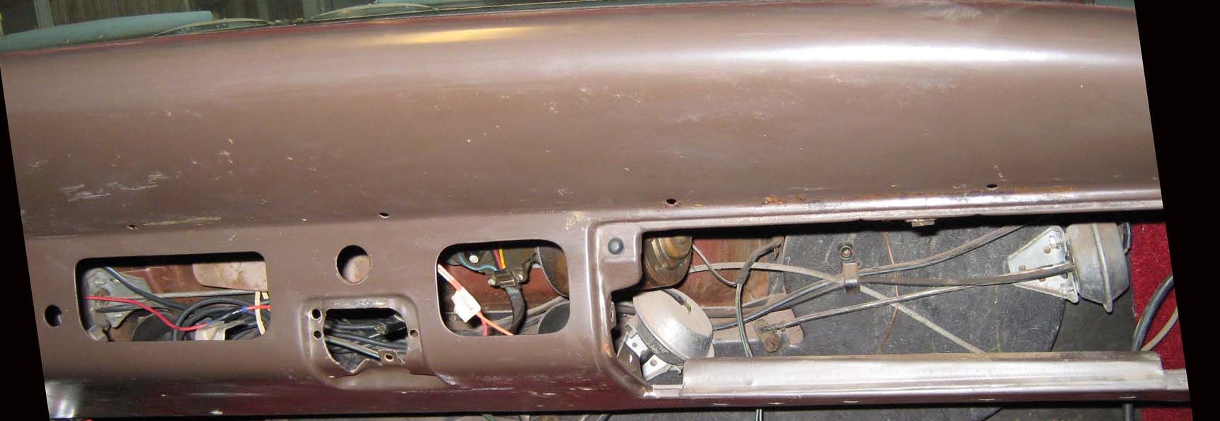

I find isopropyl alcohol to be useful for cleaning all sorts of things – including, recalcitrant Carlisle sticker gum on the windshield! But it was great at softening up the glue that held on the replacement makeshift dash pad. Here’s the before:
…and the after:
I used it to clean the whole dash. Next, to lightly sand, prep, and mask the dash for painting.

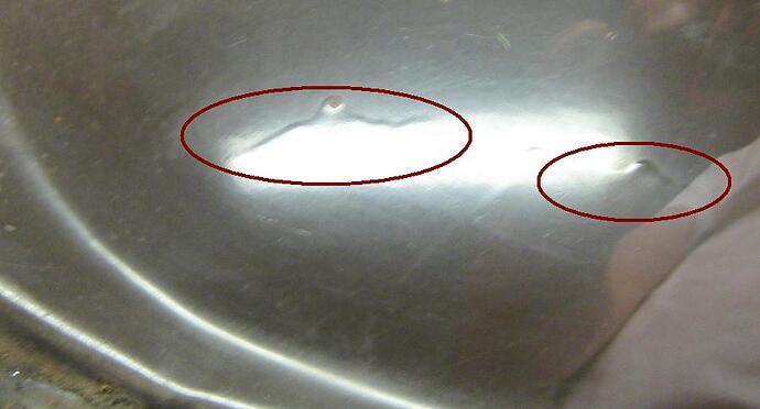

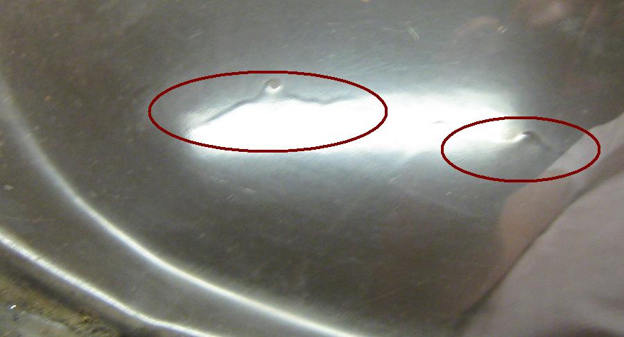

Here’s something I always found interesting about Faulkner:
It’s not a great pic, but you can see the runs in the original dash paint. Astute observers will note that the paint is running “up” – so this is a run while the dash was held vertically for painting with the driver’s side up. I guess it’s true what they say about MoPar quality control in those heady days – slap 'em together, get 'em on the showroom floor and sell, sell, sell!
Dan, The Dash is looking good! And happy B-Day too!
The dash cleaned up well. I Think you have a Monday build car or at least the dash was built on a Monday or a Friday before a 3 day weekend was always a sloppy, rush rush, lets get out of the plant day. Or at least it was when I worked in the Chrysler Stamping plant during my College days. I bet nothing has changed in the plant…
Are you going with the same color dash as you have now or something else in color?
The dash will be painted black, John – I have plastic prep and black plastic paint, too, for the vents and other plastic pieces. I sent my mounting strip to “Just Dashes” last week – I’ll be ordering a black dash pad to mount on it. I plan to sand out those runs – I’ll make good on a fifty year old quality defect! :laughing:

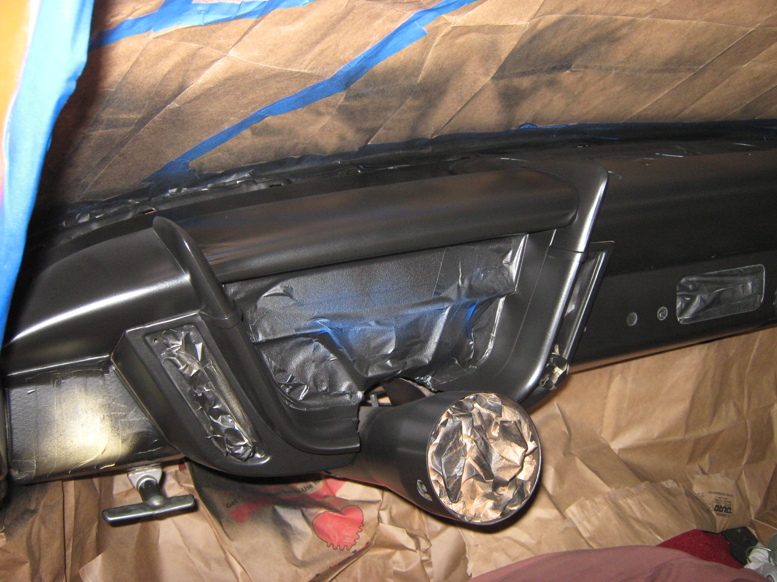

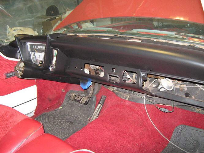

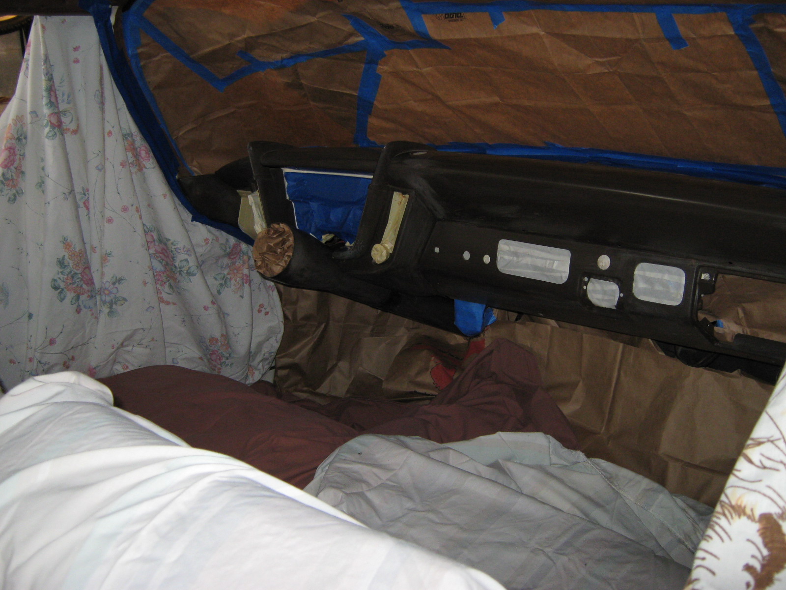

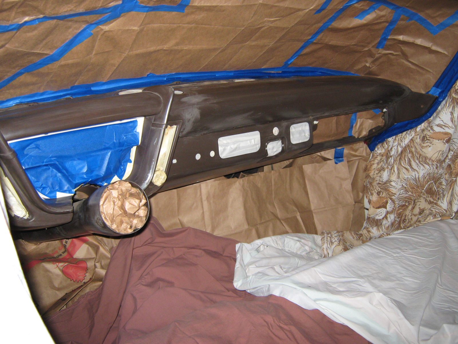

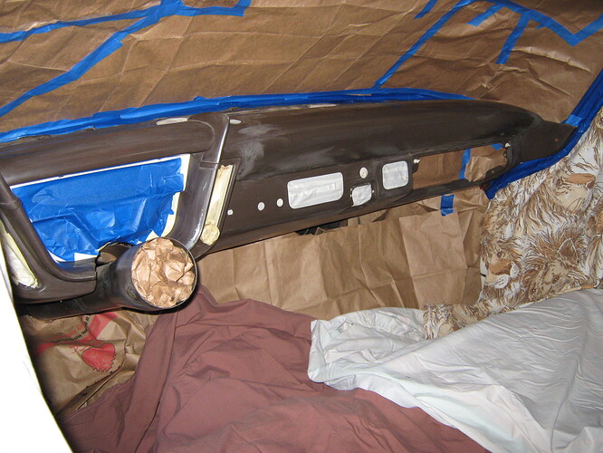

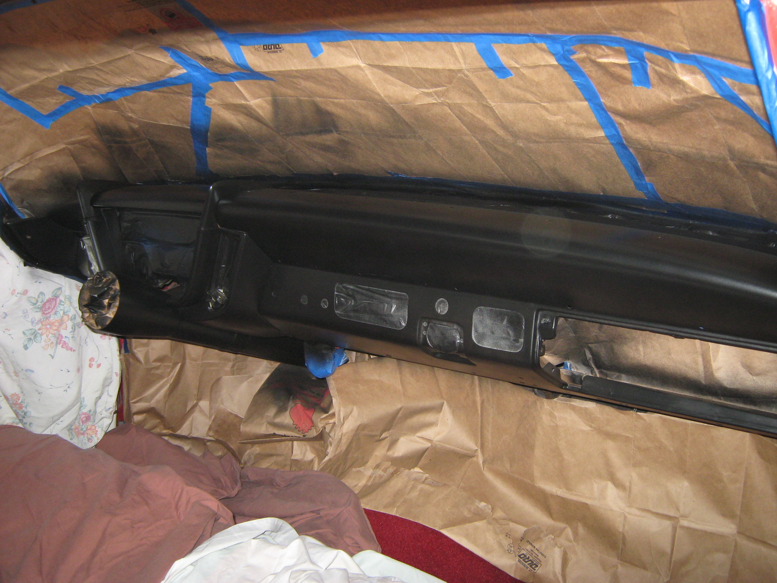

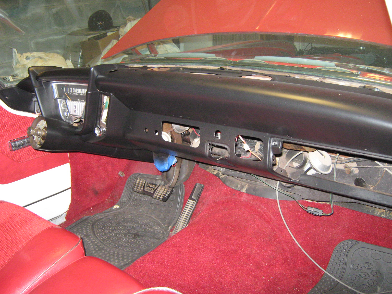

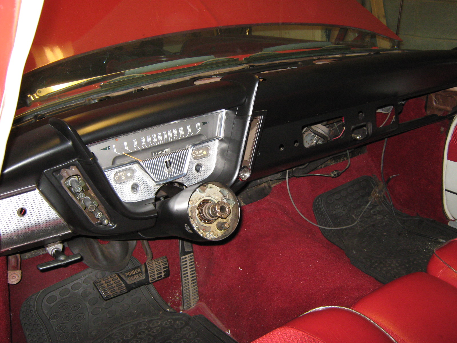

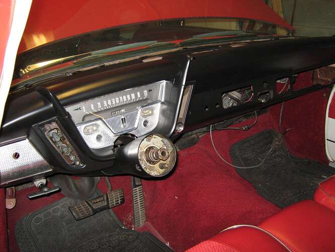

I finally got up the gumption to paint the dash. It didn’t come out too bad for TWSAM. Some before and after pix…
All dressed up and ready to go…
After the painting
masking tape removed
bravo!

Dan,
The dash looks great - mine was painted in-car as well. I must say your dash looks lonely without the glove box, mirror, radio, clock, ash tray, wipers, light switch and steering wheel. You have some work to get done before Carlisle!
