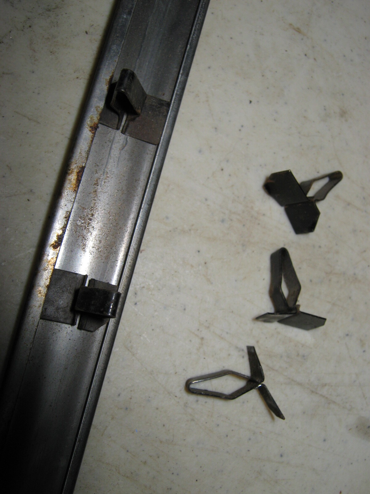

Anyway, there was an ugly brown Naugahyde dash pad(yes! Brown; those who have seen it may have thought it was black). To remove it, I popped the clips out for the chrome strip at the bottom lip. I popped 5 clips, 3 of which immediately fell out – two remained on the strip. But each remaining is mounted differently! What is the correct way? (The top of the strip is shown at the bottom in the picture):
Also – since I’m missing a clip – does anyone have an extra?

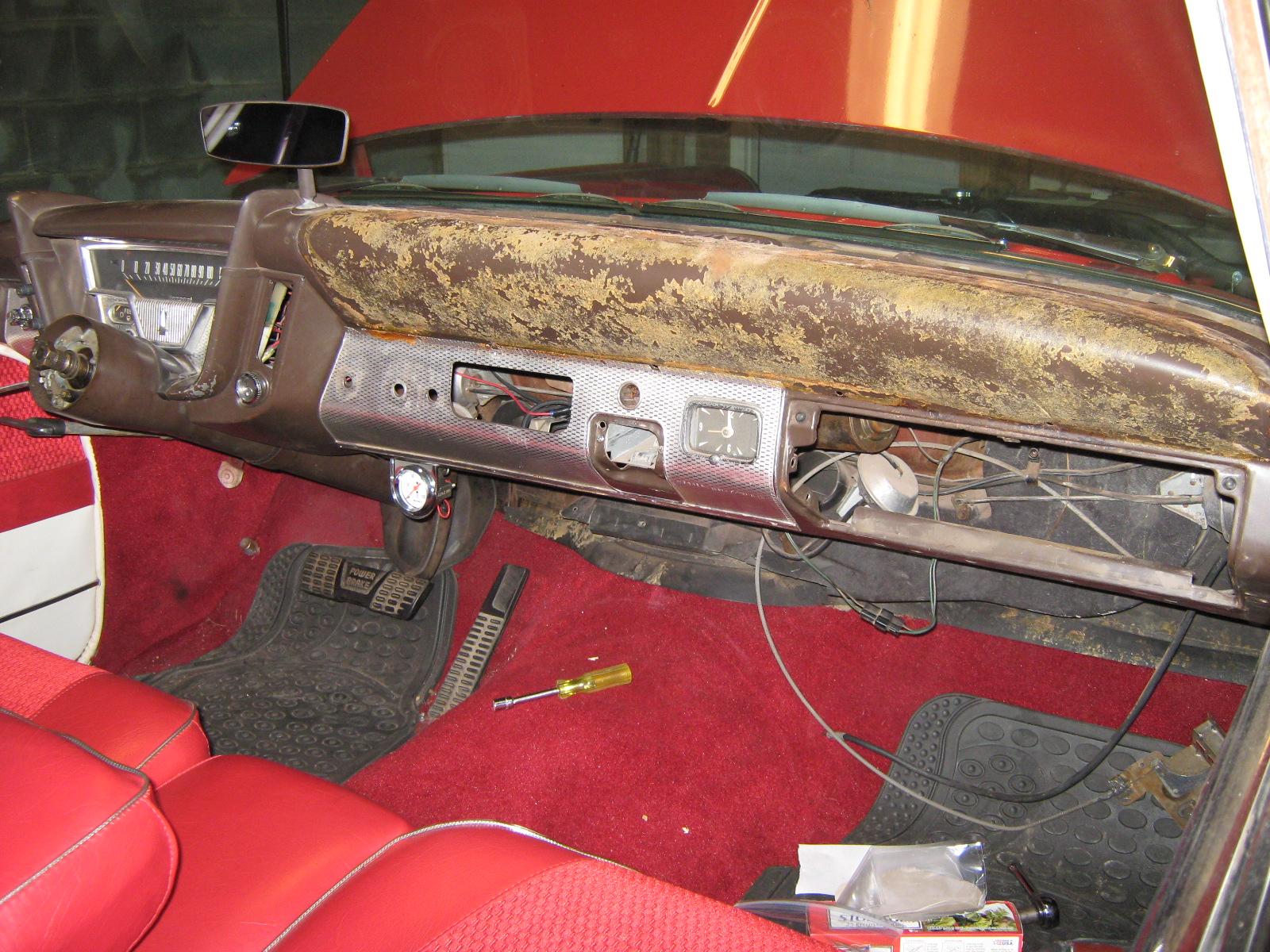

Here’s a pic of the interior now, partially disassembled:

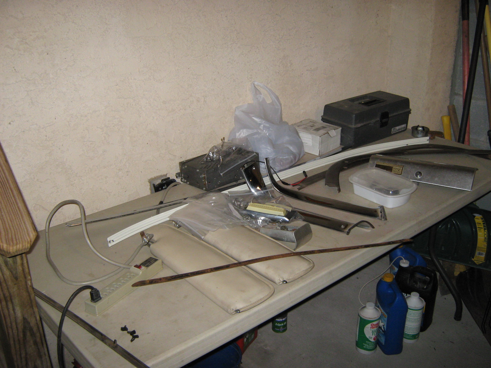

Lots of pieces parts!

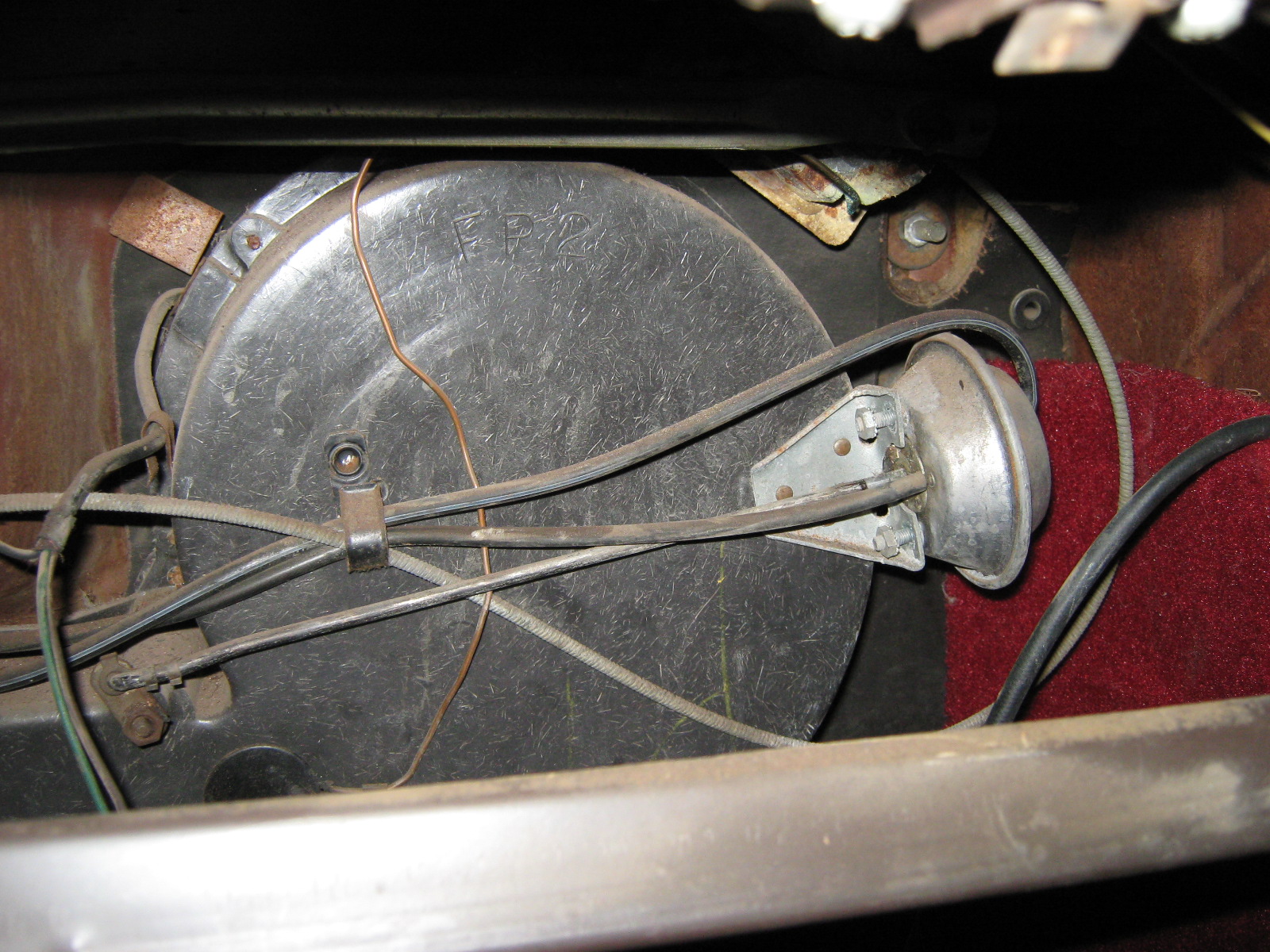

To get to the clips retaining the lower chrome lip of the dash pad, I removed my glove box. That kind of disintegrated in the process; guess it’s time to contact Gary Goers. In an attempt to drop it between the dash and the firewall, I removed one of the vacuum chambers for the heater – in the process of removing the vacuum tube from the unit, I managed to pull the nipple right out of the unit! It pops back in, I guess I’ll epoxy it; but I might be in the market for one of these too.

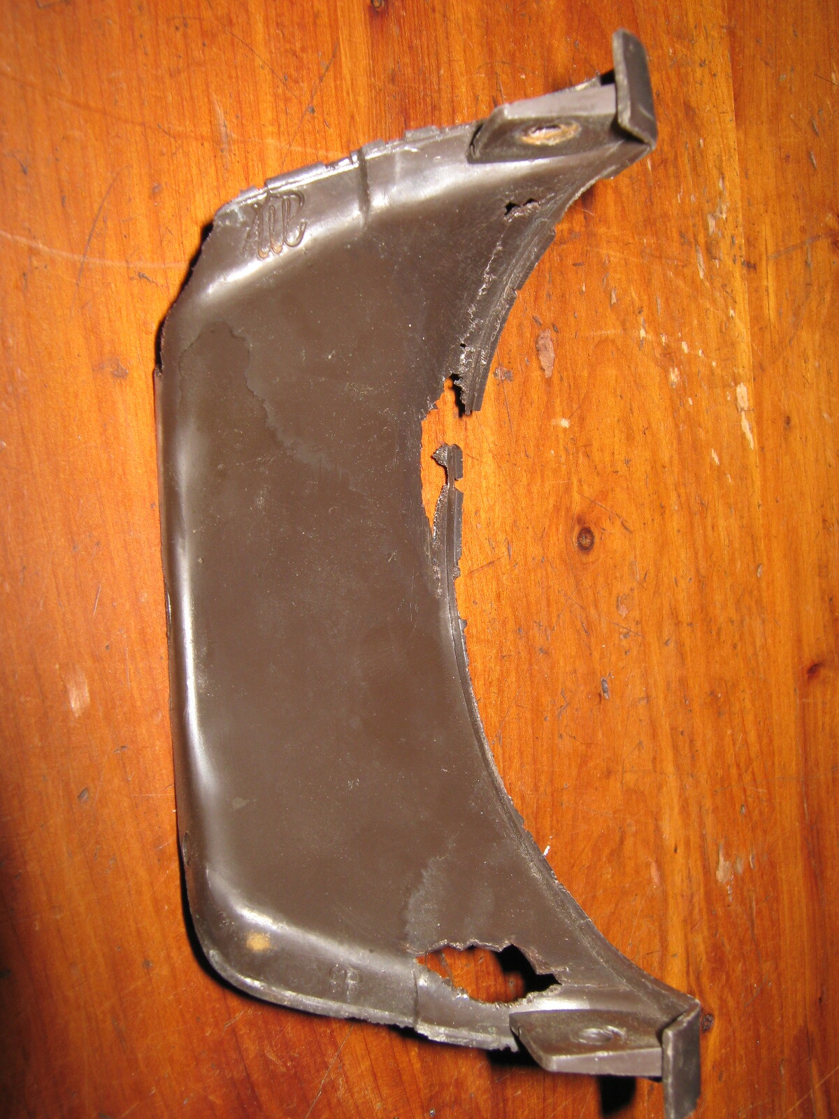

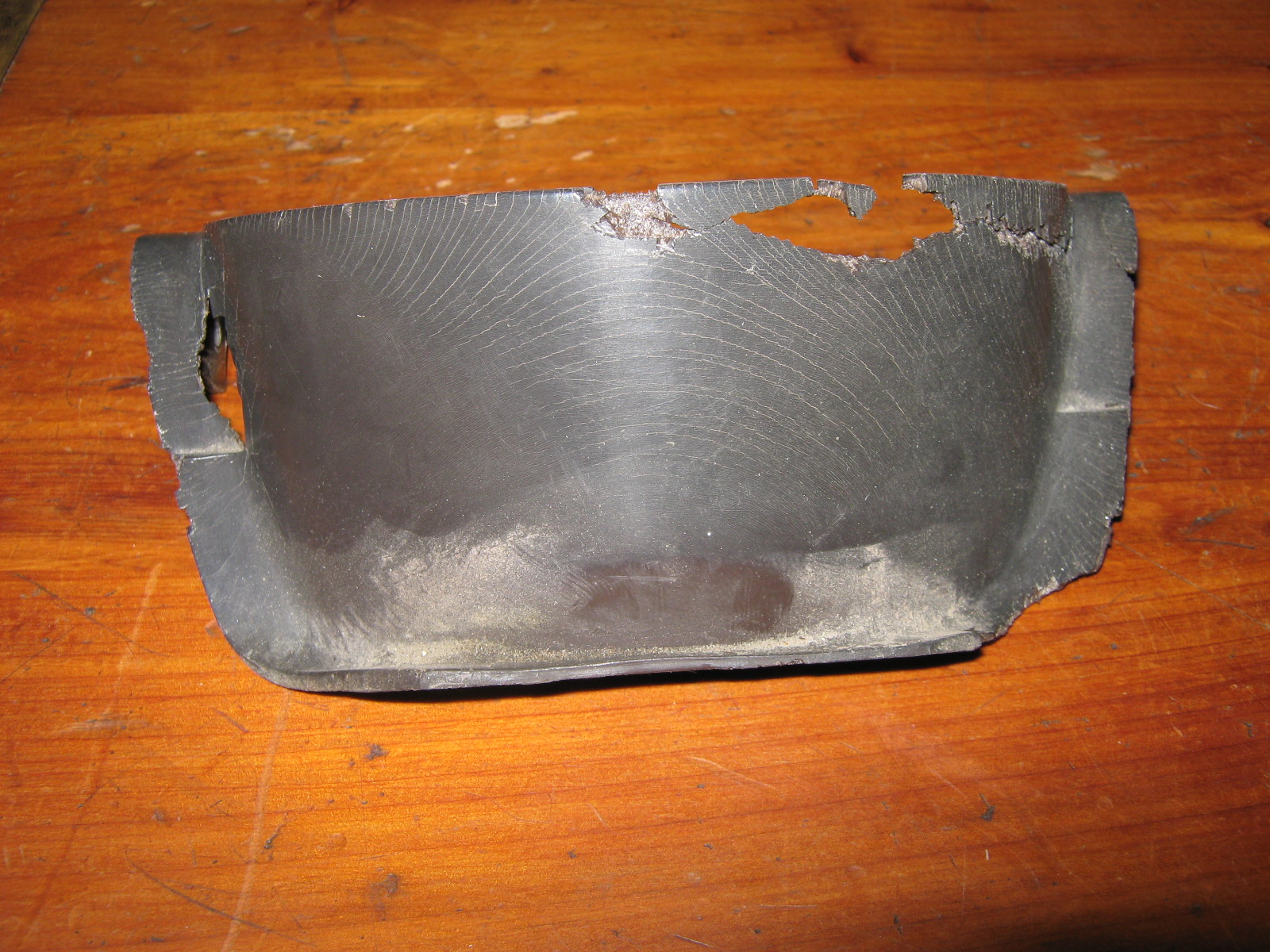

However, I’m going to be looking for a plastic cover for the steering column; mine is pretty well rotted from exposure to the Boise sun. Does anyone have one in better shape than this they’d consider selling? I suppose I could repair it with Bondo, but the results would be less than satisfactory…

Secretary :laughing: - anything else that you are missing? A Cuban cigar and a drink or so? The time you are thinking about taking the dashboard out is longer than it takes to remove it! It’s easy and you have already done ¾ of the work. Why quitting now? From what I see on the picture you can remove the hole dashboard in less than 1 hour.
  • Disconnect Battery (if you haven’t done it already)
  • Remove/disconnect the Clock,
  • Remove the mirror from behind (or you risk breaking it)
  • Disconnect push button cable and the speedometer cable
  • Remove the cluster (screws and bolts on purple arrow)
  • Remove the 2 piece trim under the windshield (blue arrow)
  • Then remove the screws underneath and ask Marie to hold it up
  • Then remove the side covers (both sides) (yellow arrow) Underneath is 1 big bolt on each side
  • Remove it and the dash comes out.
  • The cigarette lighter comes out when you remove the big sheet metal nut behind it.
When you install it again you should use these silicon bands that are used between the inner and outer fenders. That’s a good opportunity to get that glittering noises out.
