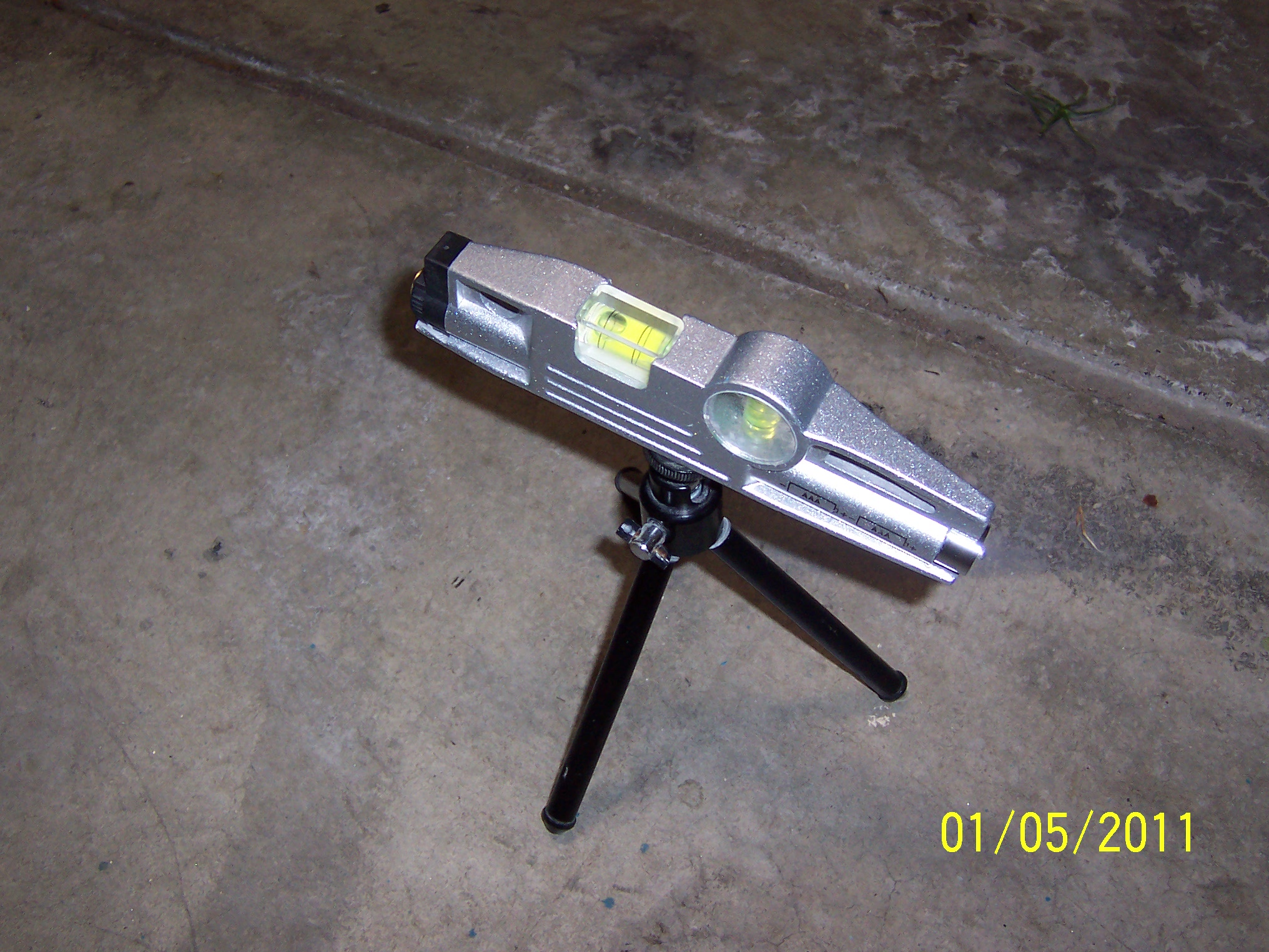

On my Belvy, I have marked the location of the Rocker molding holes using a Sears Tri-pod laser line (used it for the drilling of new molding holes in the SF and Fury Doors that are now on my car). ![]()
Really helps hold the horizontal measurement line to make sure all is in on the same plane.
Picture of laser device coming up in a few mins…

I did also find my Laser tri-pod device I was talking about to shoot a horizontal laser line on the 59’s rocker area. But the camera’s flash washes out the line when I take the picture of the red beam on the rocker. But it works!
Kinda a neat way of doing the layout. A carpenter’s chalk line would work too if you don’t have one of these.
Good for Rocker moulding alignment holes and chair molding rails in the house!
