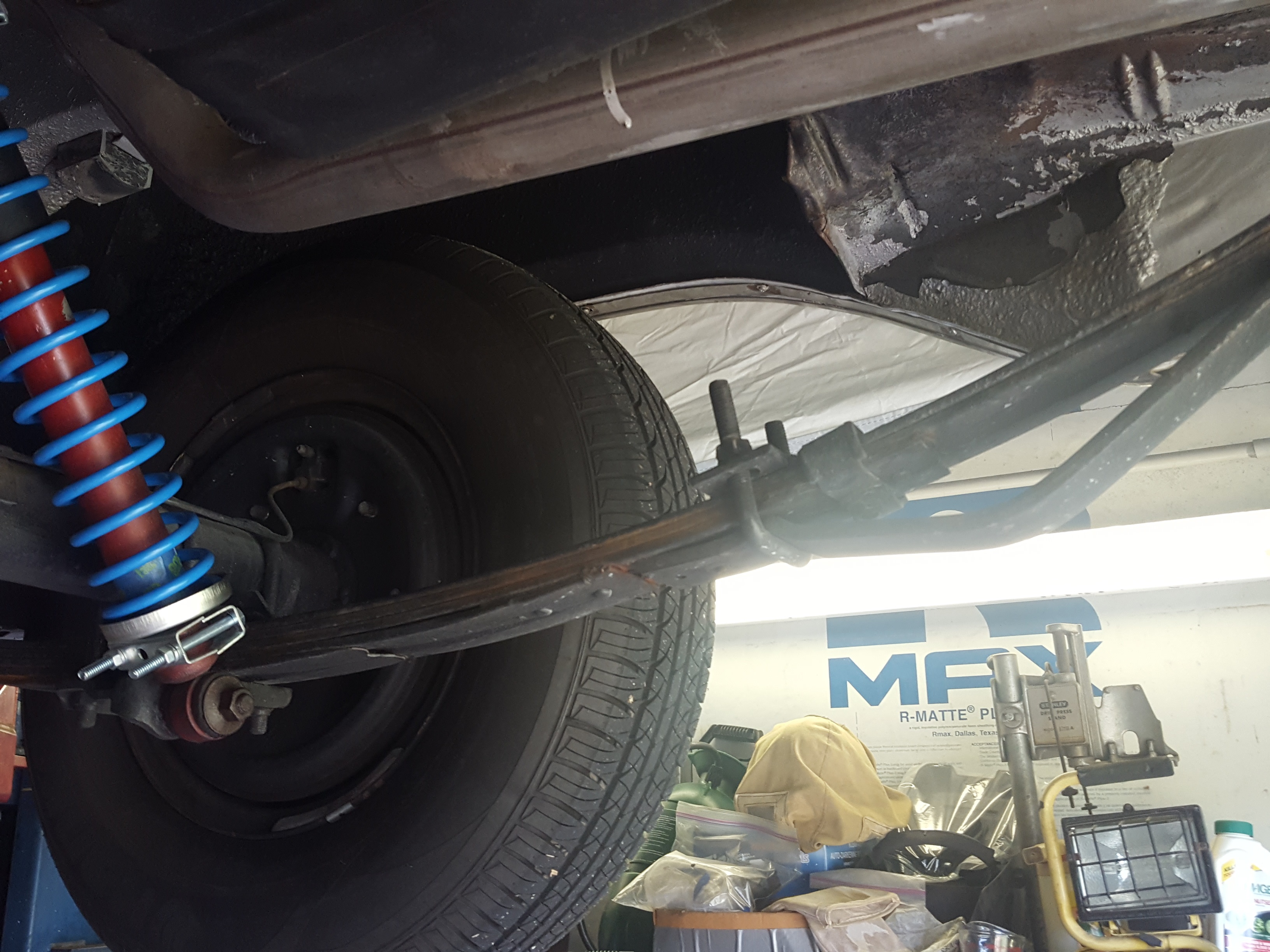

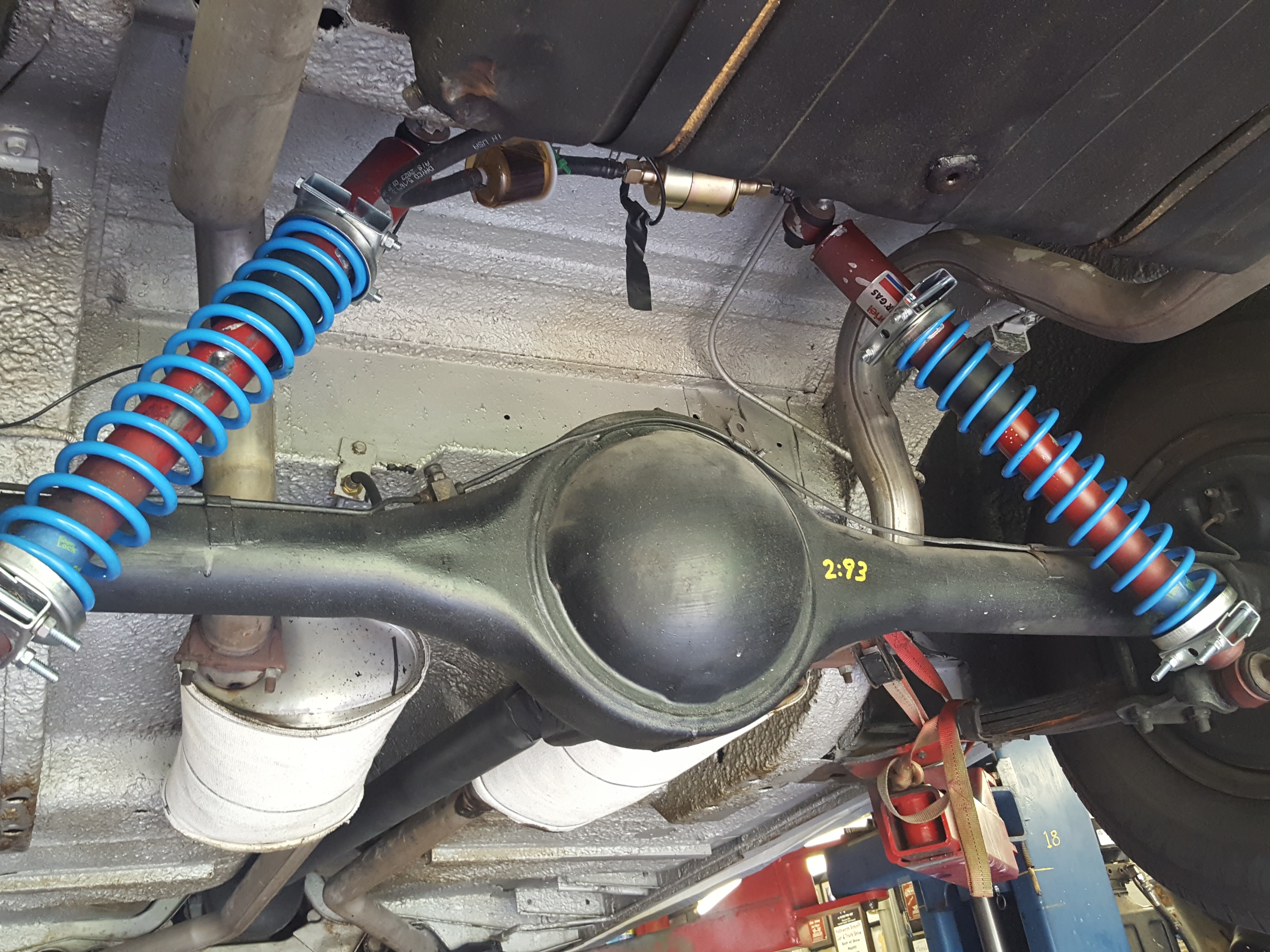

Thanks Dick for the information. I did not realize the springs could be purchased separately for existing shocks. I had already purchased the combination spring/shock and had them on the shelf for many months before I decided to install them along with my new leaf springs. My first task is to see if my wheels will clear present setup. If they do I am good to go. If they don’t then I will re-install last set of shocks and buy the separate
coil springs per your information. I am afraid I made the assumption when purchasing the combination shocks with springs that they would extend out to same length as originals. Thanks - it is good to know there is an alternative.
