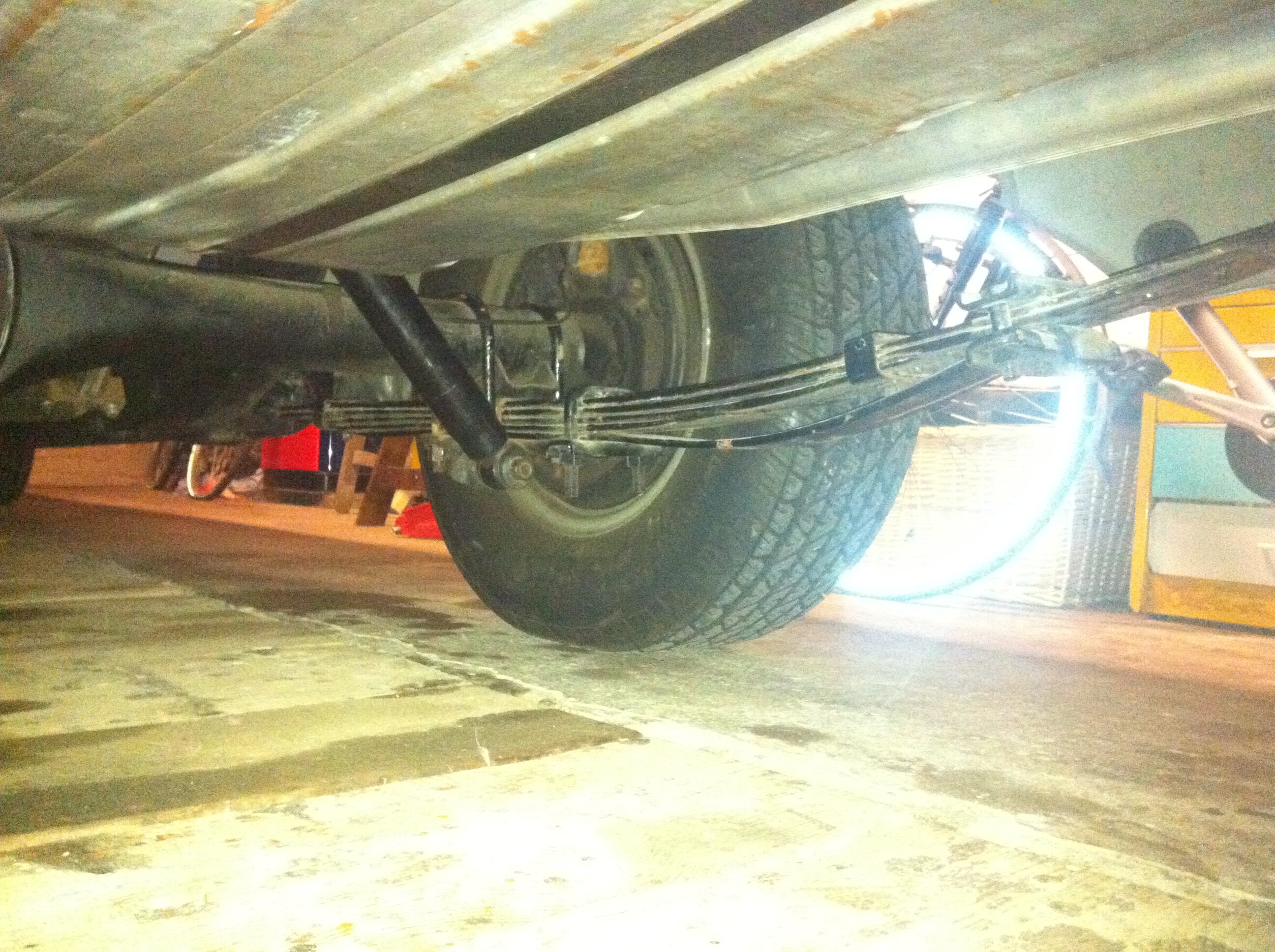

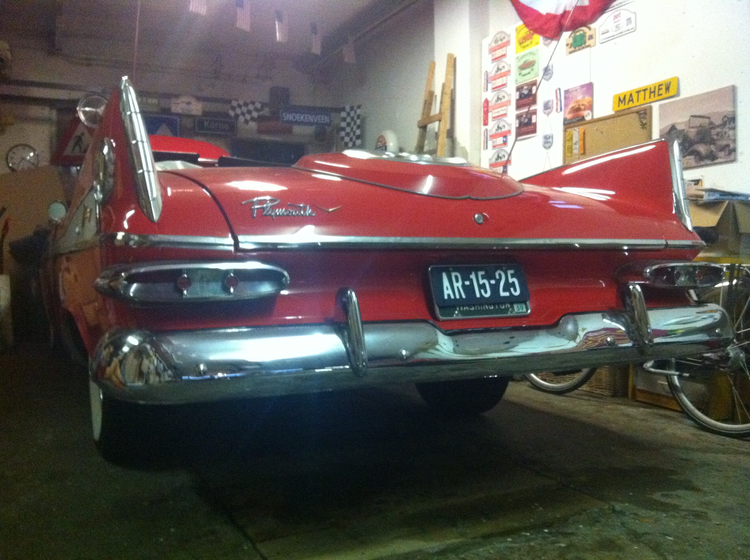

Ok, here are some pics

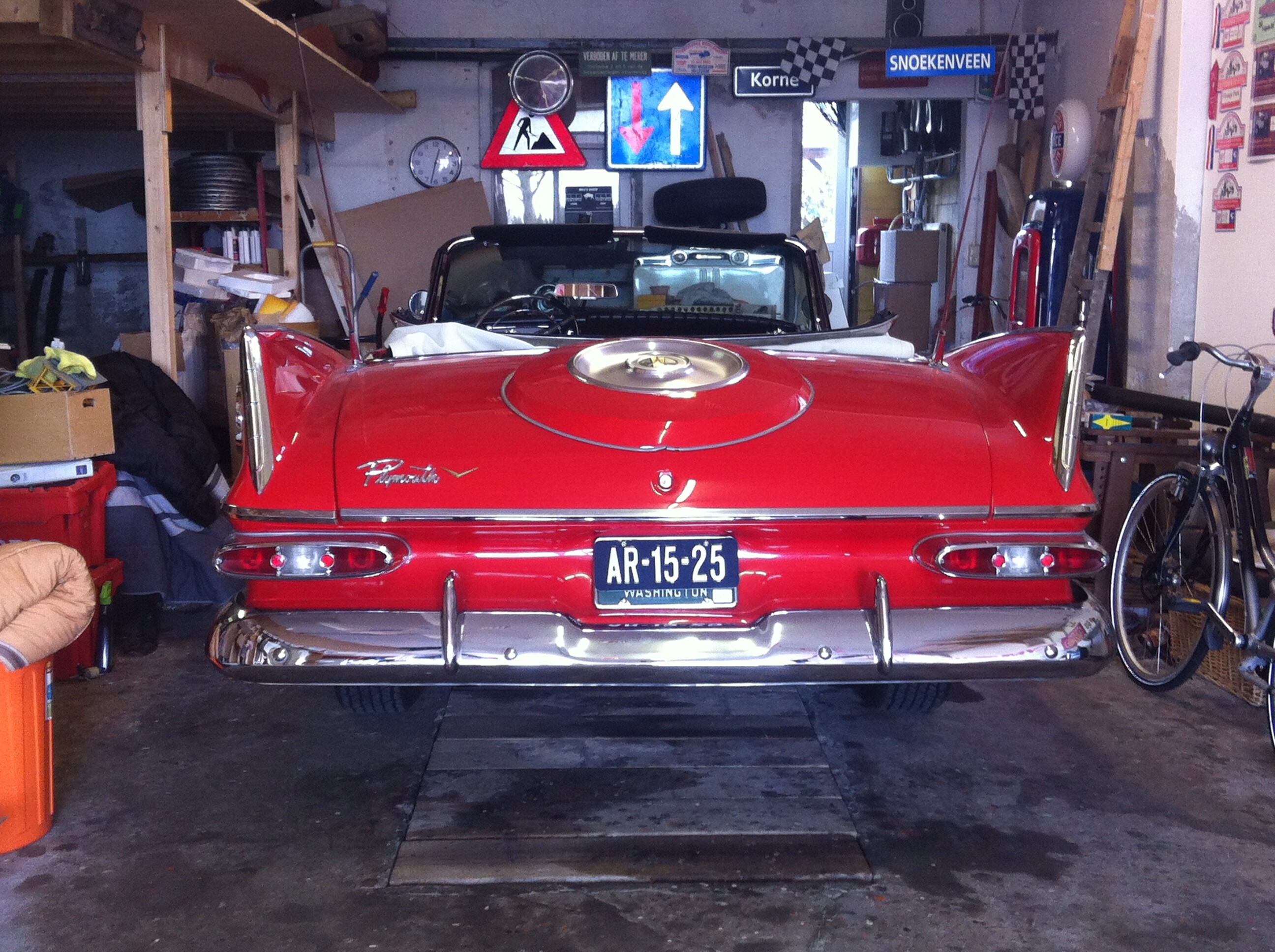

Car as it is now, couldn’t get a straight pic from behind

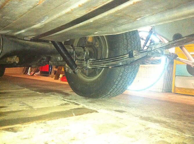

Side view as it sits now
The 1959 springs

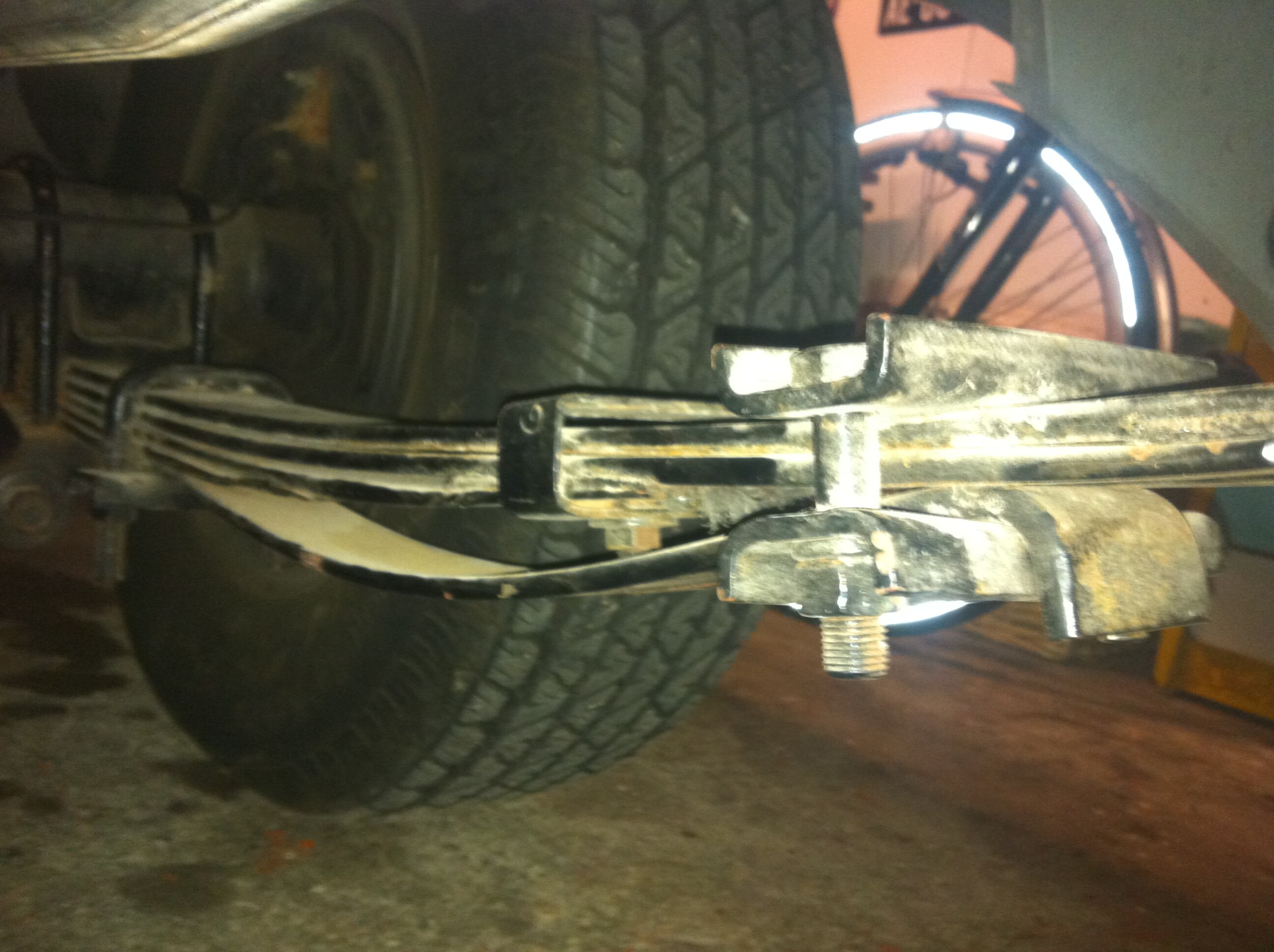

6th non original spring. Should I remove it?
Matthew, What you have there in your photograph, is the good ol helper spring. I havent seen these for many years. They do work, in some cases they are just a crutch. You would jack up the rear of the car and bolt them on, thus adding to ride height and load capacity.
So, take them off?

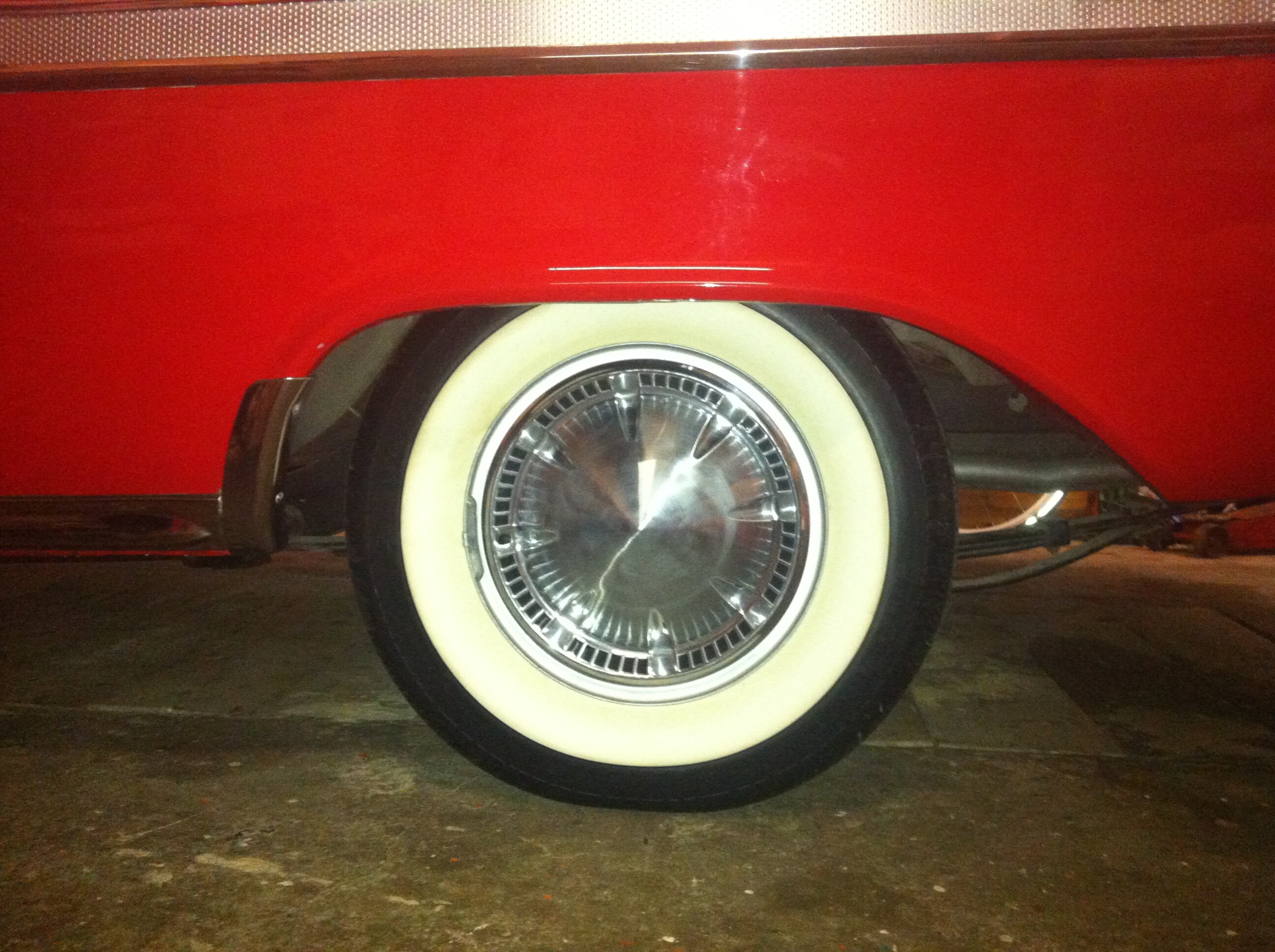

Another pic of how the car stands now
Matthew - I would not take them off. I have helper springs on my Desoto and Green SF and even then sometimes when someone is in the back seat it will bottom out.
Dick, when I rode in those two cars it did not bottom out right? So they must work! :blush:
John - As long as you stay in front!! Talk about abundant butts. Oh, I’m sorry, I didn’t mean that, I forgot I stll may need some parts.
Why I aughta…One of these days Koch…To the Moon!!! :laughing:
It’s OK to leave them on especially if John Q and myself are to ride in the back seat. When they are set correctly ,you do have to have the front end alignment checked and possibly adjusted. This is your choice and there is no harm leaving them on as long as they are a matched pair and no other leaves are broken.
