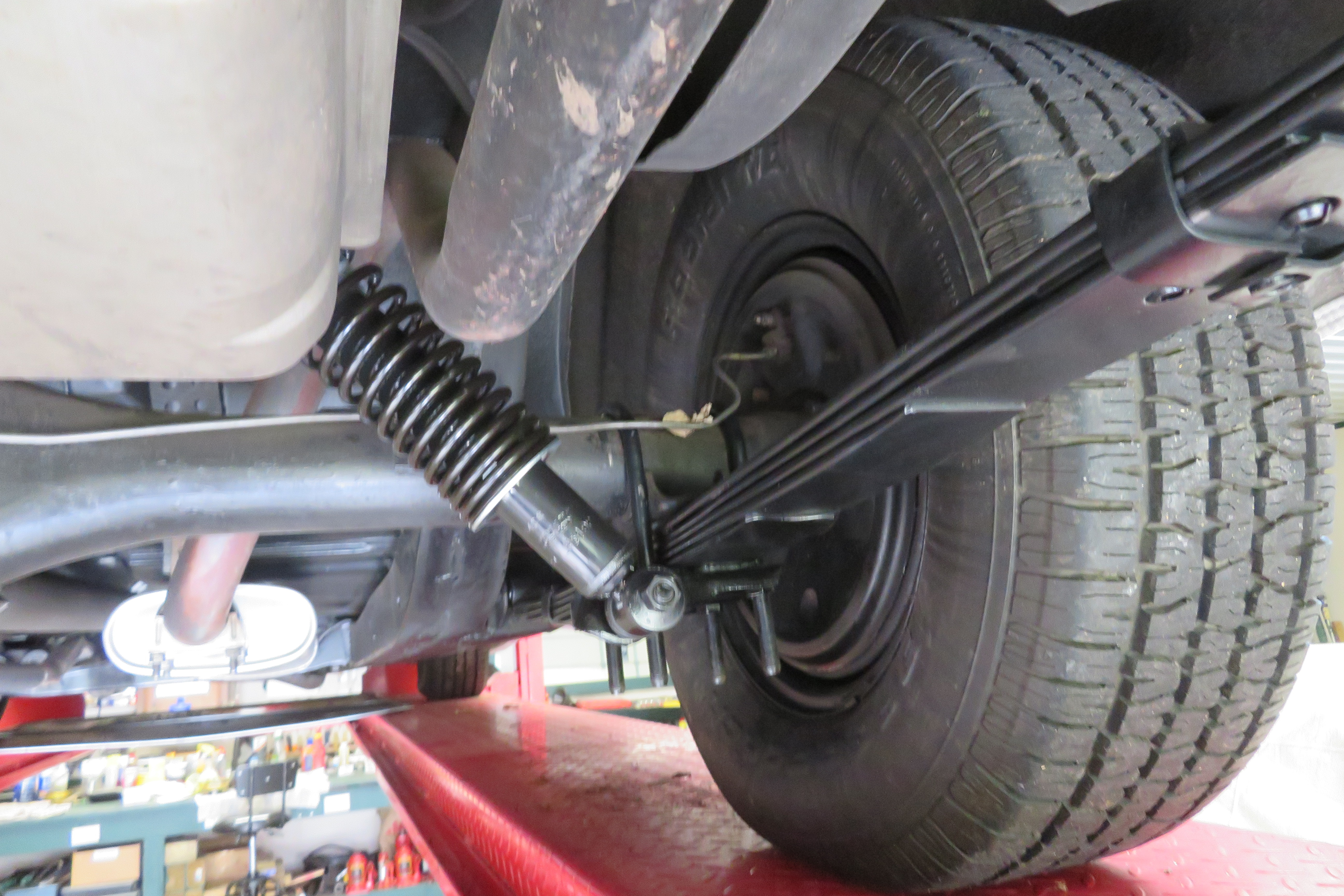

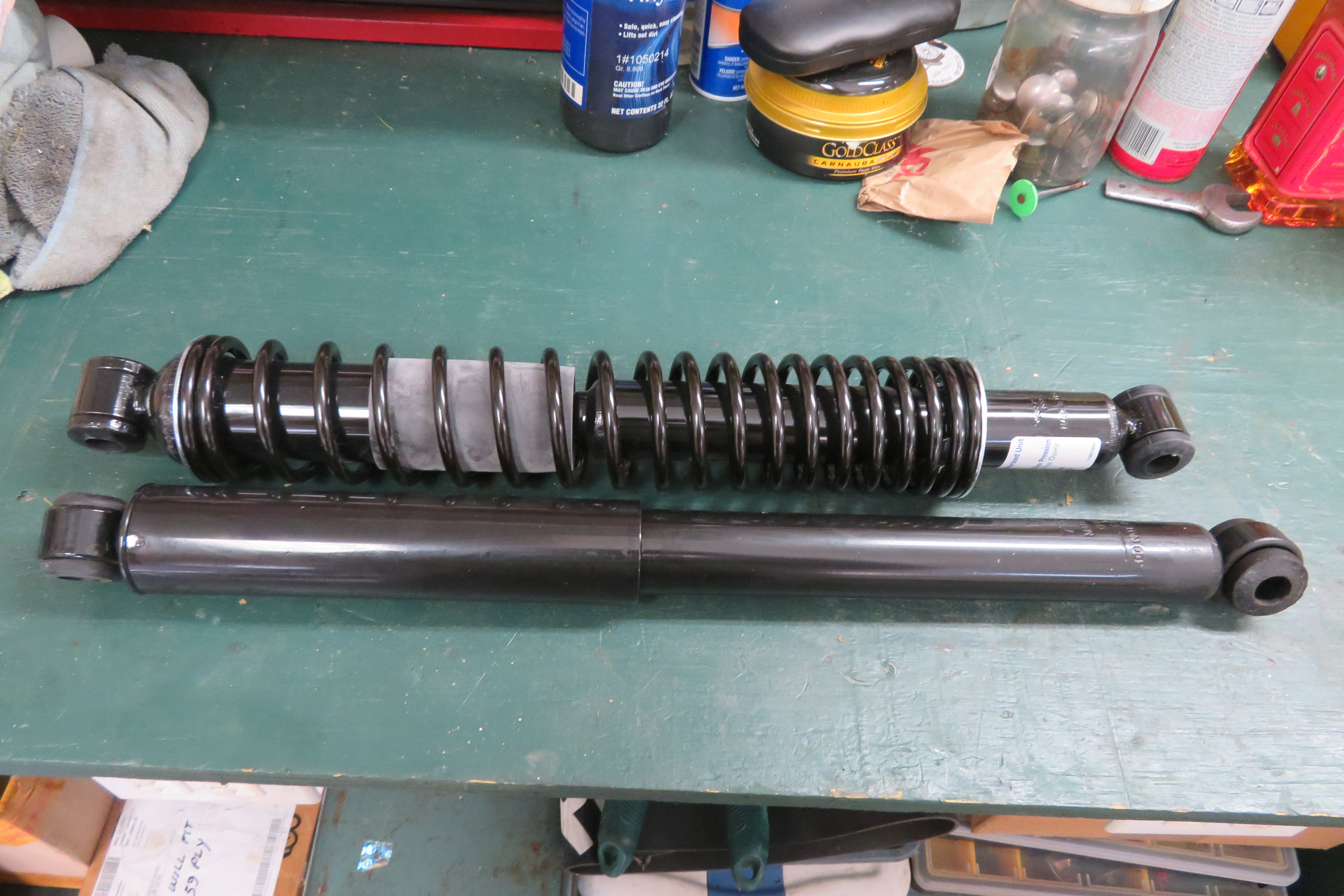

I just finished installing new rear leaf springs on my Sport Fury. Purchased springs from Eaton Springs in Detroit. After installing, my Fury was at a much better stanch height. (Old springs were bent downward on the ends and I could see daylight between some of the leafs - none were broken) A while before I decided to purchase new springs, I purchased a set of shocks with spring coils that would give my old springs additional support but never installed them. After installing the new leaf springs the height stanch was much better but I noticed the new springs under load were just about horizontal. Knowing that even new springs will most likely sag a little after a year or two of use, I remembered those coil spring shocks that I had sitting on my shelf. While I had the car up in the air, I decided to go ahead and also install the new Monroe coil springs shocks in combination with the new leaf springs. After installing, the Fury body height did not change but the coil spring shocks added more load capacity. After installing, I took the Fury for a spin and it was unbelievable how much of a firmer overall ride and handling the car had. (The old setup with the original leaf springs gave the car a softer ride along with the lower stanch.) After installation, I thought I would have to do an alignment and raise the front-end of the car up, but the fury looks pretty darn level in the front as it is, so I can forgo the cost of a new alignment.
Not sure what I am going to do with the old springs. They can be re-shaped back and re-used or I can keep a couple of the leaf’s as backups ( more
support) or I could donate them to guys who are into forging for making knives and such as I understand the spring material is good for that.
I recently installed new rear leaf springs and also new coiled helper spring shocks on my 59 Sport Fury. I am pleased with the results but have come across an article regarding Coiled Helper Spring Shock absorbers that I think Fury owners that have rear coil helper spring shocks should be aware of. It concerns being able to change your rear tires. These helper spring shocks are typically shorter in overall length than the original non-coil-spring shocks when fully extended. The only time a fully extended shock comes into play is when you have to change your rear tires. As you jack your car up, the car body rises vertically from the axle for tire removal. If you have oversize tires different from the orig factory size, you may not be able to remove the tire because of the clearance between the brake drum and the body wheel opening, because once the shock is fully extended the axle cannot move any further for additional clearance. That means you will have to disconnect the bottom of the shock from the attachment arm on the leaf springs to get a larger clearance between brake drum and body wheel opening. (Imagine being stuck on the roadside with a flat rear tire and having to disconnect the bottom end of the shock to get additional axle clearance) I have on my Sport Fury BF Goodrich 225/90-R14 tires which
have a wide tread (i.e. tire is fatter) so I will be doing a practice rear tire change out to see if my present setup has enough clearance to remove/install tires. It might require me to go back to the standard gas shock for extra length. I found the article on this problem in the Forward Look web site as some MOPAR owners have run into this situation.
