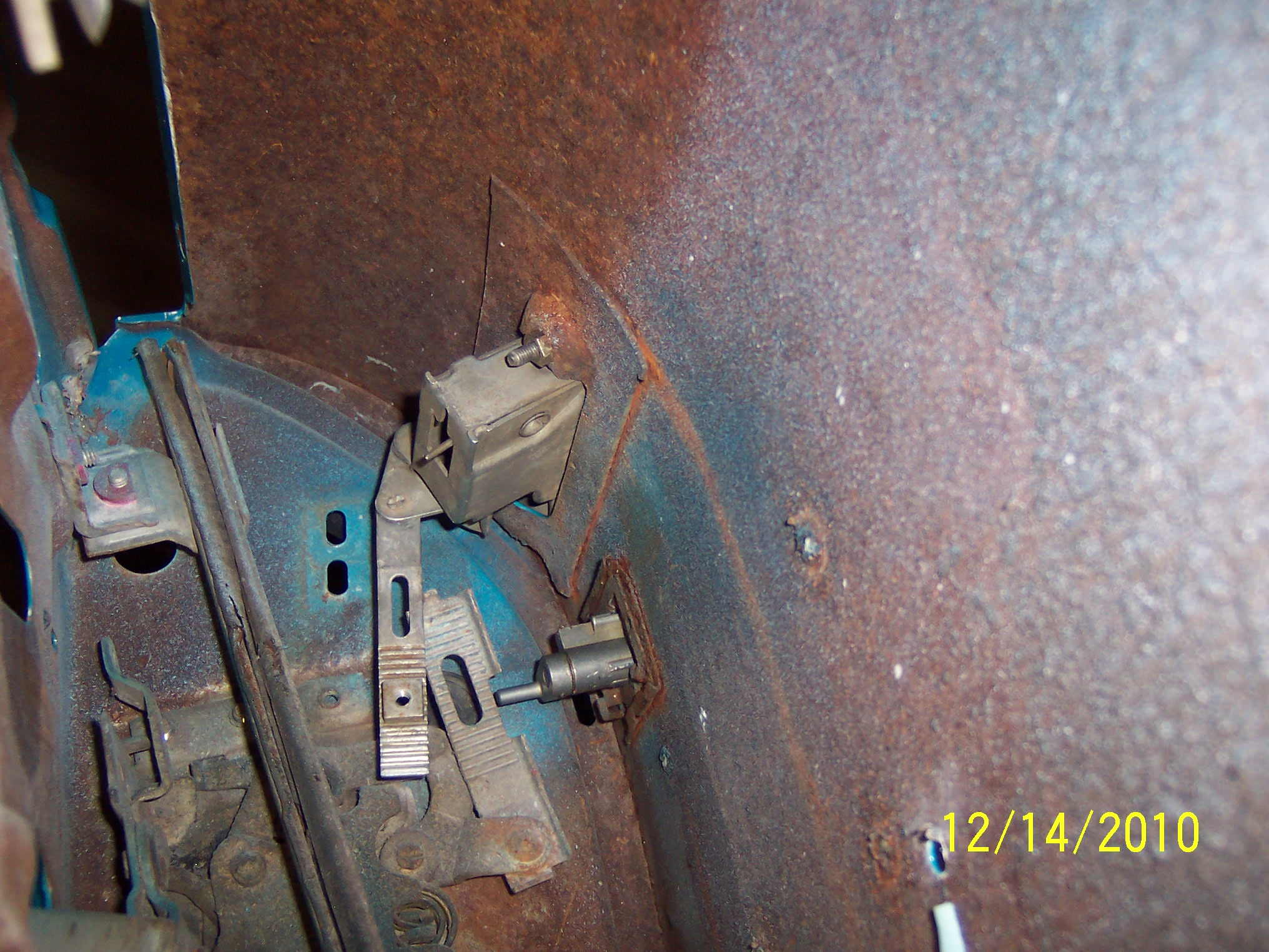

I will try to take a picture of this area to see if it helps visualize the slide tab.

picture of locking tab inside the door from window access port (remove door panel) my glass is not installed yet. Also the key lock pawl to door latch is also not installed either at this point.
Thanks, as always, John. Your pics remind me the door lock retainers are a bit more complex than the trunk lock retainers. The door lock retainers are a sort of self-contained mechanism, although it isvery difficult to see this from John’s pictures.
Use a flashlight, and look for the upright “tab”… :confused:
Thanks for all the help, you guys. The visuals are great. I’ve got the door panel off on the passenger side and have had a good look at that lock. The bracket is a little bent, and I suspect that this is not helping me slide the thing over. I’m also having a hard time getting a good enough purchase on that tab to keep my tools from slipping off it when I give it a good solid pull. I may spray some more lube in there and leave it for a couple more days and see if that helps. I do have the yellow shop manual, but it makes this whole procedure look annoyingly simple compared to how it’s playing out in real life. I suppose that’s to be expected with anything that has 50 years worth of crust built up on it.
