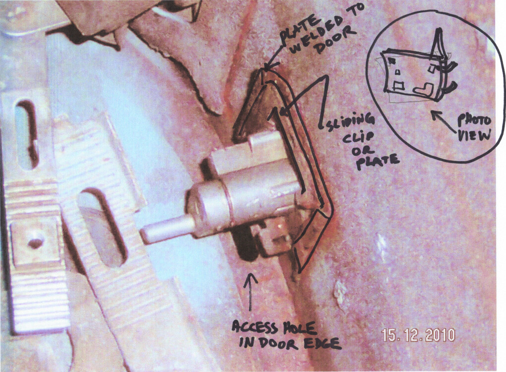

Yeah, I don’t think I’ll need to order new door locks. The local guy I found spent a couple of hours with me the other day trying every tool in his box to pry these clips off to no avail and he didn’t charge me a dime. He also made a copy of my current key for free (and he has plenty of blanks to make more). I don’t think he’ll charge me much to re-do the existing locks once I get them out (and at this point I feel I owe it to him after he spent all that time at no charge). I just sprayed them again today, and I’m thinking I might go in there tomorrow with a hammer and screwdriver and see if I can’t tap it from inside the door. I’ve got slender enough arms I can actually reach up in there where he couldn’t.
My apologies…I modified John Q’s photo for viewing, but now I just can’t remember how to properly post it!
Roger,
Send it to my email and I will post it for you!
Hallelujah!! I went in with the hammer and screwdriver and gave the clip a few good taps from inside the door and it finally slid over! I got the lock out of the passenger side now, and I’ll do the driver side tomorrow once I get the door panel off. Thanks so much for all the help and the great photos and diagrams! Those were a huge help in figuring out exactly where I needed to smack the thing. ![]()
