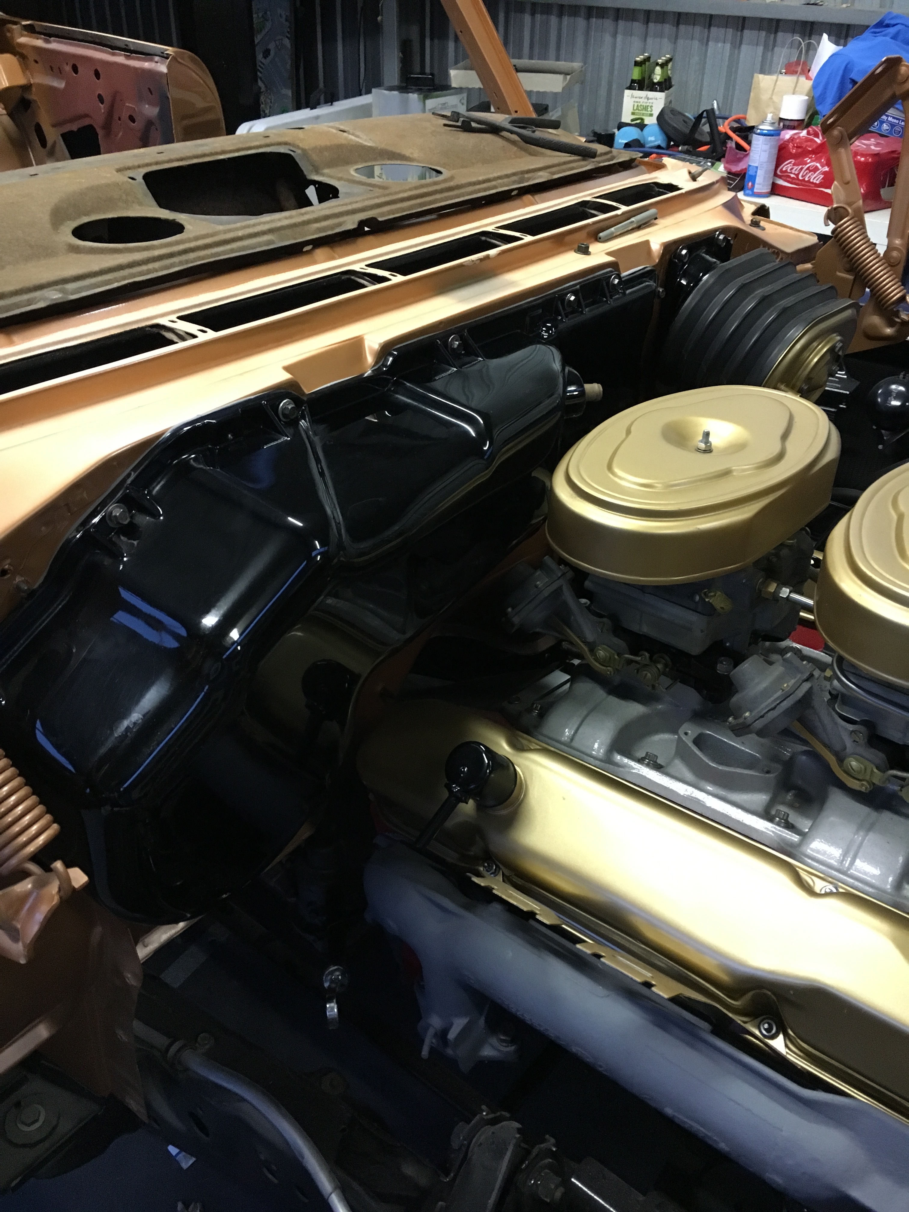

Turns out thru my research ( or the best I have done so far) that they are approx 1956-57 carter afb carbs
They don’t sit as nice as the actual 58/59 set up but for that price couldn’t let them go
I believe the mounting on the LHD as per the pics may actually be the choke but not 100% positive
Has anyone seen this type of carby before?

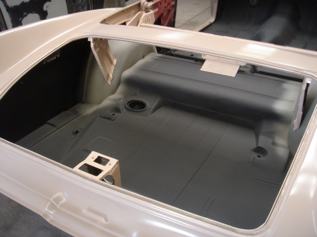

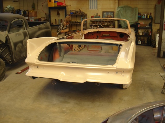

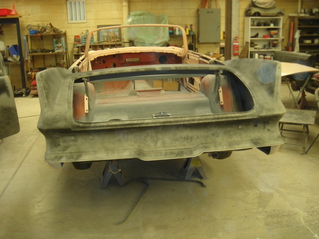

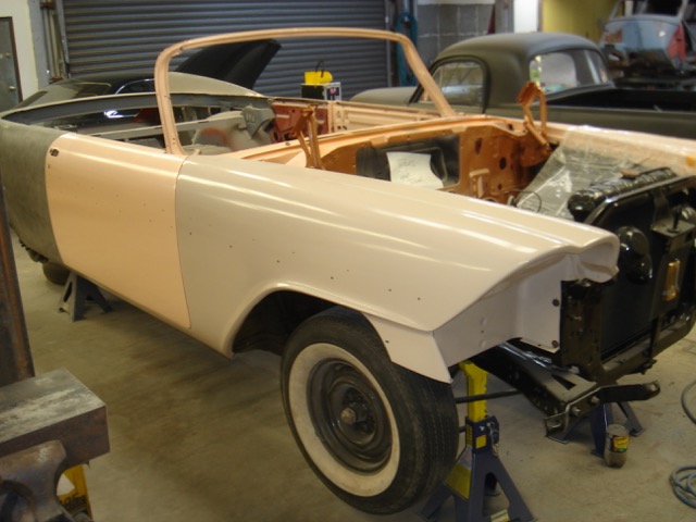

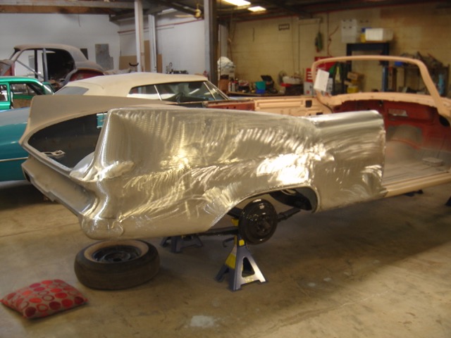

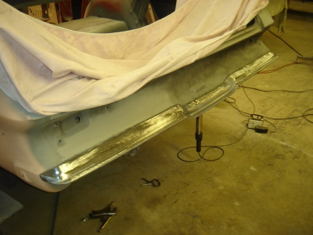

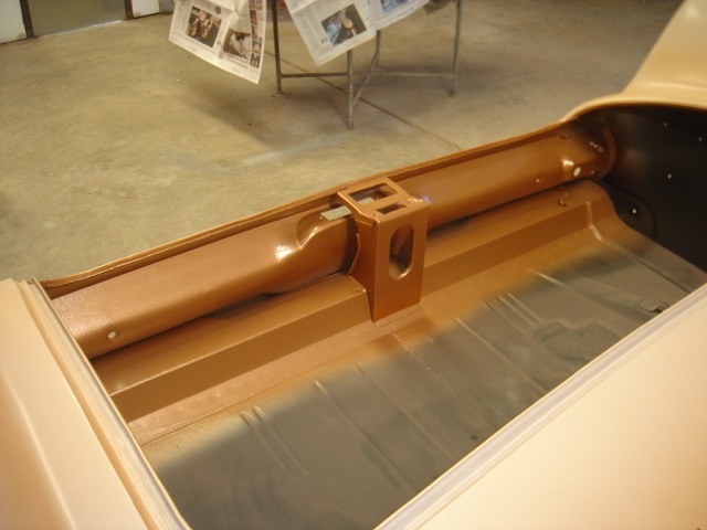

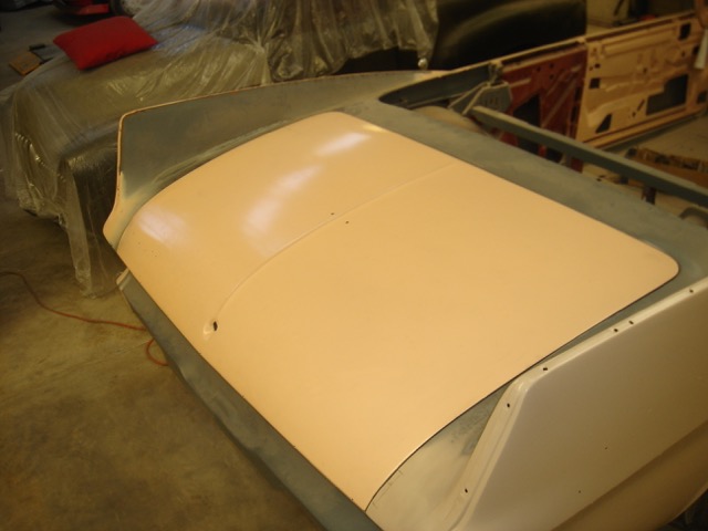

More pics my coach builder has taken

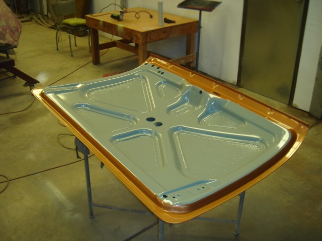

Tried something different in the inside of trunk
Not keen will paint underside of trunk lid all grey

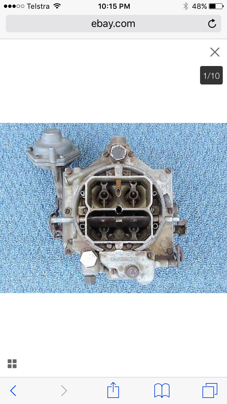

Looking at a mark iv original Ac currently on eBay
The cost the ship to Australia is almost more than the cost of the unit !!!

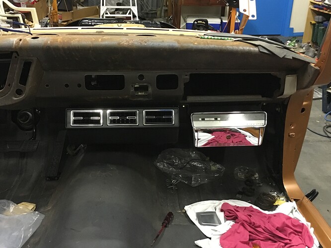

Hi all
Honest opinions please

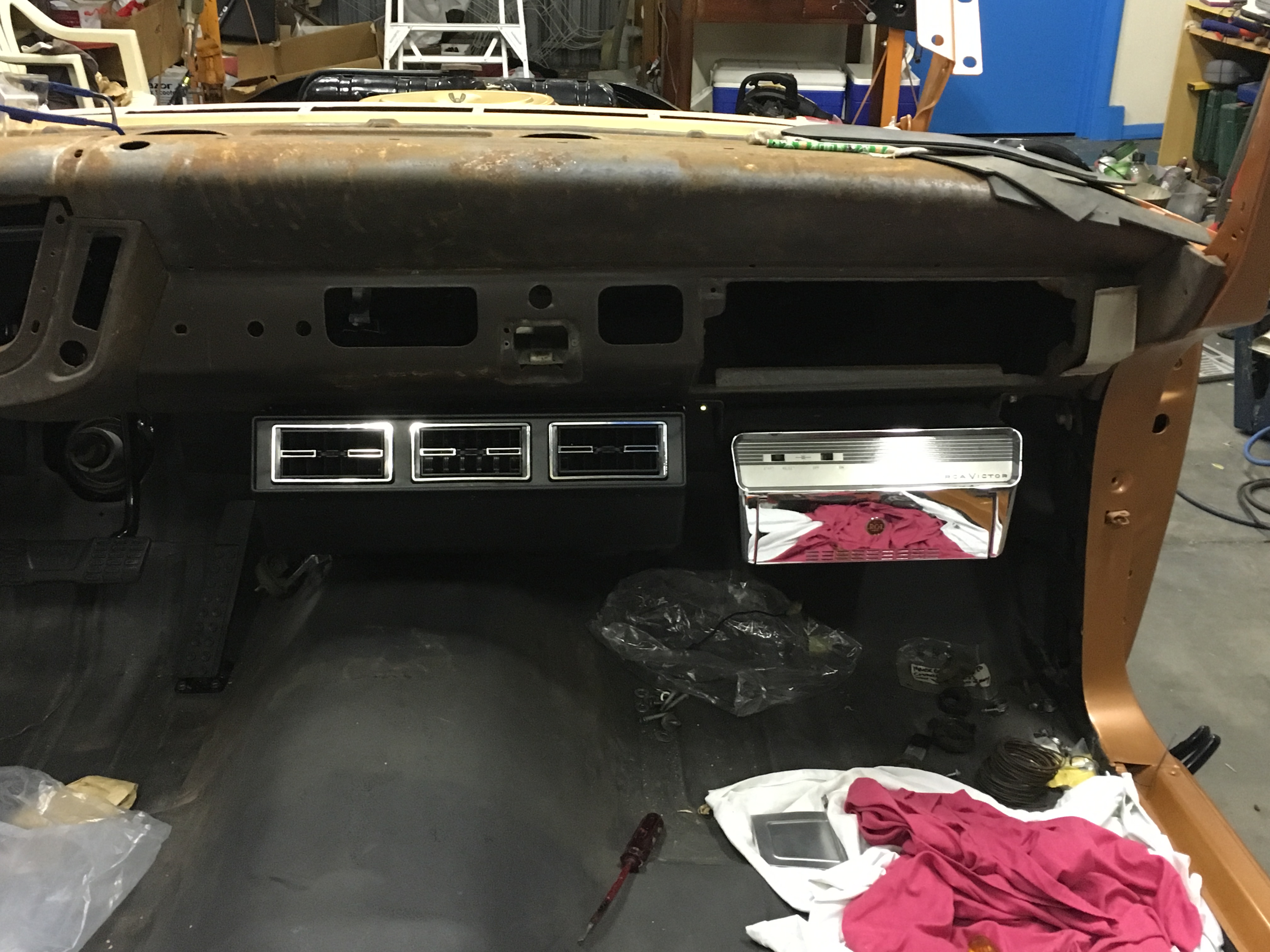

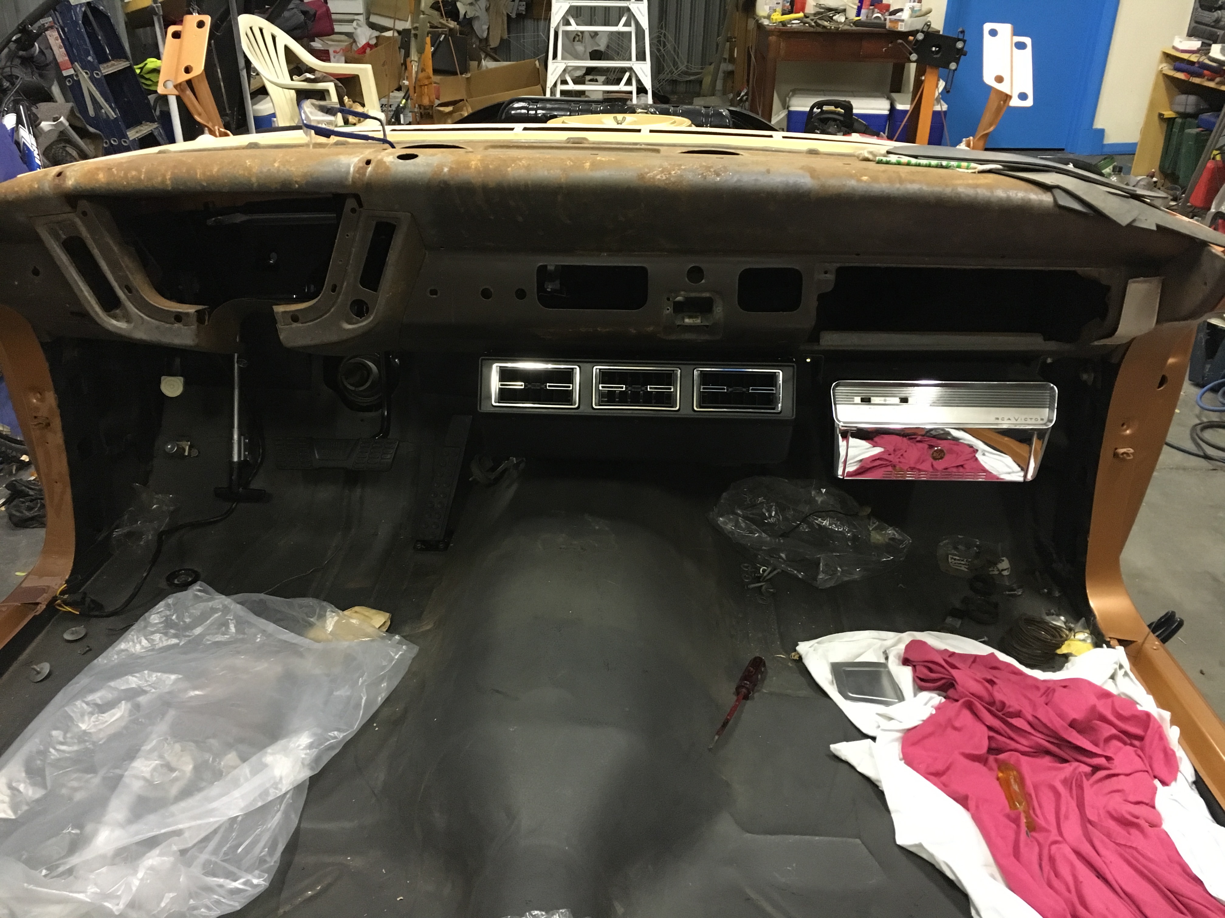

I want to install an Ac system in the car
The most economical is under dash as it also doesn’t muck the original set up of the car heater
Is the set up shown in the pics ok or should I put the record player in the trans hump??
I will be plastic chroming the Ac face so hopefully looks better with the record player
Happy to hear thoughts and suggestions or alternatives
Cheers
Vic
My vote goes out the the transmission hump. Will look so much better and cleaner on the passenger side
Vic, in practical terms - the distribution of air from the A/C would work best from the center position. And operationally, it would be the passenger managing the record player from the side, not the driver from the center. (Geez, did they have record player laws for drivers, like they do now for cellphones :astonished: )
I vote that you keep the setup, as you have it.
1-1 so far!
I still think the record player looks better under the A/C.
Will look like a sort of center console

Yes I too wanted it in the middle but the ac needs robe placed slightly off Centre from the hump otherwise clashes with the accelerator pedal
The record player then doesnt sit under the AC unit given its height so it needs to sit proud of it and as it needs to be mounted slightly off the floor it all starts to look awkward
Vic - l think you just answered your question. Do you think the AC evaporator unit case could be altered or shortened to clear the pedal??? It must be nice to be young enough and have the time to be as meticoulous as you are in making your car absolutely perfect. Because of my age l had to hurry up so there would be time left to drive it a little bit. :mrgreen: :mrgreen:

In terms of the Ac unit I don’t think there’s much I can do in the way of shortening it
There are smaller units but they won’t cool the car down
When l had my 63 Ford Galaxie Convertible l installed a specially made kit for that particular car from Classic Air in Tampa, FL. The underdash unit looked small to me. I found out it was for a mustang but they assured me l would not be dissapointed. They were correct, there were four round outlets on the face and there was a strong blast of air, it cooled down the Galaxie nicely. Google them and take a looksee. A key to a good blast of air is adequate current from your generator or alternator. When l put AC in my Desoto l installed a 35 amp one wire alternator. It wasn’t enough current to support the electronic ignition l installed with the GM modulator. I installed a 65 amp alternator from a 73 Charger and haven’t had a problem yet. The bonus is the AC cold air and fan speed seems to have doubled.

I have seen the Ac unit you reference. My concern was that it was a design for ford and would look out of place in the Plymouth coupled with the fact of shipping cost - gets me every time as it’s as much as the unit itself
At this stage I think I’ll proceed as is

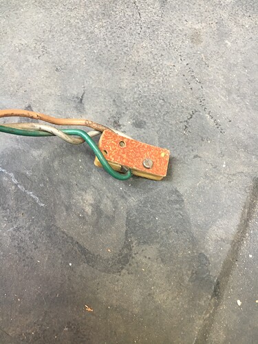

By any chance would anyone have the rear interior light socket for the cvt rear arm rests
Turns out I have the lenses but not the light socket
Given the forked prongs on the rear of the housing I assume it’s a special fitting?
Any pics would be great so I can start tracking down what I need on the net

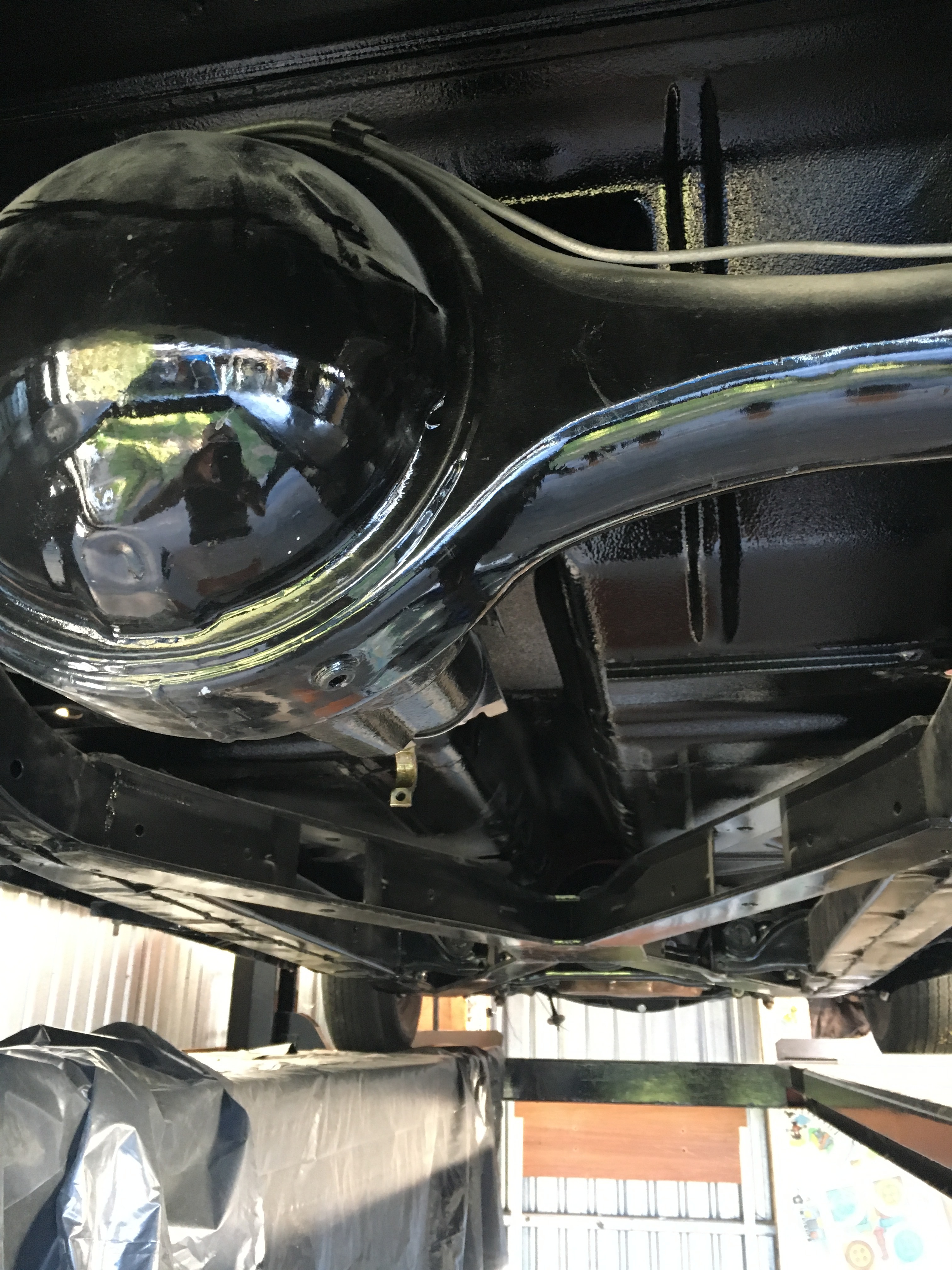

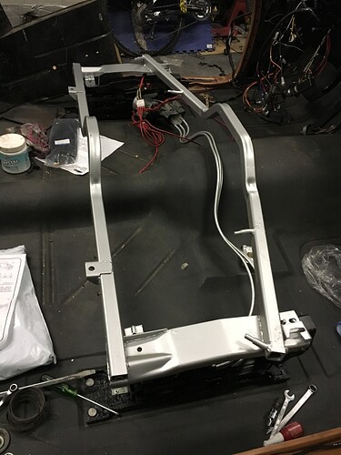

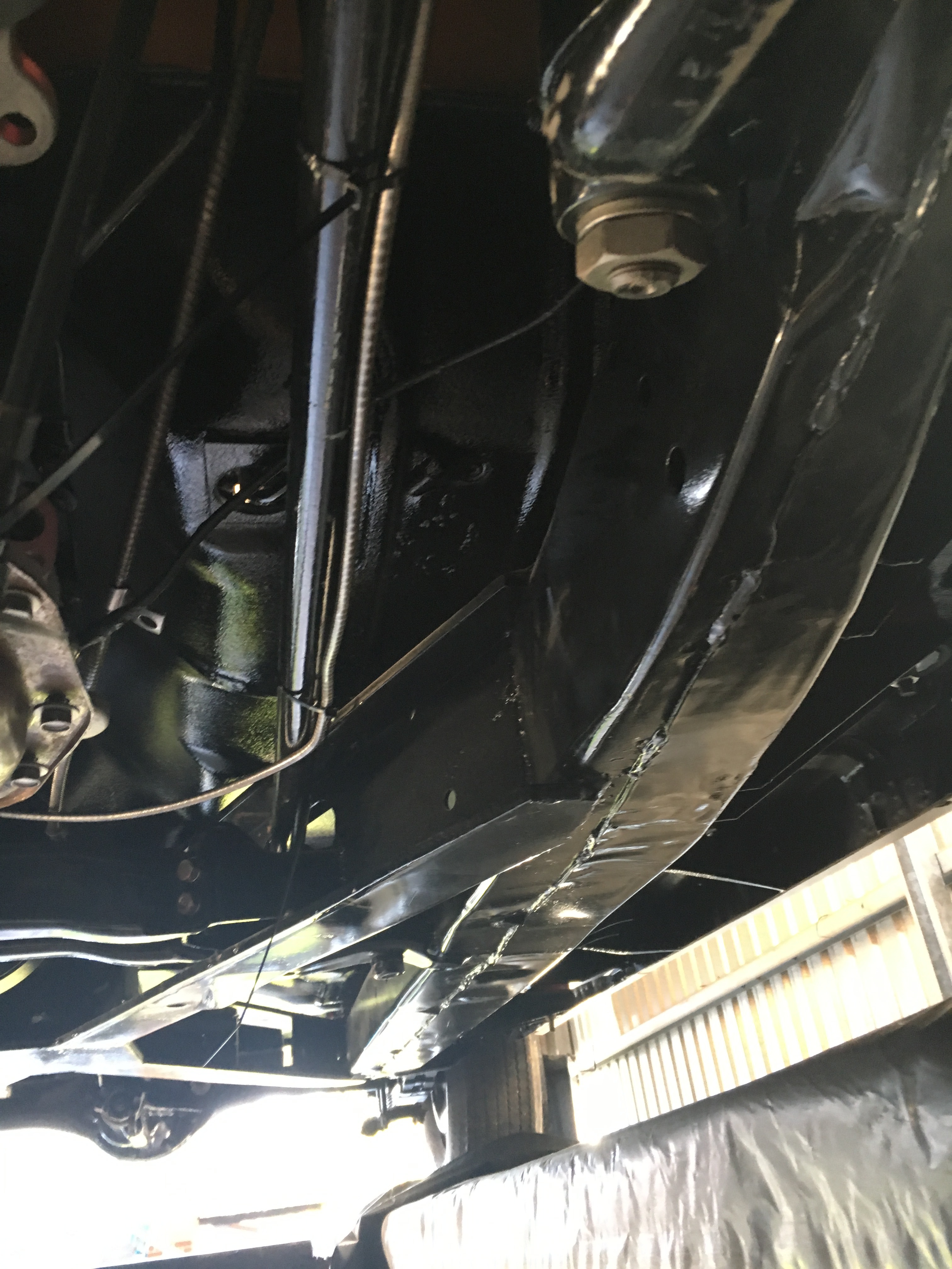

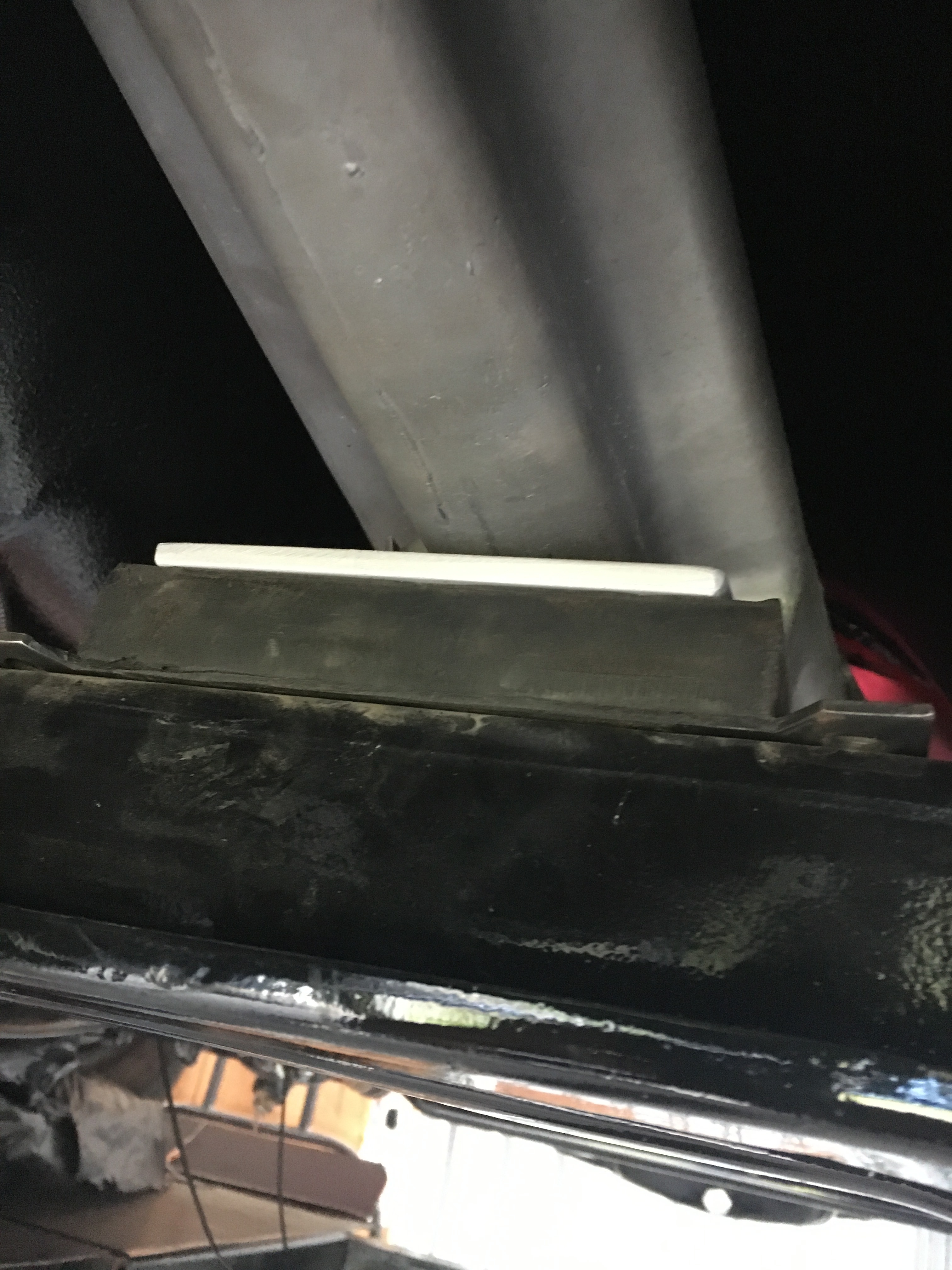

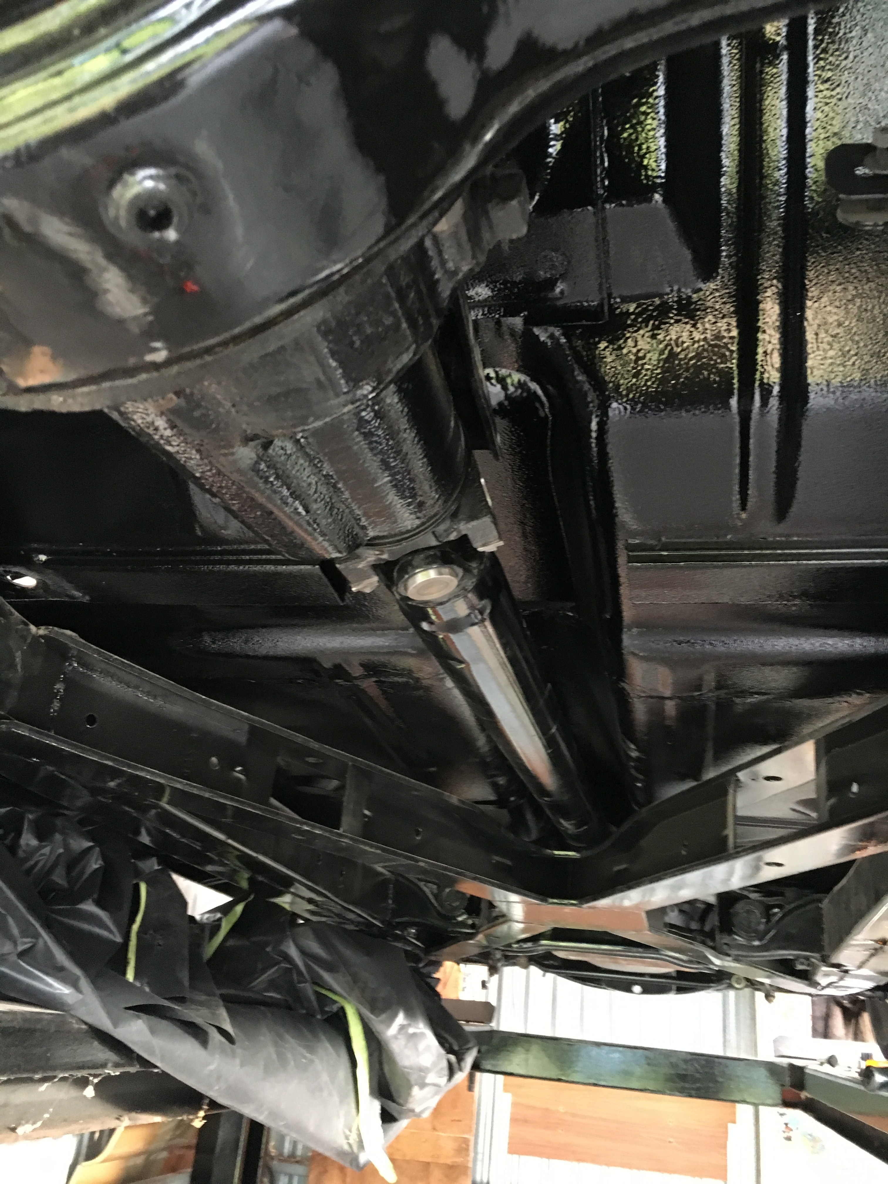

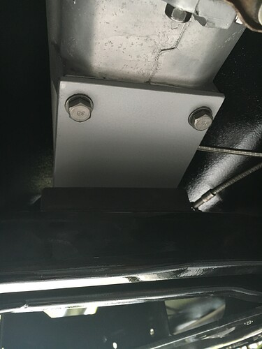

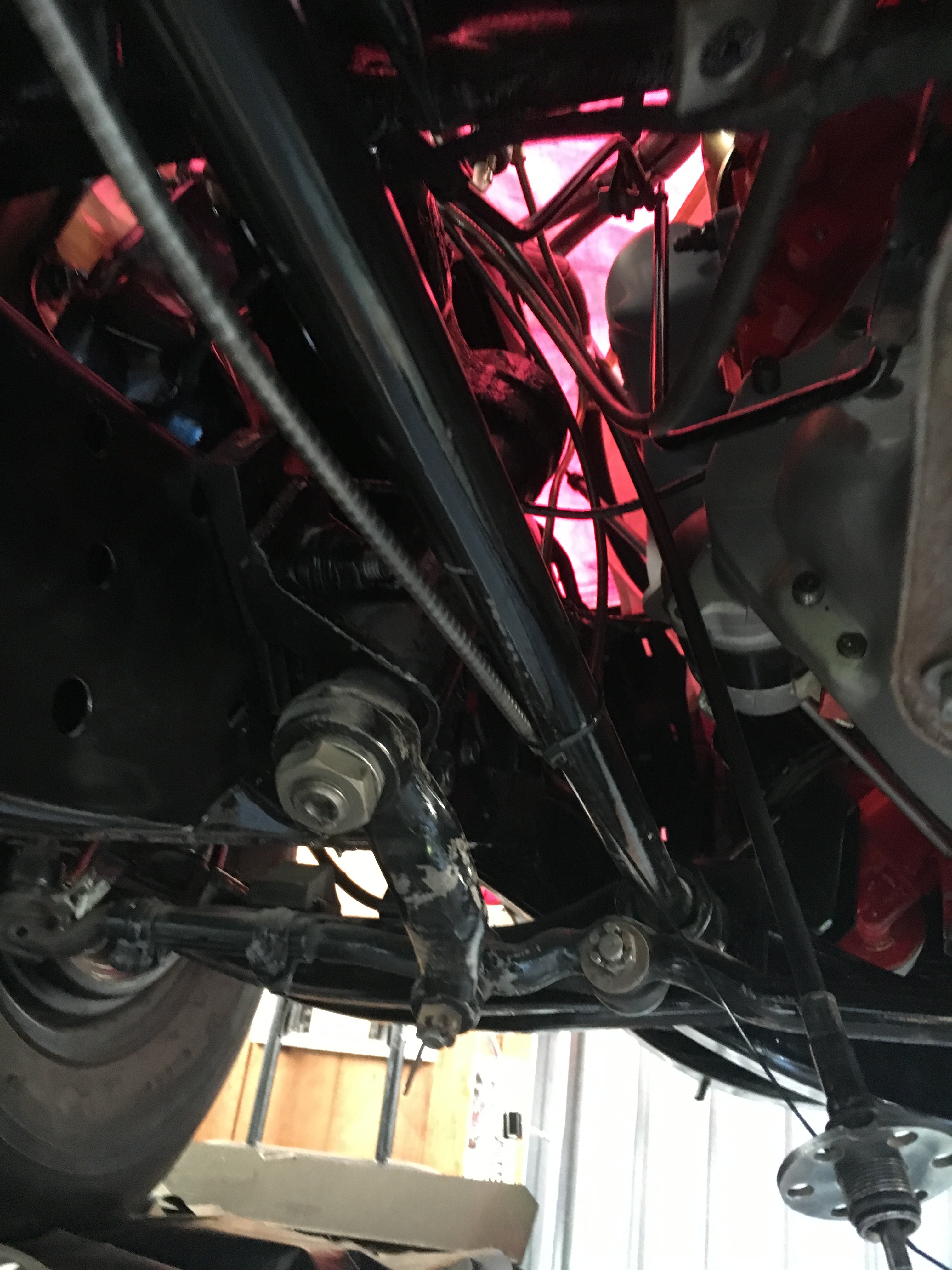

Bit more of an update
Finished most of the wring install

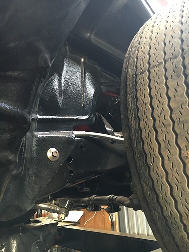

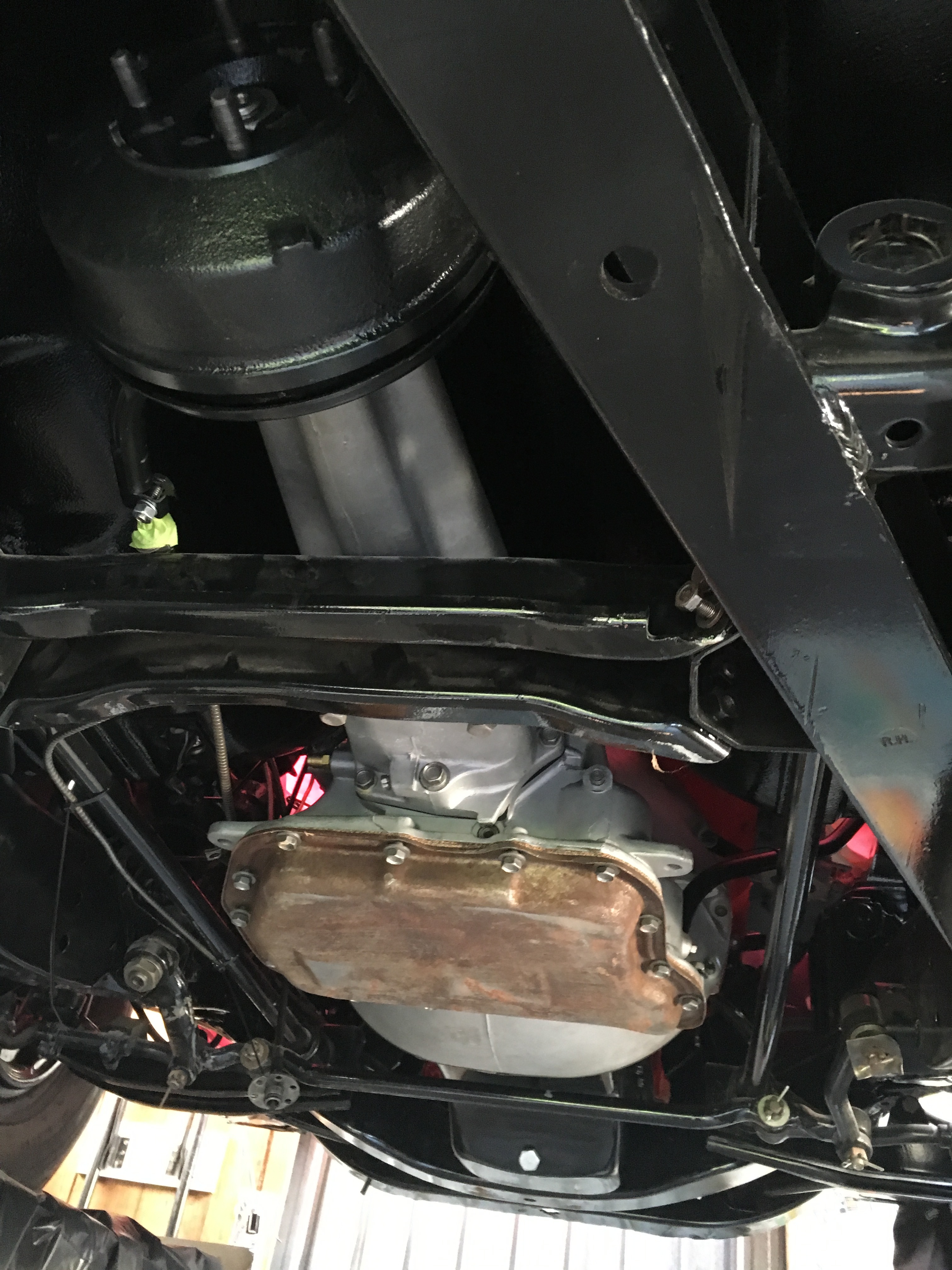

Got the car on the hoist and started on the transmission mount
The 61 727 trans mount fell short by about 140mm from the trans cross member
I made up a plate so that I could still use the original style trans mount
Apart from this the hand brake mounting was a match as was the shifter cable

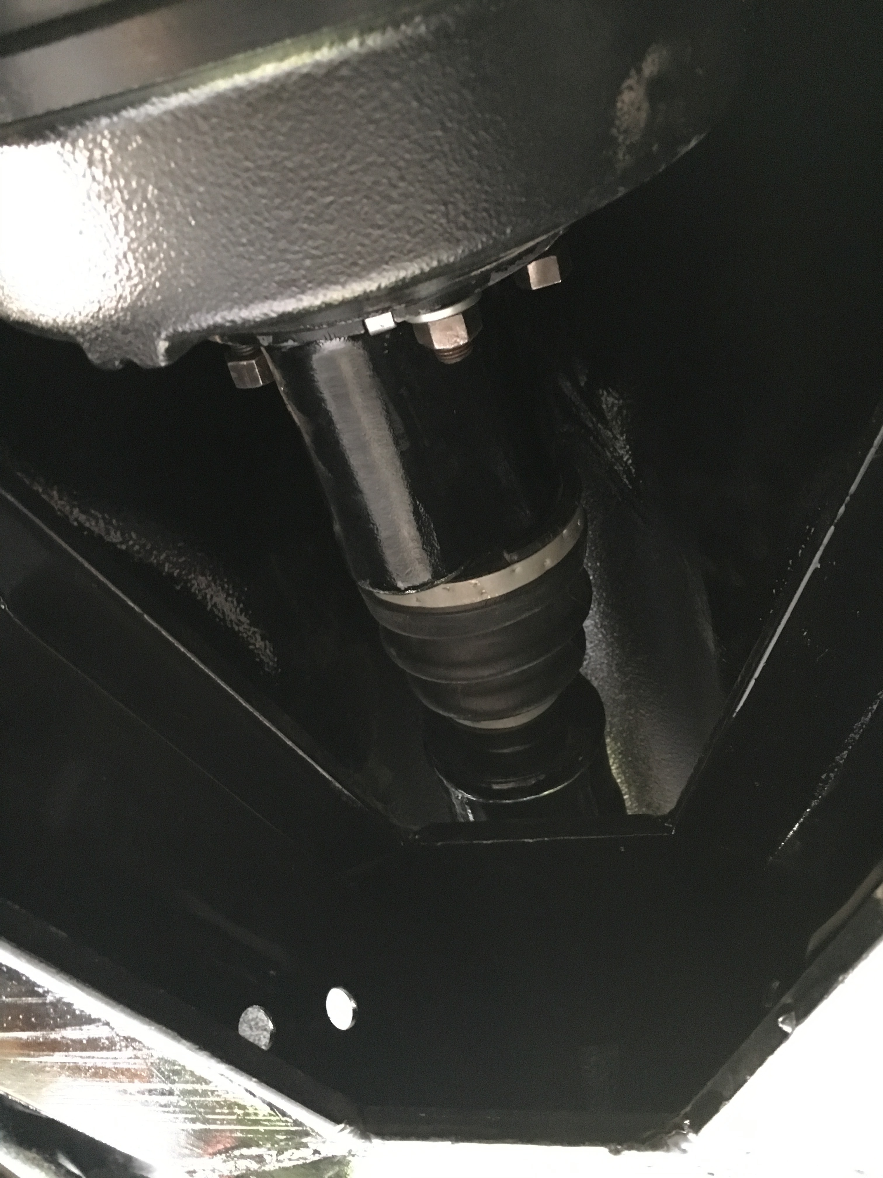

The tail shaft assembly was a match and it bolted in nicely
The only other one small adjustment to be made is the kick down rod
The original torque flight rod is a little bit longer

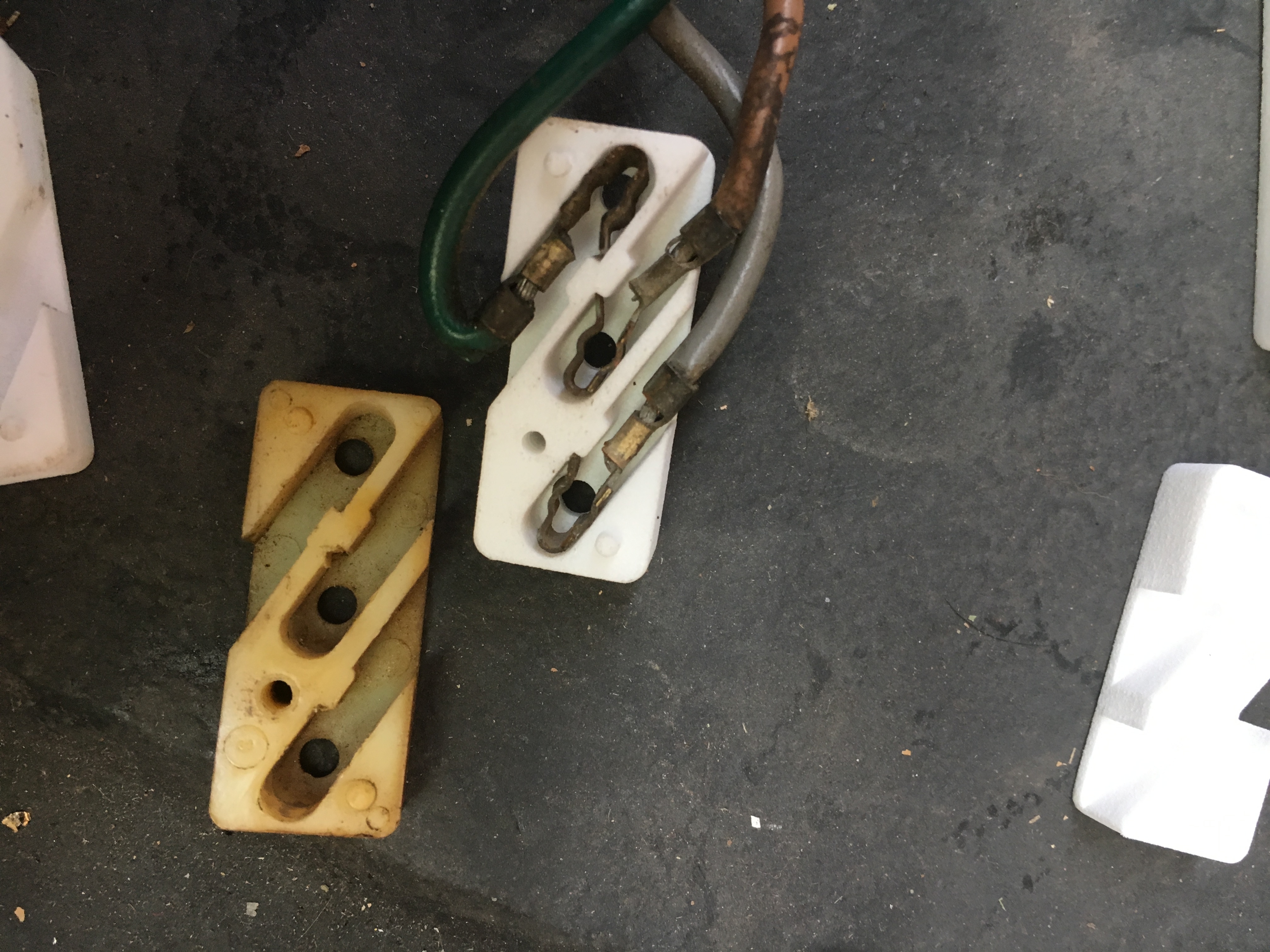

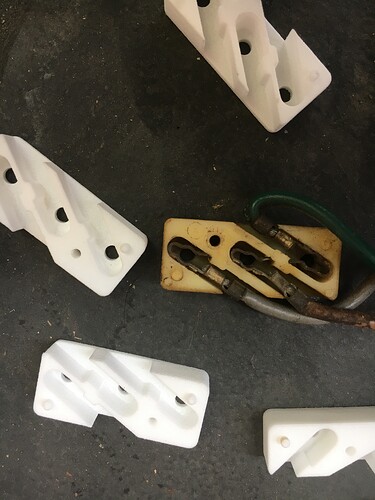

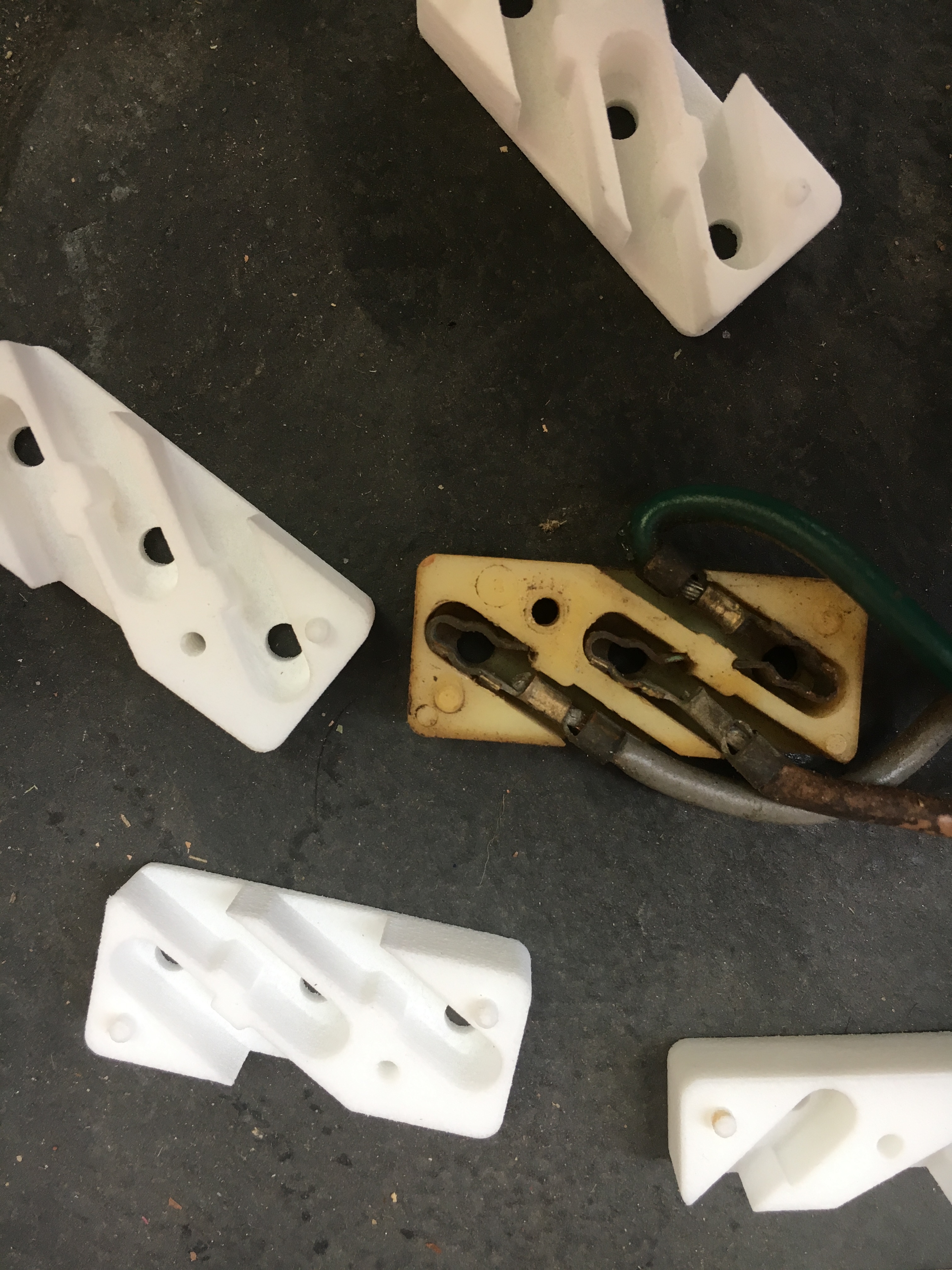

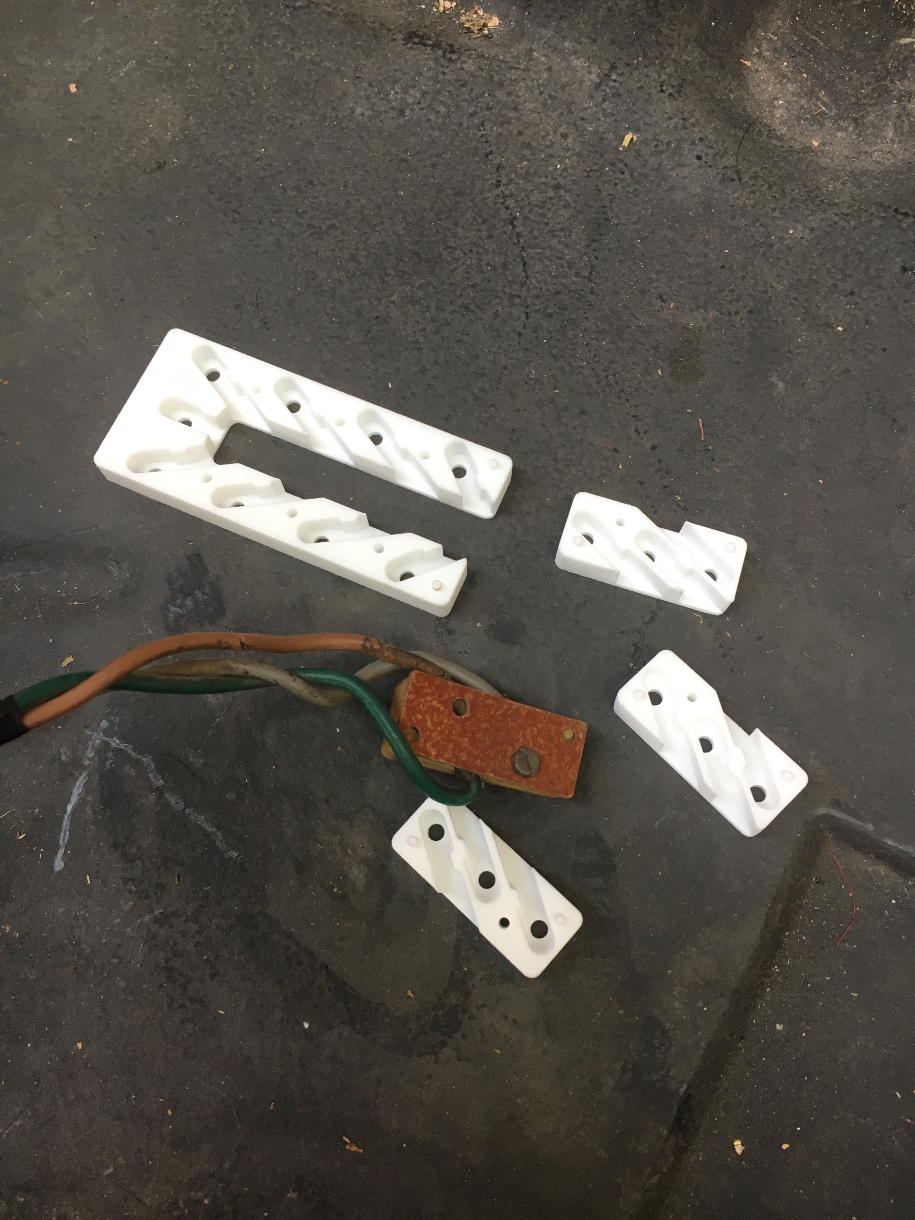

Started on the power window switches and noted that my housing were brittle and in parts melted
I found these on the web. Not sure if you guys have seen these before. A fellow forward looker was restoring his 58 Plymouth and struct the same issue
He’s ended up making these reproductions with a 3D printer
Oh how the world has changed

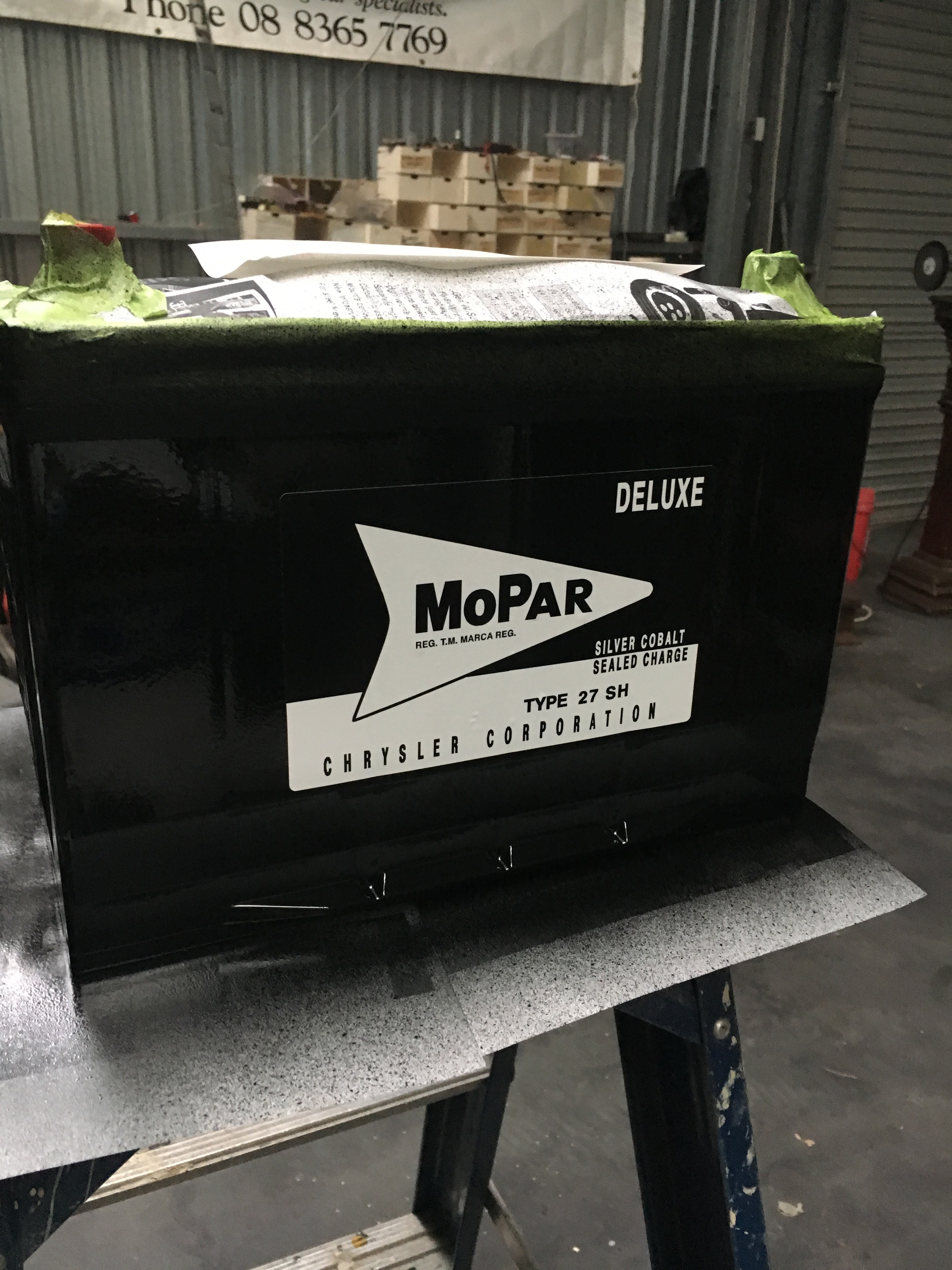

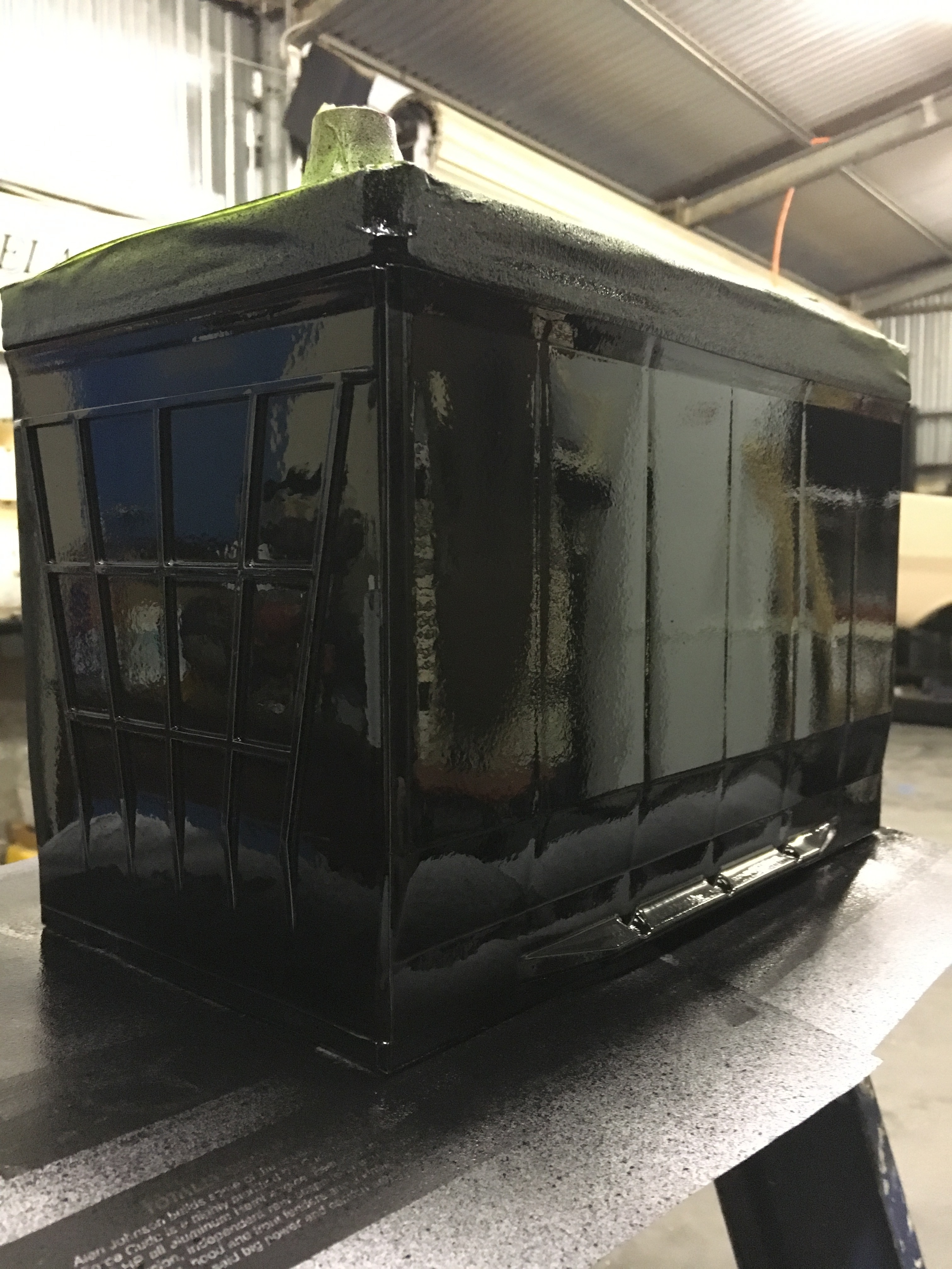

Also bought my battery (ended up painting it black to try and look half original and als put on Gary Goers (GG) sticker on)
Oh also a big thanks to Dan for helping me out with a shipment from GG he was a great help and made this process so much easier
Cheers
Vic
Thanks for the props, Vic, but we still have your seat base cover issue to resolve. I’m in Chicago on business, but will check in with Gary on my return to see if his new source came through.
Wow, those switch housings are awesome! It looks like his contact info is truncated in that one pic - can you post, please? Wanna get some of those babies! :wink:
Hi Dan
Detail attached - they come from France

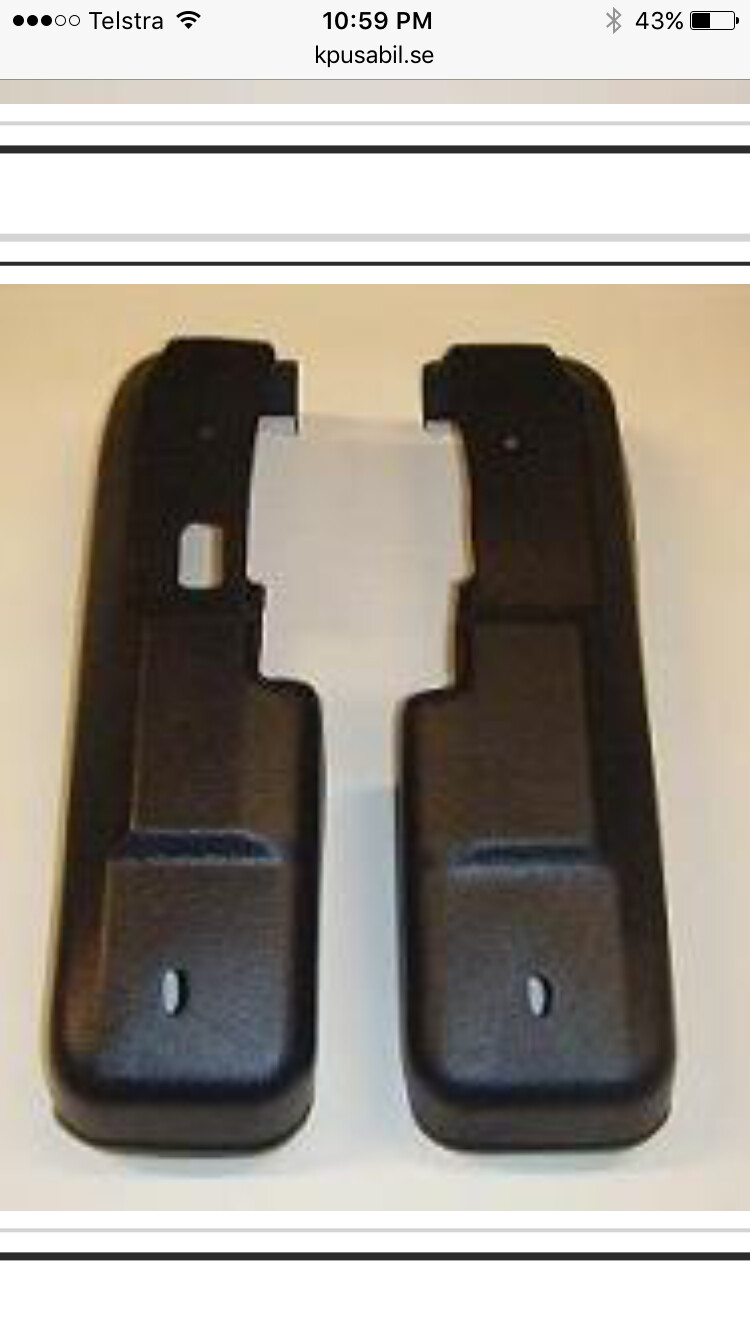

However , by any chance does anyone have a pic of the plastic covers for the power seat assembly?
I’ve seen 1958 ones on the KPUSA website- wondering if these can be modified for the swivel seat
Cheers
Vic,
Tom Fox is having a little trouble with his new phone, so he asked me to post this on his behalf. Might this be the solution?
