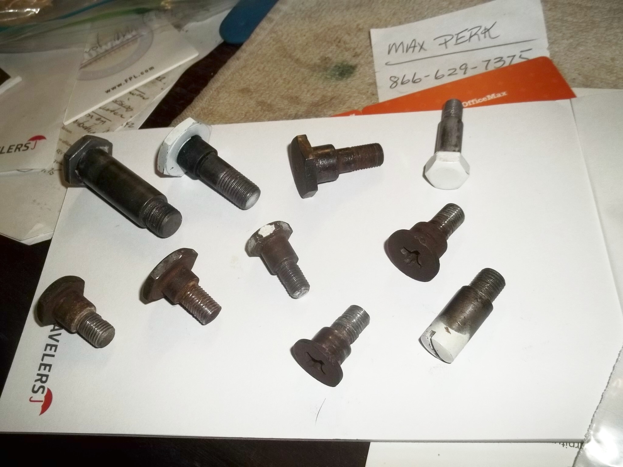

I have in the basement a jar with some convertible top frame bolts that I had picked up during my restoration that I did not use. I will try to locate them and take a picture of what I have and if you need any of them let me know and I will send them. Give me a day or two to see what box I put them in.

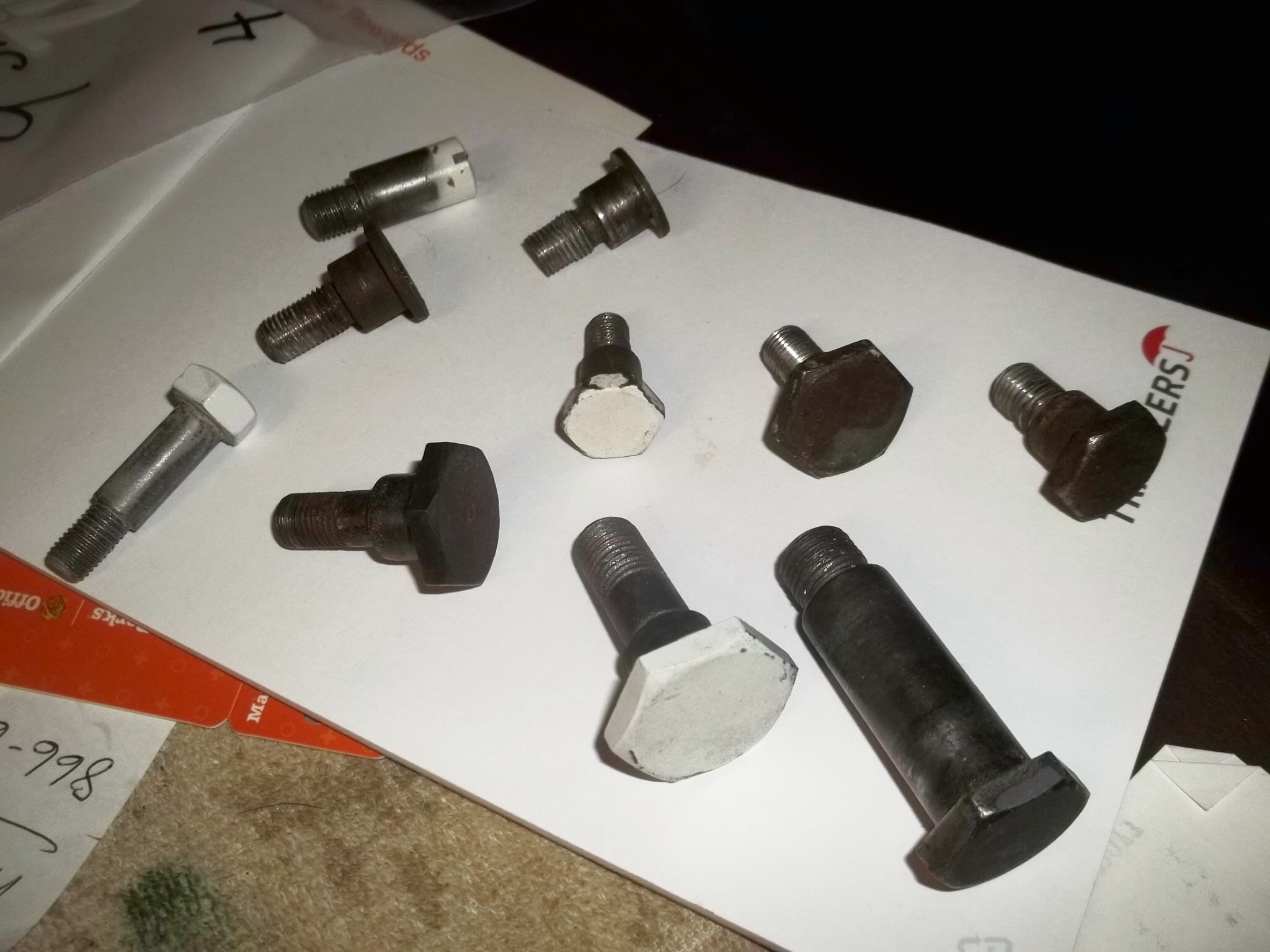

OK, Vic and John - Just got back from the machinist shop. Two older Norwegean old school brothers. There are 10 shoulder bolts per side (20 per set). This does not include the long and short clevis pins that you can get locally.
Thier normal rate is $60.00 per hour which I think is a pretty good rate. They will charge by the hour but not to exceed $650.00 per set of twenty or $32.50 ea. Plus shipping of course. Let me know ASAP so I can get them started. I’ve included pictures of what you will get.

Guys…Don’t forget to back out the small set screw on the top frames arms so as not to strip the threading when you re-install…It is probably already backed out but just in case…
Please back out the set screws at each shoulder bolt. Those are not oil holes as this dummy thought and that’s why I stripped the threads off the bolts and had to have new ones made.

With regards to the set screws mentioned in the earlier thread, I assume that these get tightened once the top is fully aligned?
Yes, you could tighten them down with the set screw to keep them from backing out during an road vibration. I did not on mine and they seem to hold fine. I did check them after the first year of use and none needing snugging down so I left the set screws not tighten down on the bolts.
The factory did it for longevity of long term use use but with our cars seeing a lot of road use and vibration. I don’t think that would be an issue with the reduced driving time our converts see today but it is up to you to set the set screw or not.

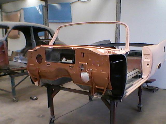

Body work 95% complete and fire wall painted

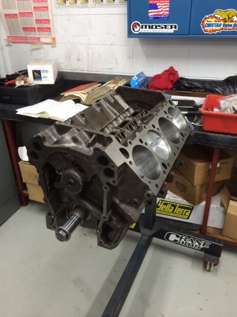

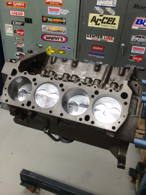

Engine rebuild finally commenced - hope to have the heads on by the end of up coming week end
bottom end all in place, cam in and timing set ( have gone for a 456 stroker kit - not without its head aches)
Thanks to Big M have managed to find a 62 727 Push Button trans to fit my new 440 crank as the late model crank would not bolt up with the original torqueflite trans

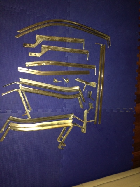

Firewall - still need to paint over the body deadener

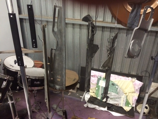

Prior to chrome plating - my coach builder rebuilt one of the rear window front support frame as the original was totally rusted thru

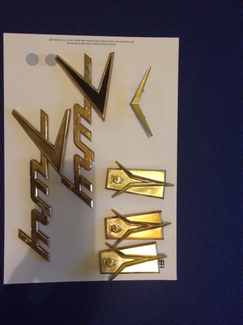

Prior to gold plating

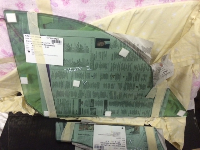

stripped and ready to paint for new glass

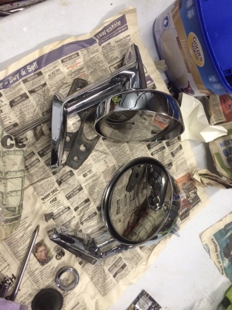

new re-chromed mirrors
new glass

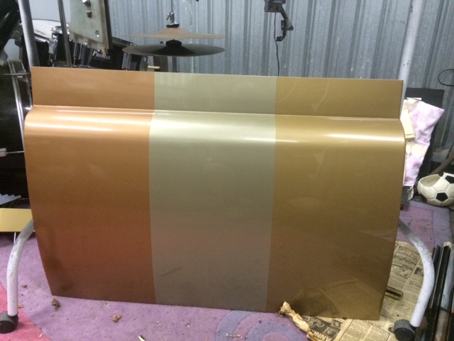

paint samples - tweaked a little - going with the LHS

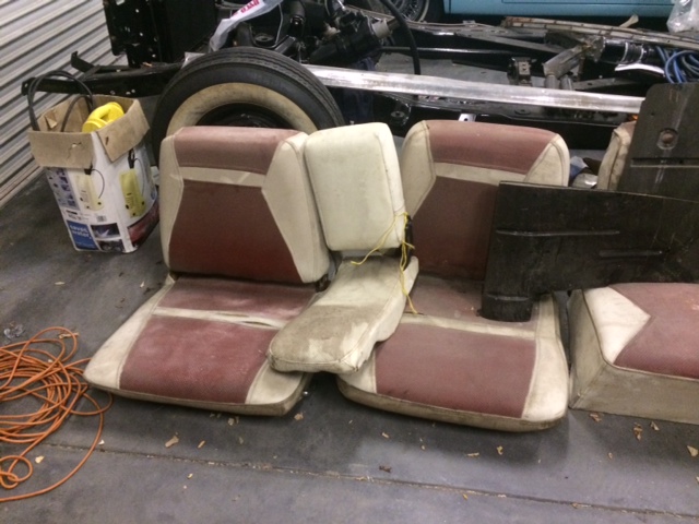

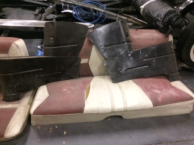

seats ready to go off to upholsterer
Vic, if you need any info, measurements or pics of the upholstery let me know.
The front seats look pretty good but the rear seat isn’t like it should be.
