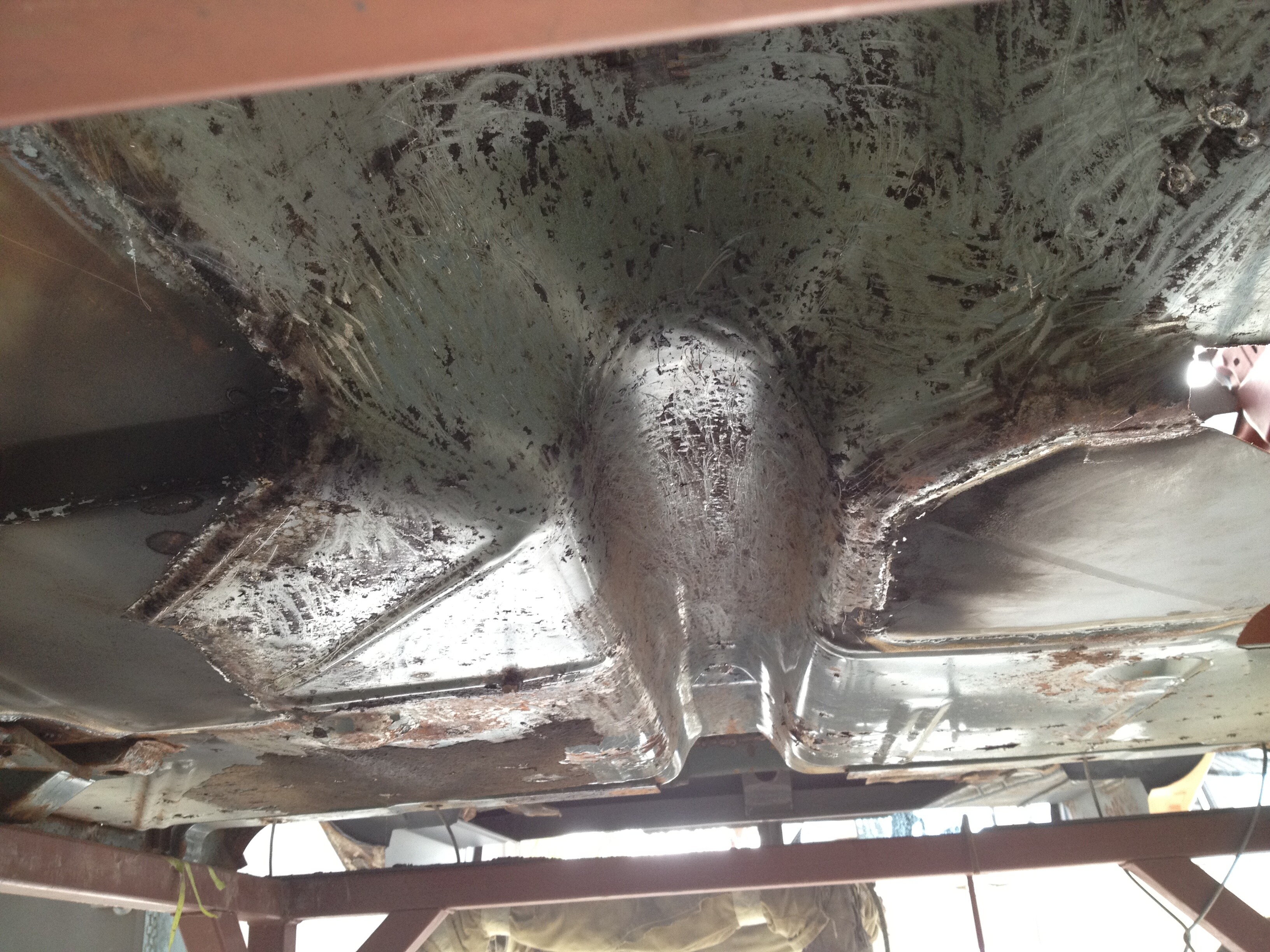

Was working on the car this weekend - mainly the floors - getting it ready to do more cutting out.
I have replacement panels, however was thinking of maybe using a 4dr Pillarless floor to do the back half.

Some more pics of my weekends endeavours - boy do i hate scrubbing the old tar off!!

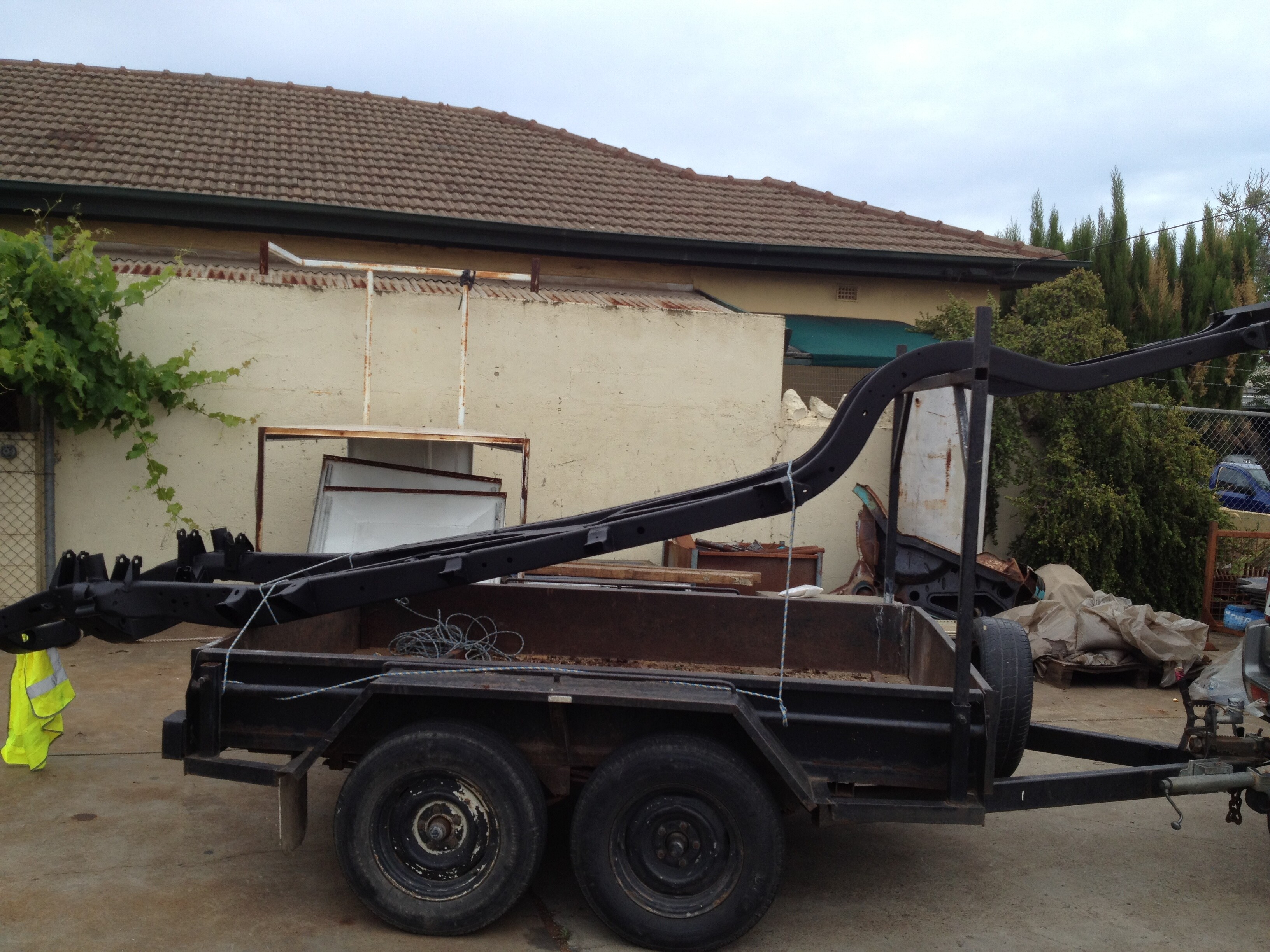

Current Update
Have finally got a rolling chassis back up and running ready for the motor which is finally started after so many run arounds from two mechanics. The body is almost ready to start the paint work and I have now started taking down all the little odds and ends to have ready to start mounting back onto the car. After much debate and deliberation I have chosen to not proceed with my 361 as it would have needed to have been taken out to 60 thou and although I the feed back I was given said that this would still be ok for this type of block, - just dont want to run into over heating problems once built. I have decided to build a 383, I managed to find a standard core engine for only $400 (not sure how this compares in the US) but this is not a bad price for AUS. Since I am no longer an original engine I have decided to also run a 456 storker kit thru it with a very mild cam. Will still be running the stock exhaust manifolds so that it still looks the same on the outside. I have recently sent off my dual carbs for a total rebuild and hope to get them back in the next week. Turns out they are 1957 Carter WFB - must say not a bad score for only $50 (inlet manifold and carbs ) back 20 years ago. ![]()
I have put in another order with Gary Goers for some fire wall pads, heater box cardboard and some other small rubber parts. Wont hold my breath though as I know he has a back order but none the less the goods are always good and he always delivers
I was talking with my coach builder the other day and he mentioned that i need the shoulder bolts for the convertible top. If I recall Dick I think you actually got them re made. Is there any chance you would be able to give me the details of the local shop that did them or if you are prepared to sell the old ones I would be interested in them

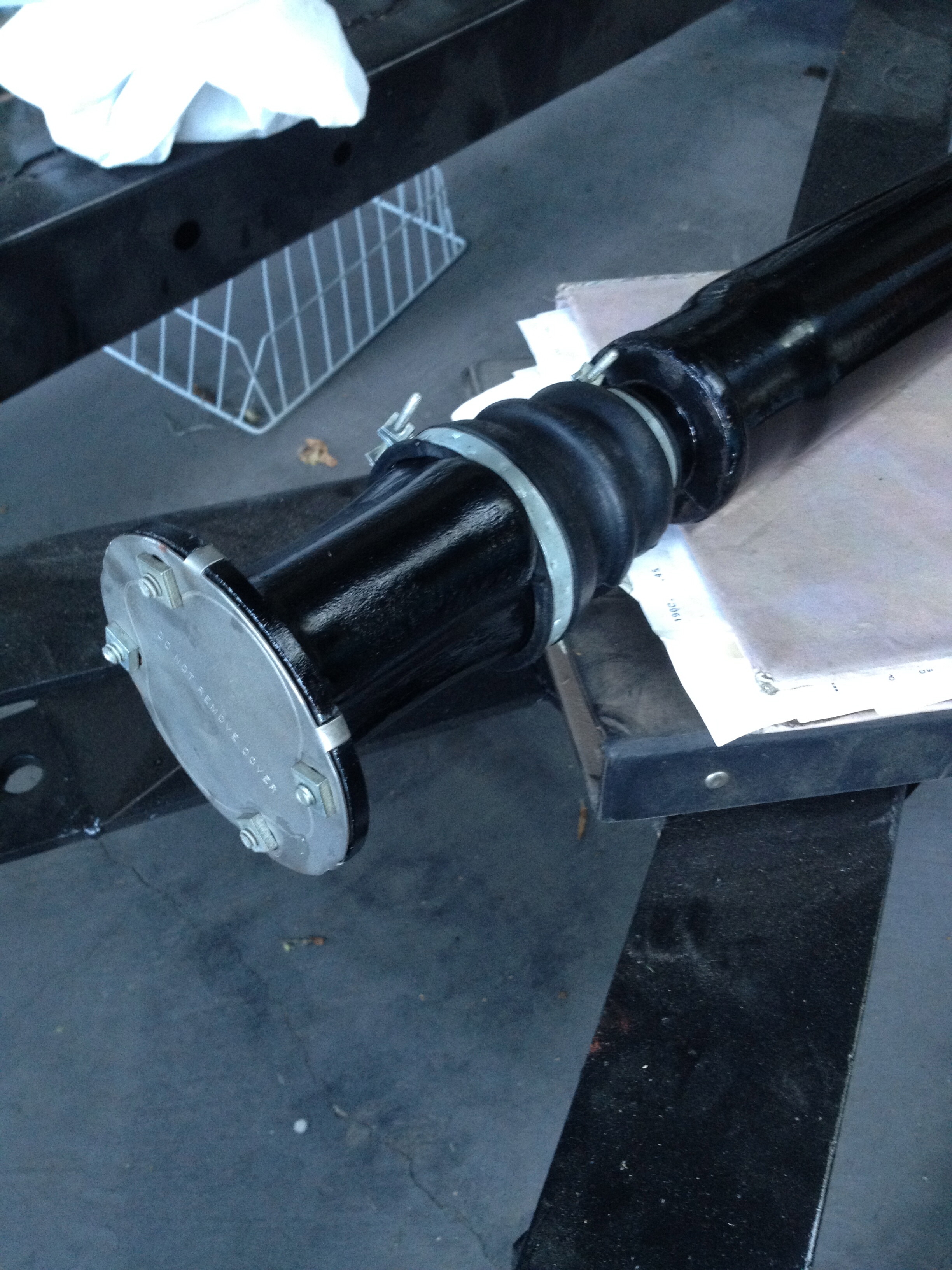

I have managed to rebuild the tail shaft with trunion bearing (i think that correct) so that its al ready for when the engine and trans get dropped in.
If all goes well looks like this might finally be the year that I get this car on the road ![]()

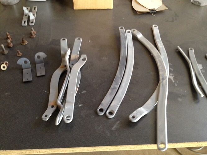

Vic - Talk about detail, you are doing pretty good youself. What happened to your shoulder bolts? The ones I have are destroyed but I kept them (Just in Case). If you have your old ones a good old school machinest should be able to duplicate them. Meanwhile I will bring my old ones to my machinest and see if they will make me a set or two. Will get back to you.
Vic - The shoulder bolts I had made are the ones for the folding frame itself. 4 on each side, each one different. There are two more larger ones on each side that mounts the frame to the car. Do you need these also.
Opps!! There are Three (3) larger ones on each side that mounts the frame to the car.

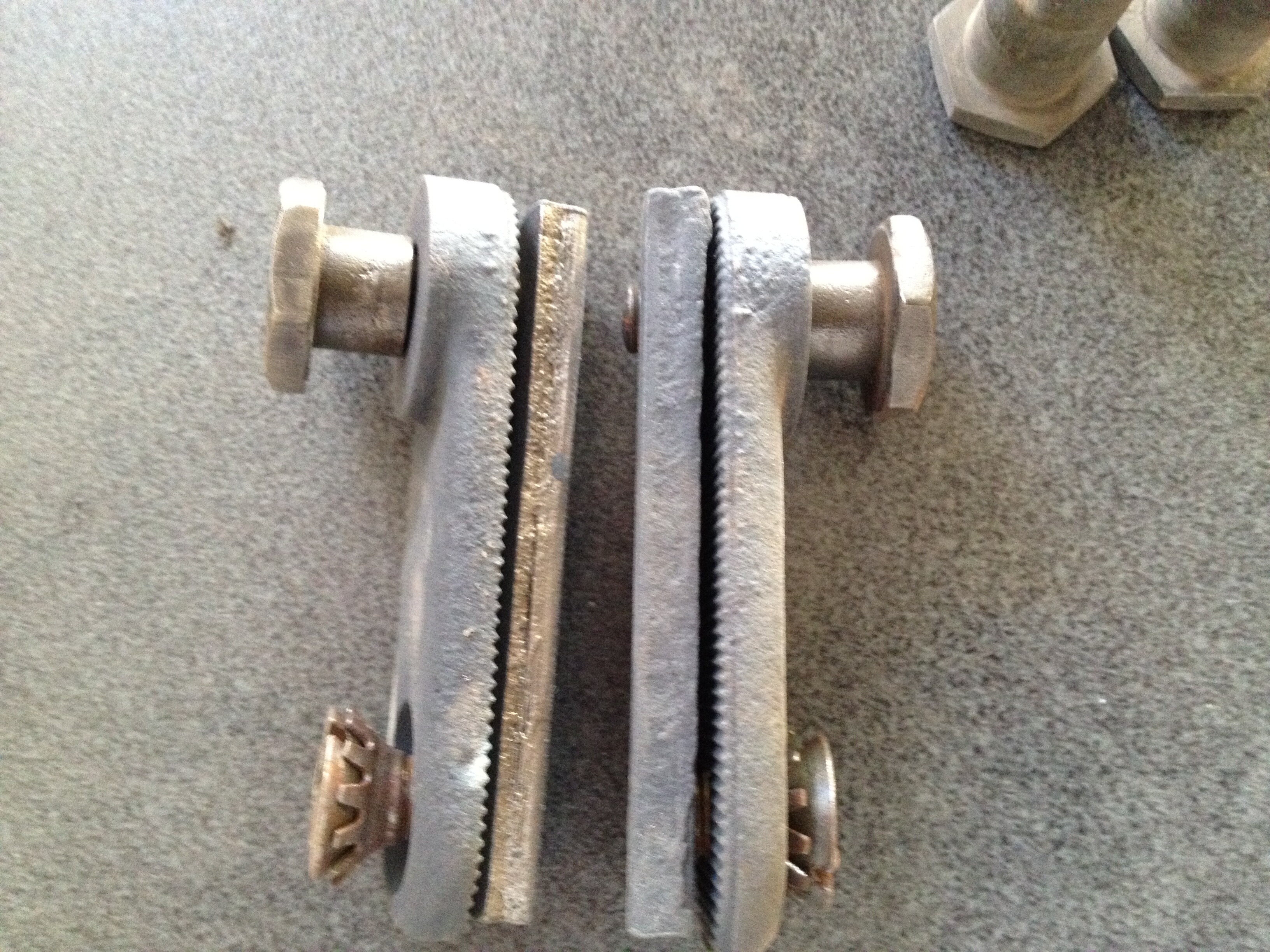

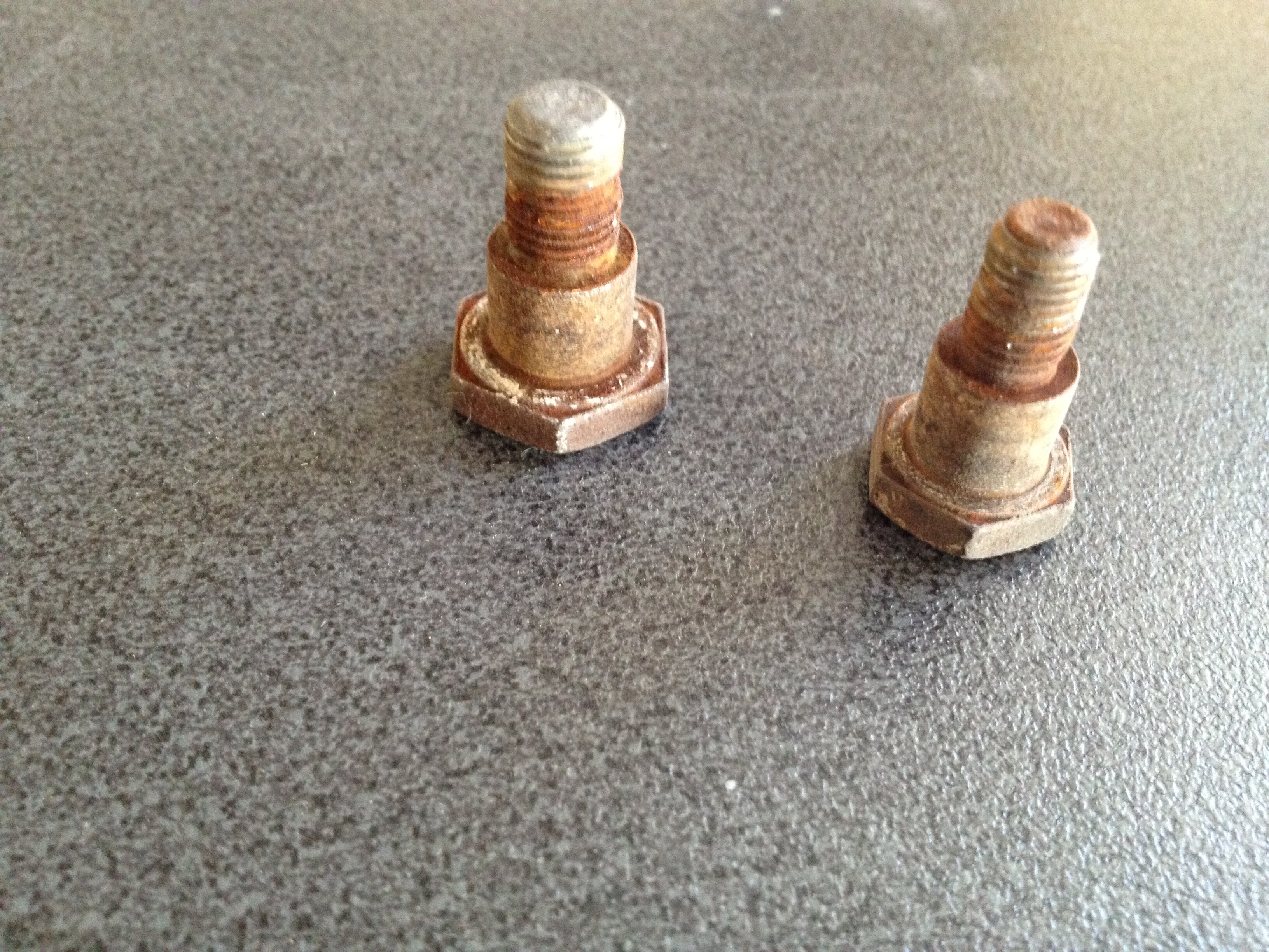

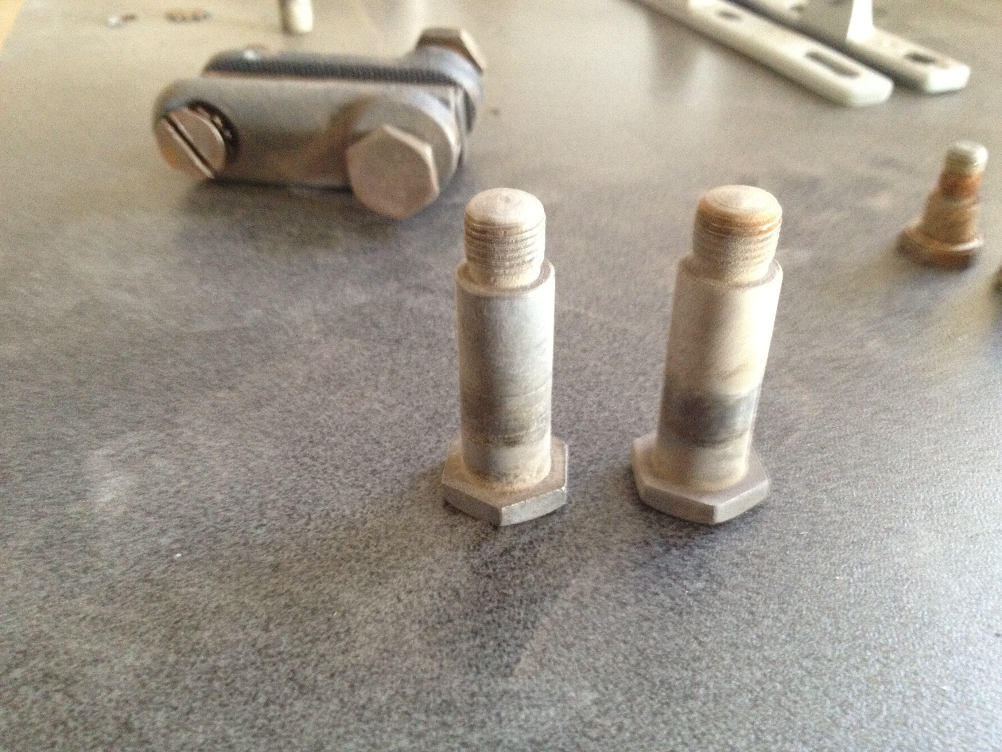

Went to the workshop yesterday and noted that I am missing quite a few of the shoulder bolts. It would appear that i have the 4 main bolts that connect to the rear well i.e. two long shoulder bolts and two smaller ones
I then appear to have a mixture of other bolts including two shoulder bolts with blank heads. I now recall that when i got the car there were normal bolts holding it together
I then spent four hours sanding back all of the frame - boy its takes a long time
to body bolts
long shoulder bolts that mount to body
Any help you might be able to shed on which ones I might need made up or who can supply them would be greatly appreciated
Cheers
Vic
this one is the larger of the blank faced bolts
smaller blank faced bolt
not sure

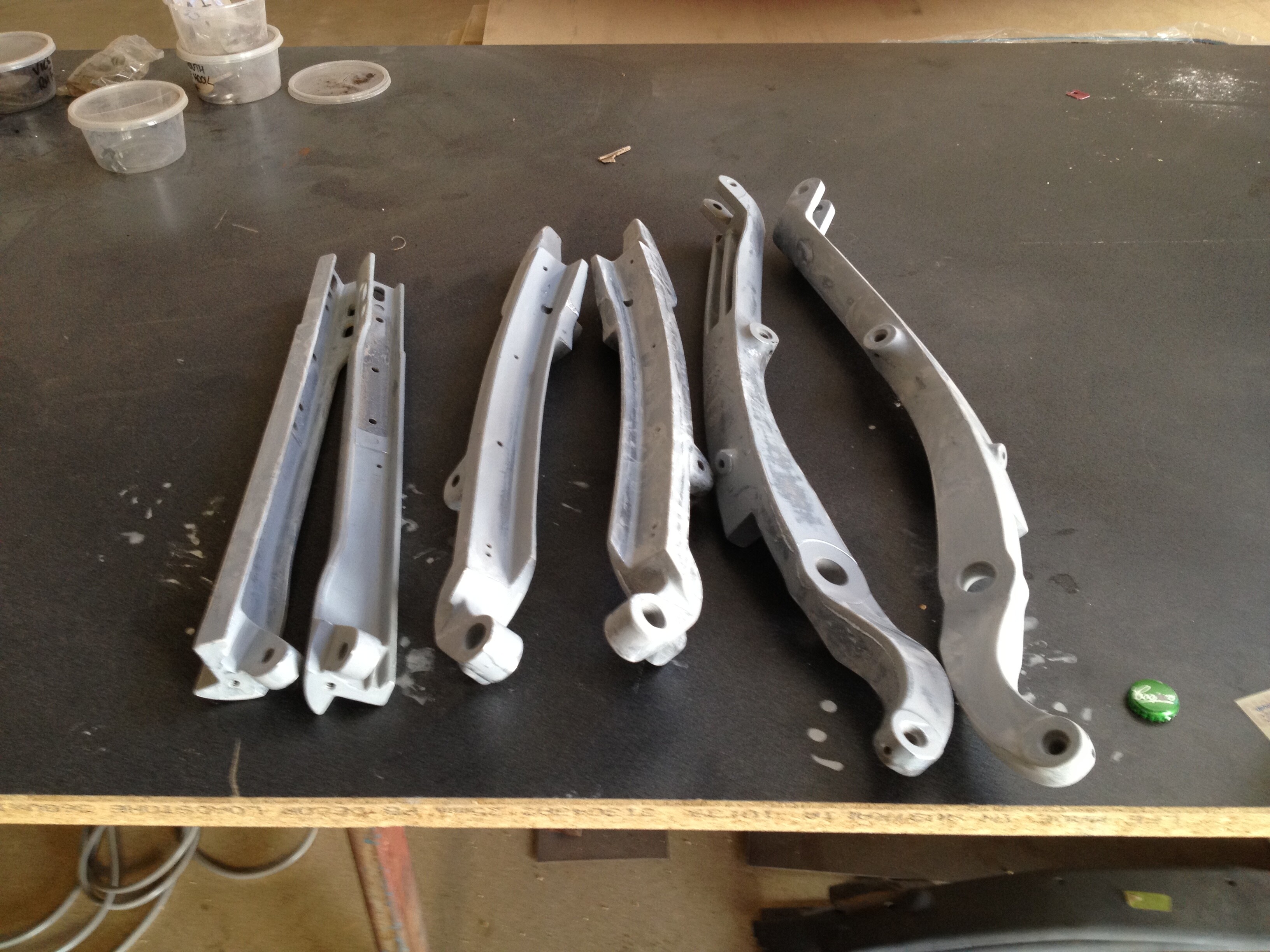

sanded first coat of primer
few more pics

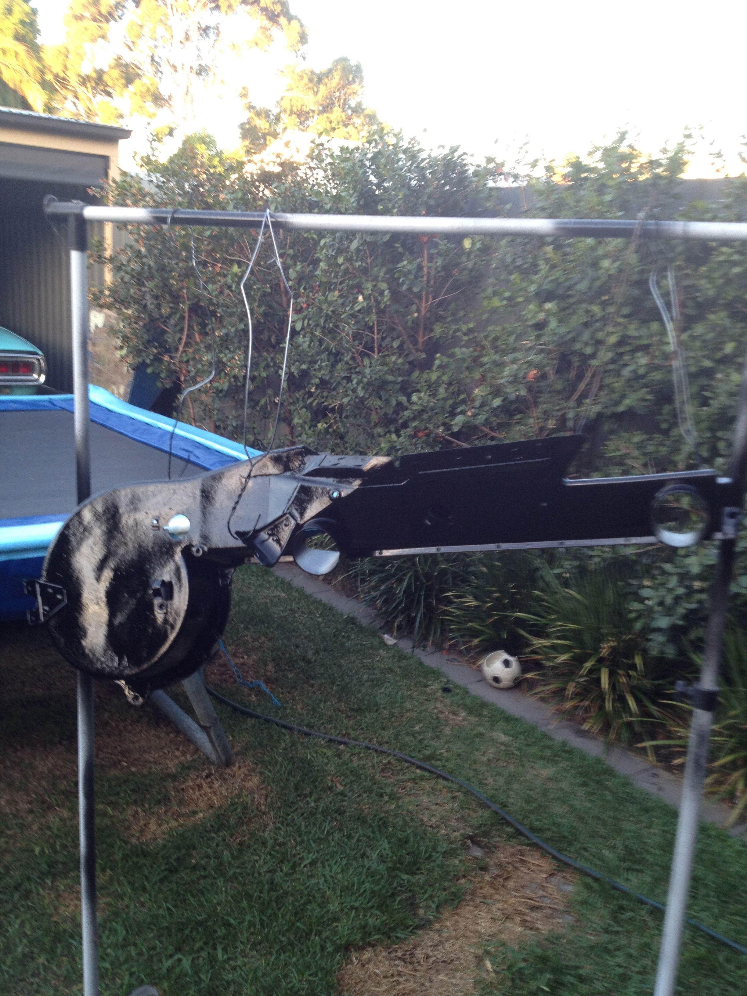

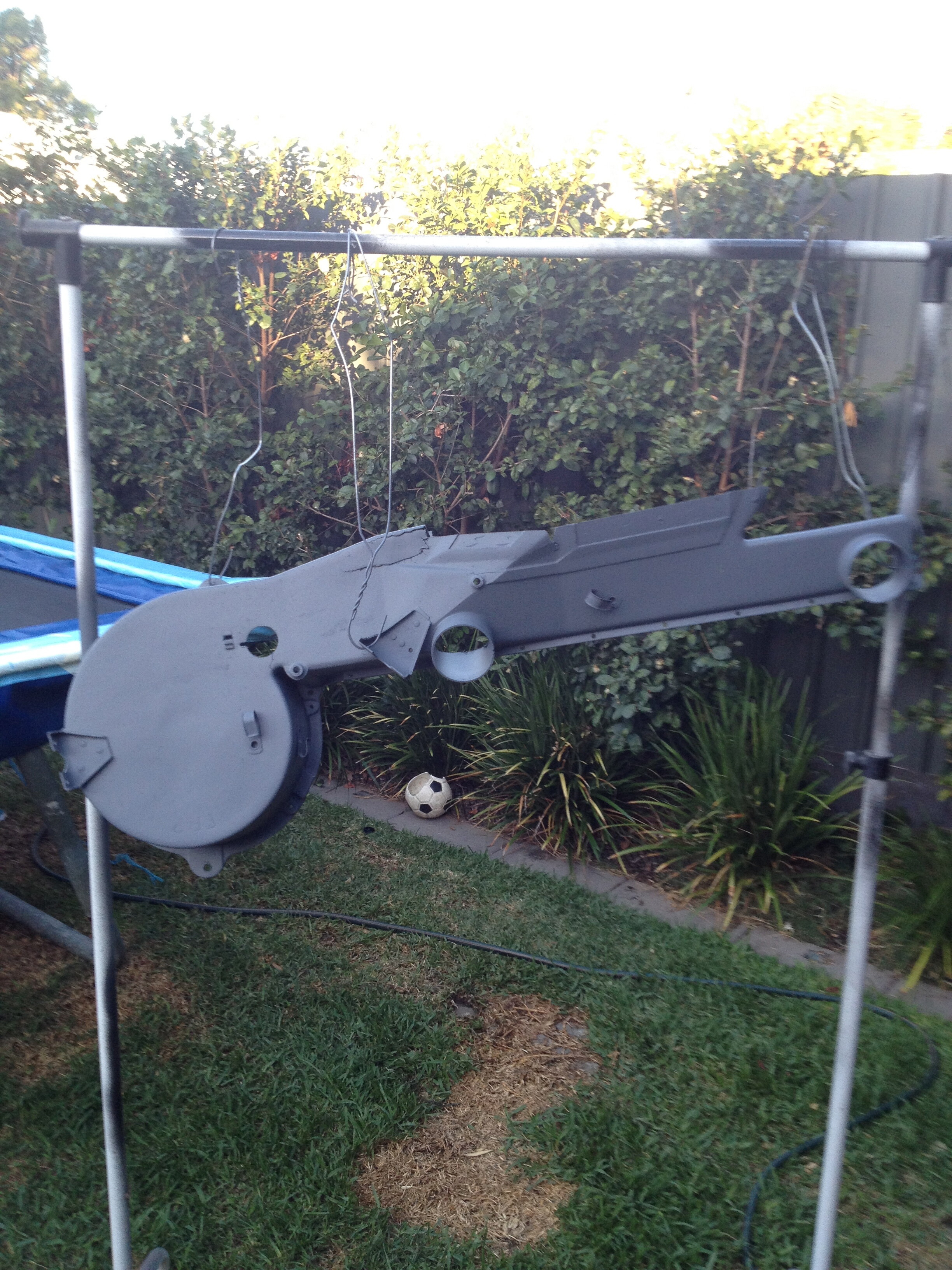

for those of you who dont have a sand blaster. You can use molasses and water to strip the rust off the smaller parts. I mix 10 parts water to 1 part molasses. Let it soak for about two weeks, then high pressure clean, wire wheel and its ready for painting
heres an example
Just watch out for aluminium as it eats it up. Lost my dash mouldings that separate the speedo from the push buttons - luckily had another pair
Happy restorations!
before
dipped and stripped
painted
Vic - Let me start over. There is no way I can figure out what you need from the pictures. I just did a thourough look see and this is how I see it:
Each side on the main frame has: Five threaded shoulder bolts with a head. Two of them with Phillips slots.
One long threaded bolts with no head but slotted for screwdriver.
One long pin with a cotter pin.
One short pin with a cotter pin for header bow.
Each side for mounting to the car: Three threaded shoulder bolts with a head. The largest one has two wavy spring washers.
One long threaded shoulder bolt with a head to mount the cylinders to the main frame.
Each and everyone of the bolts are all different. I will get a price from my machinist for a complete set (both sides) if you would like. Let me know.
