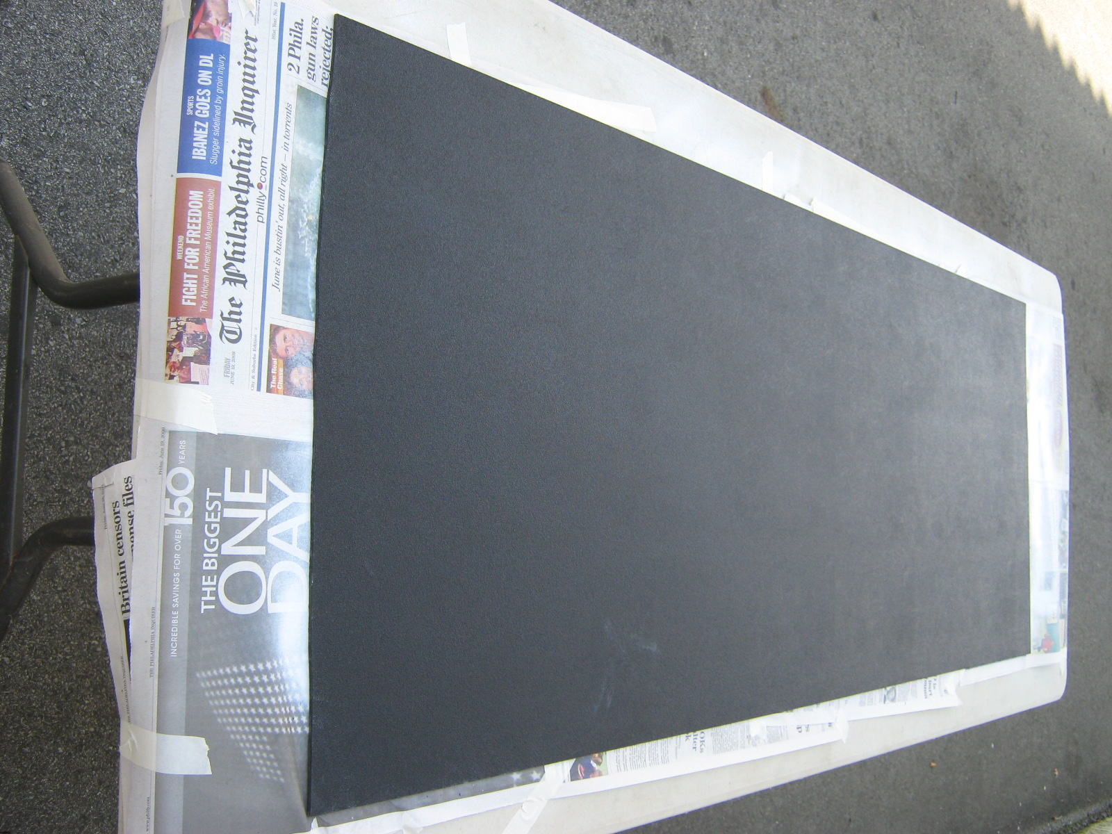

The first thing we did was cut down the ABS center panel to the right length. We marked it carefully, then, with Matthew and I holding and Andre manning the jigsaw, we made the cut. The blade traversed the panel, and when it got to the other side – we realized it had welded itself back together, across the entire length! As the blade cut, it welded back together behind it. This is not going to be so easy…
We snapped the end off and cleaned it up with a file. Andre and Matthew put it in place, holding it up with the clips I made from my extra Caravan strip – perfect. Now, to tackle the side pieces.

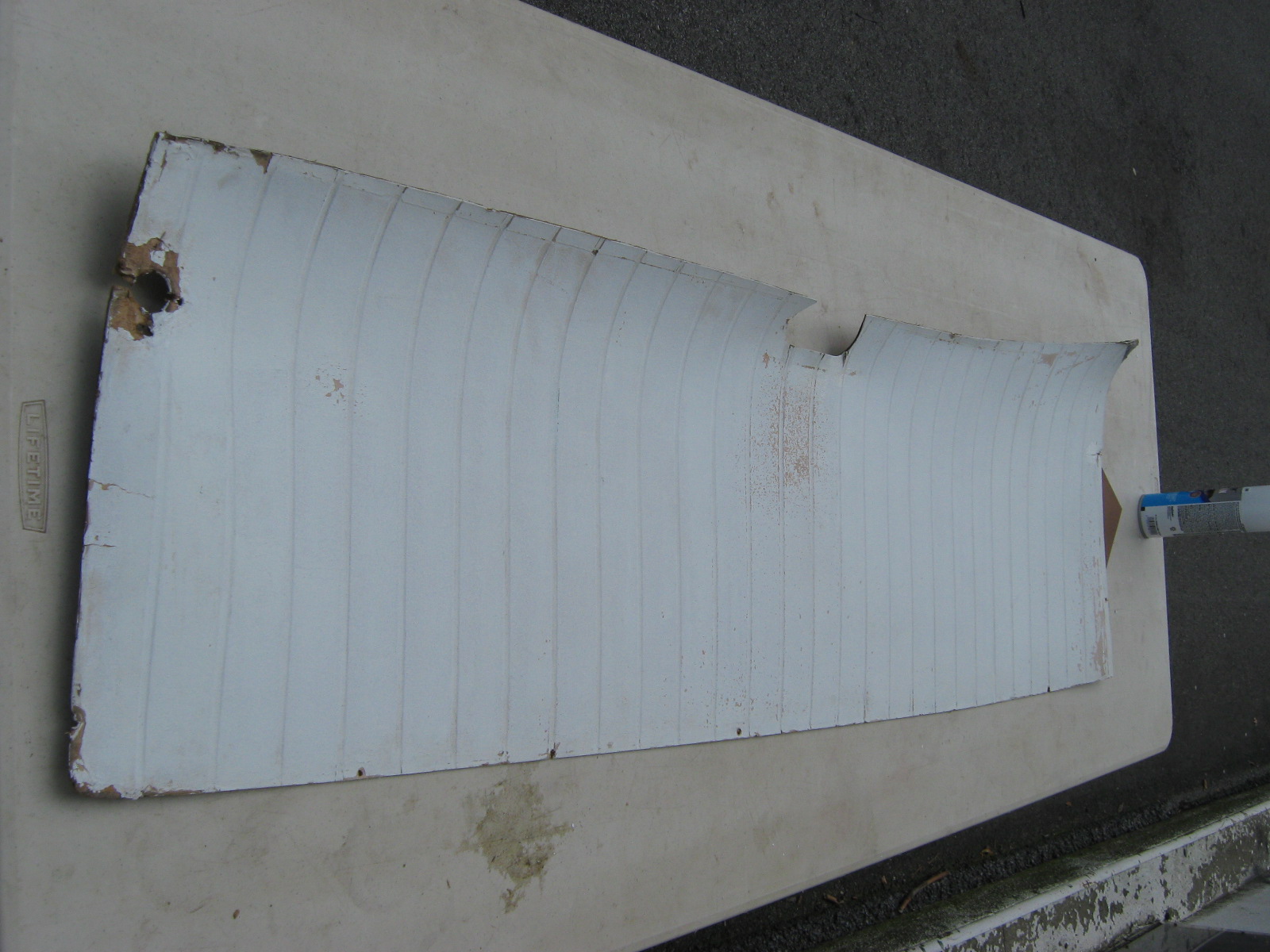

Ed and Ruth graciously welcomed us, as they always do – and Ed showed me the panels. Hey, these are not bad! They need sanding in spots, and the paper cover had separated in spots from the cardboard, but it could be glued back down. Once painted, these would be just great for Faulkner. I asked Ed if, instead of borrowing them as a template, if I could buy them from him. Ed said, NO – they were mine to keep. :smiley: :smiley: :smiley: :smiley: :smiley: :smiley:

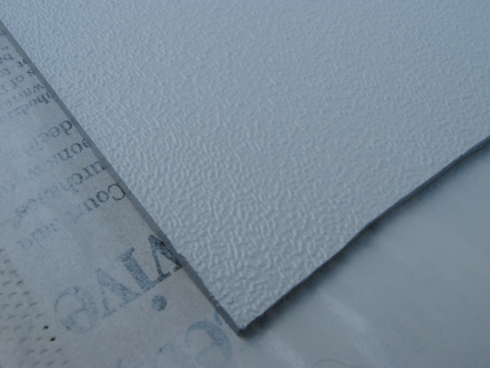

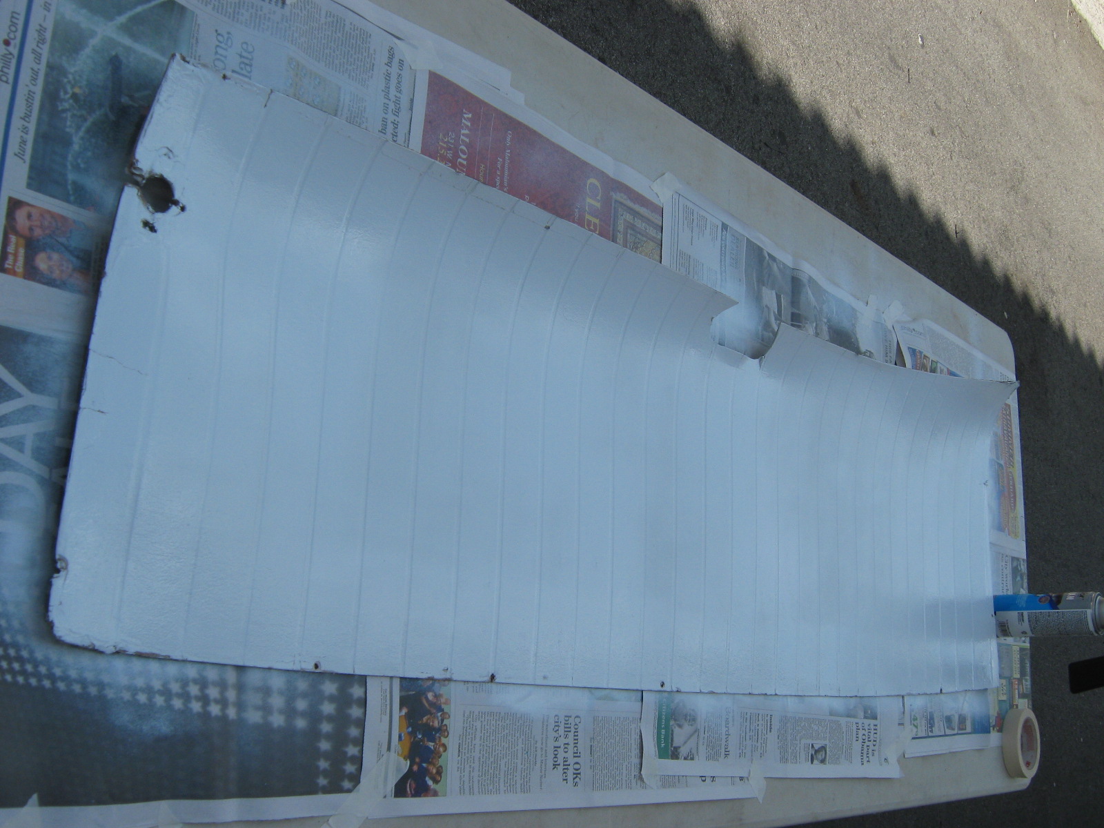

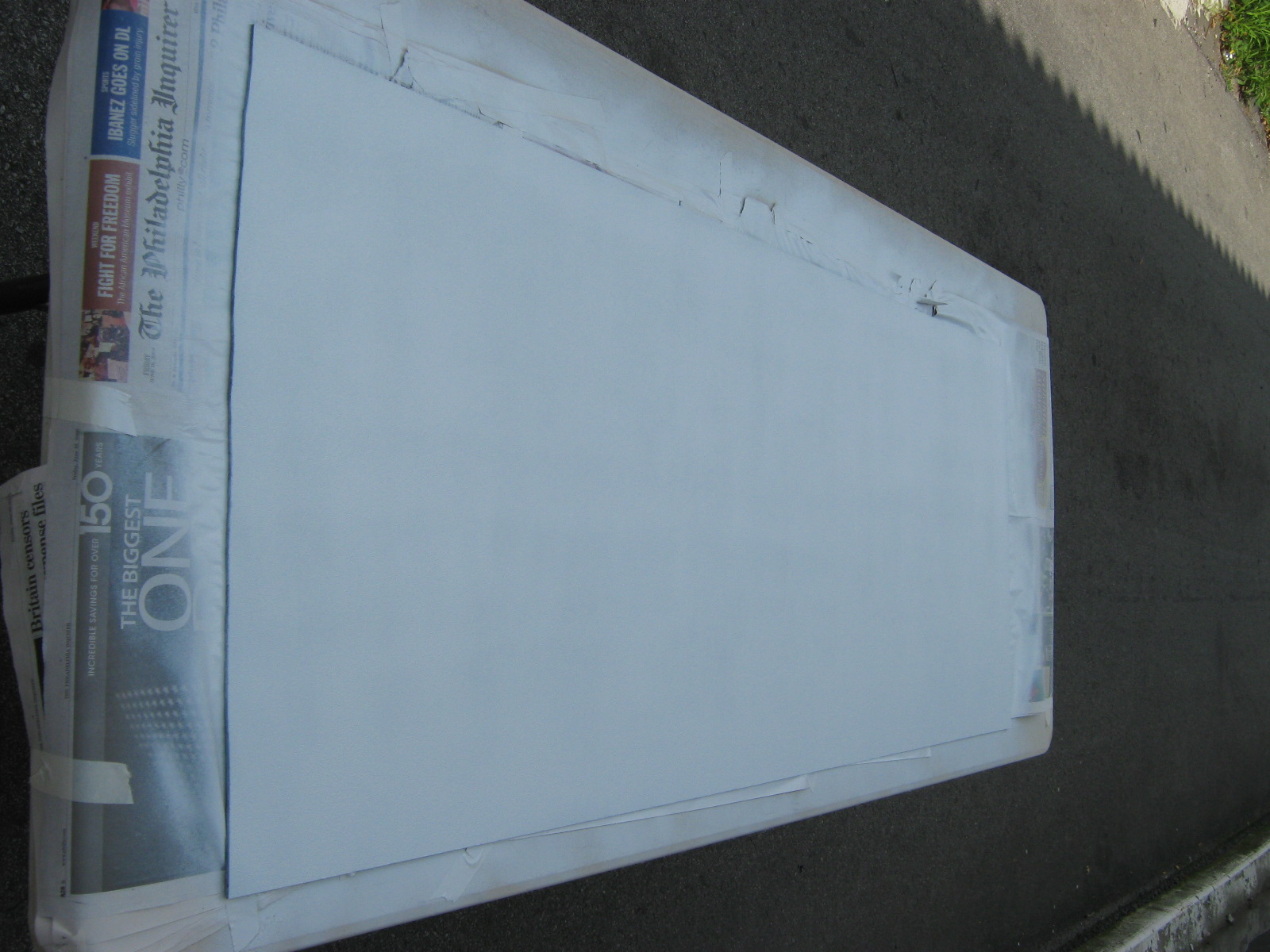

The panels cleaned up very nicely – here are some pix. All told, it took 4 cans of white spray paint – one for each of Ed’s panels, and two to cover the black ABS center panel. No need to cover anything with fabric – the ABS has a nice pebbled texture, it will do just fine until a perforated panel finds its way to me. (Anyone looking for some perforated headliner fabric, let me know – oh yeah, I got ABS too!)

panel one of two, after sanding but before painting
after painting! the second came out just as nice
ABS panel before painting (but after using vinyl prep)
ABS after painting
pebble texture of center panel

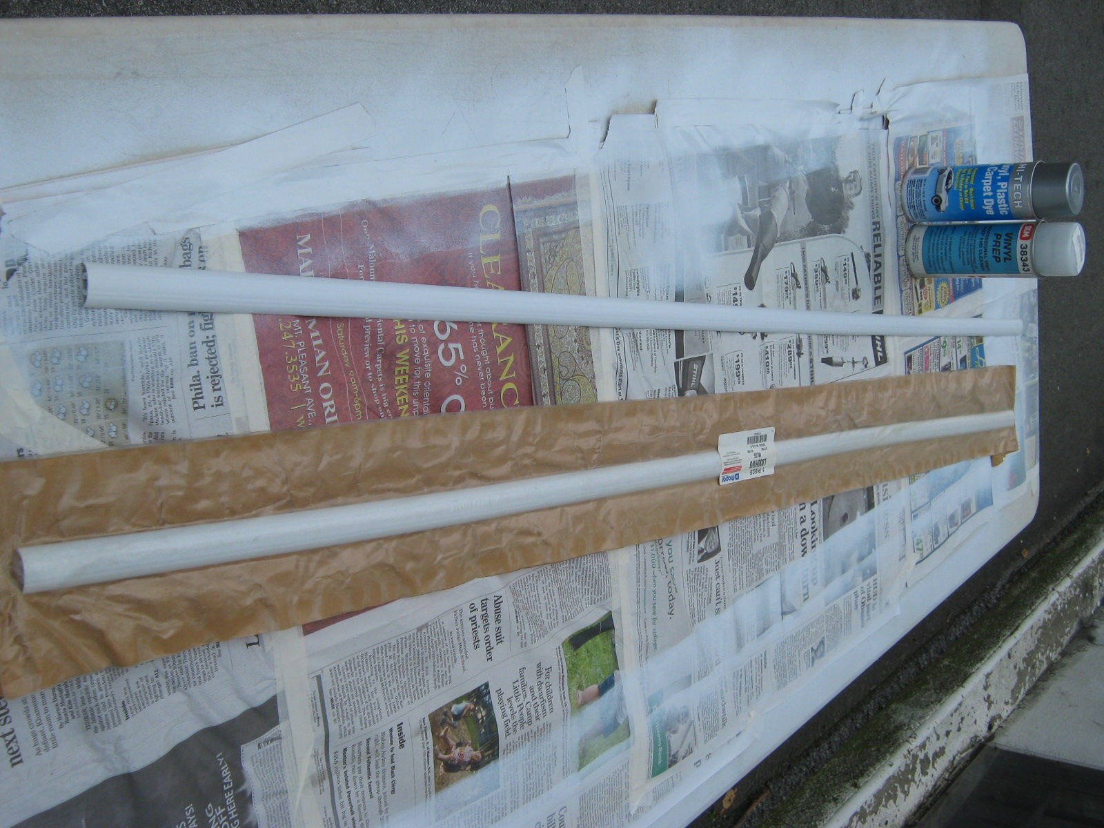

Dodge Caravan strips are perfect replacements for the headliner strips – but, they’re white

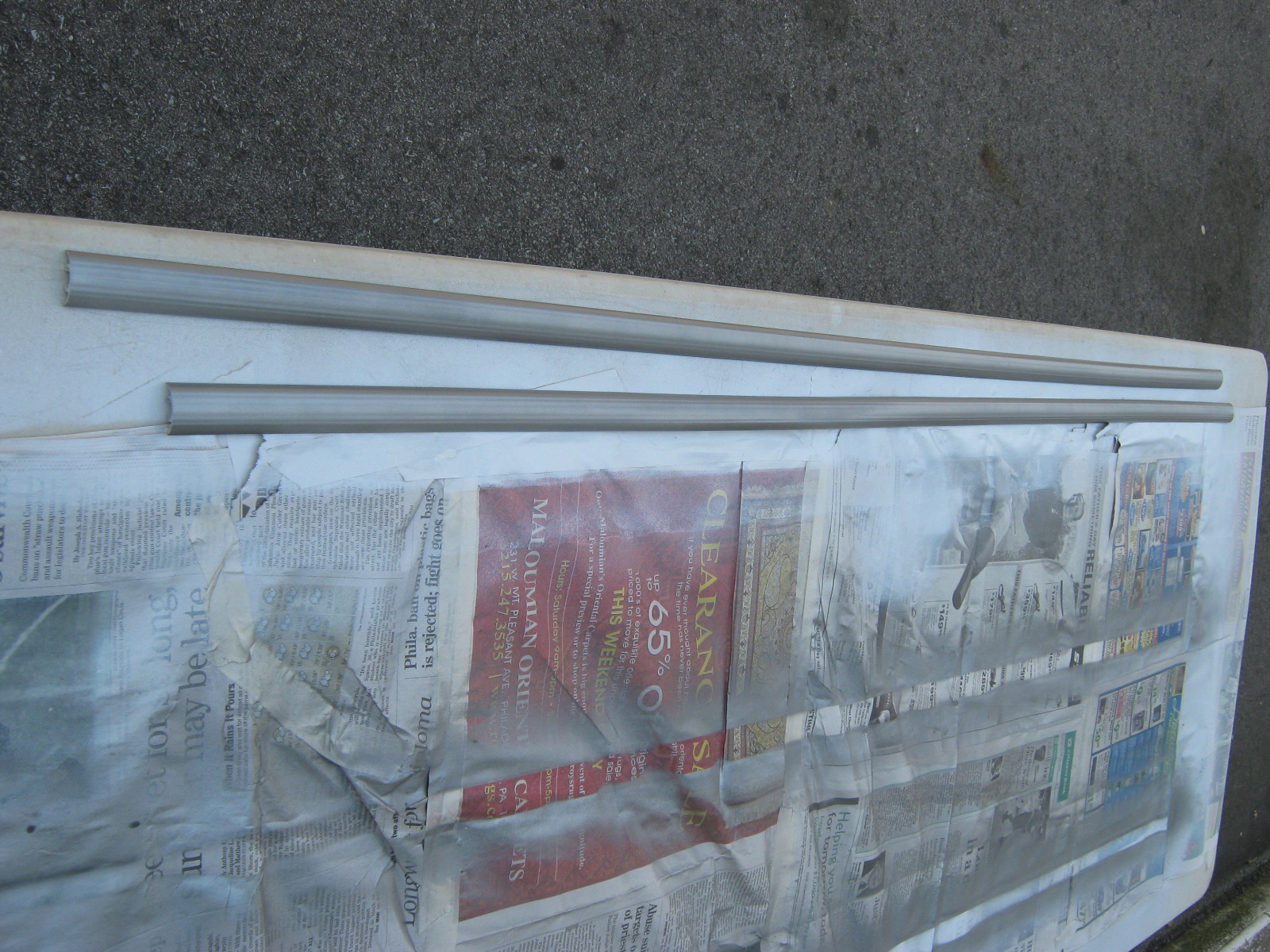

after painting silver
