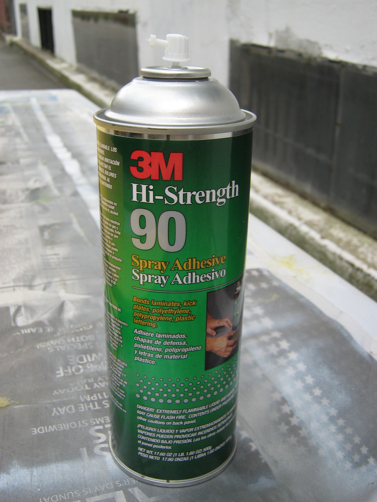

Ordered the ABS plastic, and bought a heat gun. I think I’ll pick up a handheld jigsaw to help with the cutting… The ABS comes in 4’x8’ sheets, they’re cutting me four panels of 2’x5’. So I can experiment with molding the corner with the scrap pieces, and I’ll have a full panel in case I ruin one. I have one can of 3M 90 Spray Adhesive – I think I’ll pick up another, 'cause I don’t want to scrimp on that.

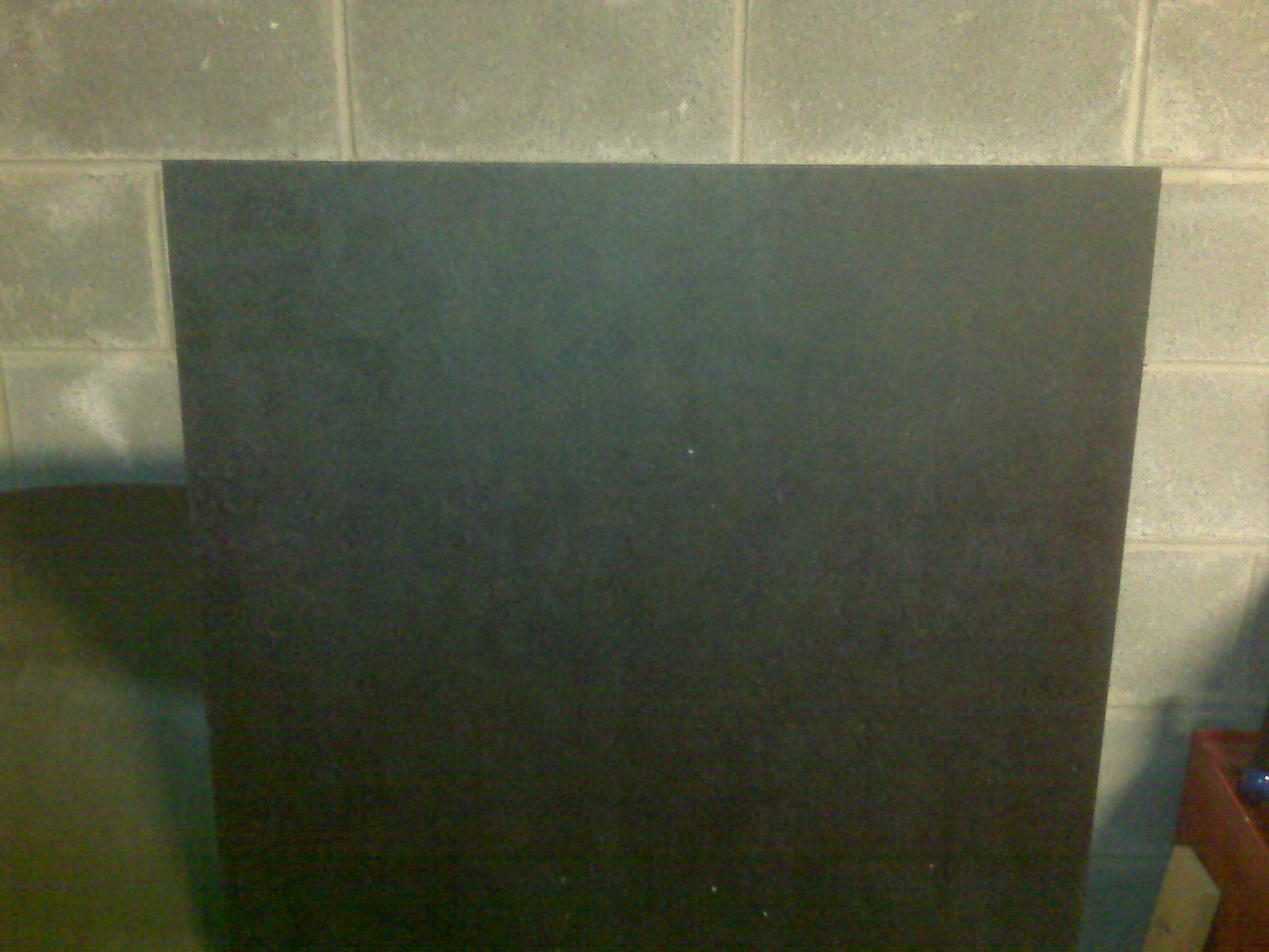

Here’s a not-so-good pic of the ABS:
It comes in 4’ x 8’ sheets – I asked them to cut both sheets down to 5’, and cut the remainder into two 2’ x 5’ pieces.
Then I thought better: The middle headliner section is 22 3/4" wide – I asked them to cut to that exactly, and then I’d only have to trim the one end. They did it, and I held it up – fits perfect!

The panels cleaned up very nicely – here are some pix. All told, it took 4 cans of white spray paint – one for each of Ed’s panels, and two to cover the black ABS center panel. No need to cover anything with fabric – the ABS has a nice pebbled texture, it will do just fine until a perforated panel finds its way to me. (Anyone looking for some perforated headliner fabric, let me know – oh yeah, I got ABS too!)

ABS panel before painting (but after using vinyl prep)
ABS after painting
pebble texture of center panel

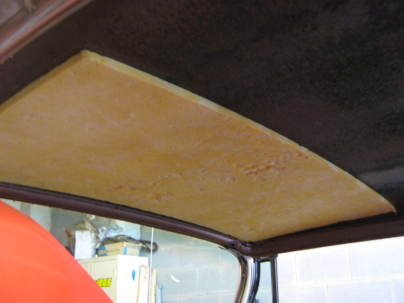

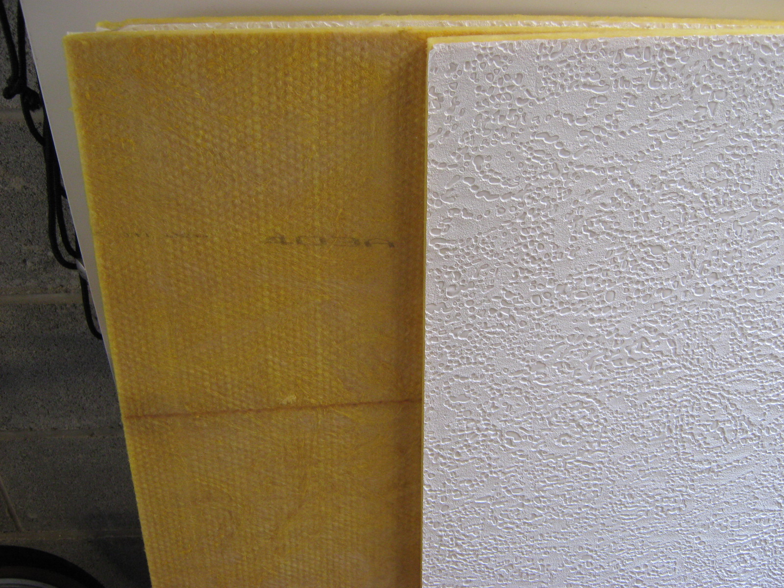

I went back to Home Depot and bought 4 of the 2’ x 4’ drop ceiling panels (it turns out, 3 is all you need) – they are 1/2" thick, and it turns out that is just perfect for the one tight spot between the rail and the roof.
The white vinyl facing easily peels off…

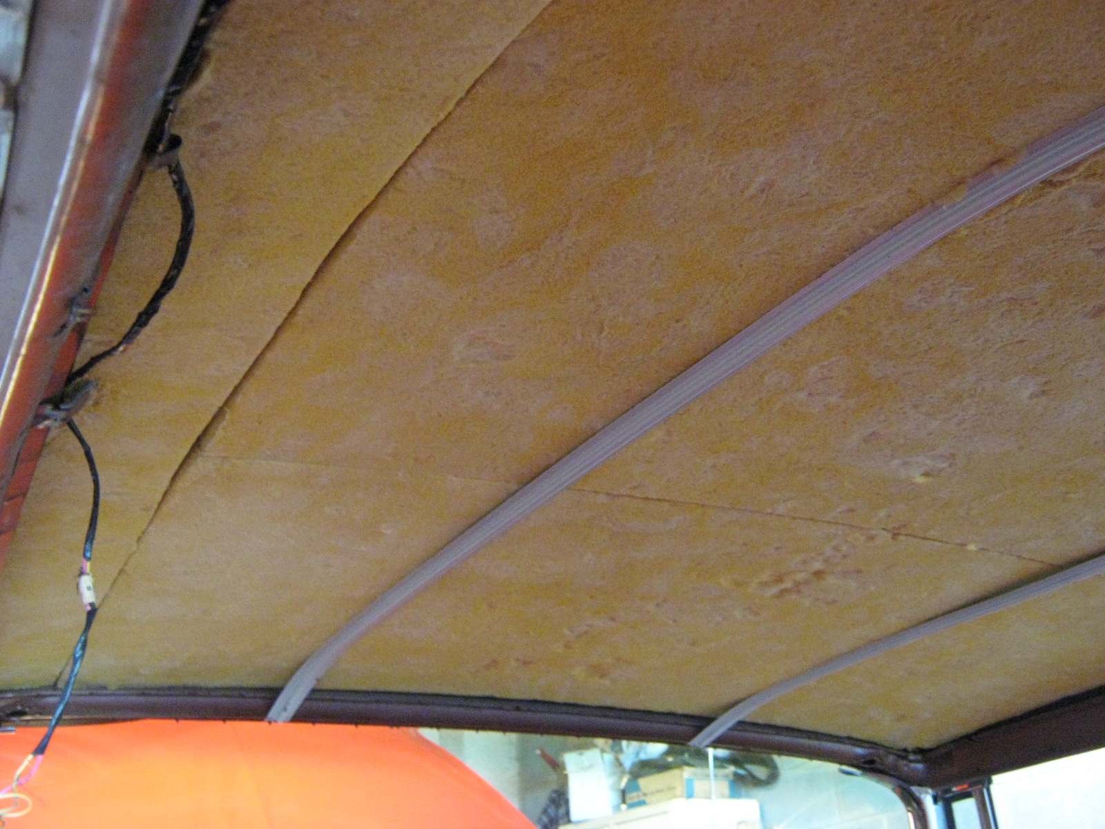

I used the 3M glue I was going to use for the headliner fabric to glue the tiles to the ceiling
You have to work fast, and you have to be careful – once it touches down, it’s locked in place! Here’s a pic of the first piece up
And here’s the roof covered with insulation, with the rails back up
