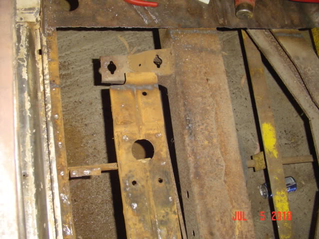

Floorboard work- Not my favorite part of the job, but there were just too many pinholes and soft spots to allow the old floors to remain. I drilled out the spotwelds, and cut a clean line beyond the rust damage to reach good metal.
With a bit of chiseling and prying, the old floor was removed, leaving the reinforcements, body mounts, and outriggers. These appeared rusty, and there was quite a bit of loose dirt and silt among them, but this all cleaned up easily. The reverse electrlolysis had done its job even beneath the floor.
Note: The body is setting on a frame that will not be used, only as a jig to prevent distorting the body while doing this. Also note that one of the main body mounts was missing, it fell off when cutting the floor. Upon closer inspection, you can see that the factory had tack welded just a corner of the mount!
