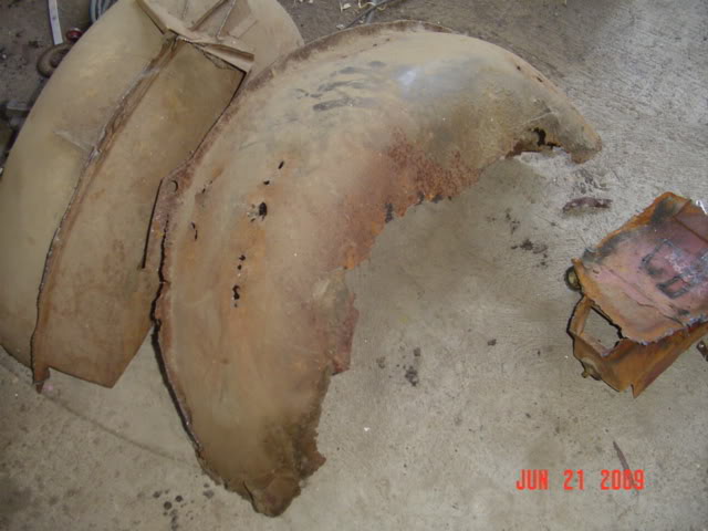

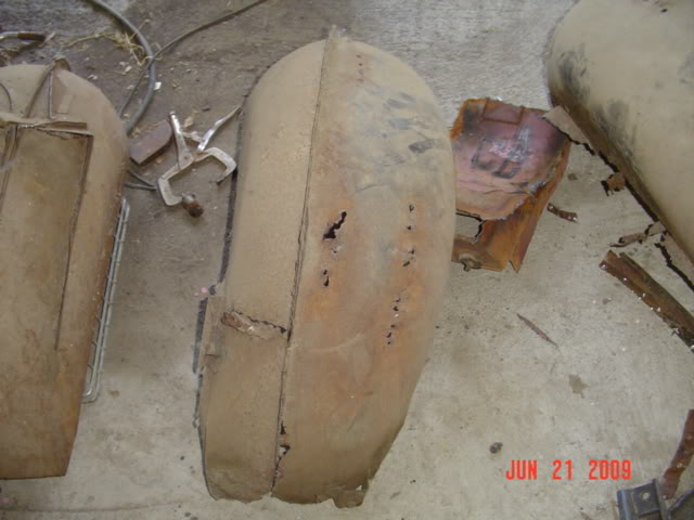

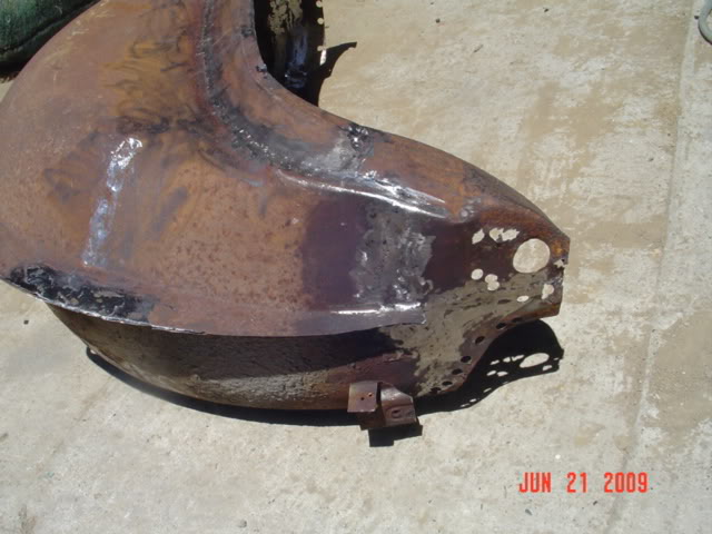

After some research, [Thanks, Roger] I found that I needed to use the convertible rear inner wheelwells, as they were completely different from those of the hardtop. The originals from the convertible were like lace curtains, not much left. I found a pair that were a bit better after searching for a year. The one on the top fits the hardtop, the one on the bottom is the convertible one.
This pic gives you an idea of the extent of damage.

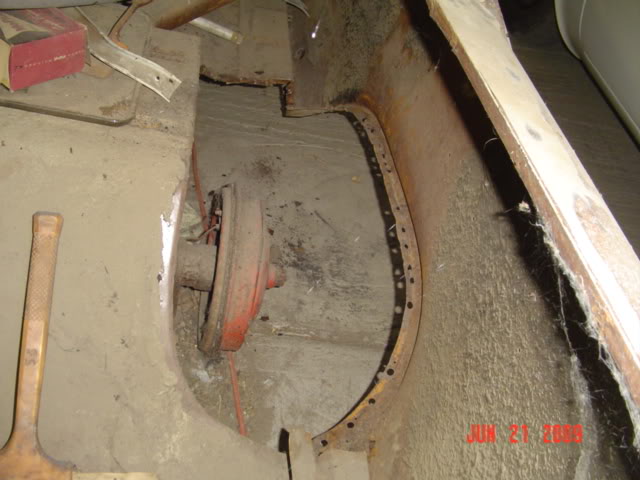

I carefully removed the spotwelds from the wheelwell in the hardtop body. I took my time, as I would be using the lower section of this well.
I had to use and modify sections, and repeatedly fit it into the body of the car. There was no room for error.
Here is the inside that will connect to the quarter panel, welding completed. Butt welds were used in order for the weld not to show on either side.

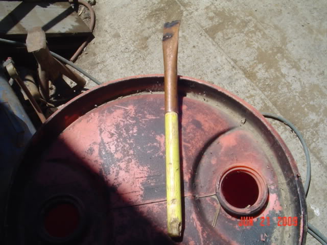

Here’s a simple tool I made from a piece of copper pipe, fastened to a piece of broomstick. Used to hold behind the steel when welding small holes, reduces the need for as much grinding.

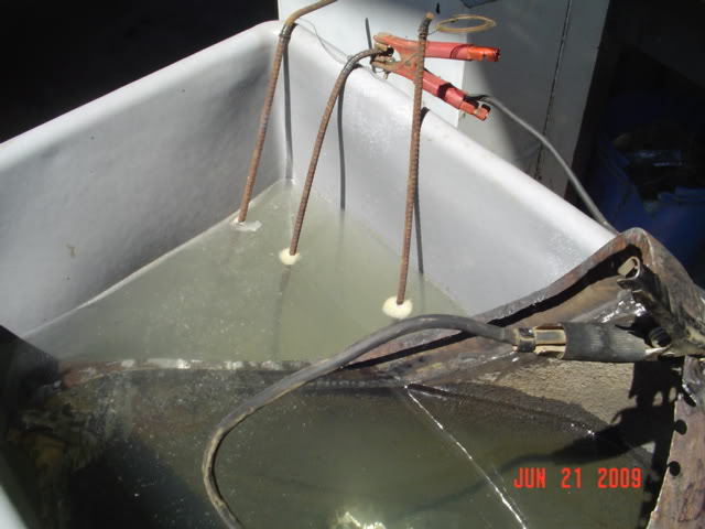

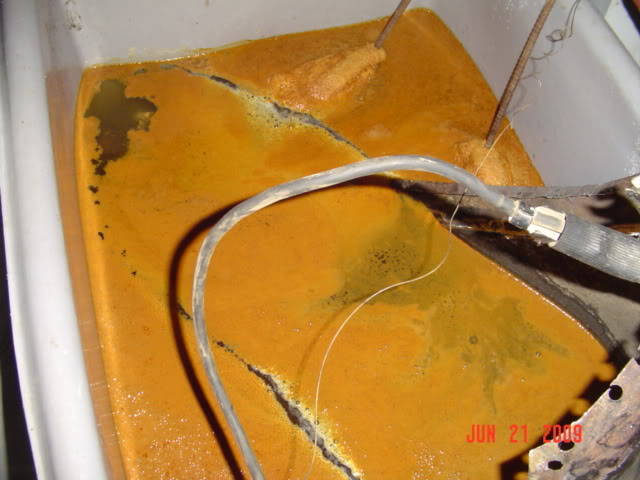

Electrolyte bath- using reverse electrolysis to remove any heavy rust.
After running current through the solution, Here is what it looks like-

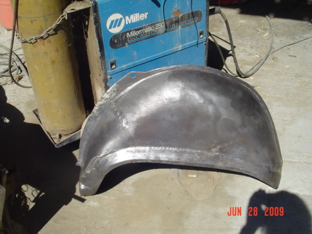

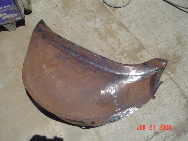

After allowing the fenderwell to de-rust for a few days, I removed it from the electrolyte, and wire brushed the black residue from the surface.

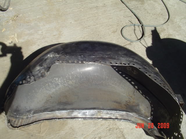

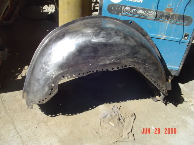

Here is the completed wheelwell, ready for re-installation into the body.

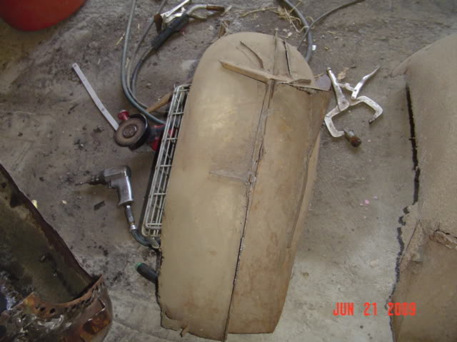

The inside of the wheelwell still had heavy undercoating in the upper areas that the electrolysis did not touch. It did loosen, and I scraped it off with a putty knife. Note, the original grayish primer is intact beneath it.
I will tack weld this wheelwell back in place, and the next step will be to do this same process on the passenger side well. The one side took over 60 hours to complete, so there is nothing to hurry about.

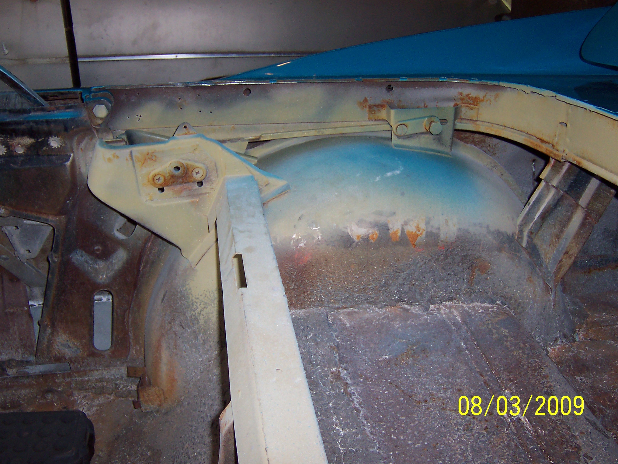

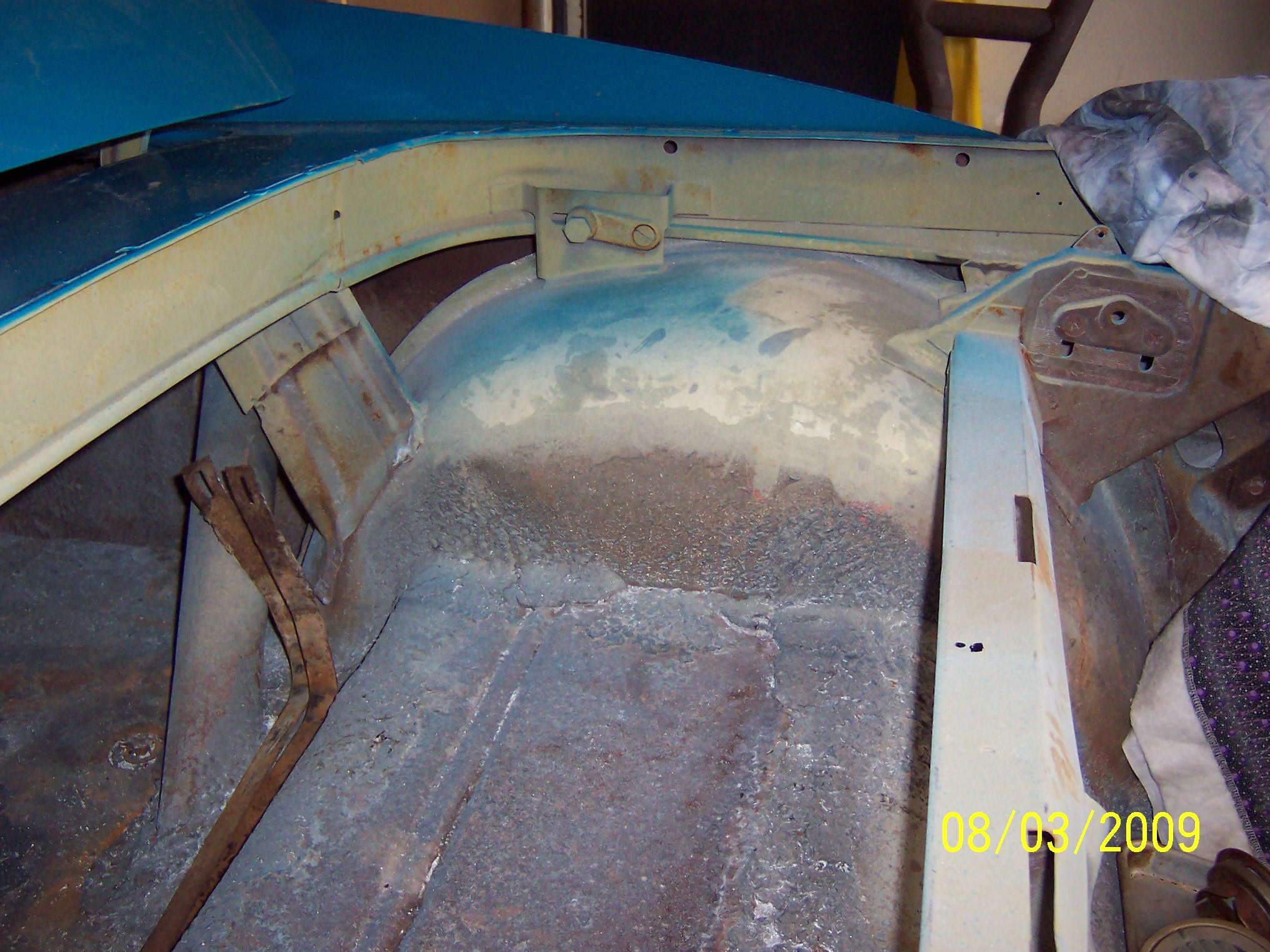

Big M (John) , If you need any locating dimensions taken from my convertible while it is still apart let me know. It might be helpful checking critical measurements before final fitting and welding.
Looks good! Another one saved!
John Q
Passenger side convert quarter
Drivers side convert quarter
John thats incredible. The electrolysis process has me mystified. What is the electrolyte and how much current and for how long do you do it? I imagine you can reuse the electrolyte? About the only somewhat intelligent thing I came up with when doing my convertible was a solution for coming up with the missing tranny cross member if you have to cross that road I can help you with that one. Great work!

There are two things that I will need some details of, the first being the small stamped steel piece welded to the front of each wheelwell, used to divert the water from the boot area down into the fromt of the wheelwell where it can drain. There wasn’t enough of anything left of these to even roughly determine their shape.
The other thing is the extra body mount that a convertible uses. I believe it is somewhere in the vicinity of the top ram mounts. This is not an immediate need like the other pieces are however.

The electrolyte is simply water, and washing soda mixed together until saturation. The suspension allows a small electrical charge to pass through it.
You can use Arm and Hammer washing soda, or here, I used the brand that Borax sells. Baking soda with a small amount of detergent mixed in works as well.
There are no environmental problems with the water that is left in the container, it can be poured right on the ground. Of course, the rust may stain concrete.
I use a battery charger for the current, I set it at a 40 amp charge, the electrolyte will only allow 3 amps or so to pass through it, so the setting is really not important. Just be sure no one moves the electrodes and shorts the circuit! An arc welder can also be used, but is less safe in case of a short, as there is not a breaker in the welder.
