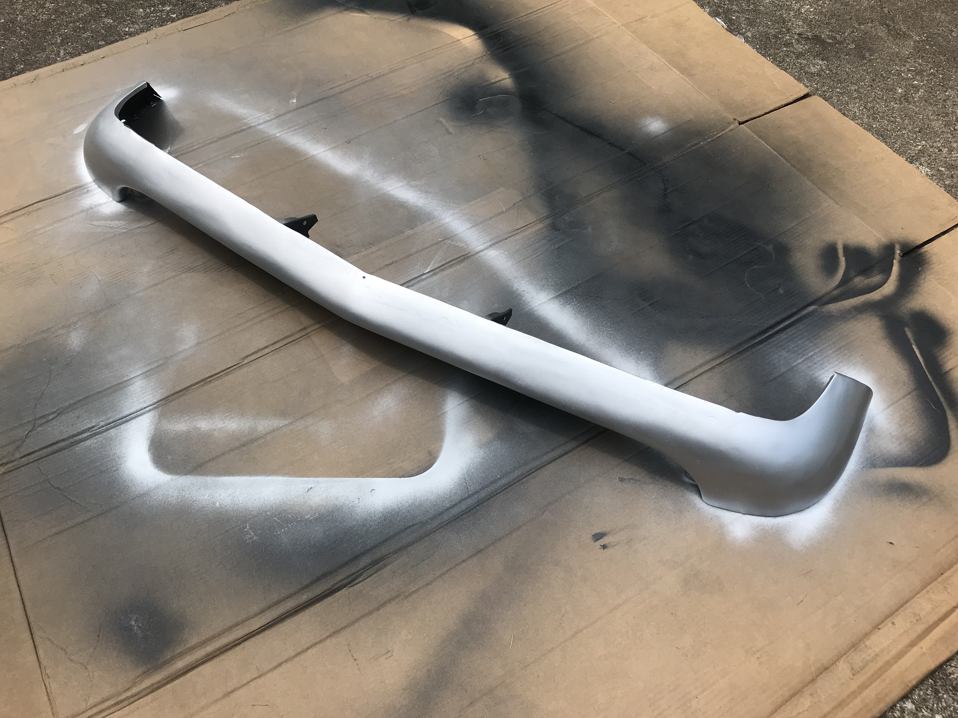

The wheel argent I bought is pretty close to the paint Dick used on the splash pan, and I can’t wait on an Eastwood order…
…so on it goes

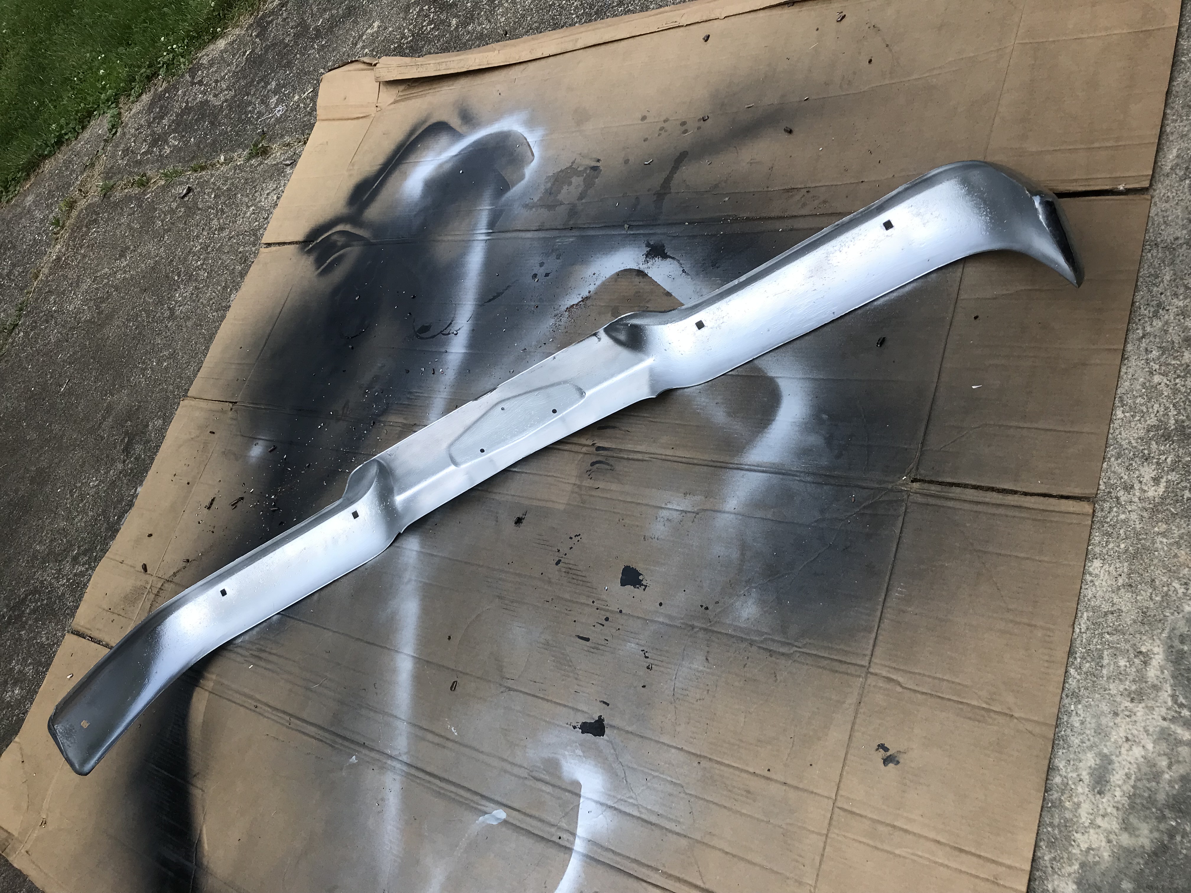

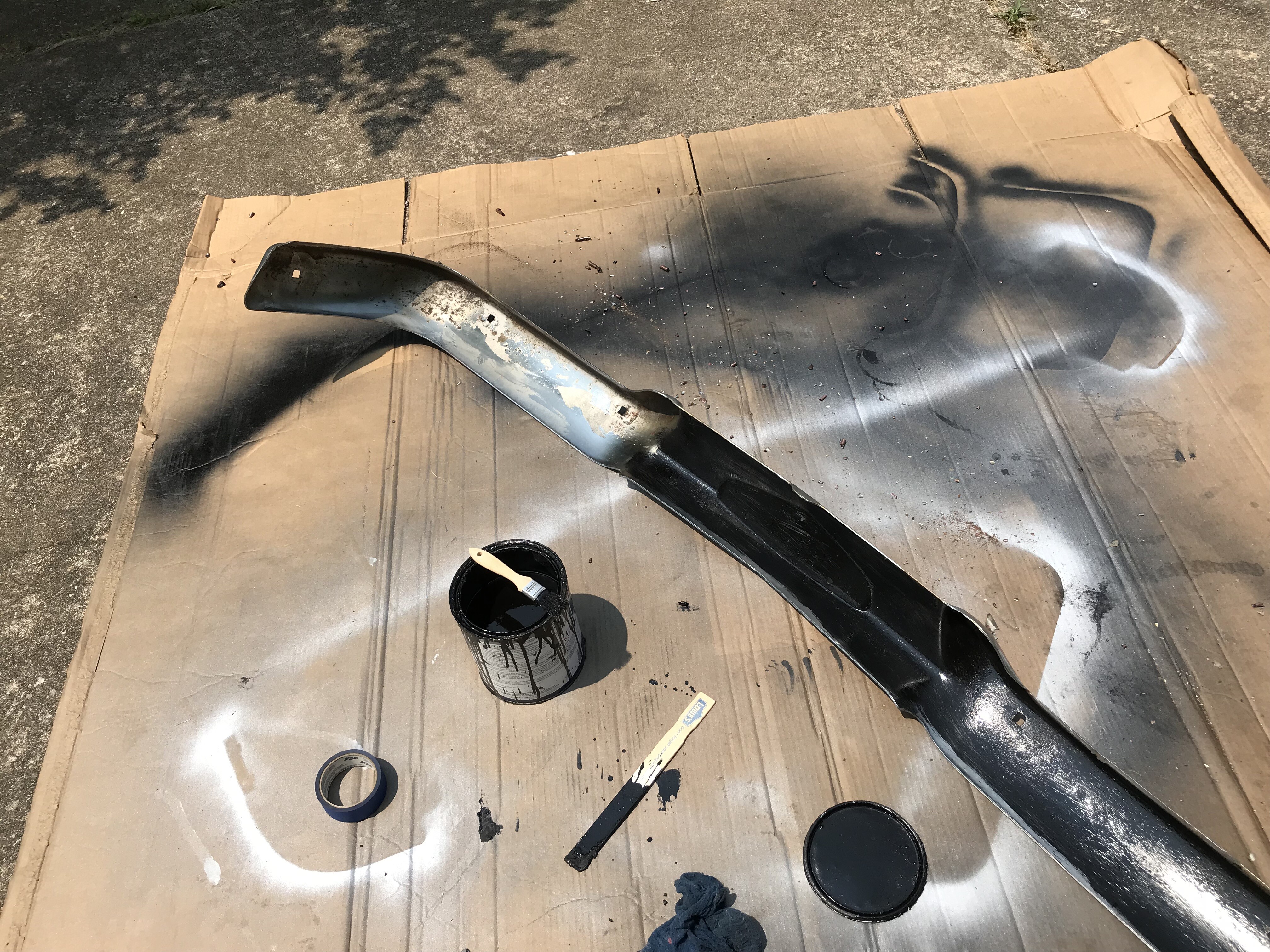

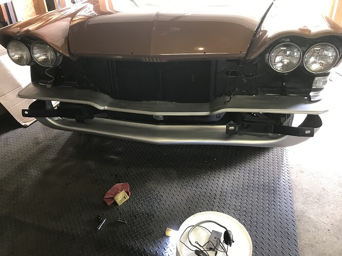

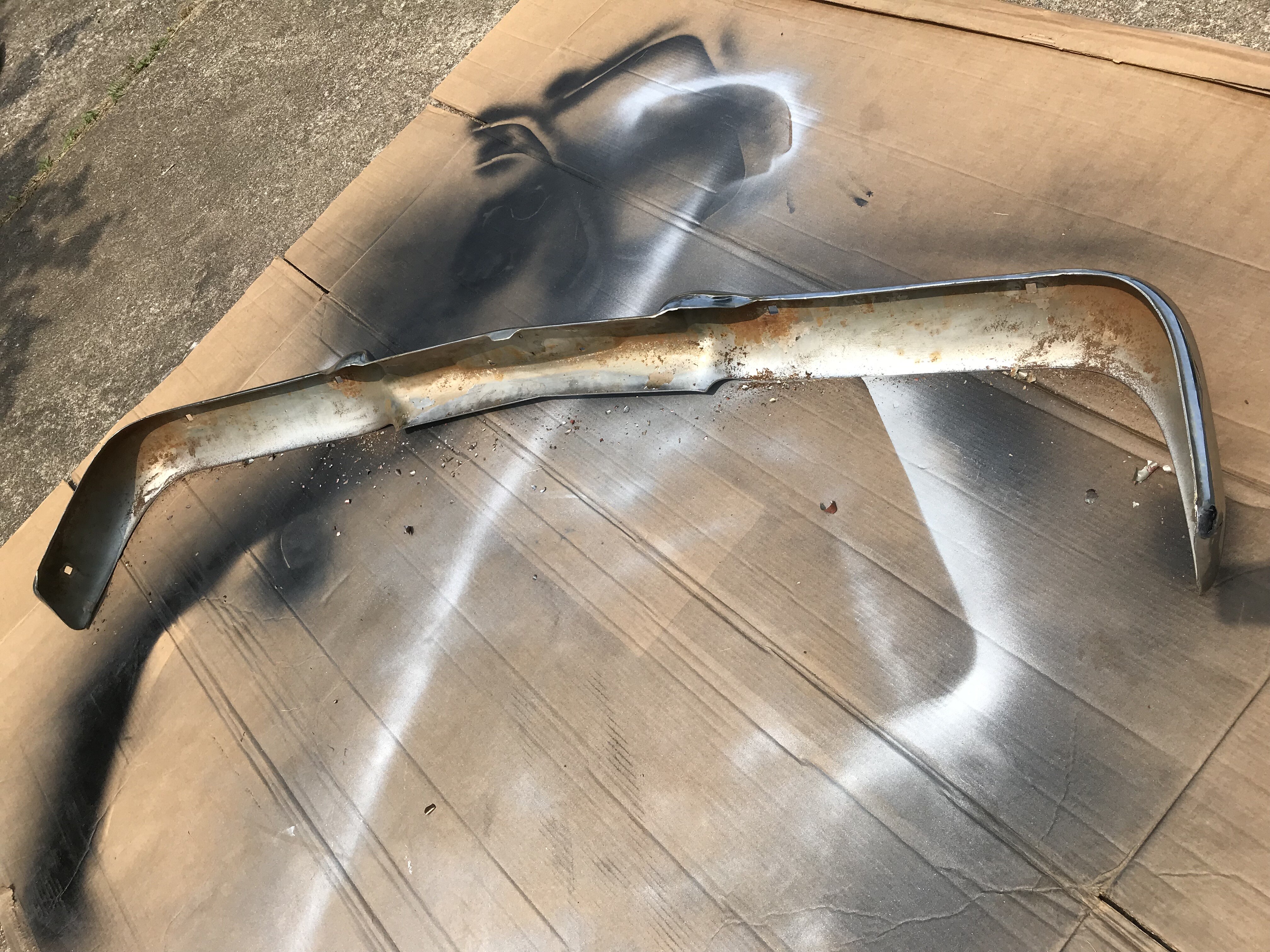

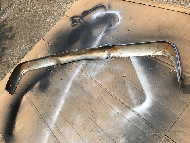

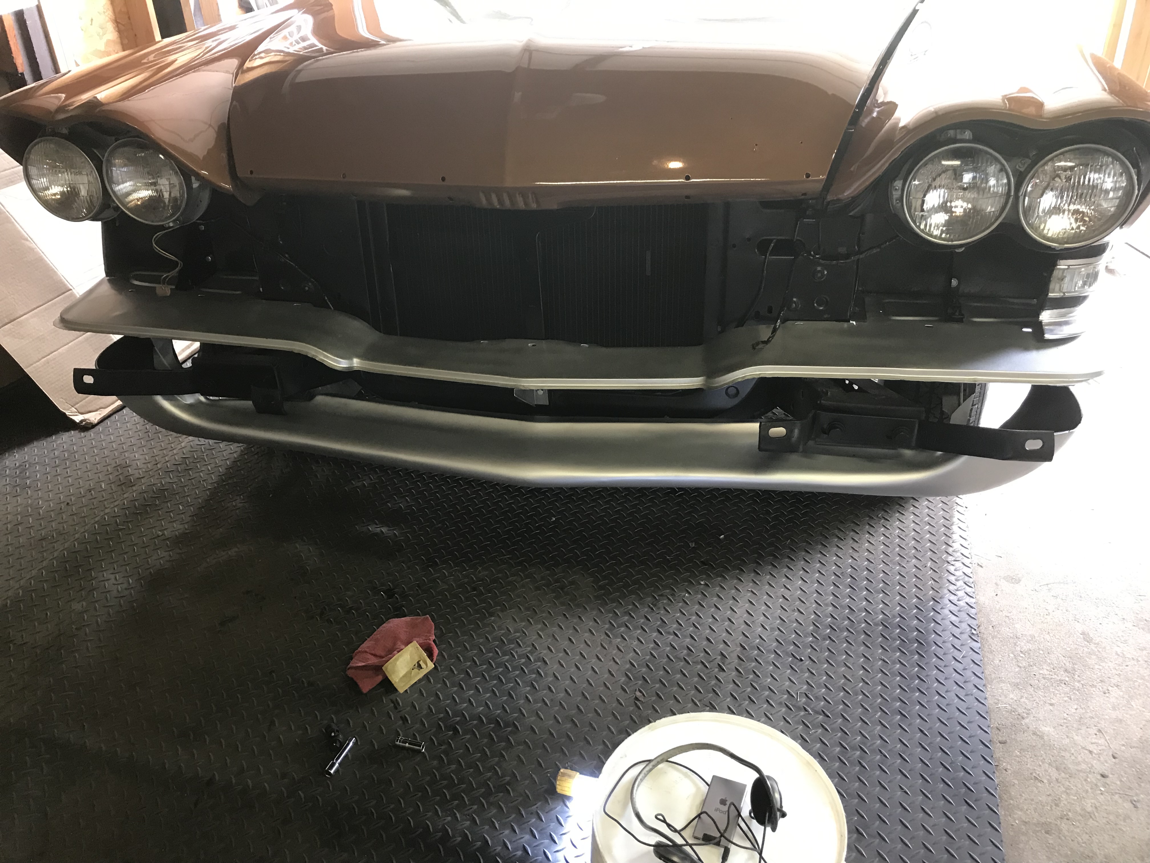

The front bumper, before I started. Because I always do everything Dick tells me to do, I brushed it…
…ospho’d it, and put rust encapsulator on it. I had to go with black, can’t wait for Eastwood
…but a coat of hi-temp silver covered it nicely
The splash pan is on, and I’ve got two bolts in the valance - but I had to mow the lawn before the storm hits. And now, the old man is ready for his power nap

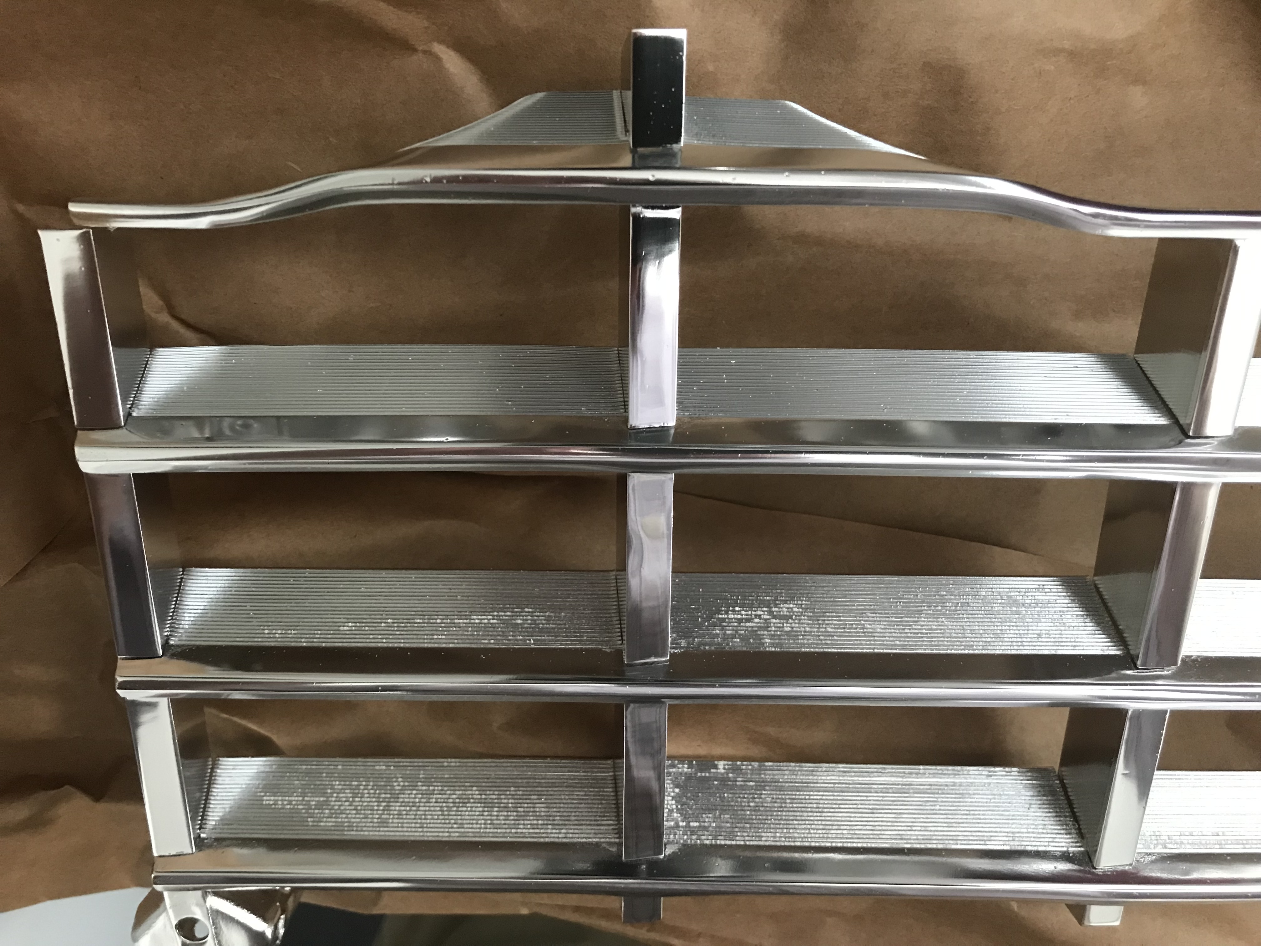

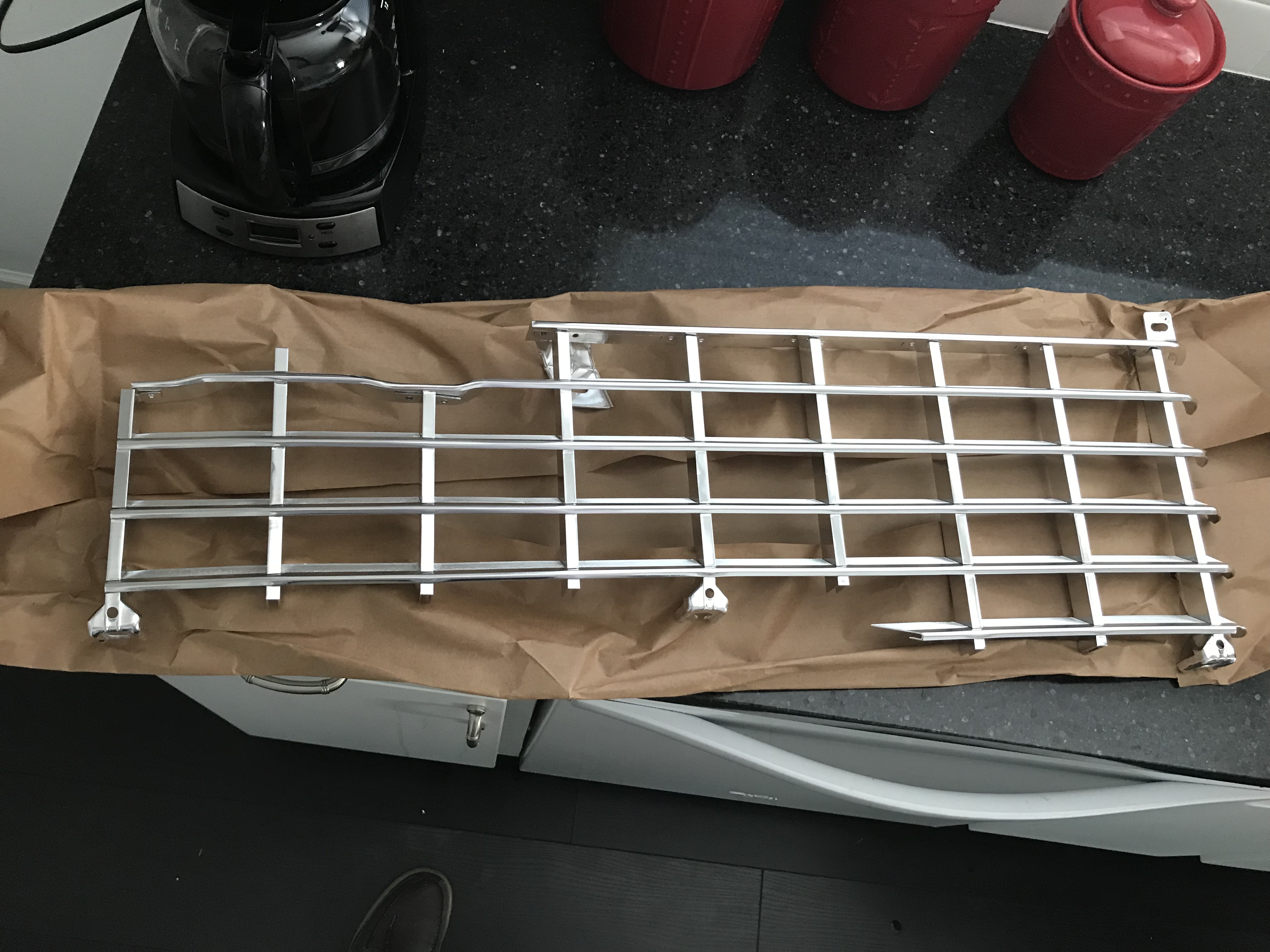

About reanodizing, I said:
Well, the grille piece I got from Ed came back. It’s not perfect; but then, neither is Faulkner :confused: So this will have to do.

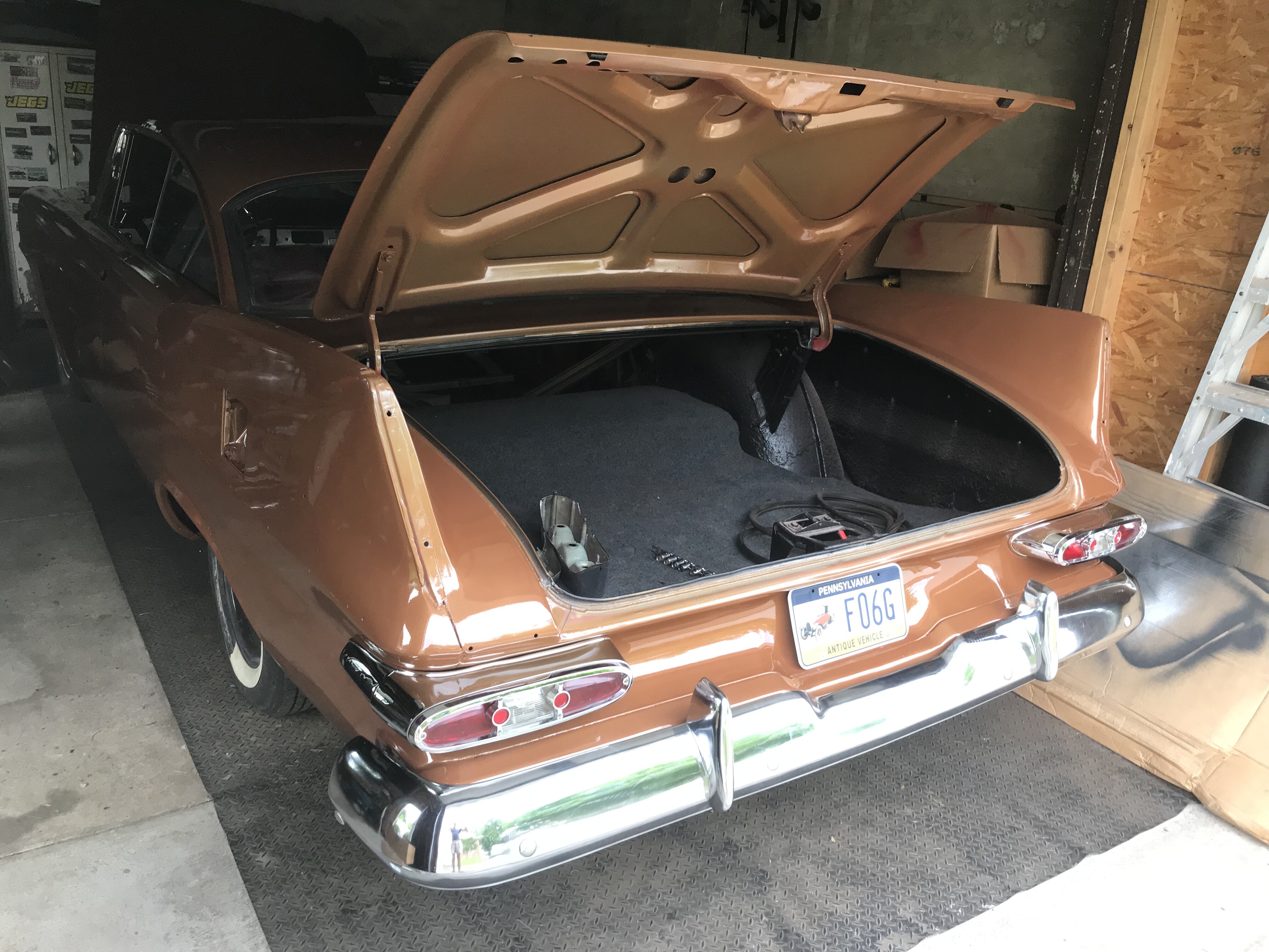

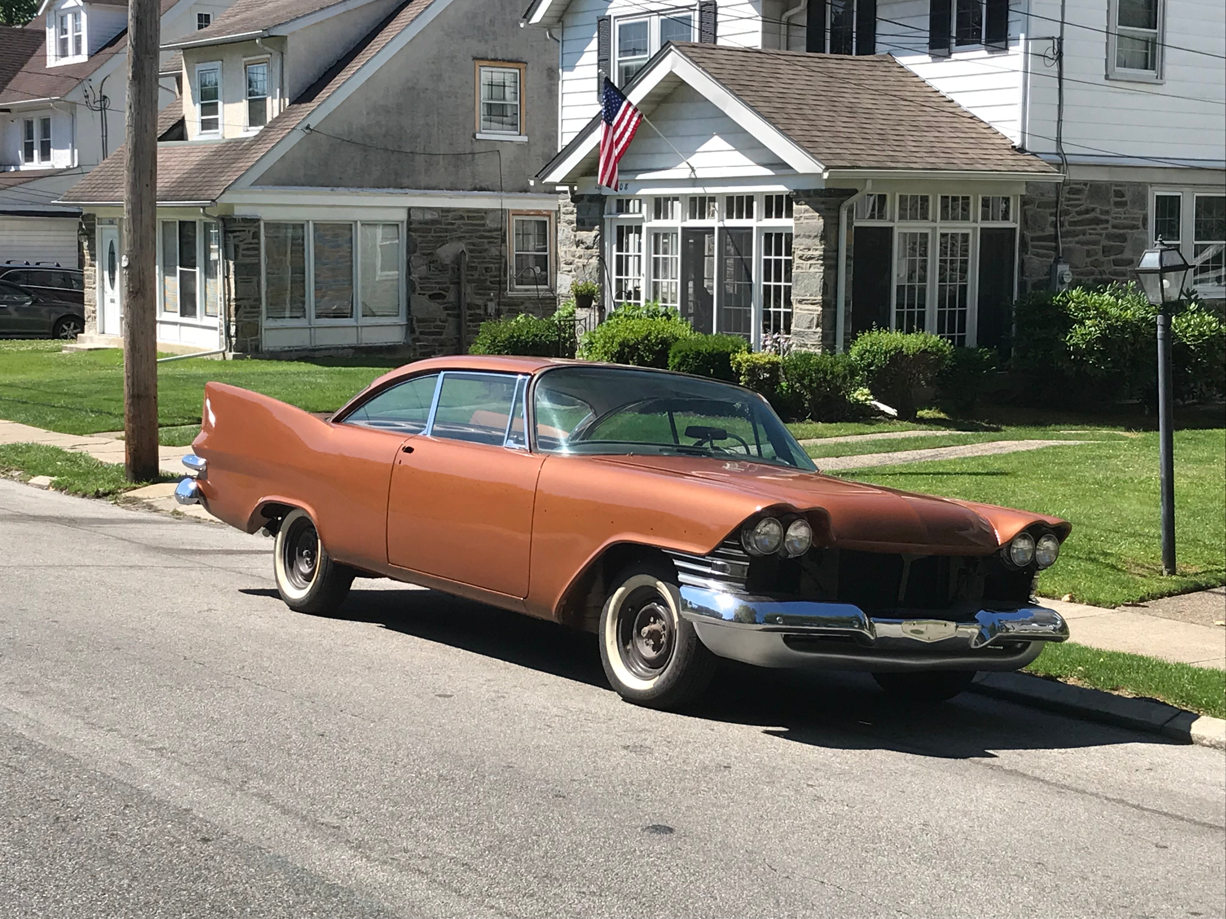

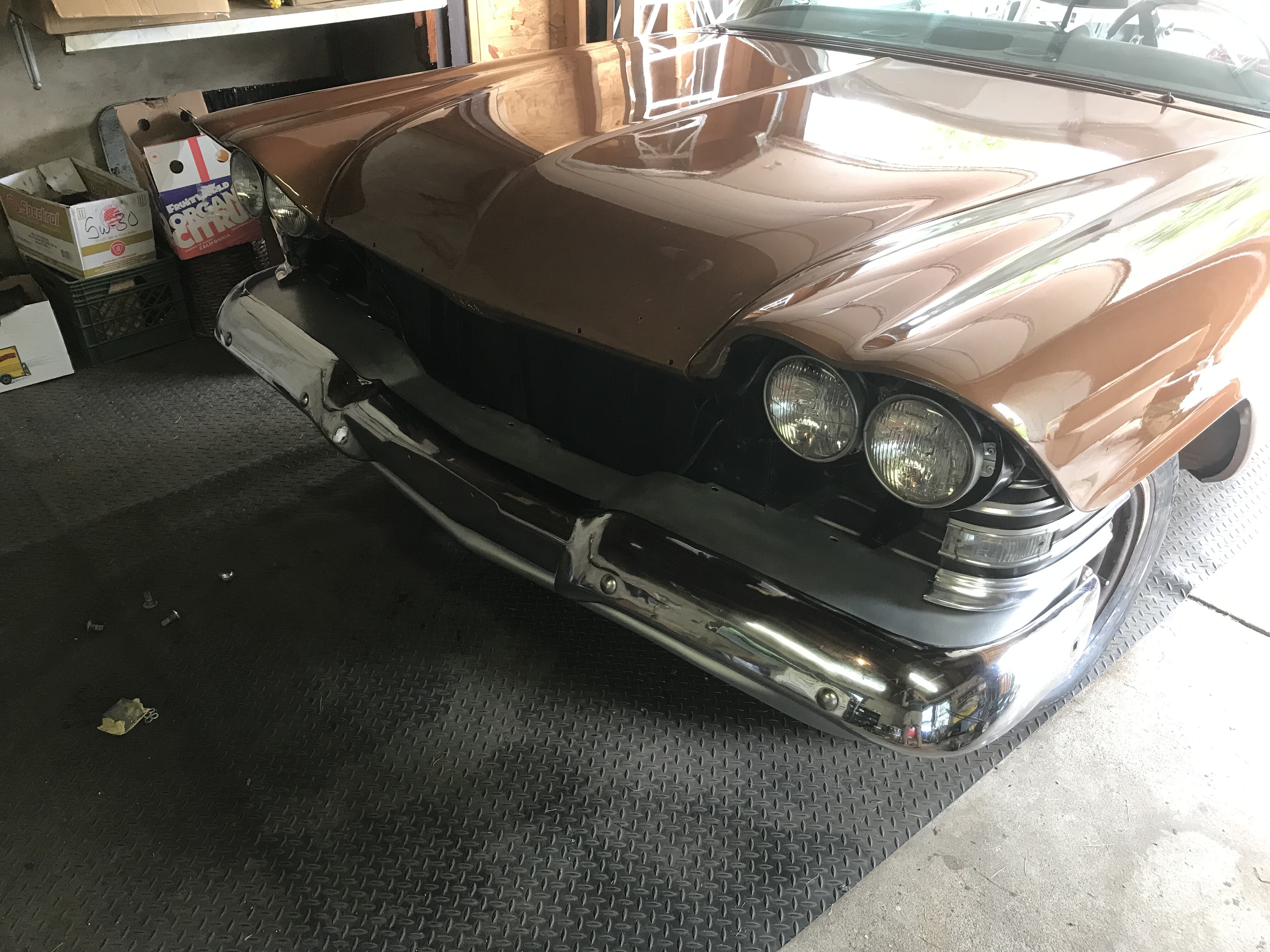

I took the day off, and got Faulkner roadworthy:
Nice work on the valance, Mr. Koch!

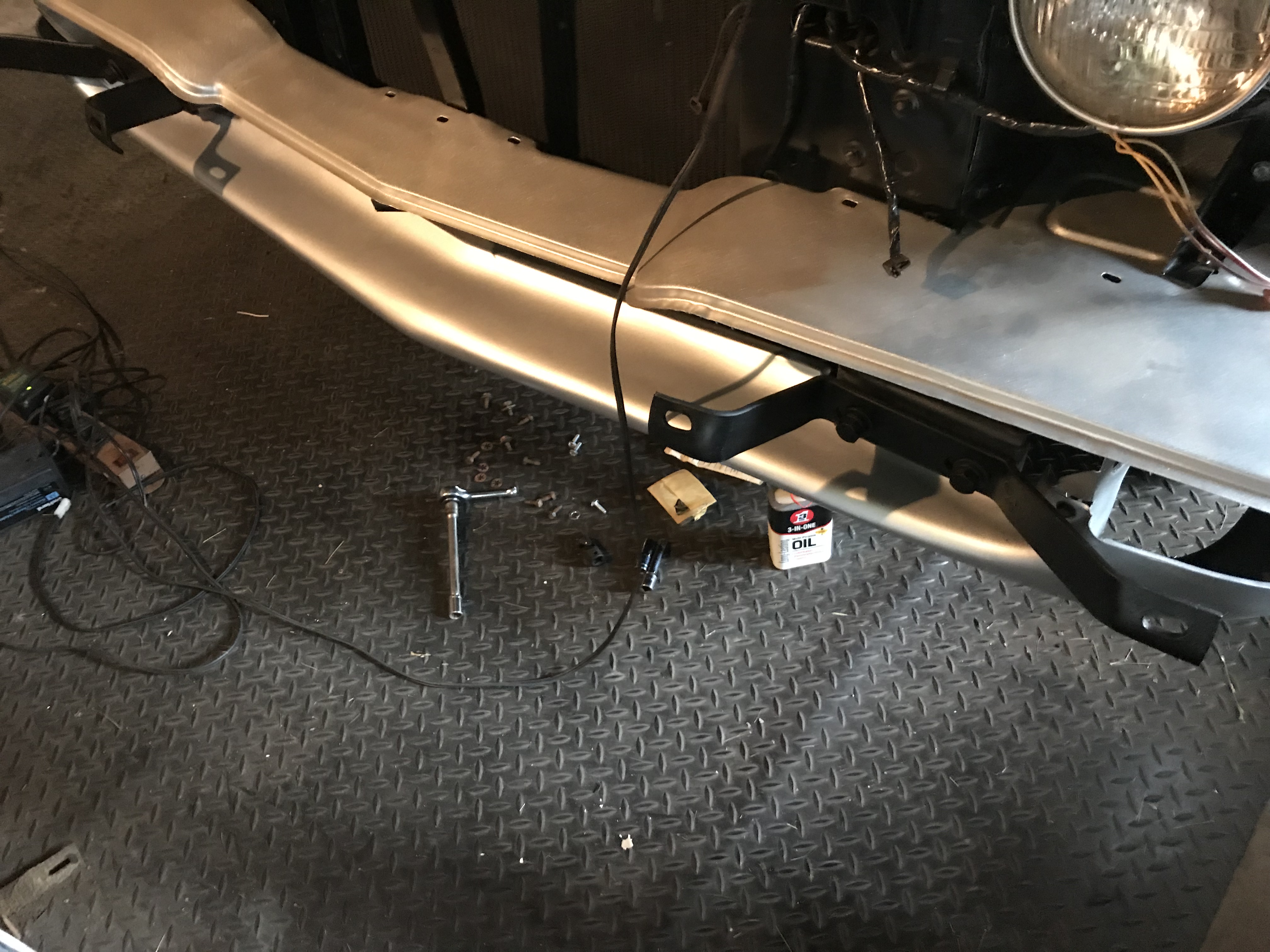

The front bumper, never replaced, is showing its age - but, still holding up. Notice the outer bolts are left off for the soon-to-be-mounted bumper wings
The headlights are still not working, but I wanted to get the car to the paint shop for some minor fixups today, so I can paint the interior tomorrow. I’ll get the headlights sorted out on the flip side.
This was the first time I’ve driven Faulkner any significant distance (6 miles) in almost four years. He handled beautifully - the transmission shifted fine, the motor ran strong, and the steering was like a dream (thanks again Dick! Two burgers and frosties for you). The 318 did run a little warm for a 90-ish degree day, though, as usual - or, at least the gauge said so. Even so, in bumper to bumper traffic it never got off the “M” in “TEMP”.
And the gas gauge worked fine as well! I’ve only had a couple of gallons in the tank since I installed it, which budged the needle to tell me it was working. Before I set out, I put exactly 10 gallons in the tank, and the needle parked at half full. Accurate enough for me! Funny, though, this replacement float must be more responsive to tank sloshing - the needle jumps around quite a bit, unlike the factory one. I can live with it!

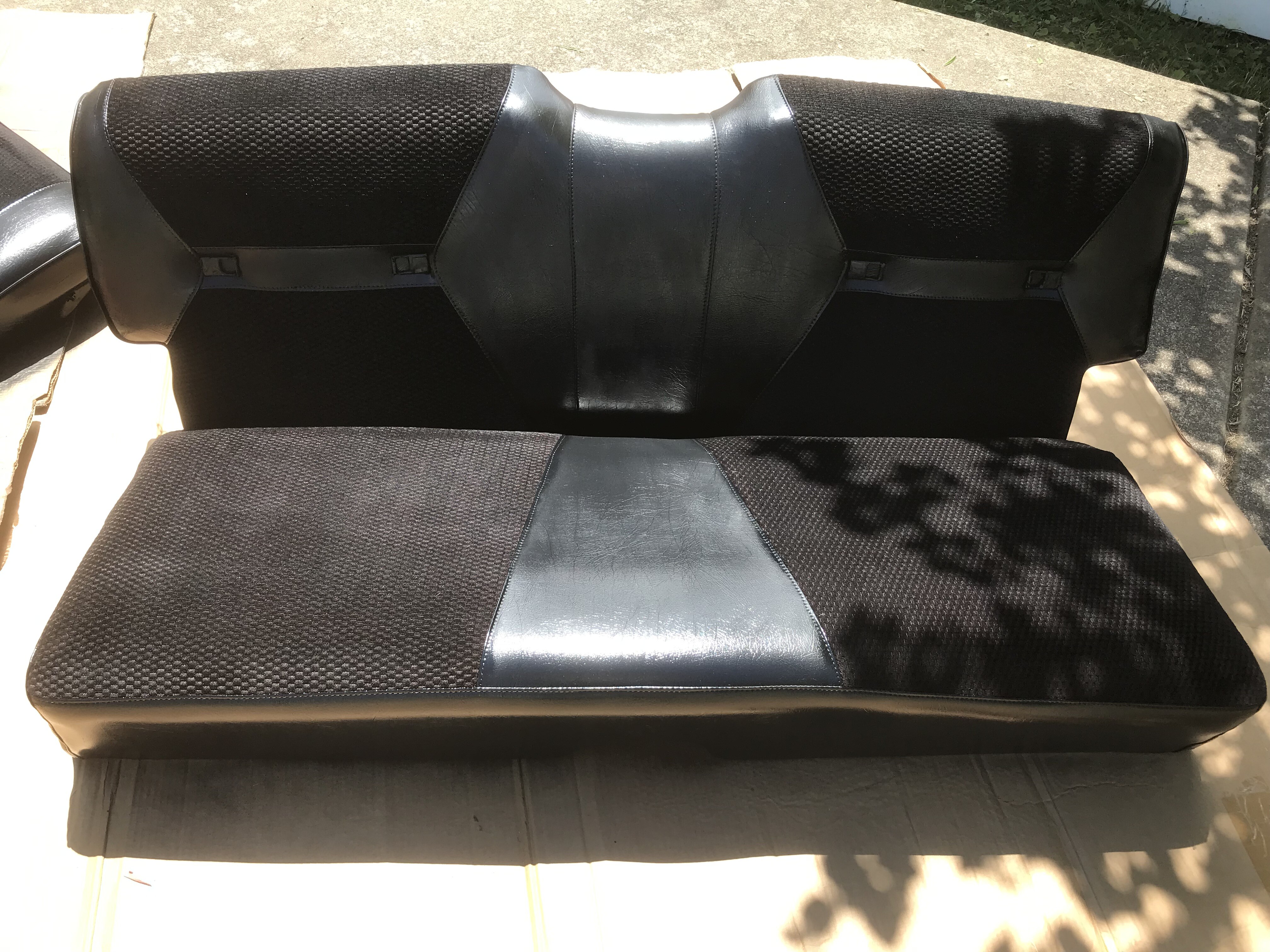

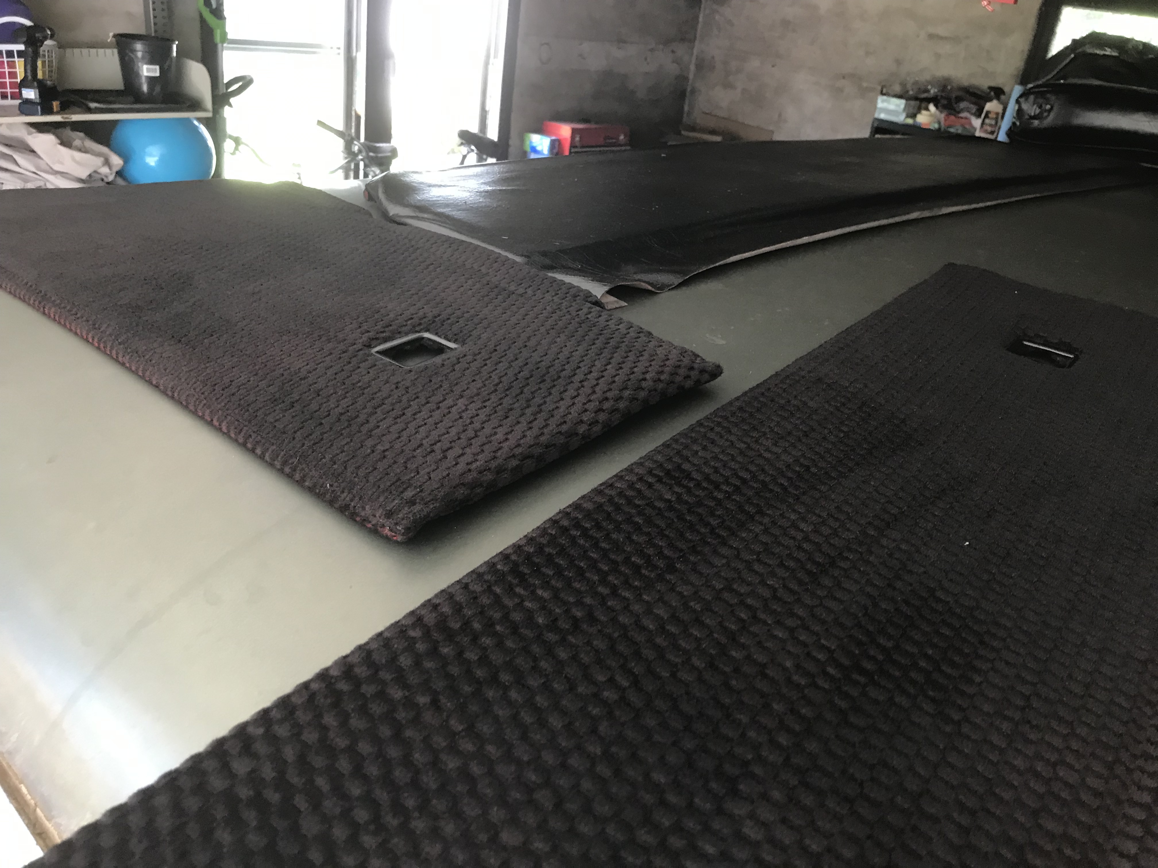

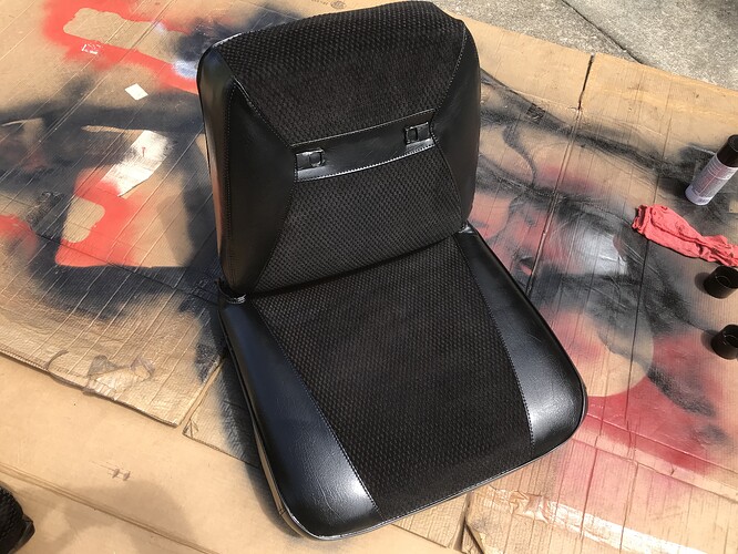

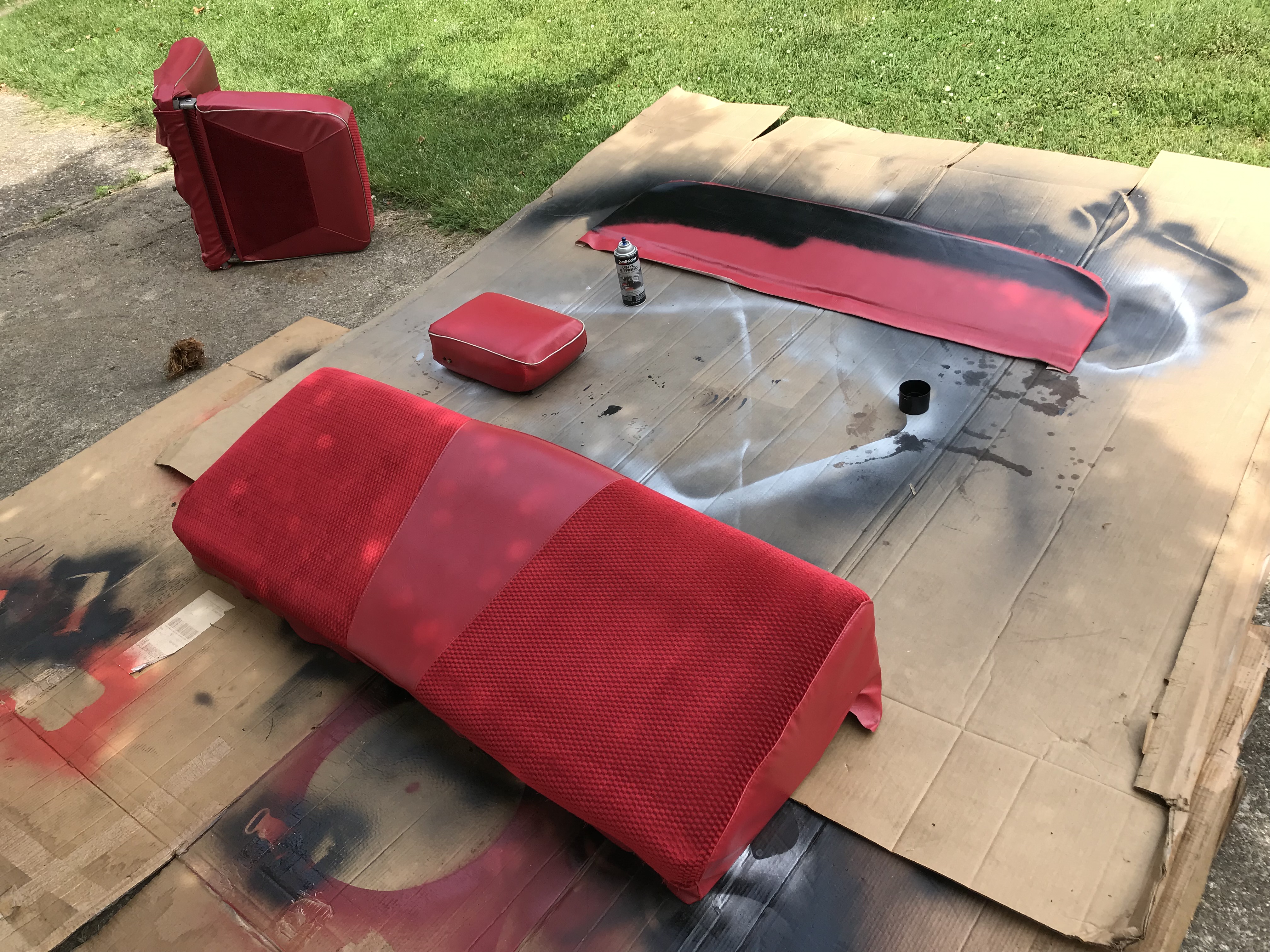

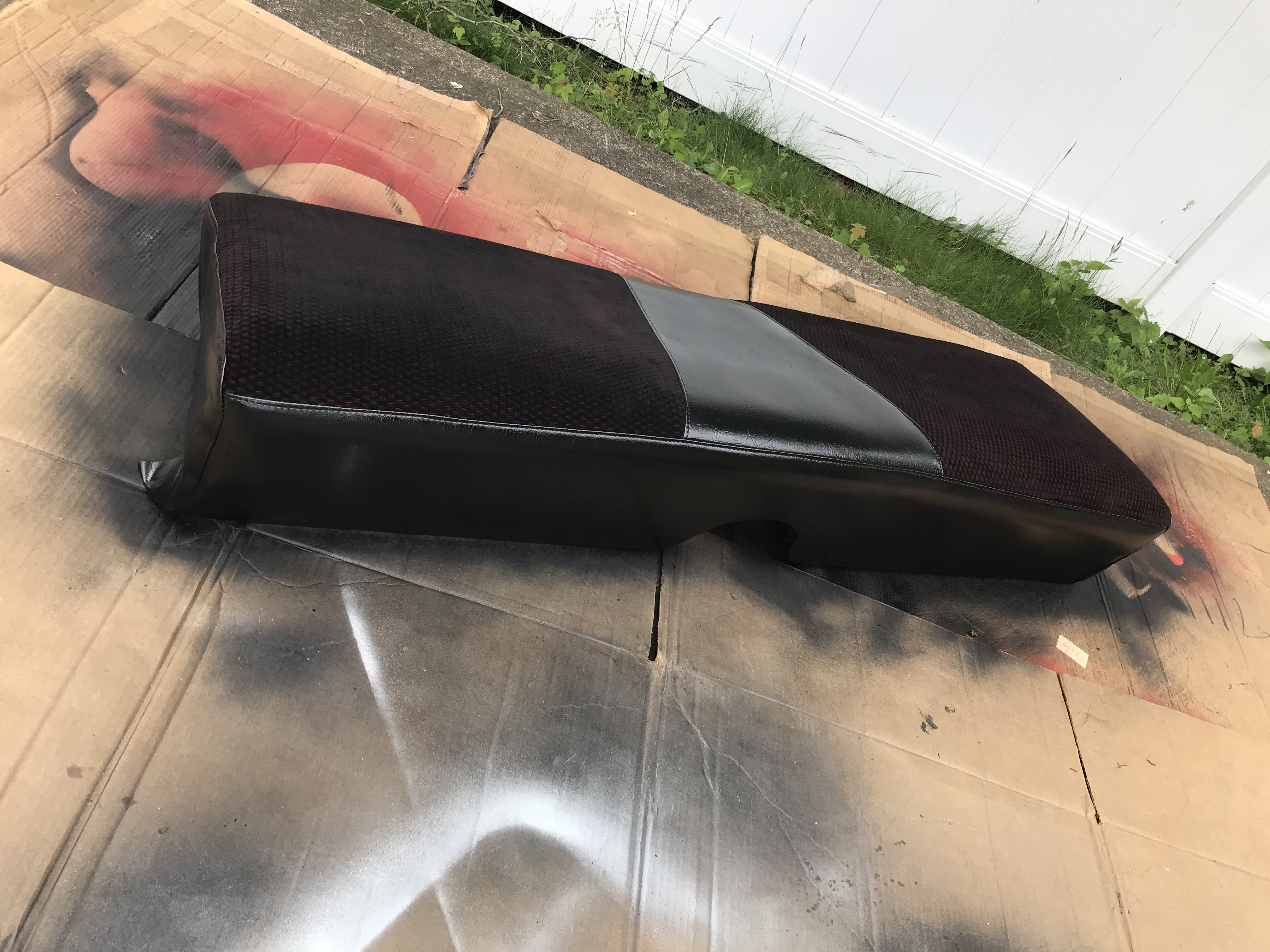

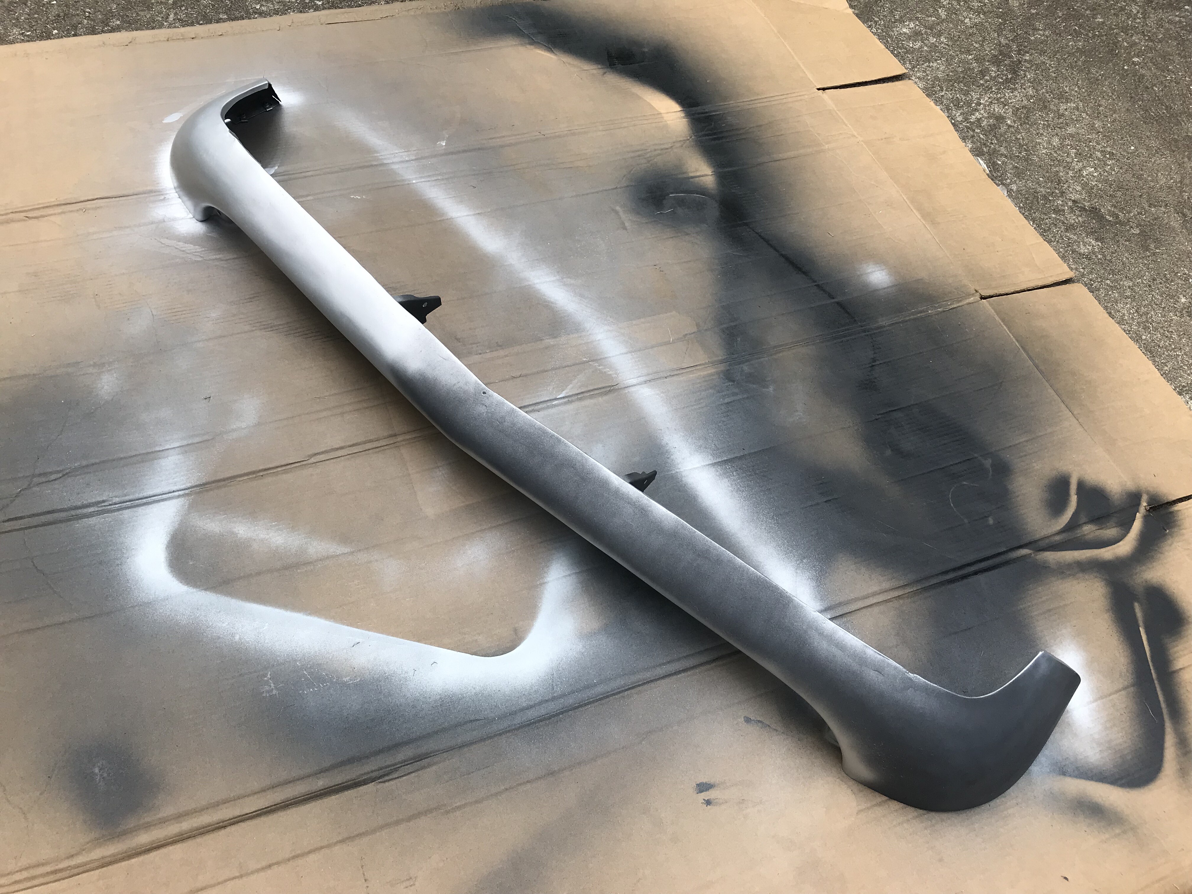

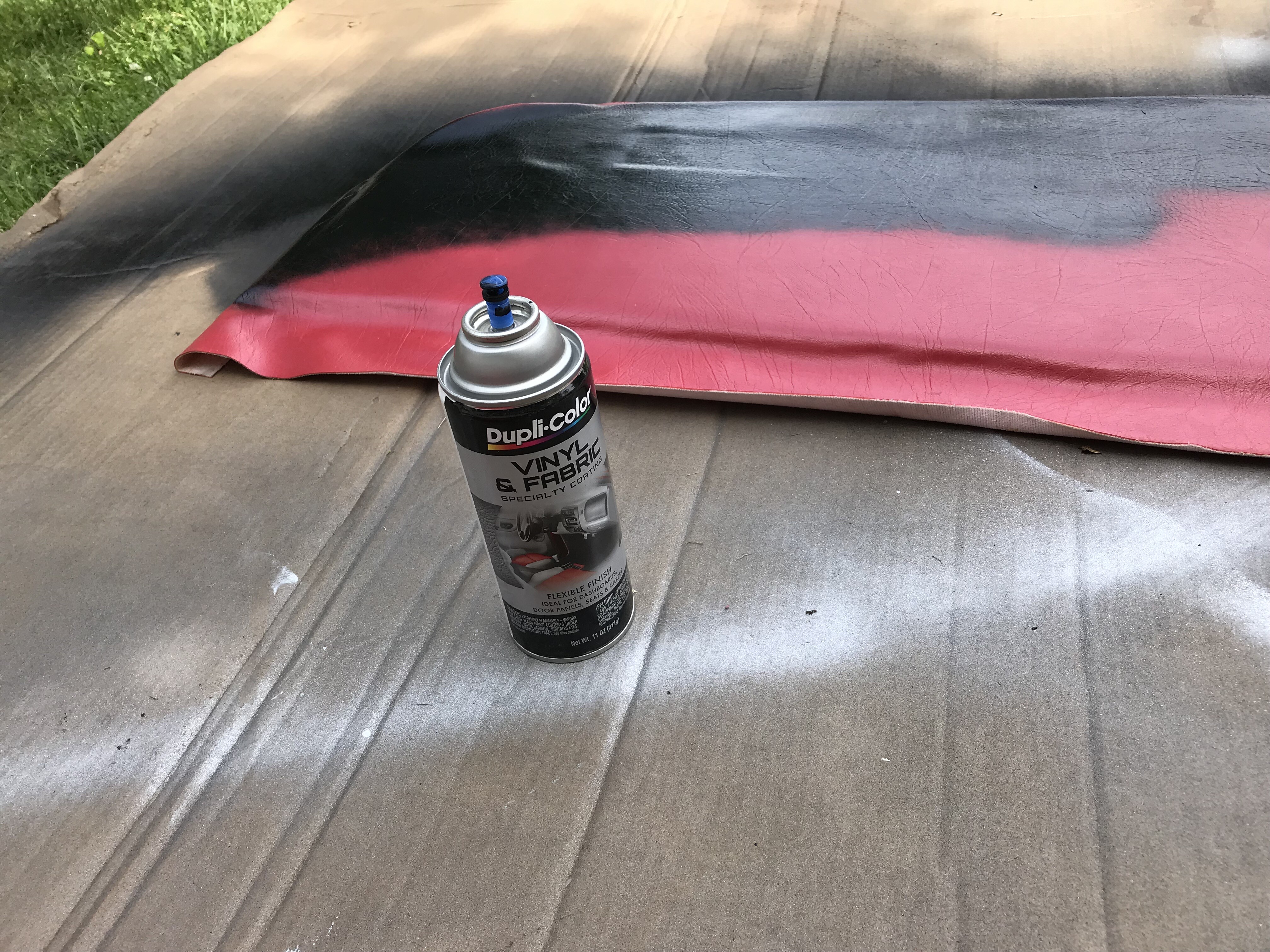

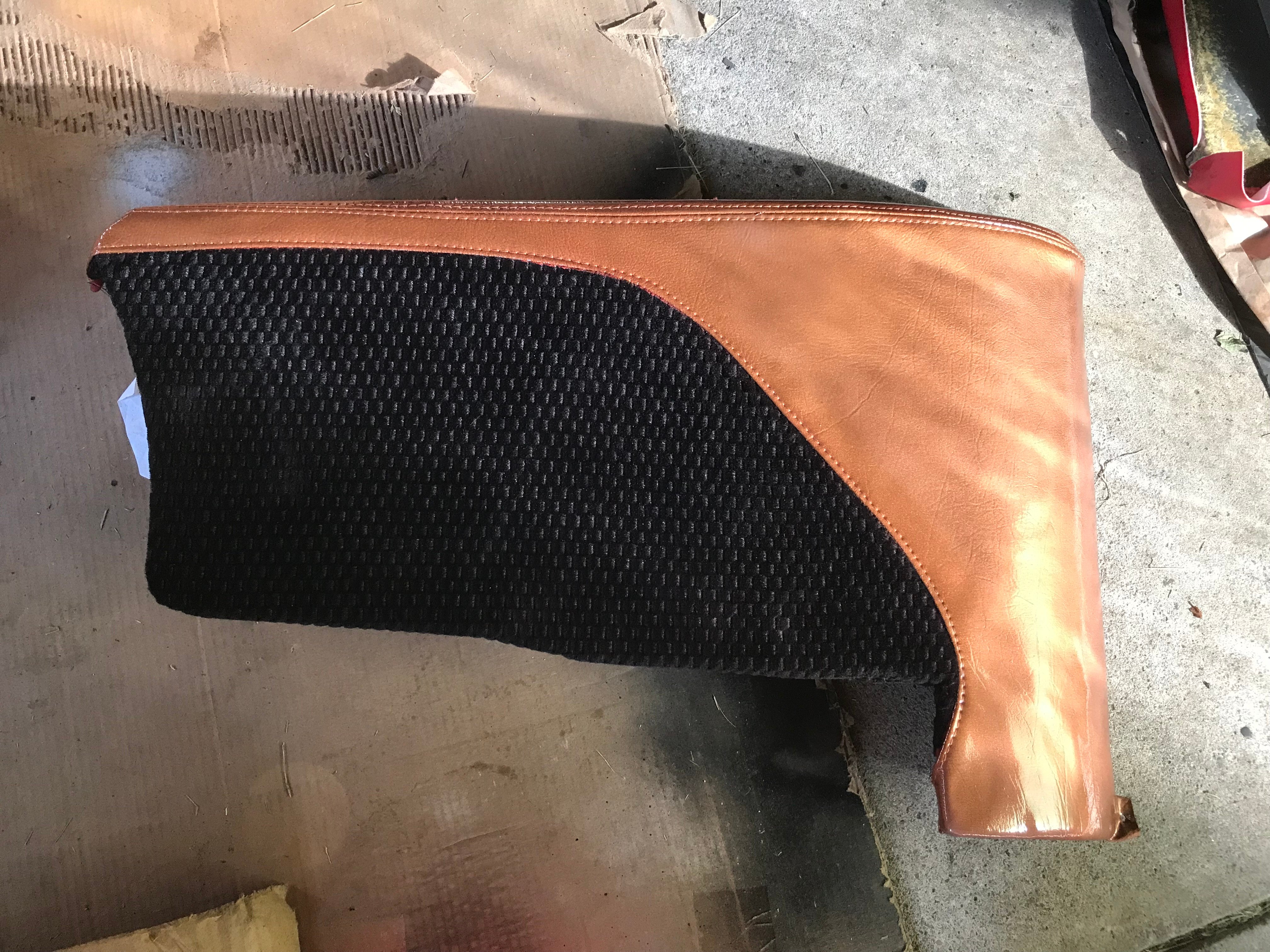

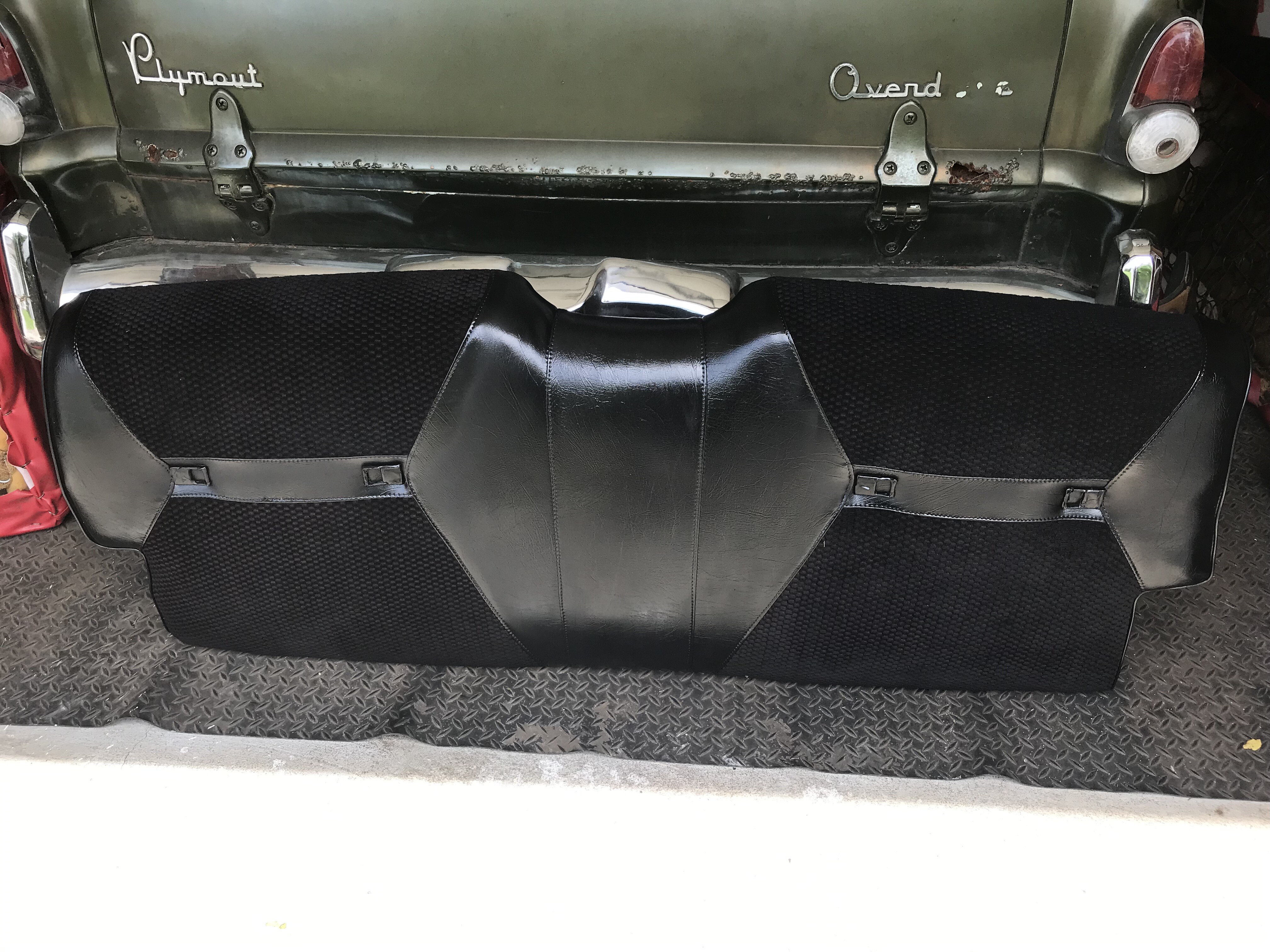

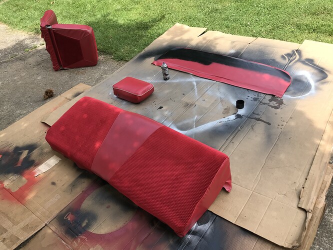

I love this vinyl/fabric spray paint from Dupli-Color. It dries super-fast and colors the vinyl perfectly; but wow, the tufted fabric really soaked it up. I went through 6 cans painting the package shelf, the console armrest, and the two pieces of the back seat. Time to order a bunch more cans.
Just getting started
This is the paint

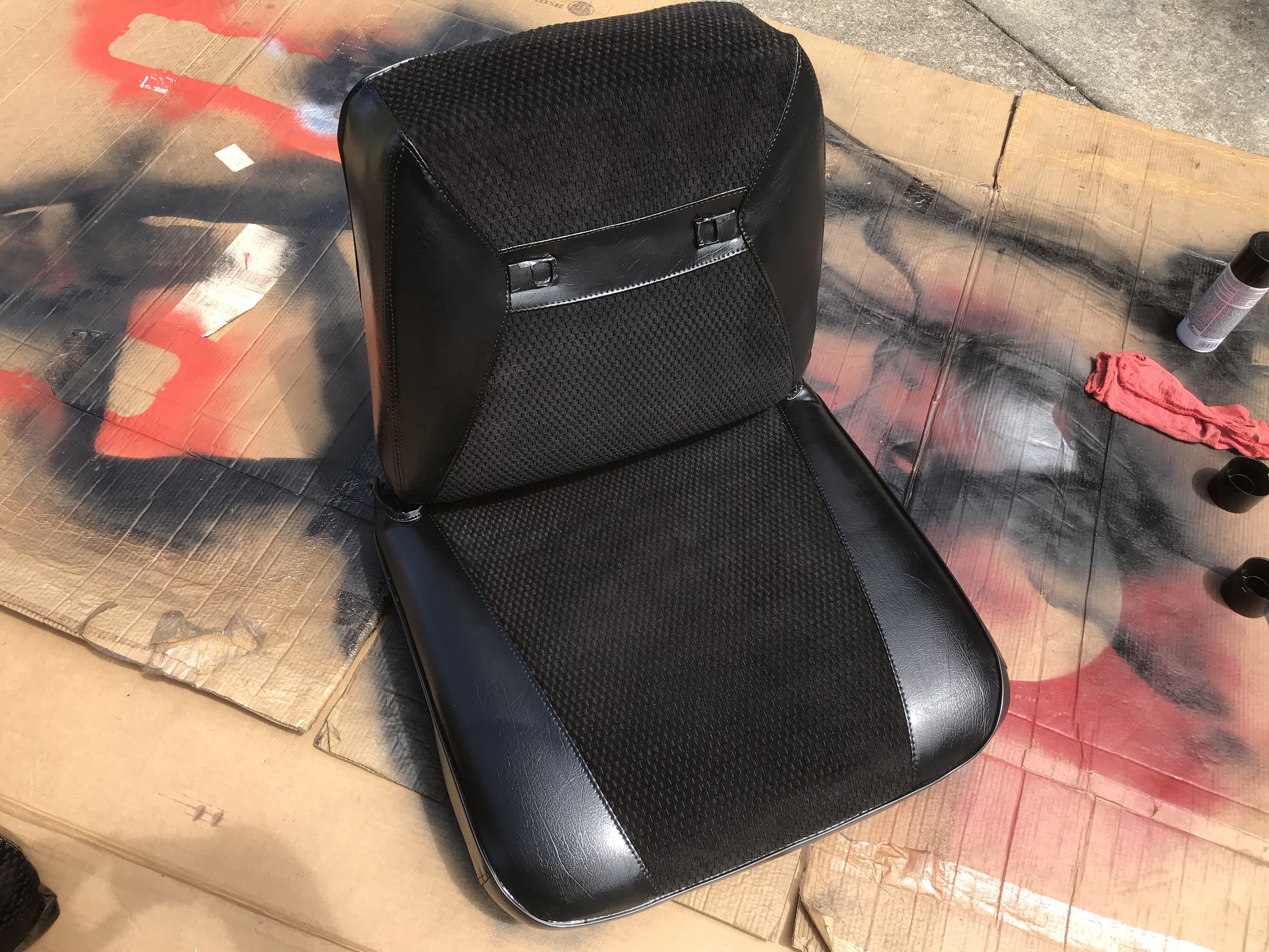

lower rear seat came out nice - but still could use another coat

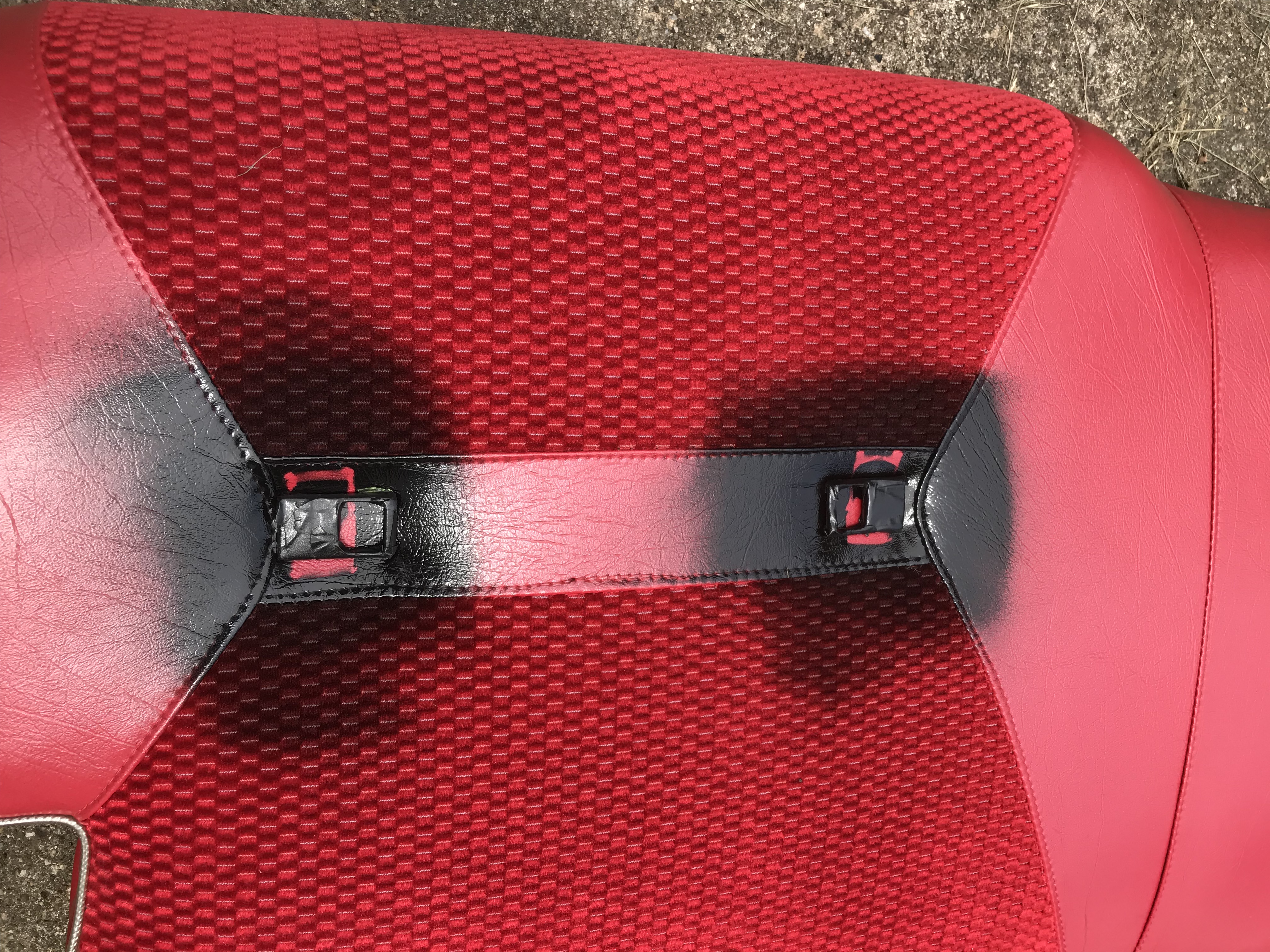

The upholsterer had saved the seat buckles when he redid Faulkner’s upholstery, but never put a belt between them. I taped the buckles and turned them so I could paint underneath them

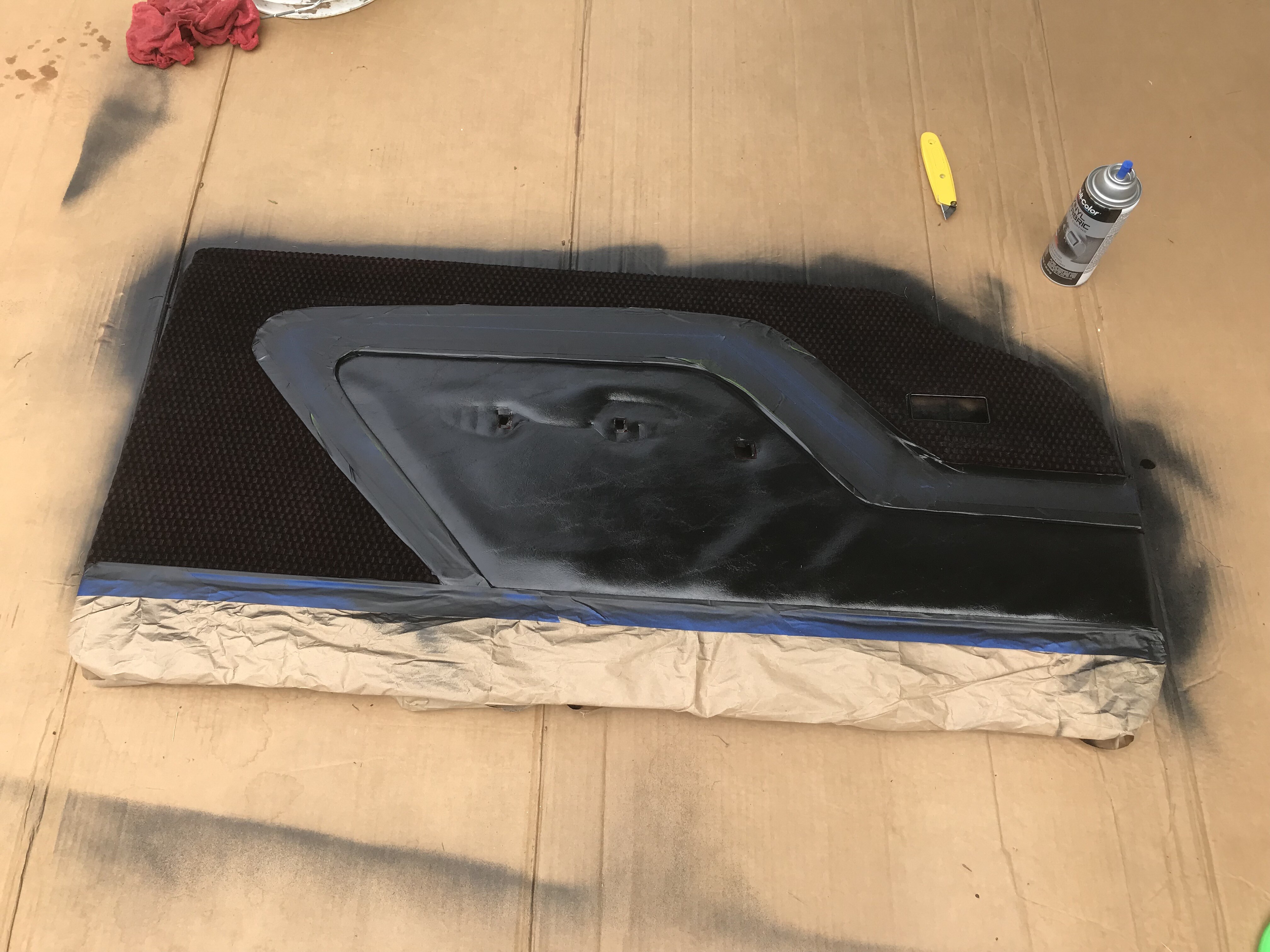

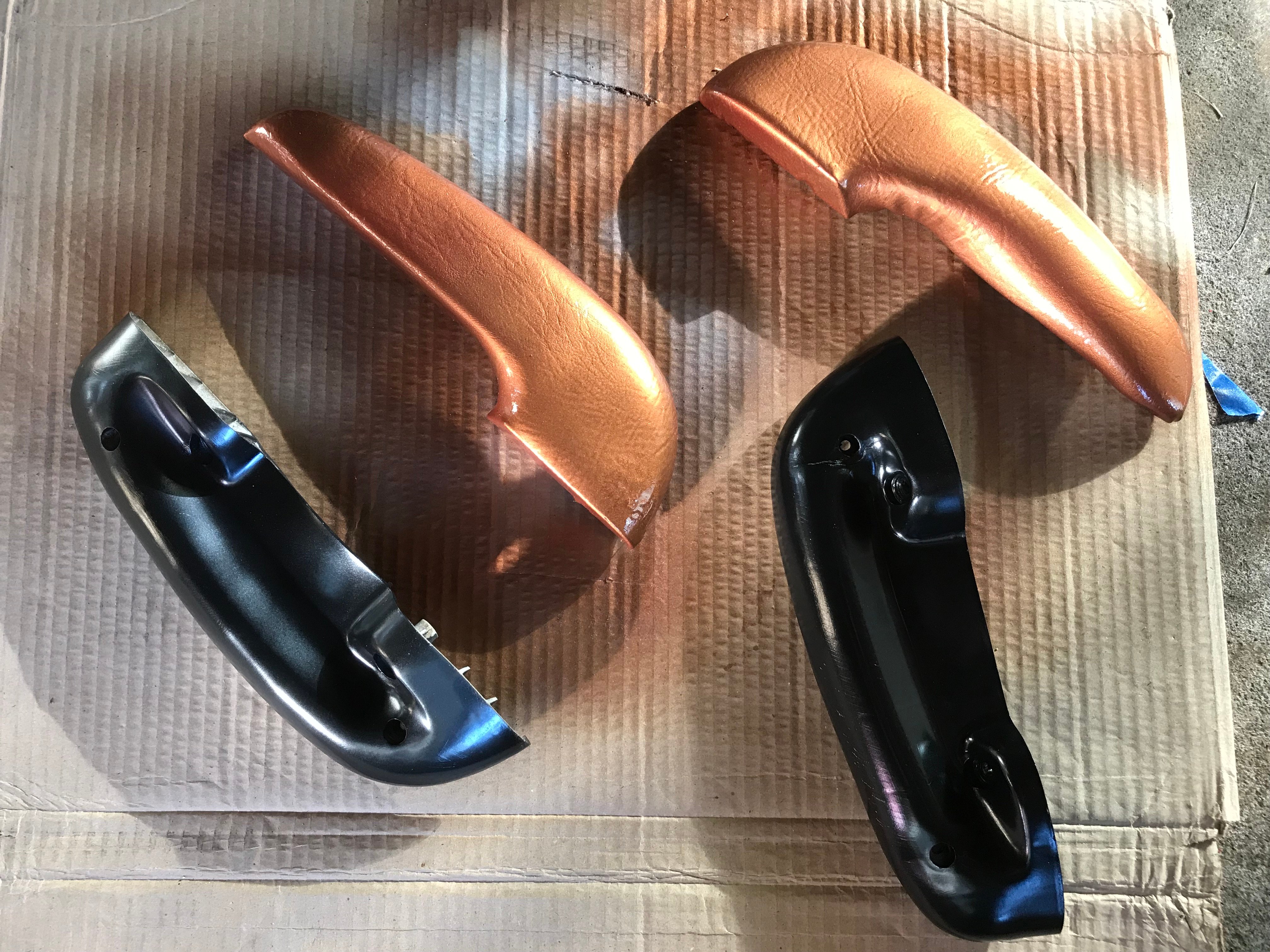

What’s covered will get painted bronze
Martha does her part to help
Wow, the bronze takes forever to dry - and, easily runs. But I’m likin’ the look.

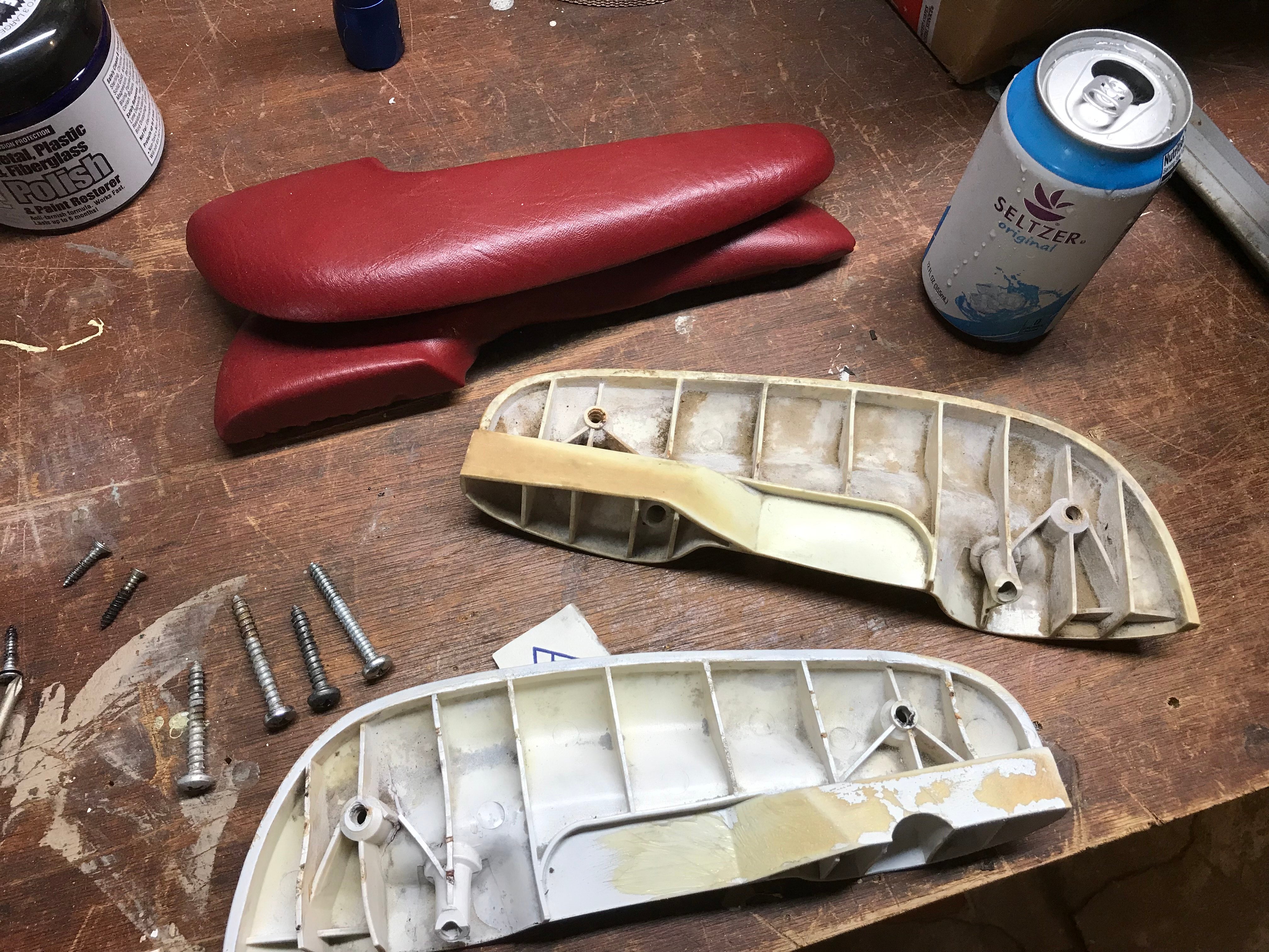

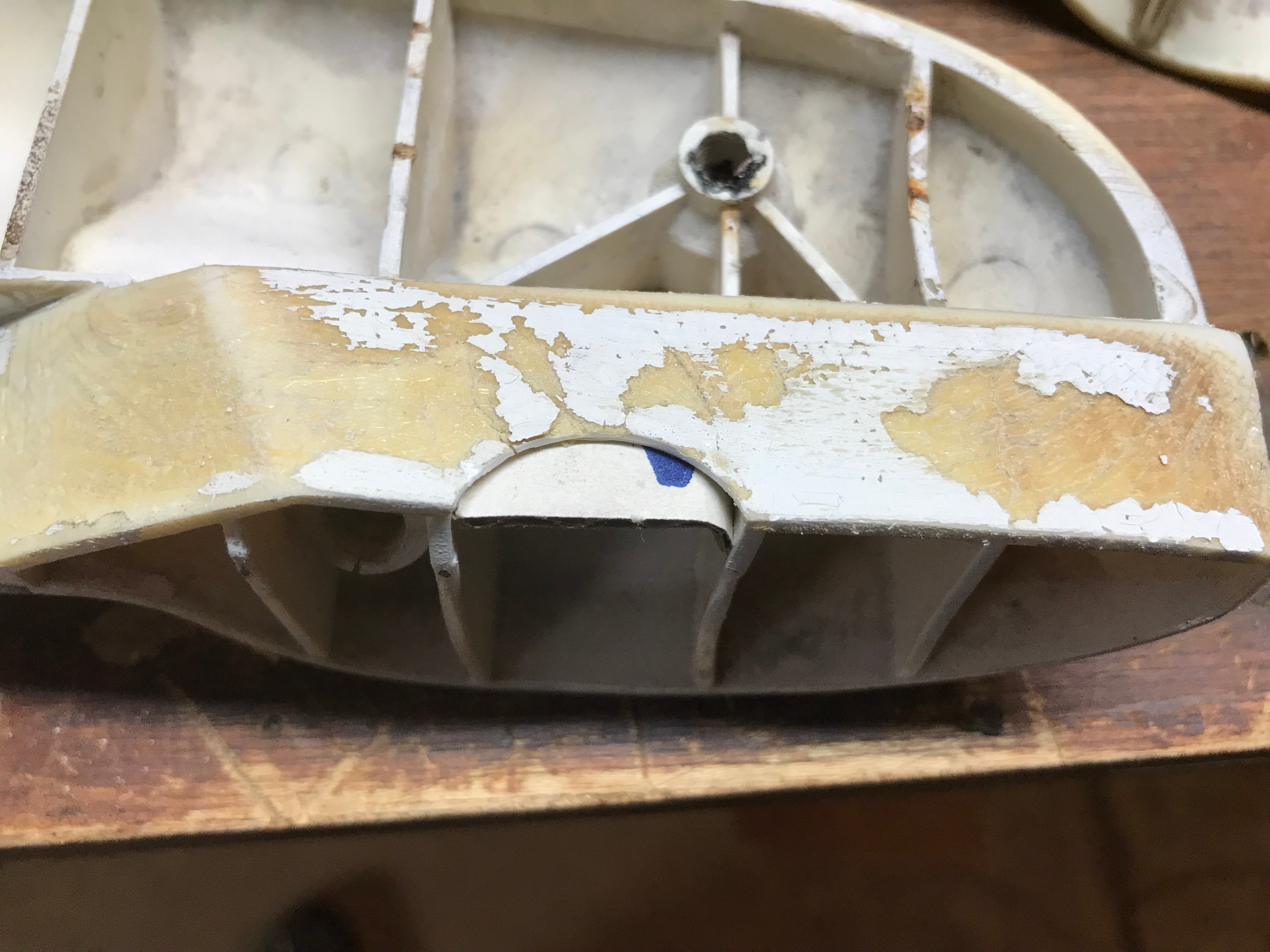

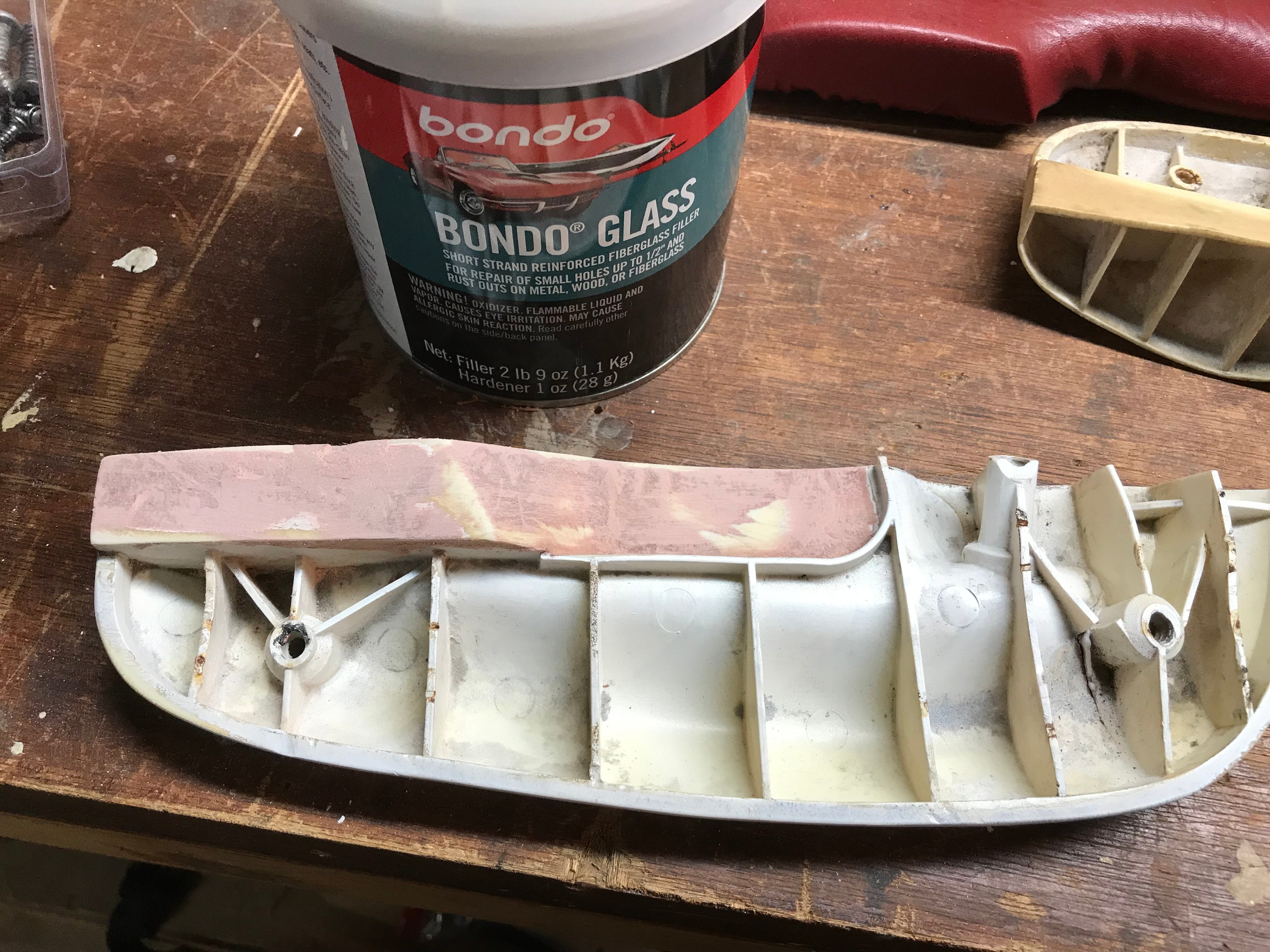

Some more interior painting today. The door handles needed some repair work before painting…

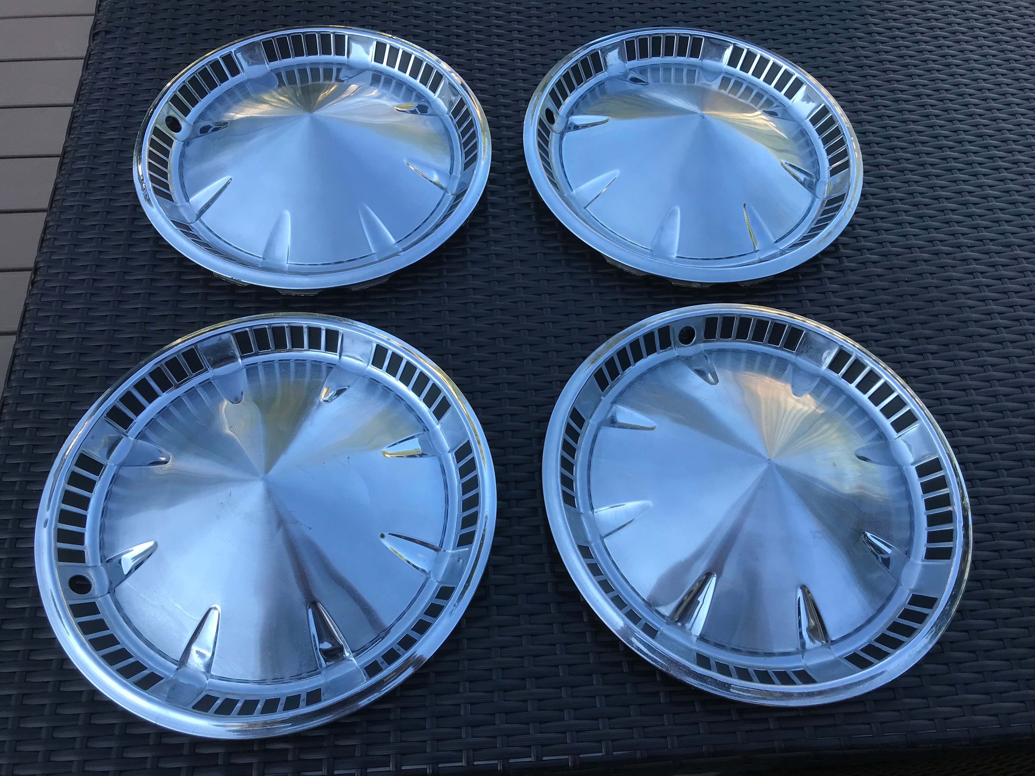

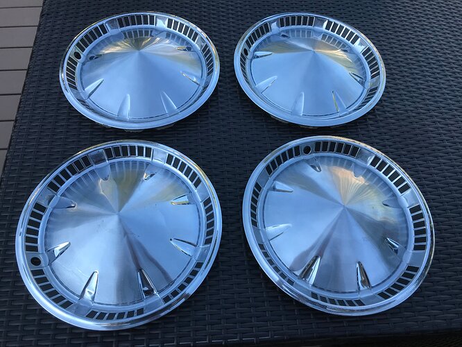

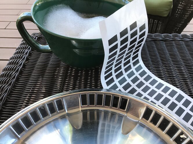

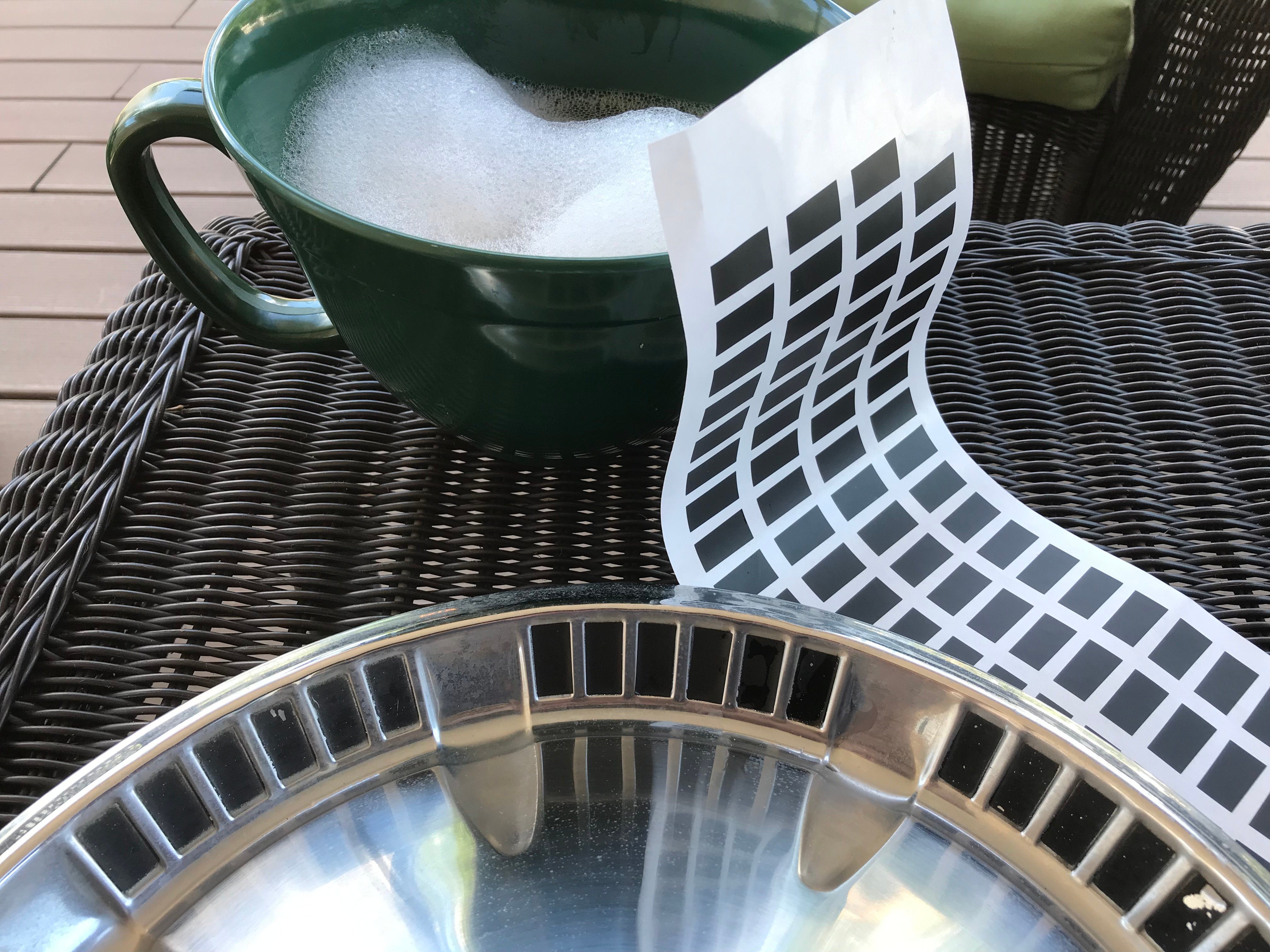

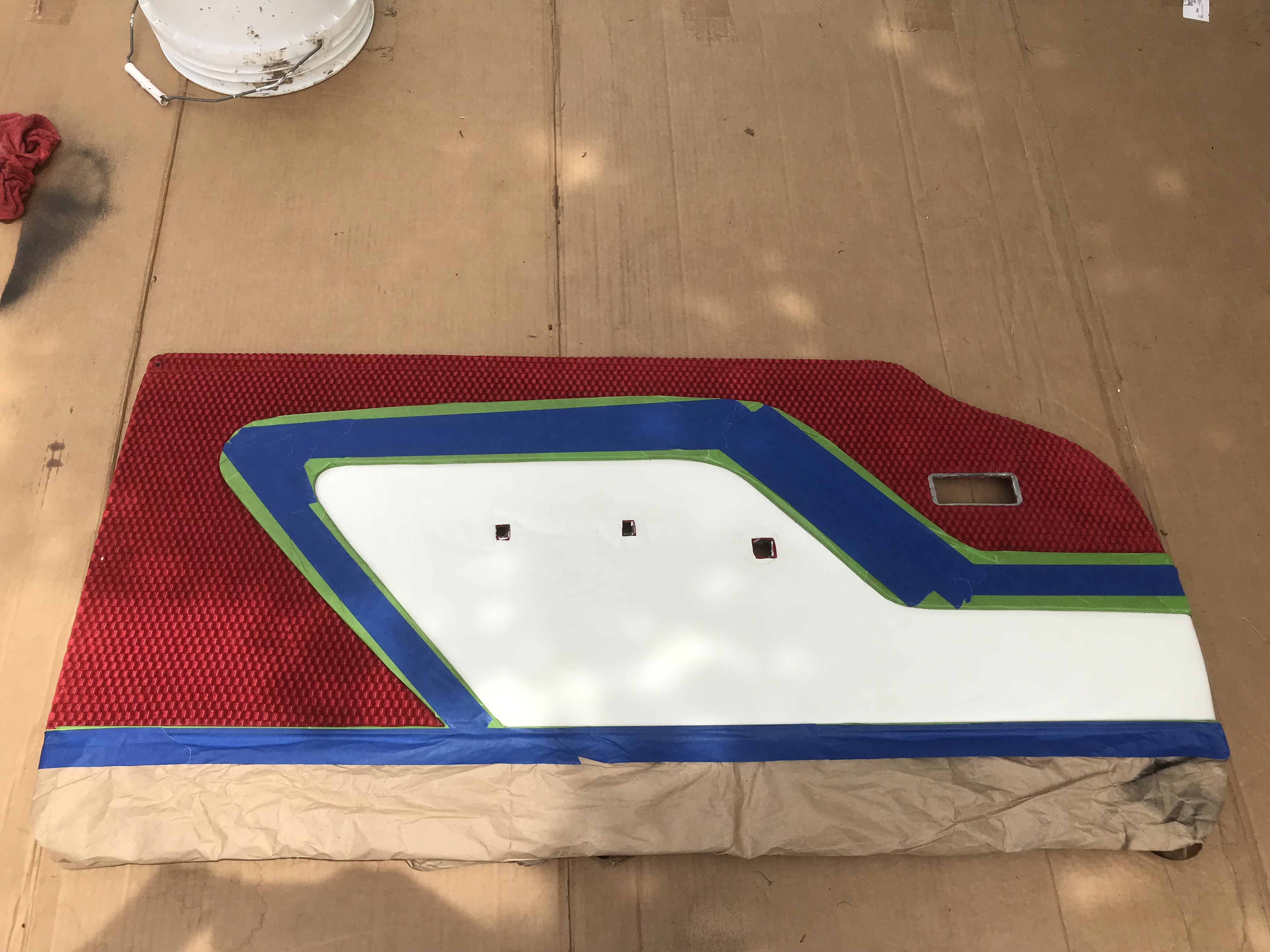

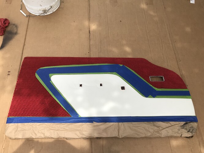

No pix of door panels, but they are nearly complete - need a bit of touchup here and there. I tackled the hubcaps:
This is Tom Fox’s idea! You should sue, Tom… What I liked about this stuff, is you put it on with a bit of soapy water. You get to slide it a bit before it sets up, in case you don’t set it right on first attempt
This is the 3M product

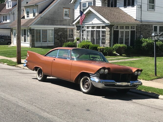

Faulkner on the street, waiting for Martha to clear his rightful throne in the garage

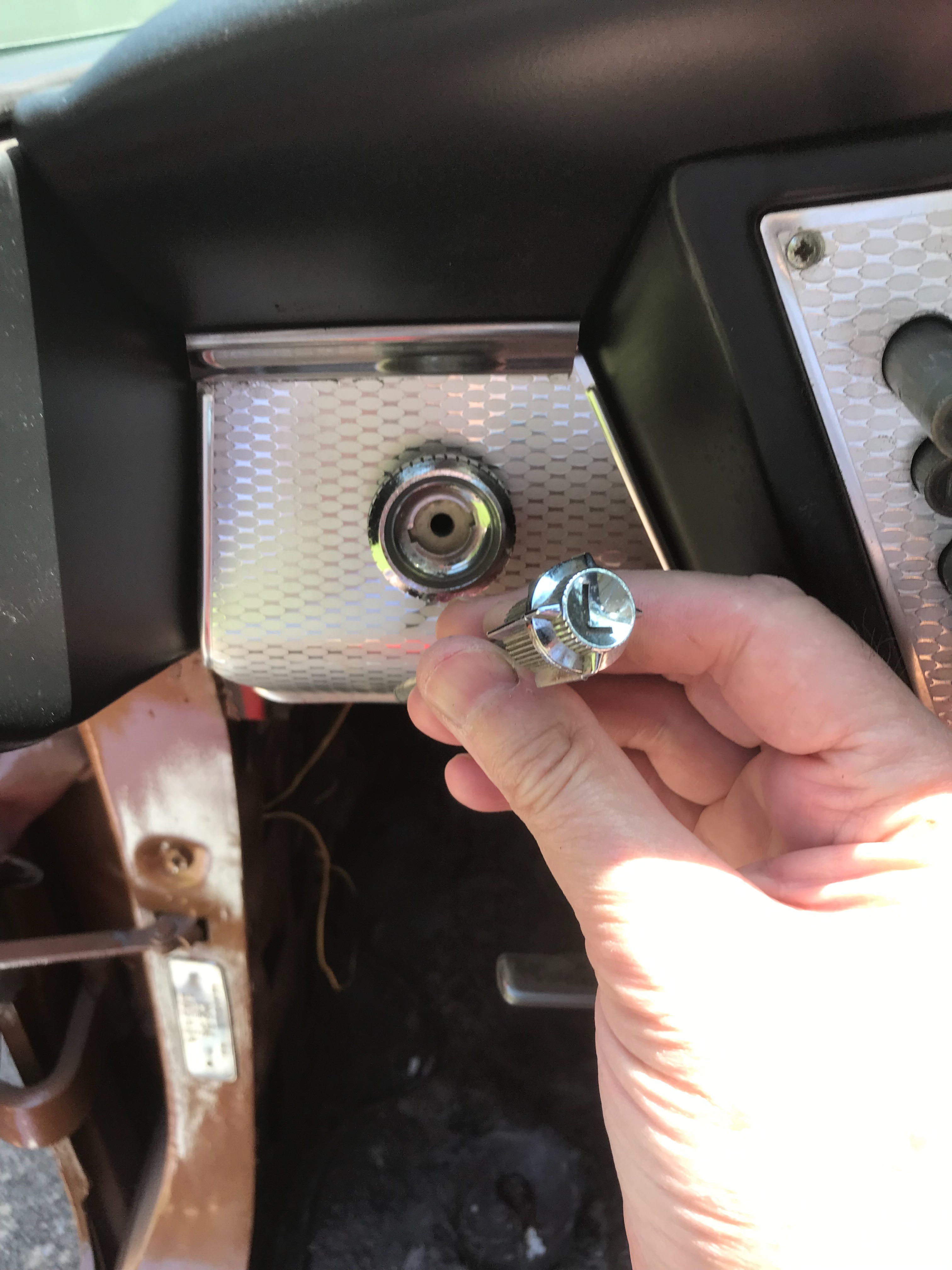

OK - by kneeling on a mat, and contorting my hand behind the headlight switch, I can find the release button. I push it all the way in, pull the knob out, and…
…it hits a stop. I tried twisting it while pulling, but still no love.
Is there a trick I am missing? I have a new switch - and, I have a used knob and post. Should I just sacrifice the old, and cut it off? Time’s a wastin’…
NVM!! It’s out :sunglasses:
