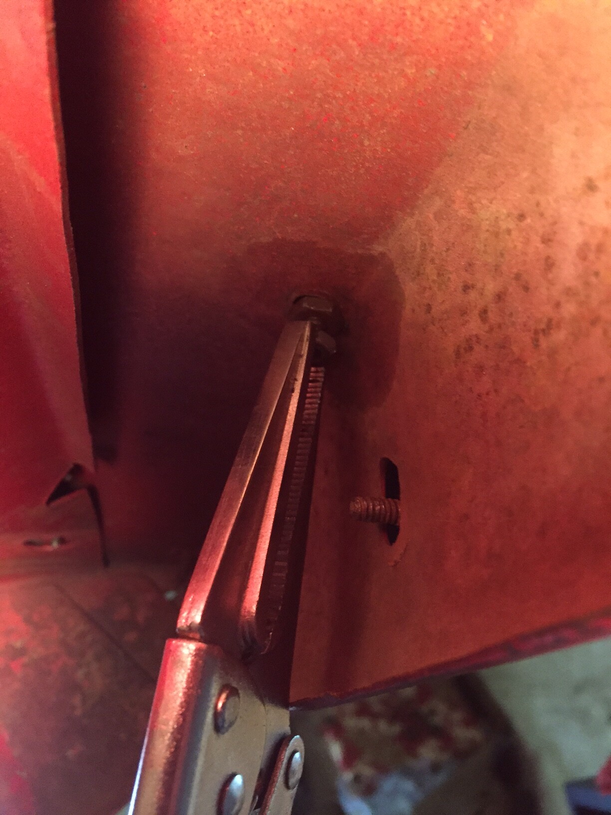

I started removing the nuts, and got to the last one. Oh no - the bolt is turning with the nut.
I don’t recall looking at these clips before. Is there a single clip with two bolts in it? If I cut it off - will I be able to replace it? Any ideas about how to get it off without cutting it?
Dan - There are two studs welded in each clip. I have an extra clip. I suggest you wire brush the nut and threads then soak real good overnight with a penetrant. If you can find two JAM nuts that size, they are thinner than a regular nut (Ace Hardware) place them as close to the end of the stud and tighten them to each other firmly, then with a wrench on the jam nuts and a wrench on the clip nut work the clip nut back and forth until it loosens. I’m sorry you will be upside down doing this but just think of how good you will feel when that nut breaks loose, yea! The other way is to clamp vise grips on the end of the stud, then wrench the nut, then cut the stud. Either way use plenty of penetrant.

Actually you could use regular nuts but I didnt think the stud was long enough, but try regular nuts if there is enough room. The weld has come loose on the stud so the clip nut will have to be losened. Splane this part time vs full time situation.

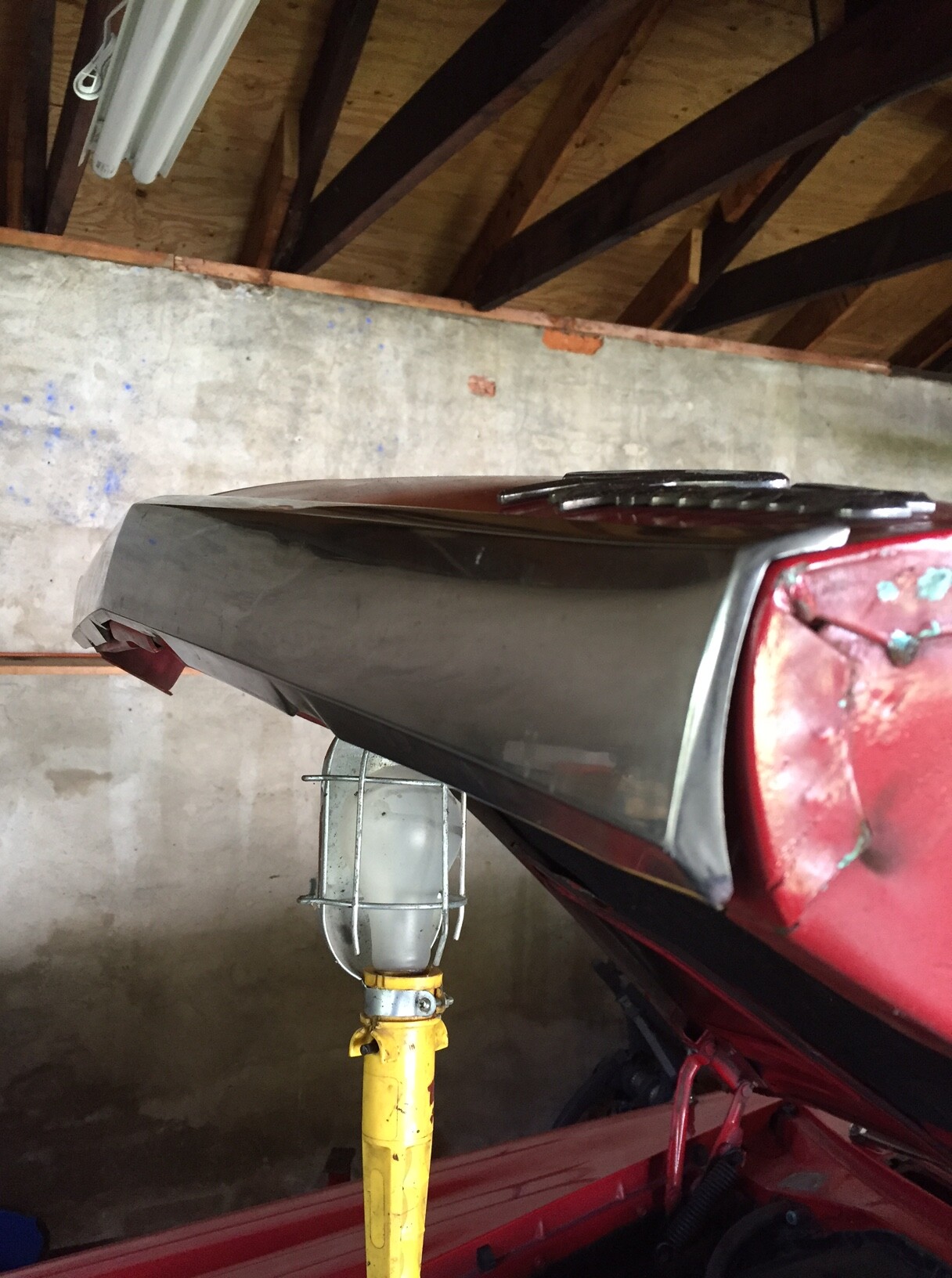

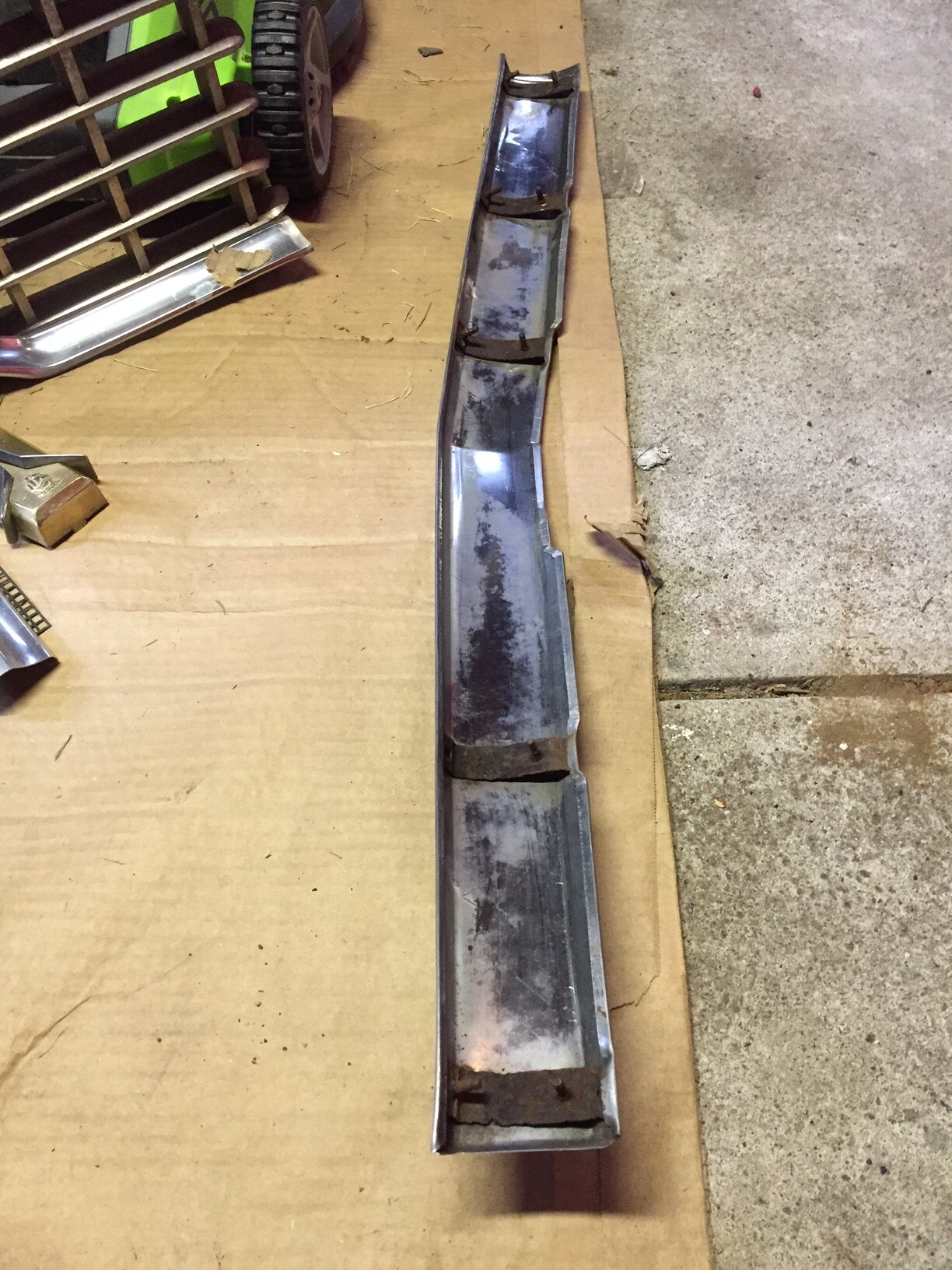

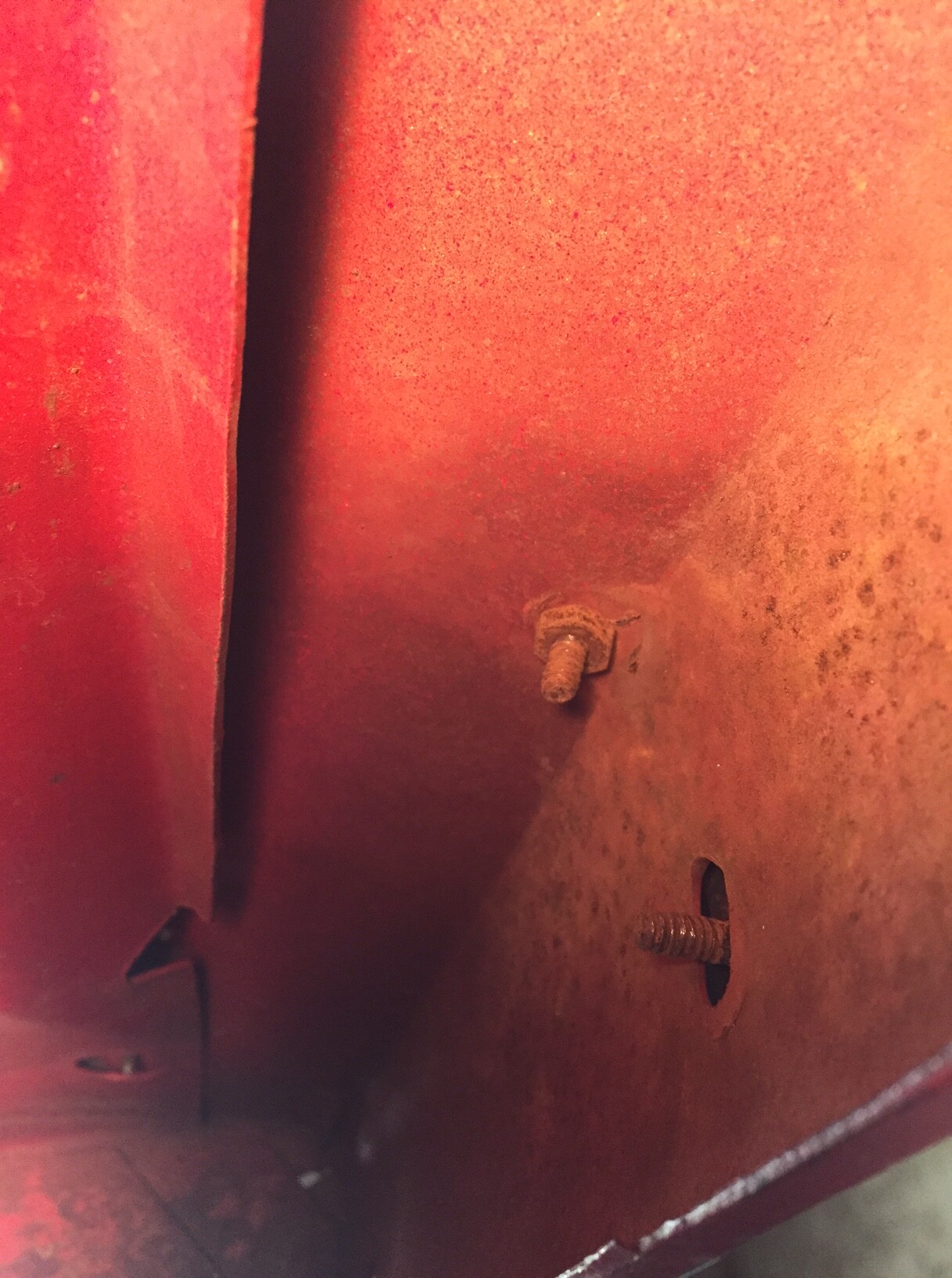

I went to my local hardware store, and explained about “jam nuts”. He looked at me as if I was from outer space. So, I went back out to the garage to tinker… I thought, maybe if I could put some tension on the clip by pulling on the bolt (with a nut on the end of it), I could turn the clip nut. And, after having loaded up with Liquid Wrench, it did turn a few spins…
But then, lo and behold, the bolt itself pulled free of the clip, and through the hole in the hood. So, the trim is off! But, I’m in for at least two clips. I had bought this trim piece off eBay moons ago, and Matthew and put it on for me - apparently, there was already one clip missing:

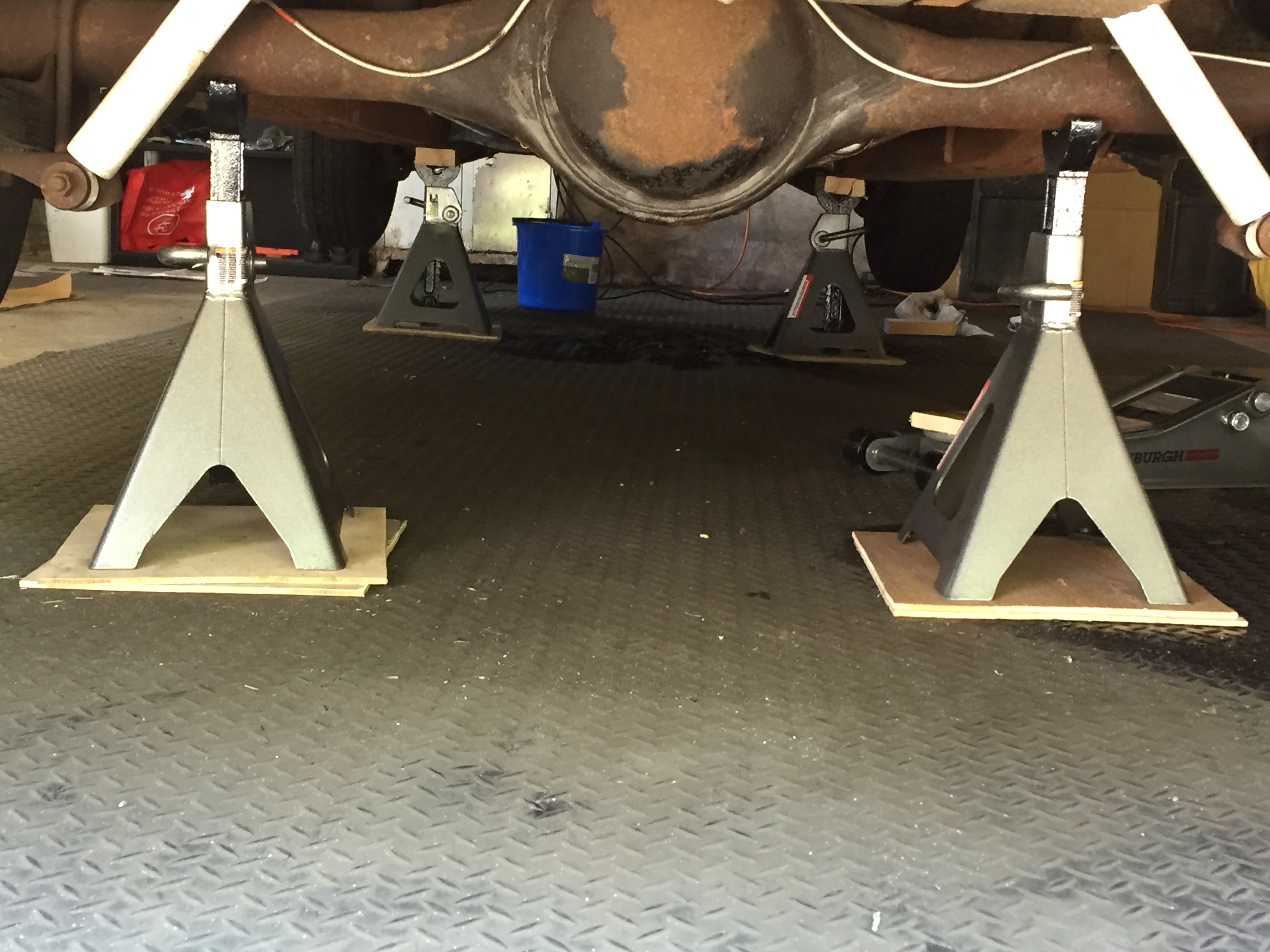

Faulker is up off the ground on stands. Love that floor jack from Harbor Freight! And to think I made do with that weeny hydraulic jack all those years…

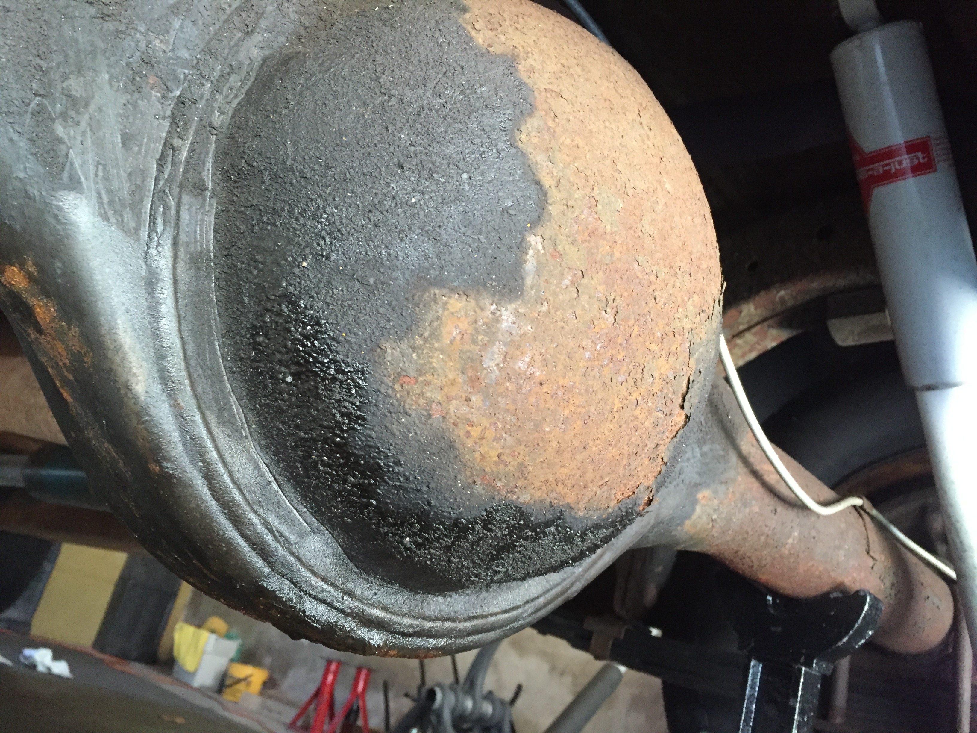

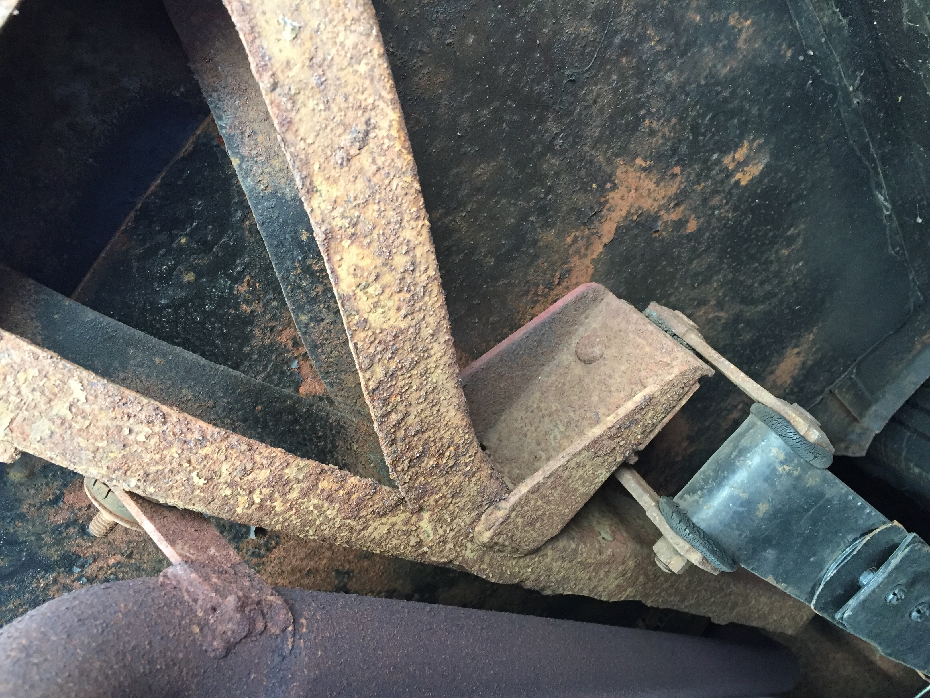

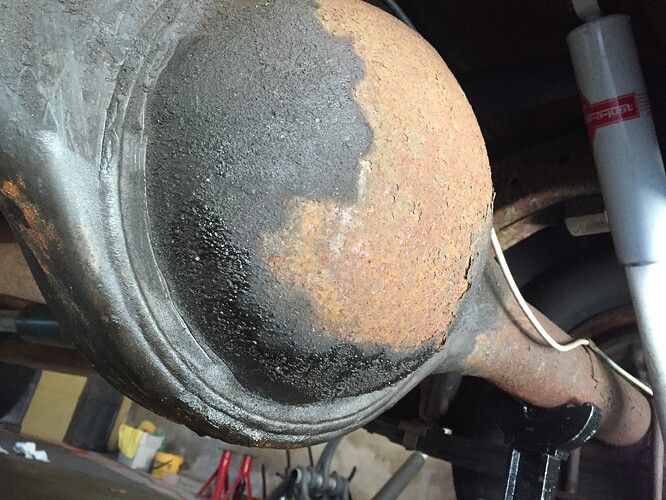

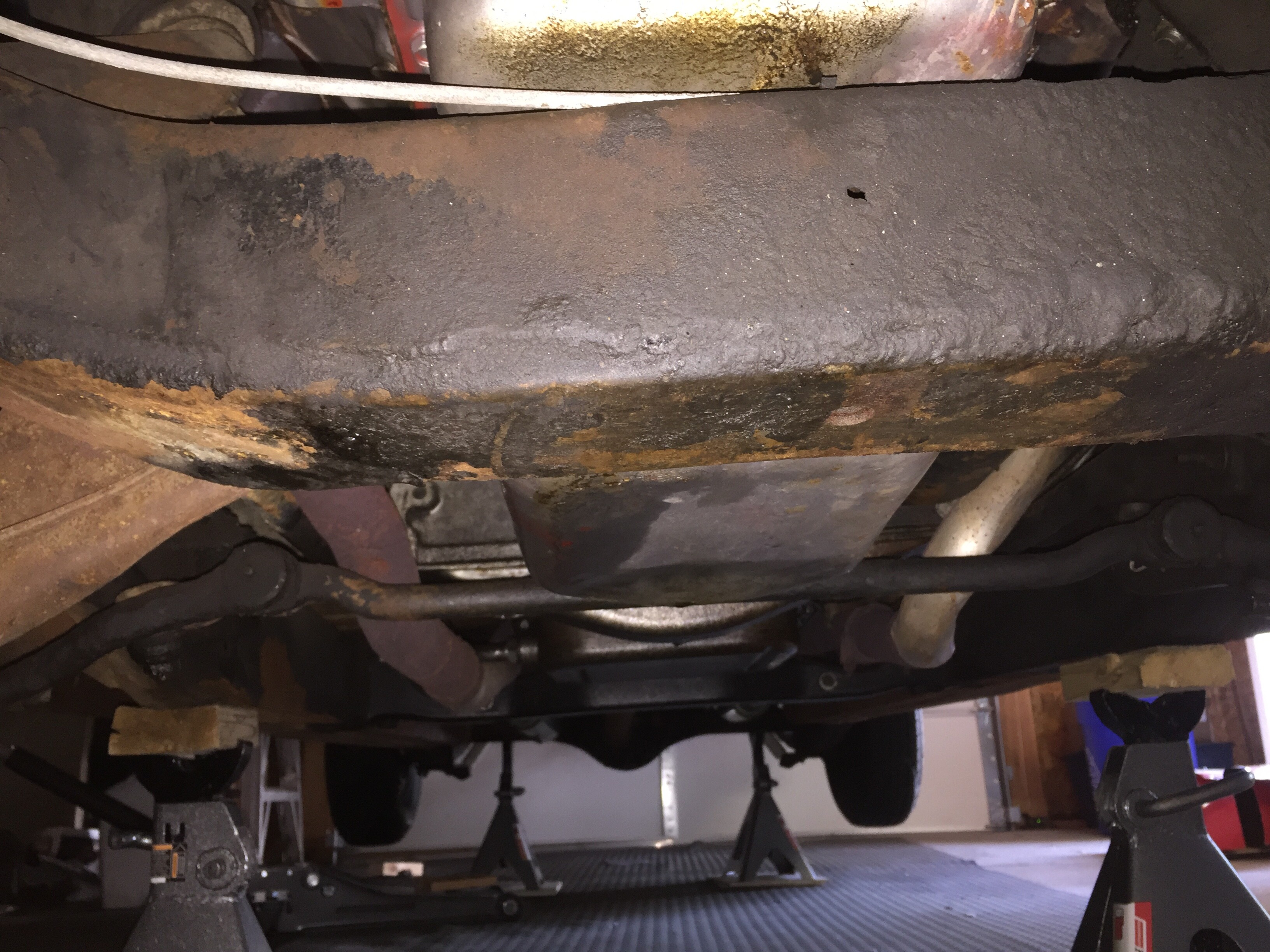

Lots of caked on grease where there isn’t rust. Fortunately, the rust is all surface - no weak spots, no rust through. Ought to clean up nicely. I’ll scrape as much of the grease off as I can, and then use this oven cleaner trick to clean up the rest. Hey, it’s not going to be a frame off, but I want to preserve Faulkner as much as I can.

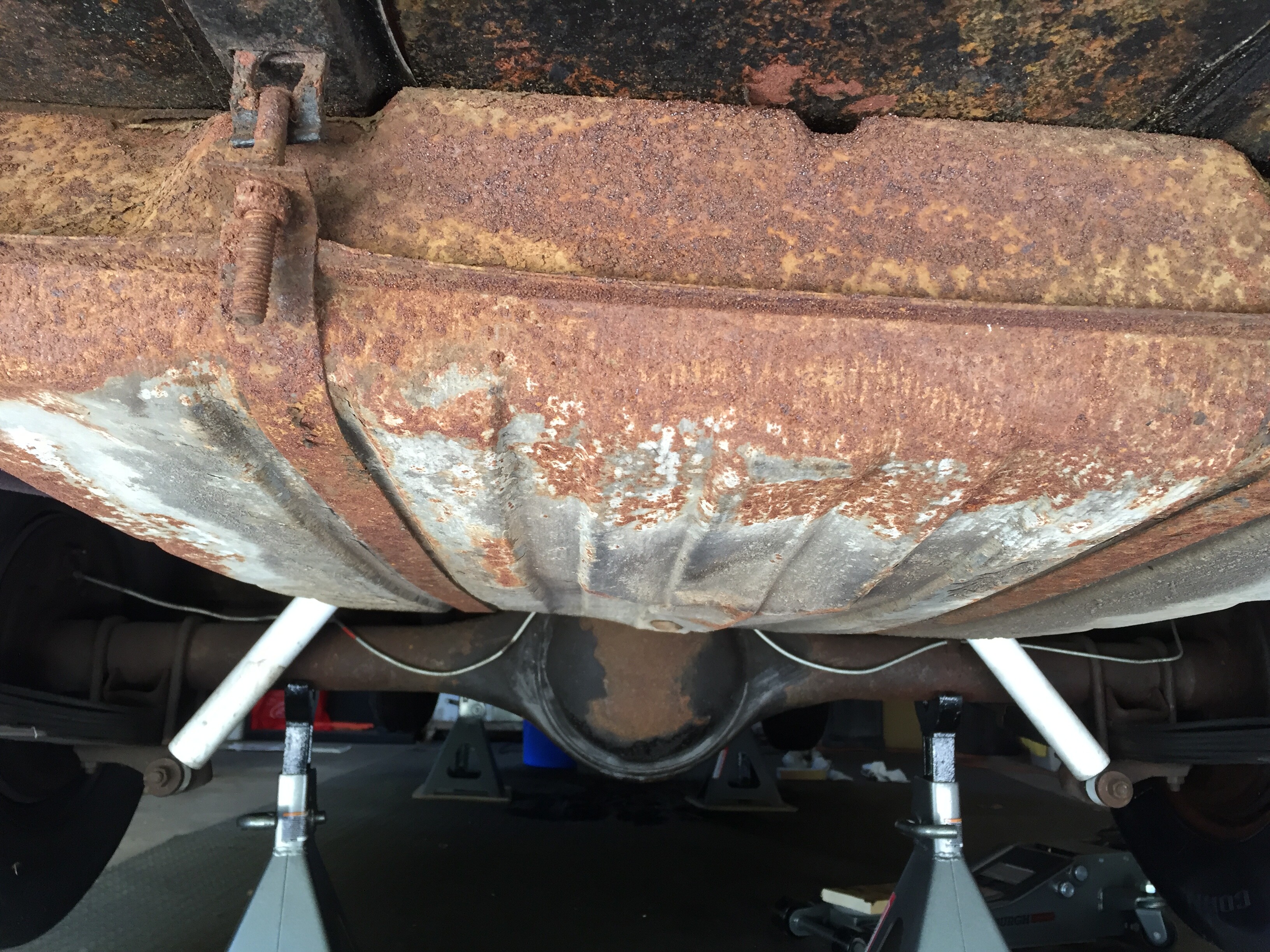

It’s so much easier to see what’s going on under here with the car up on stands. While I imagine I could clean the gas tank up and knock out some dents, it looks pretty far gone to me… I think the Van’s Auto replacement tank is the right thing to do:

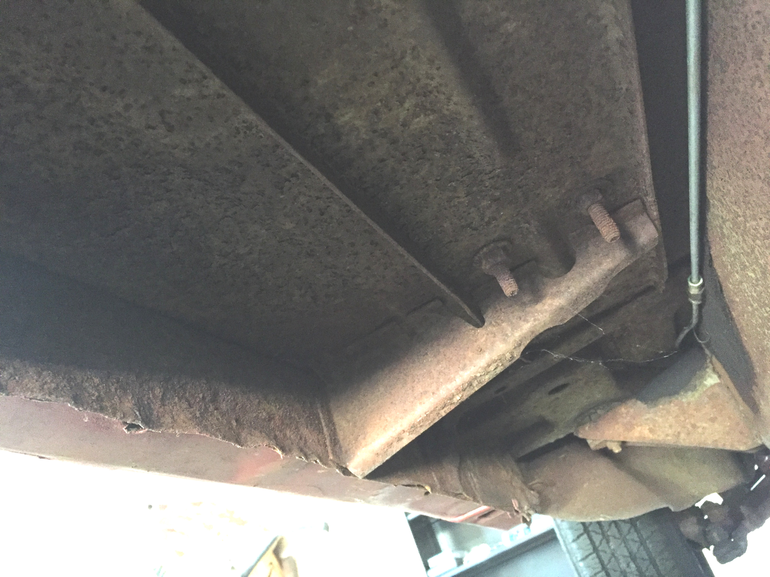

Lot’s of surface rust like this

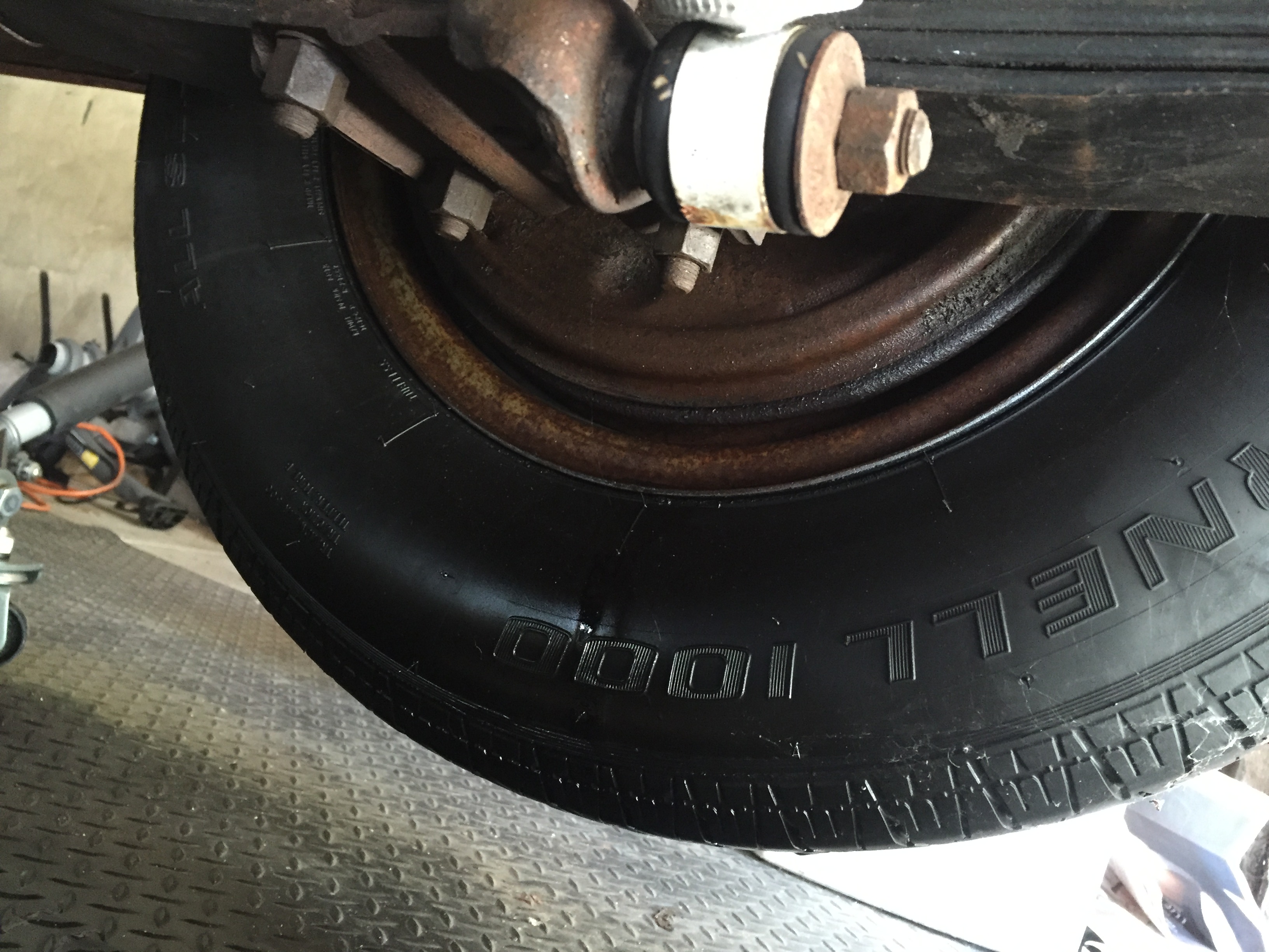

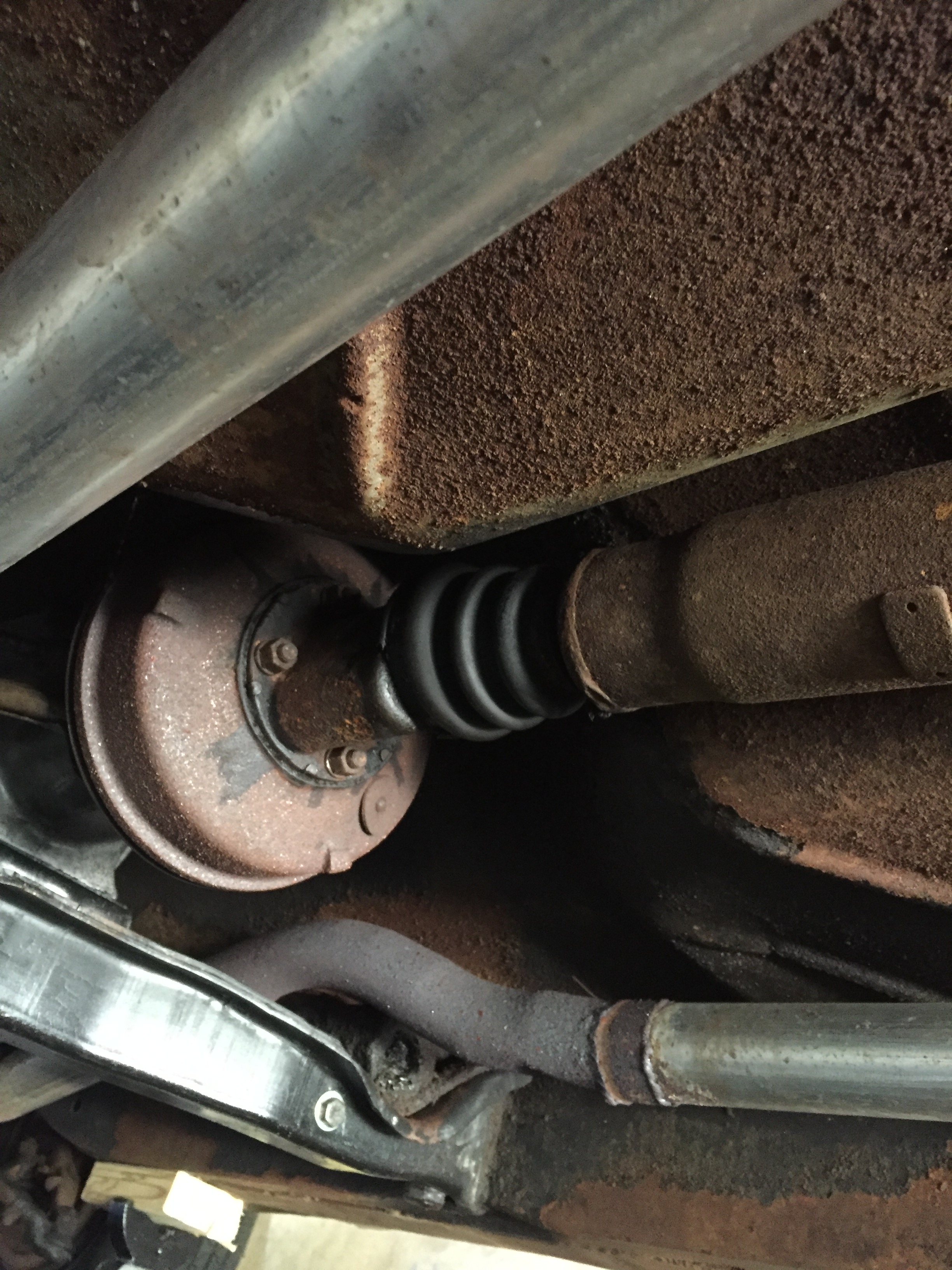

Uh-oh! A leaky wheel cylinder, right rear. I’ll be taking care of this pretty soon. We all know how much fun it is getting these drums off - good thing I invested in a puller

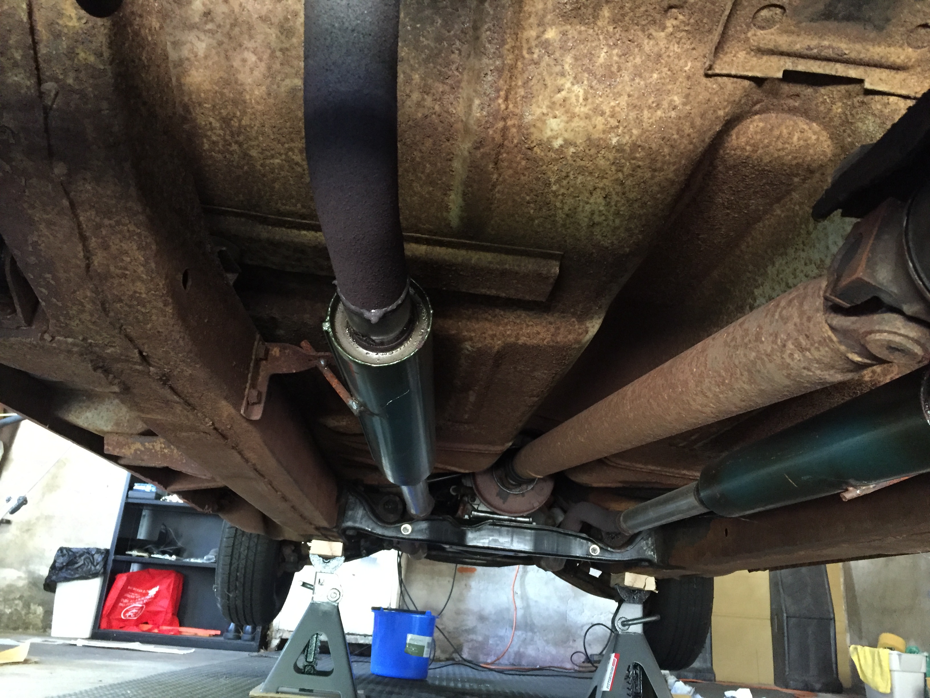

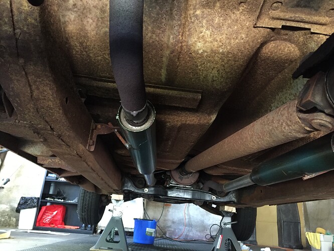

The Smitty’s are going - I bought a pair of mufflers from Ed Eckerson, along with the stainless exhaust (I’m missing one lead pipe), they will be going in replacement

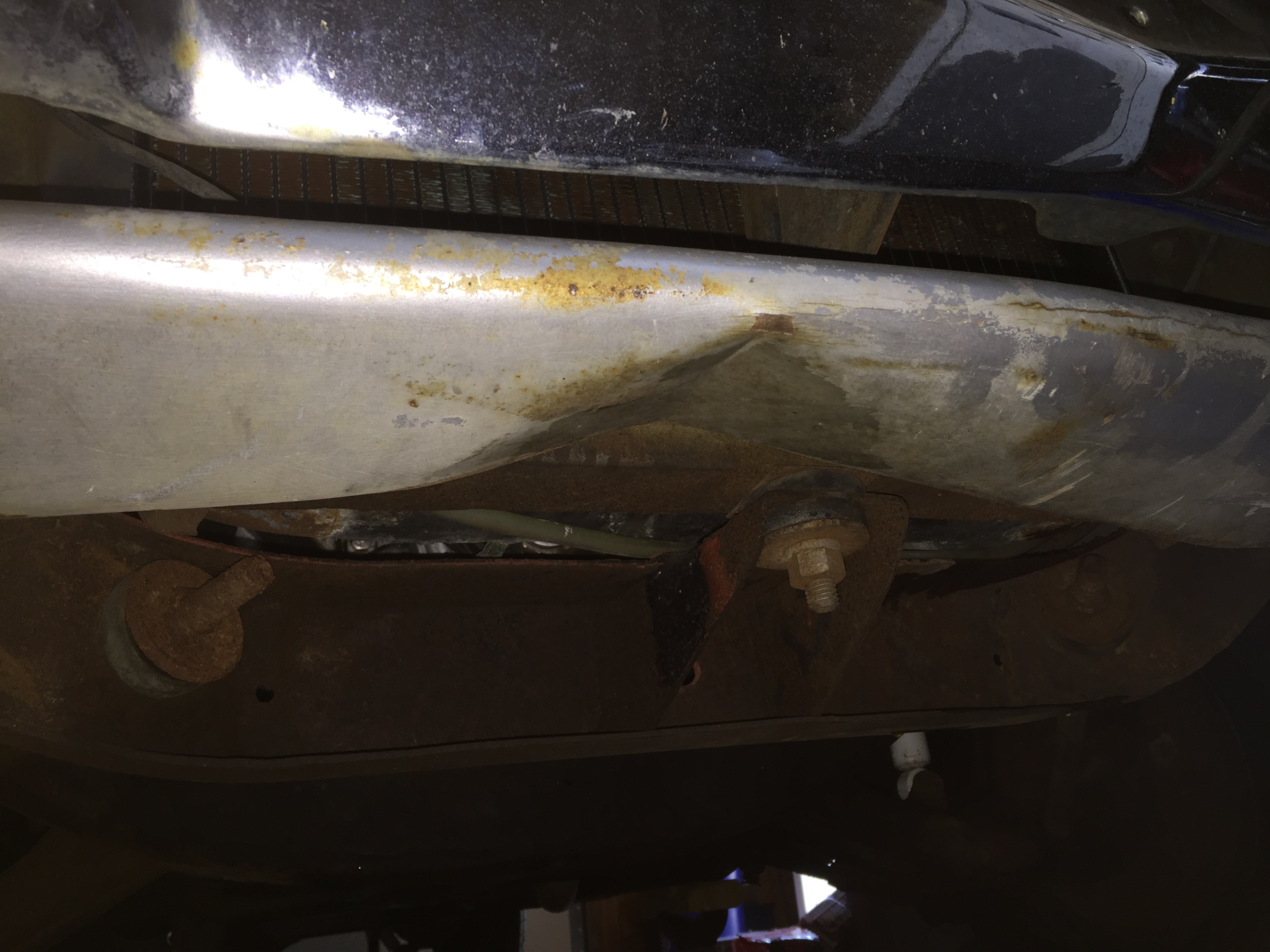

Talk about the Braille Method of driving! This poor valence is going to require a lot of work to bring it back
What do you think? Looks like I have my work cut out for me, doesn’t it…
What’s the advice for treating that surface rust, after wirebrushing it down? I’ve used Eastwood’s Rust Converter with good success on spots in the past. Then follow up with Chassis Black?

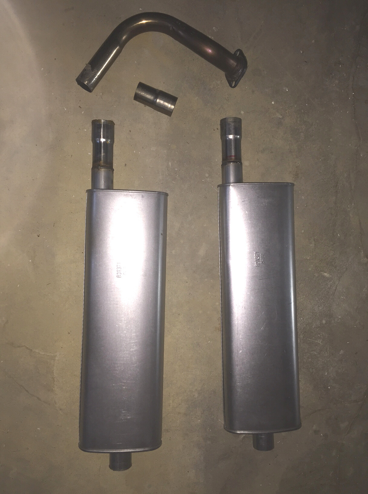

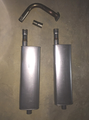

I never did open the package with the mufflers in it that Ed Eckerson sent me 6 or 7 years ago! Wow… They are beautiful:
Which is the front, and which is the back?! And would the off-center pipes go towards the outside of the car, or the inside… I’ll need to get stainless lead pipes for these, and another manifold pipe. I’ll have to line up to see which manifold this is for (unless Ed remembers!). Not sure what the little adapter piece is for.

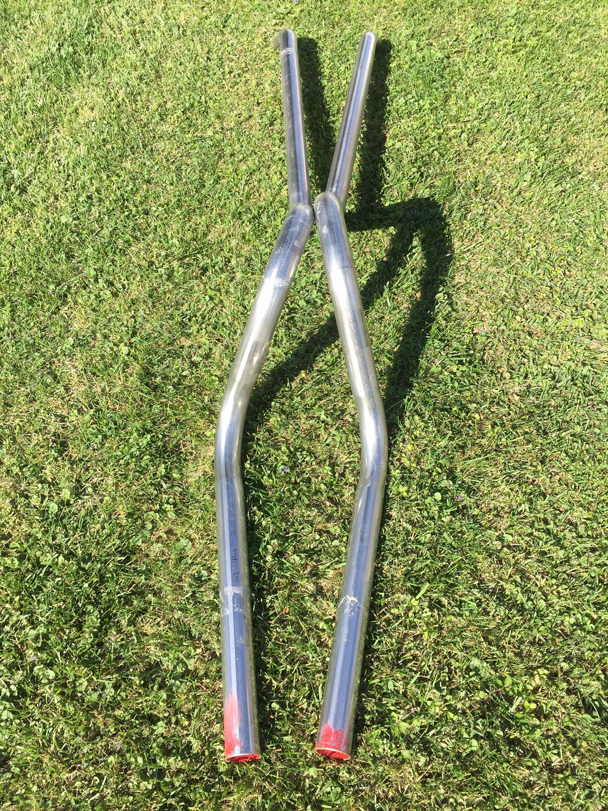

And here are the beautiful tail pipes, also from Ed!
I just need to get the missing front pieces, some clamps and hangars and I’ll be all set. Lessee… the undercarriage should be all cleaned up and painted by the time my exhaust expert arrives from Poortvliet… :laughing:
Dan - If possible scrape the crud off, then wire brush with a 3 inch coarse cup brush on a small side grinder (harbor freight). I know it will be difficult laying on your back (wear goggles) but it will make the job less difficult. Make sure you clean all oil and grease with a solvent like minreal spirits. Next brush OSPHO every where, let set for 10 minutes then lighhtly wipe with a rag. Best to let set overnight then coat with Eastwood encapsulator, two coats if possible. It’s an epoxy and you should not need the chassis black.
