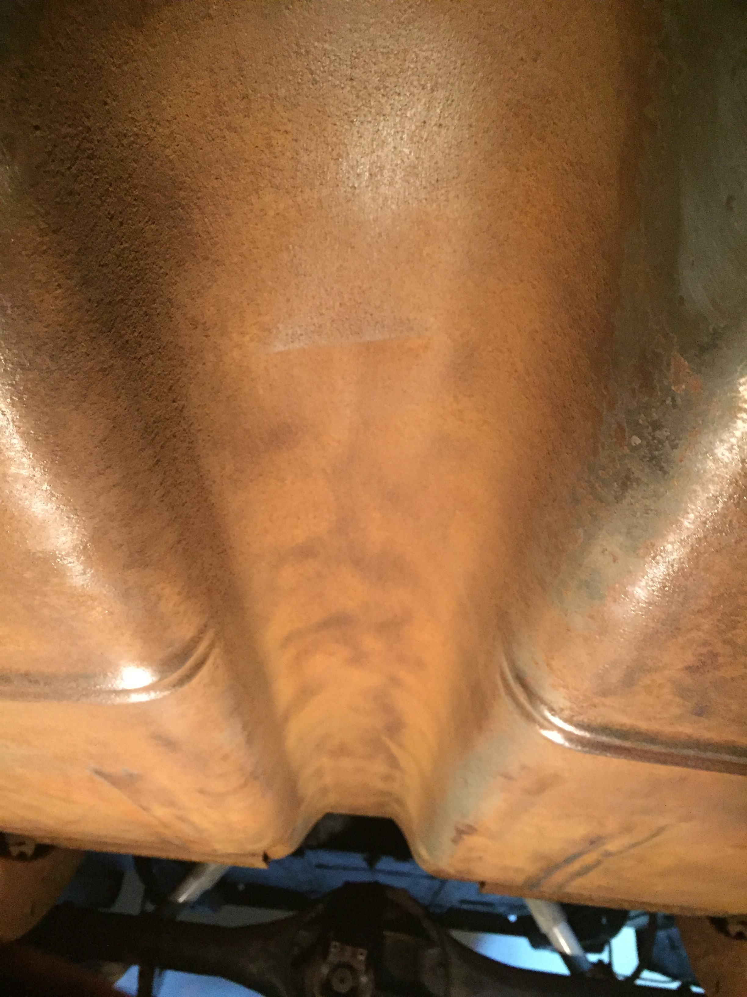

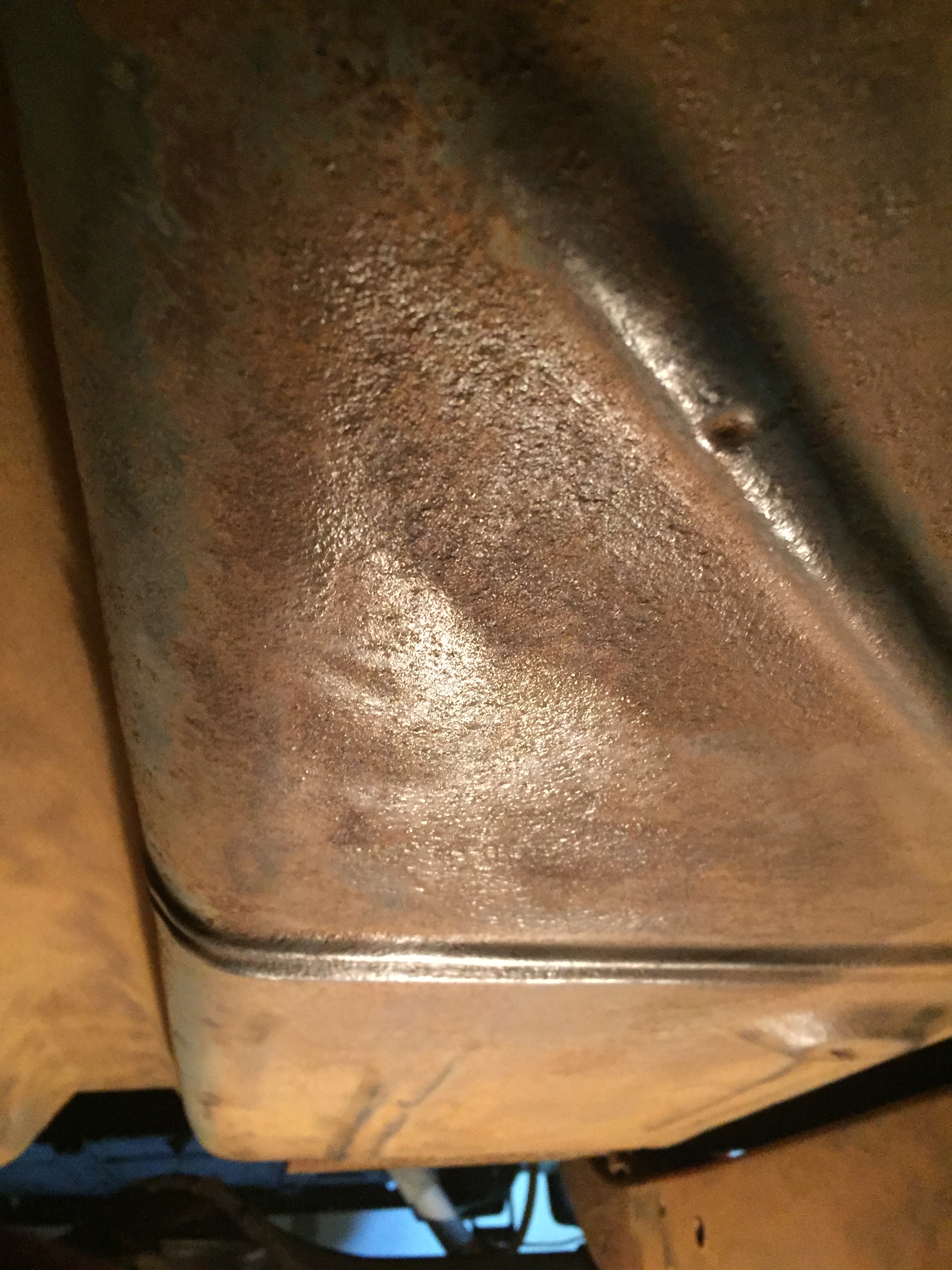

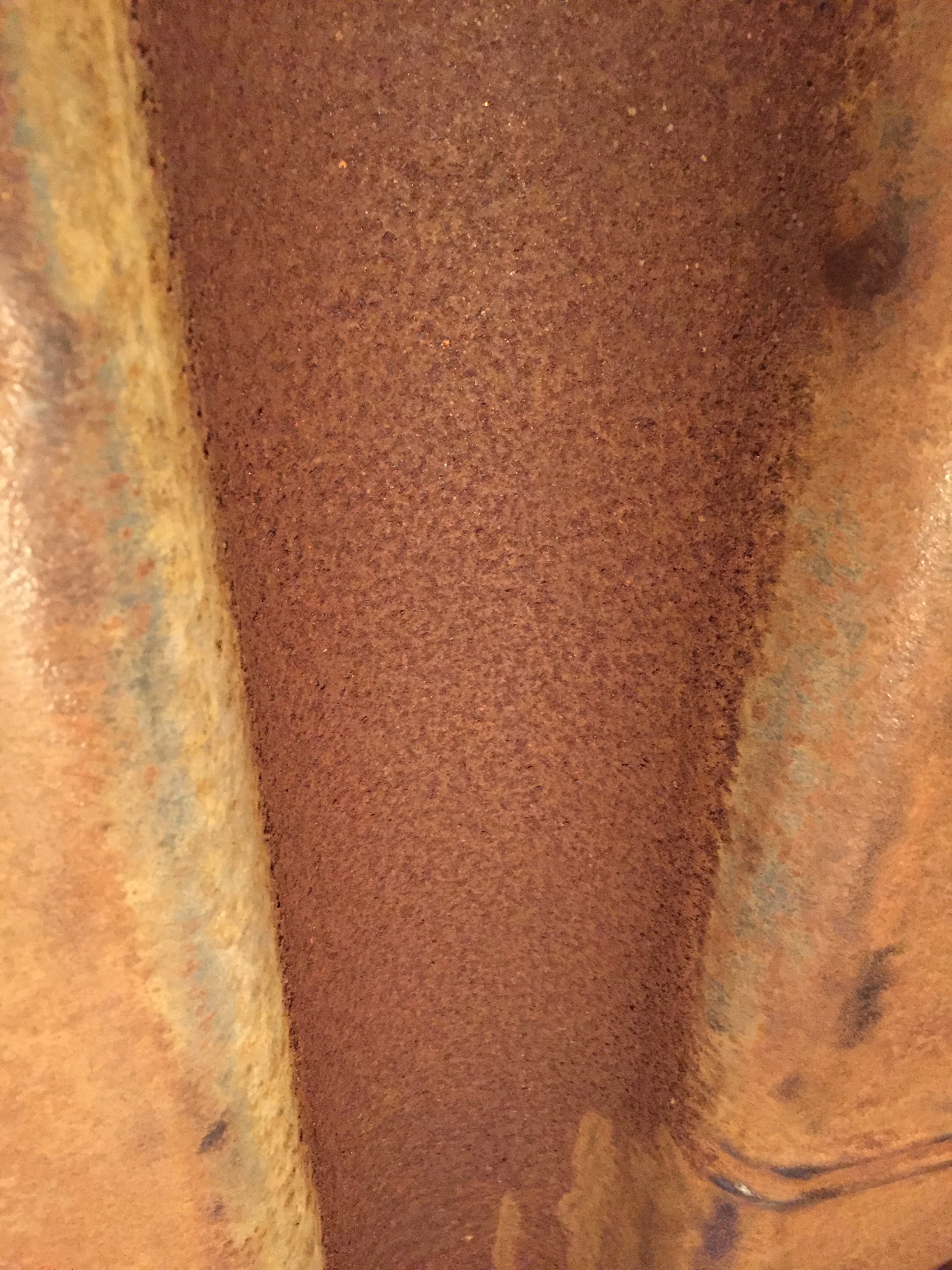

As a wise man once said, you just have to put your time in, a little here, a little there, and eventually you will get done. I dragged my sorry butt under the car again today, and while I still have some finishing up to do above the rear axles, I attacked the underside of the floorboards. The tunnel in this shot, it what pretty much everything looked like under there before I started:

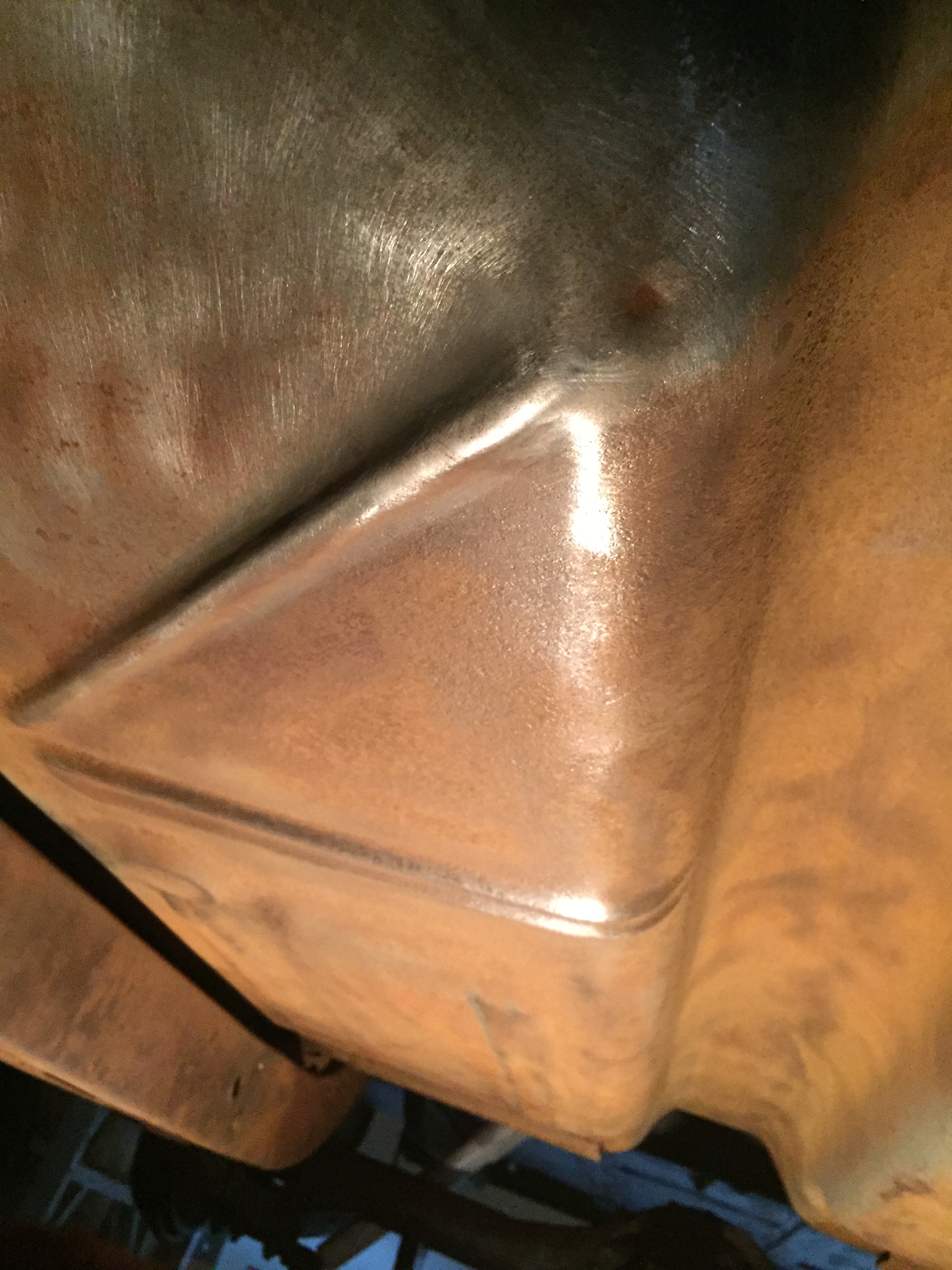

The floorboards are in great shape, after brushing - these will come up nicely.
All around the tail stock of the transmission, and the emergency brake drum…

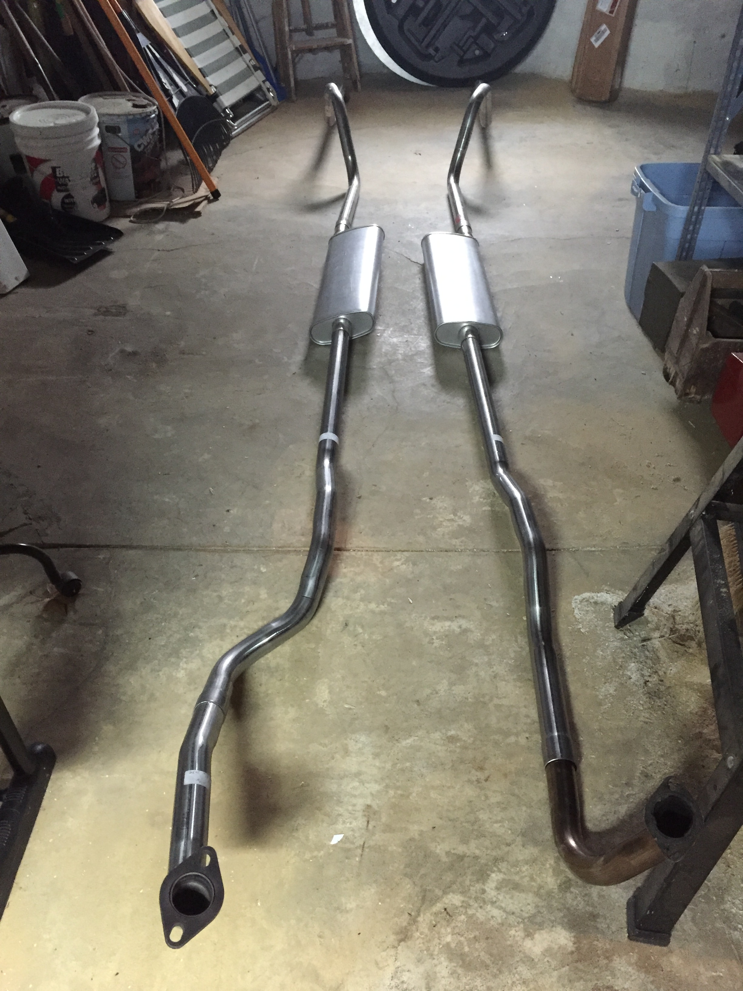

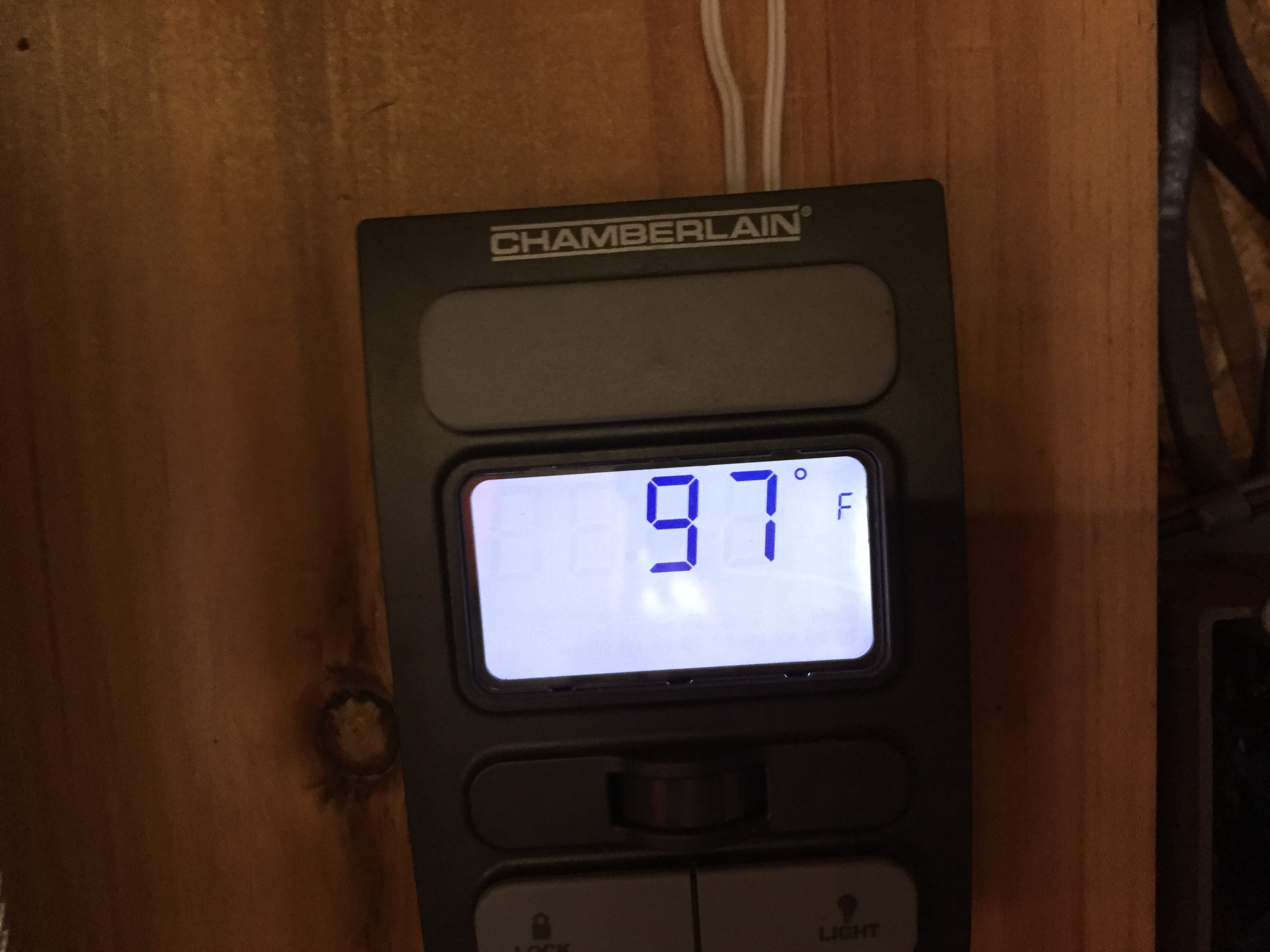

Too hot in the garage these dog days of summer, so I played around in the basement with the exhaust shipment that just came from Waldron’s. Oh, that it would be this easy to install on Faulkner…
I need two more clamps (I got two, from Ed Eckerson), and four hangers - two for the rear of the muffler, and two for the rear end of the tailpipe.
The clamps are easy to come by, the hangers not so. Any one have a supplier they can recommend? Perhaps I’ll go back to Waldron’s for these, if they have them.
I only ordered the lead pipe for the passenger side manifold, because Ed had tossed in the driver’s side. But it’s 1 7/8" OD, and would need a sleeve to fit the 2" ID pipe to the muffler… Not sure it’s the right shape or length, perhaps I’ll order the driver’s side from Waldron’s too.

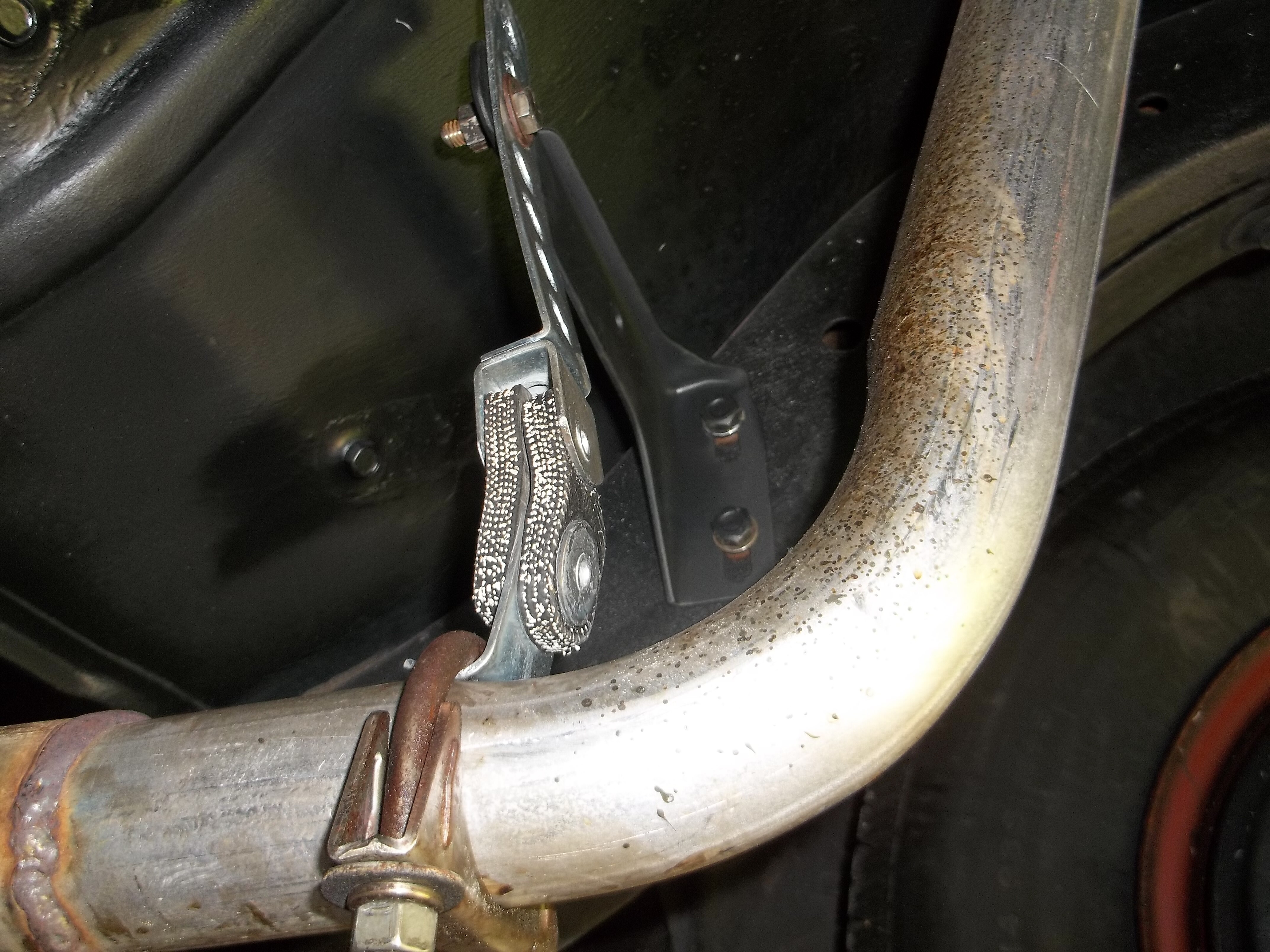

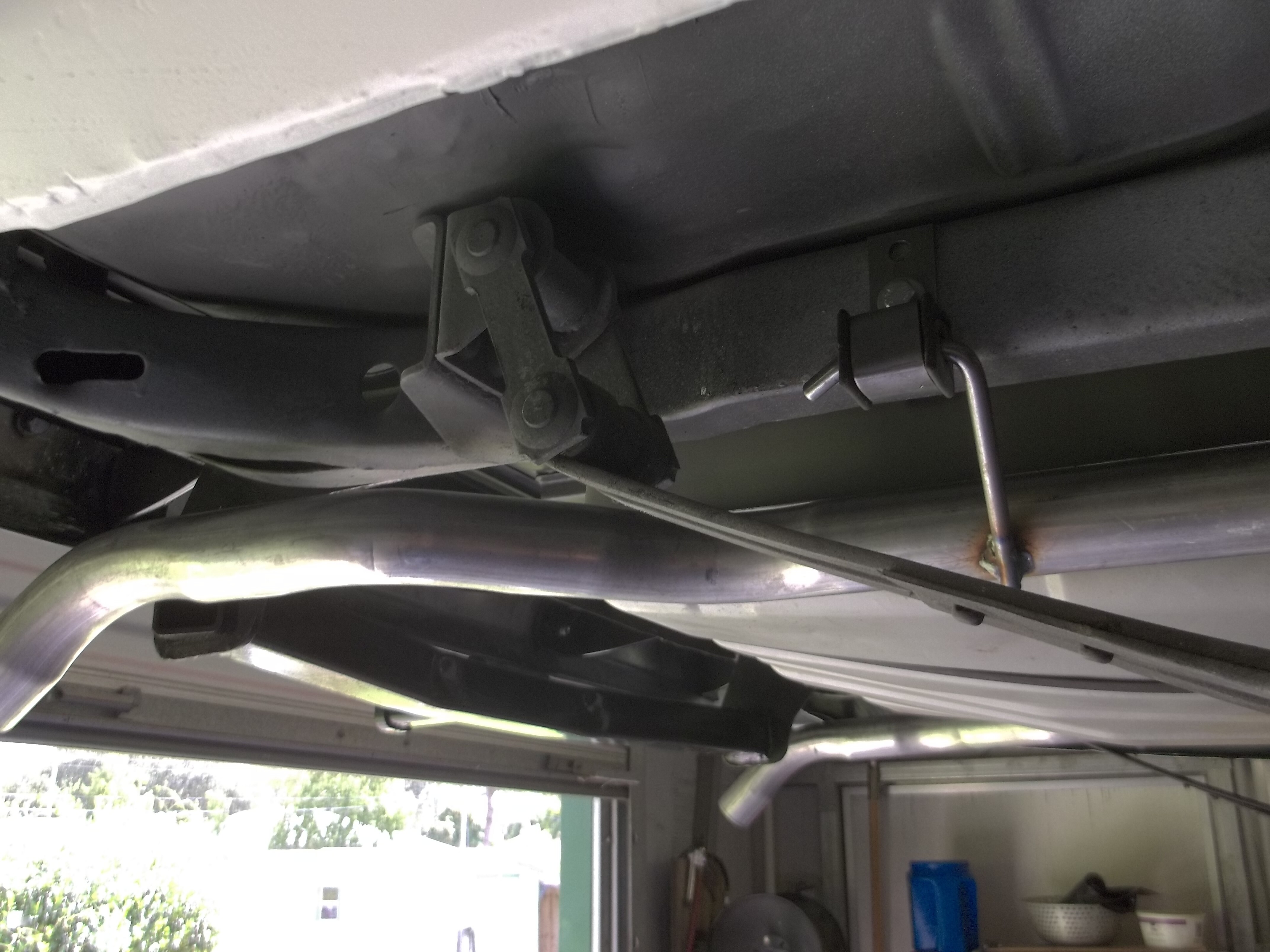

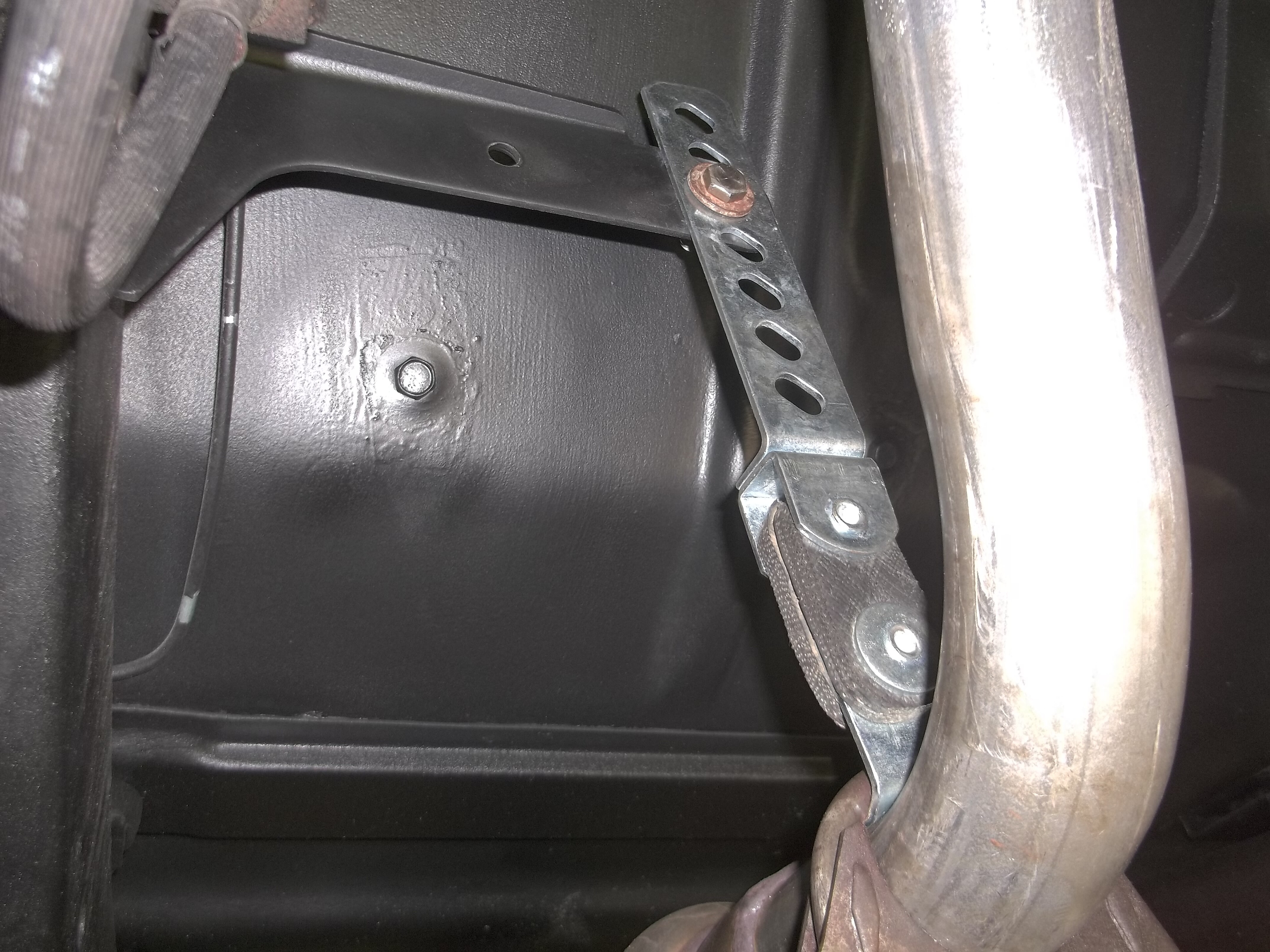

Just some ideas about hangers. Dick’s Convertible Project page 23. Dick’s 59 Red & White Sport Fury Restoration page 15.
Dick.,
Ah, and here we are! First, from the convertible - towards the end of the tailpipe:
This looks a lot like how they mounted the exhaust in Faulker, just rear of the muffler - except, no rubber shock mount :imp: Where did you get those?

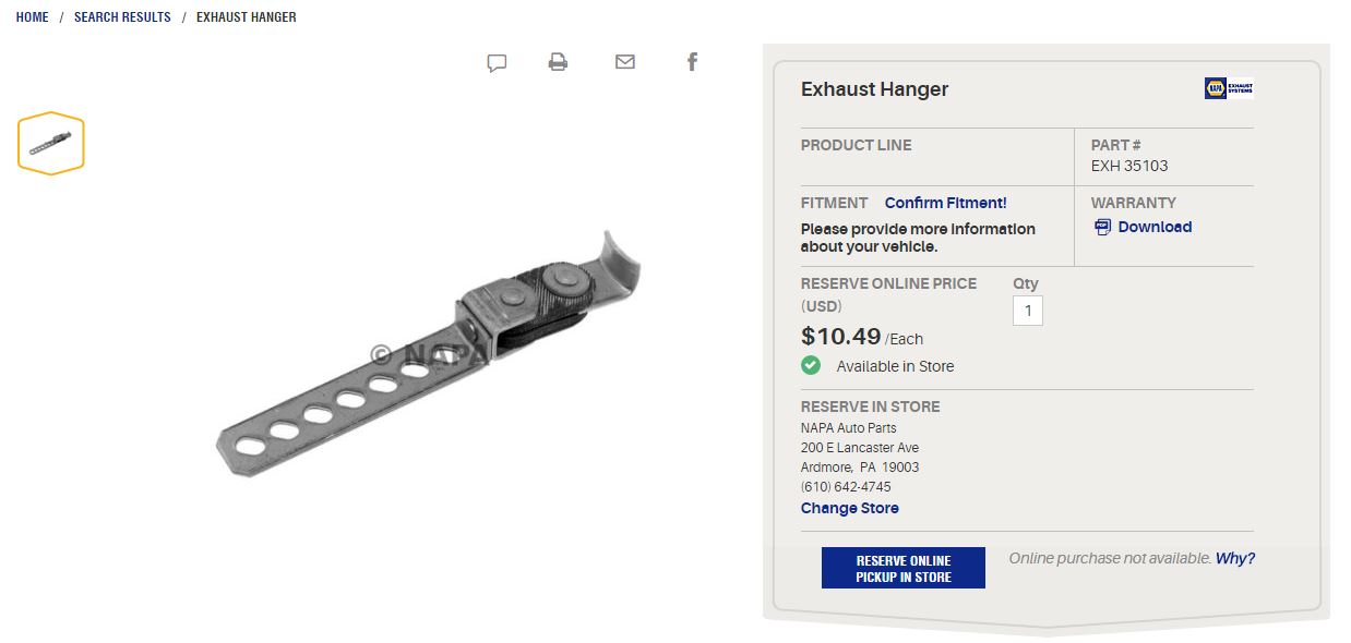

I like these from the Red and White Sport Fury, that you said you got from NAPA:
I think I would use these at the end of the tailpipe, as well as at the rear of the muffler. Part number, please!
Pull up http://www.napaonline.com, search Exhaust Hangers (88 of um). look at EXH36316 and EXH35103.
EXH35103 - it’s what I’m tawkin’ about!
Thanks, Dick.
Because I have a trailer receiver the tail pipes had to be routed on the outside of the recever so l had to use a local muffler shop, they supplied the hangers. I think NAPA might have them, look thru all the hangers.

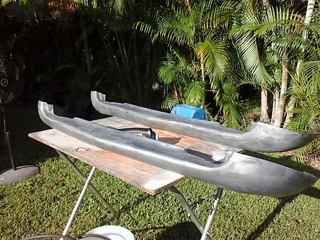

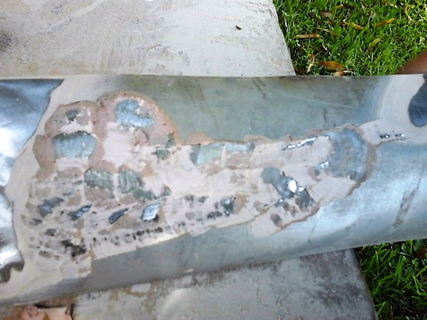

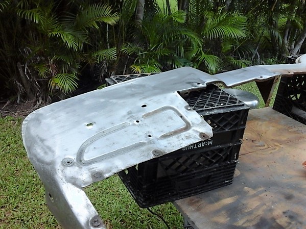

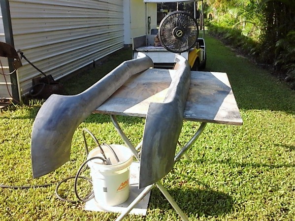

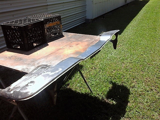

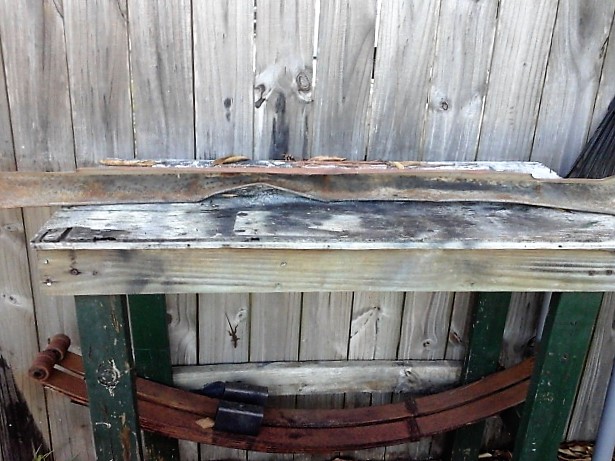

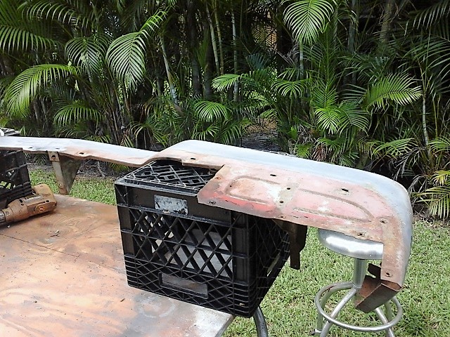

A little report on Koch’s Auto Body Repair Shop. Dan sent me a mess but I’m gettin there. The valance and splash pan took a beating at some time and rather than take them off the car whoever worked on it did not try to remove any dents they just bondoed the dents right in place. Well, all the bondo is gone and dents are out as good as they are going to get, all it will take is a skim coat of bondo to make look nice. This is what I call Valance heaven. One of them I got on ebay for $10.00 while the rest of you were sleeping. The other one I’m going to put on ebay with a reserve of $1,000.00. :laughing: See the pitchuhs.
Amazing, Dick Koch! Amazing…

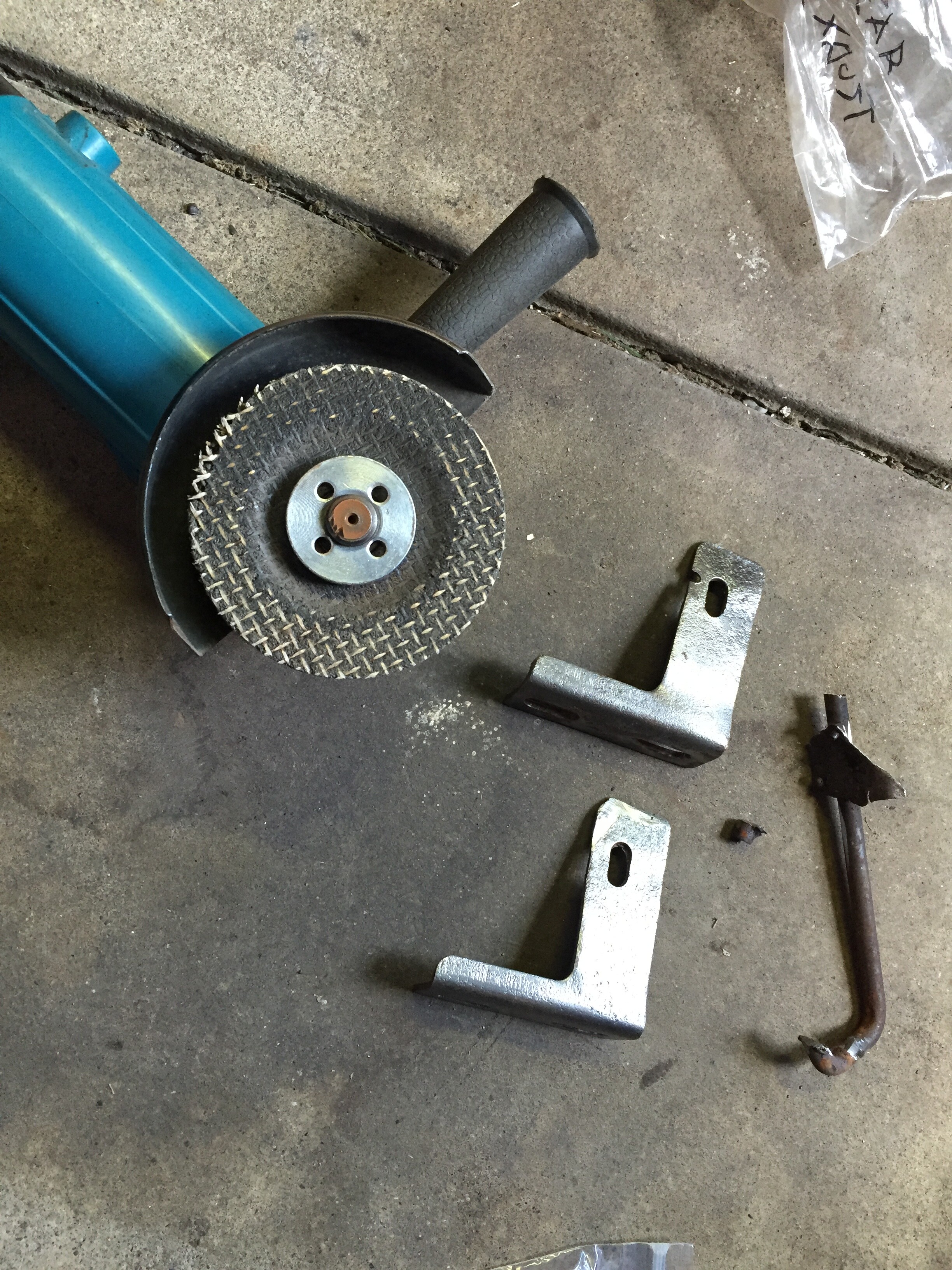

I never did get under Faulkner. but, I redeemed the other exhaust bracket from the grips of a Midas hack job

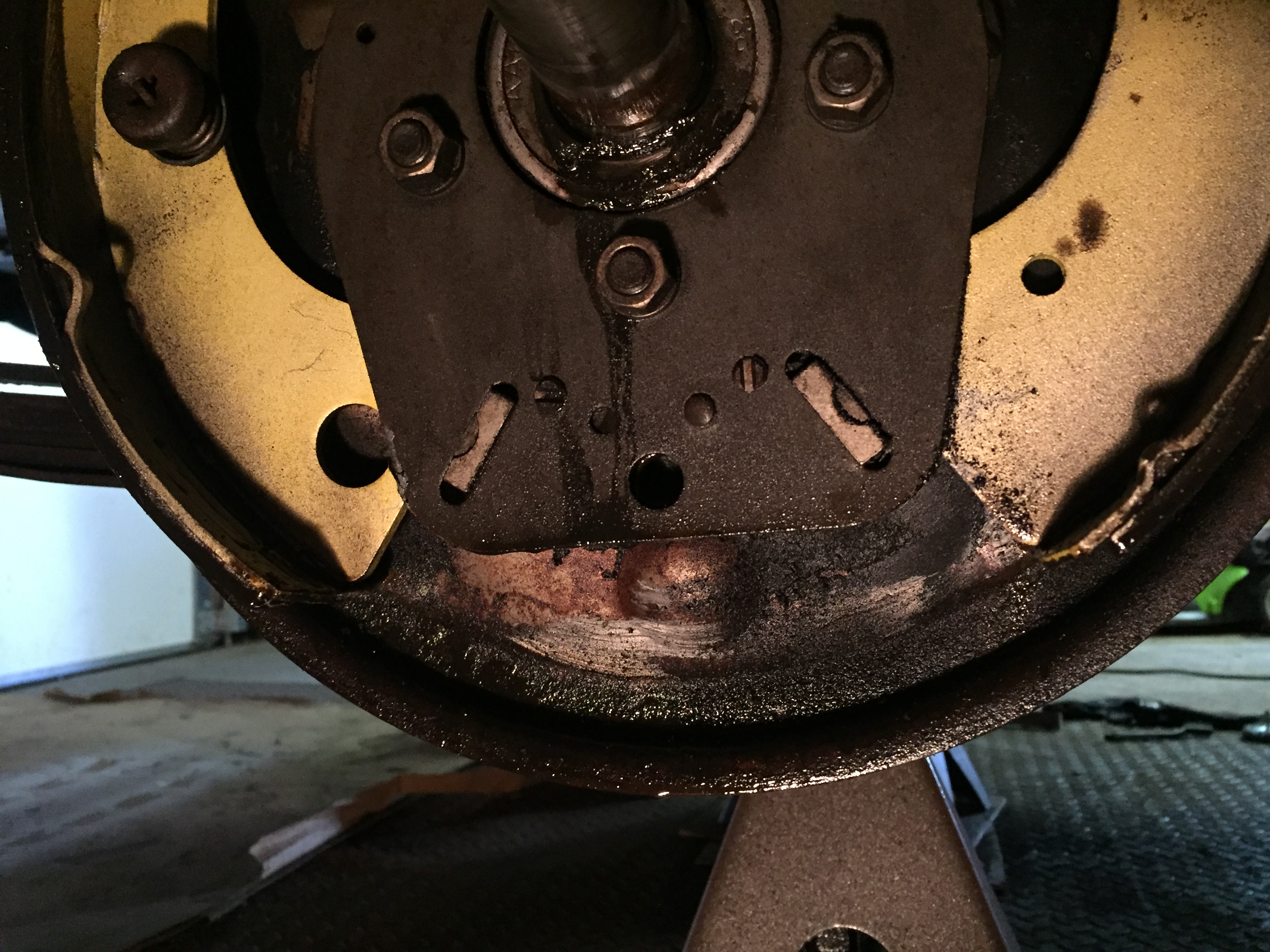

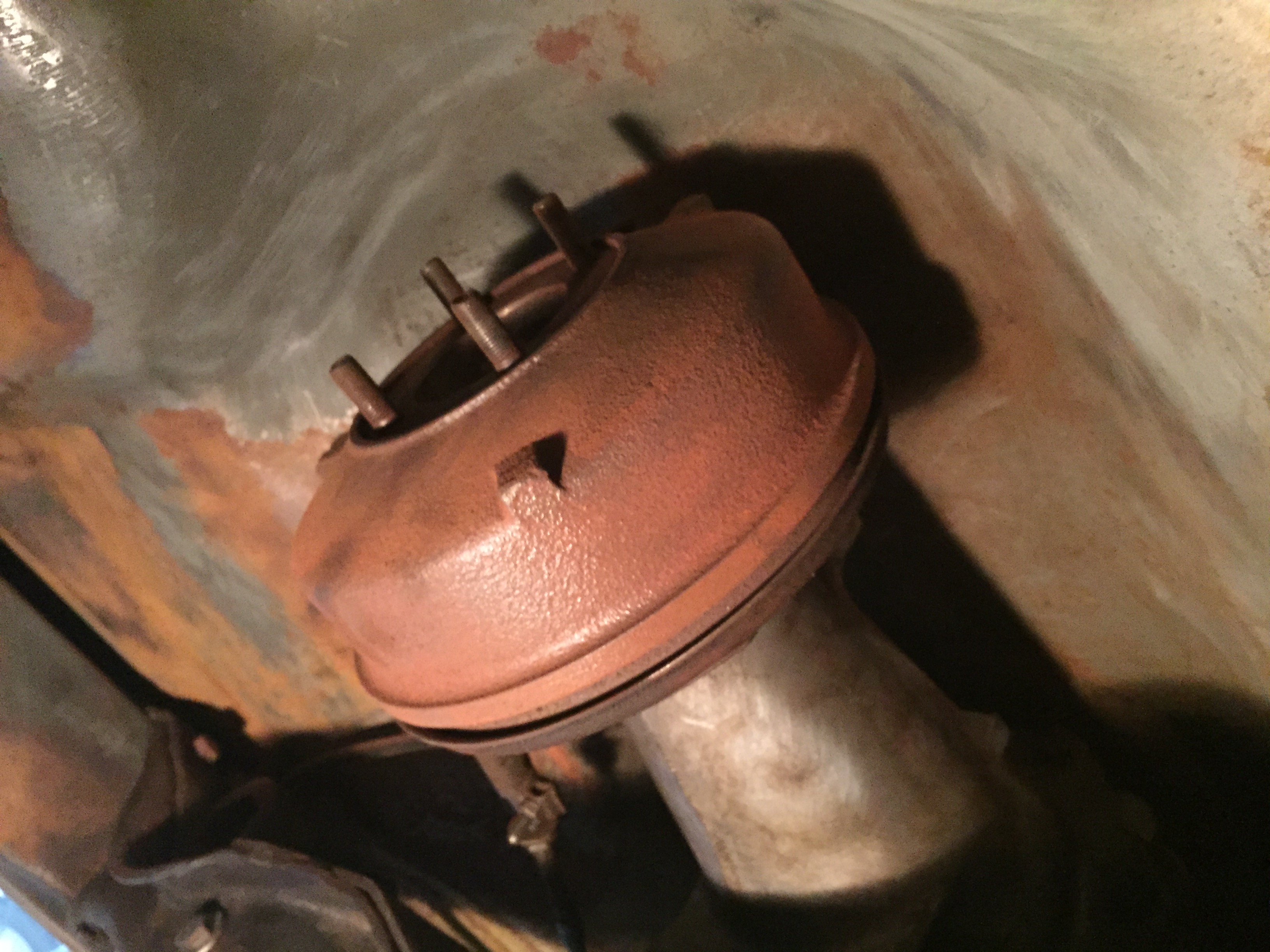

And I decided to tackle the leaking wheel cylinder. Except, it’s not the wheel cylinder at all! To go along with the weeping pumpkin plug, I’ve got a bad seal. It gunked up the works pretty good. the drum itself is in great shape, though

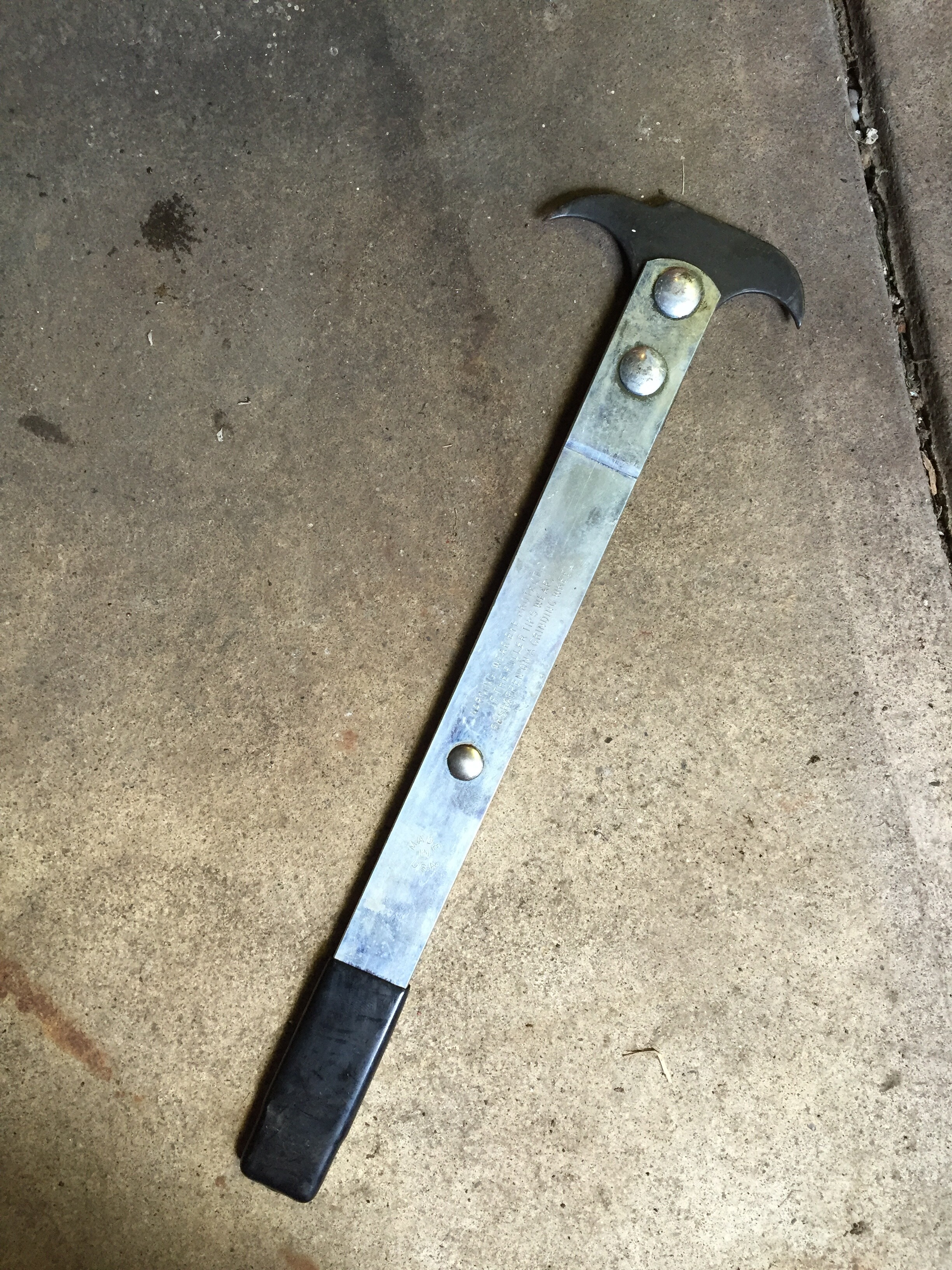

This is the tool I need to pull it, correct? It’s been a while.

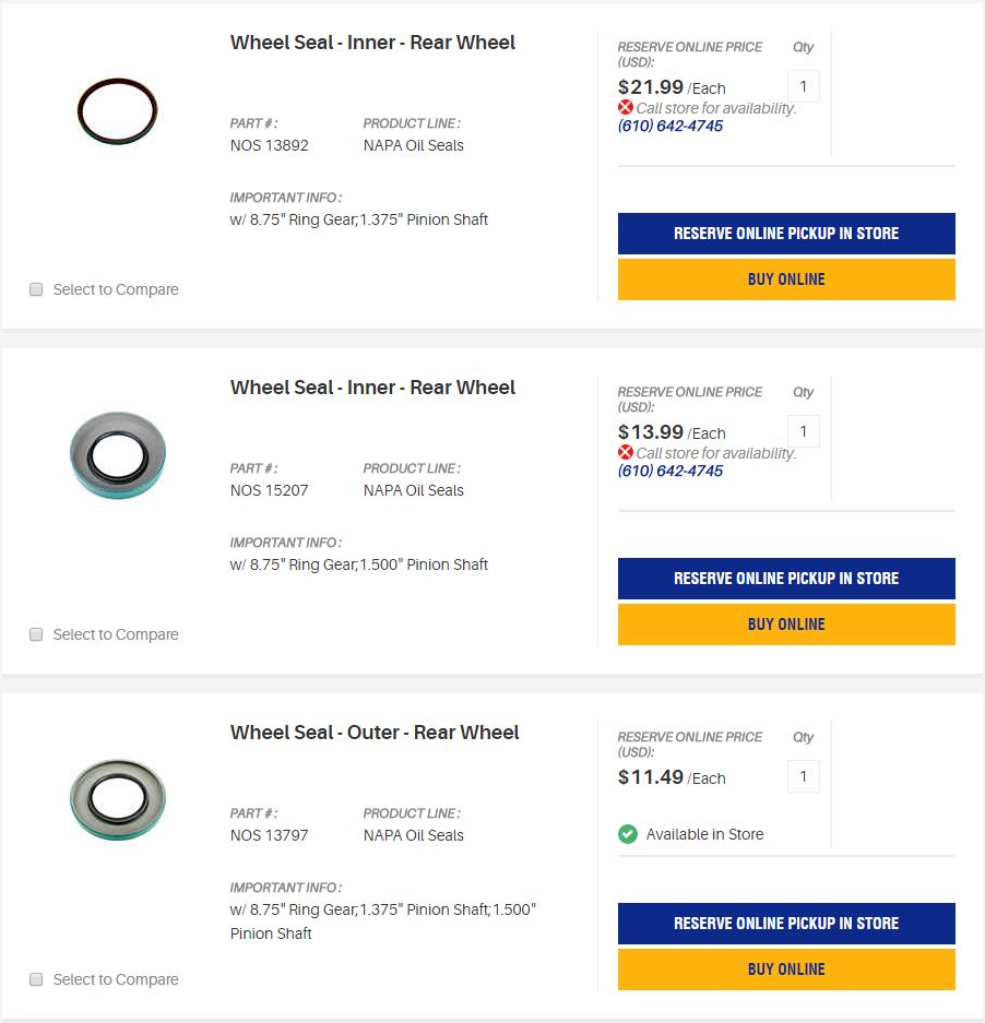

I’ve got to place a NAPA order anyway for the exhaust clamps and hangers, I’ll place an order for a seal too.

Hmm. I’ve never replaced inner seals, just outer ones. Is replacing the inner seal something I should even mess with? If so, which one here is correct? I don’t have the first idea how I would extract it…
The tool you show and a flashlight is what you need. The inner seal usually fails first but you should replace it anyway. You will find the correct numbers on the seals you remove. Take pictures and refer to your manuals. I think there is a land for the inner seal to rest against.
Thanks, Dick. Does gear oil only find its way to the axle when the car is in motion - i.e., should I tilt the one side up when I pull the seals, to avoid it dripping out? (Although, between the seal and the plug, I suspect I’ve lost quite a bit of oil already.)
You shouldn’t have to tilt the car, mine never ran out. If you never changed the gear oil nows the time.
