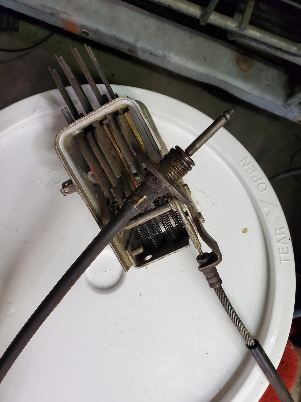

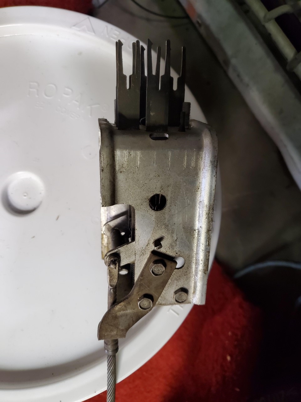

I think your name is Don? I have some pics from A functional torque flite button control, is that what you have? 1st pic is neutral, 2nd is d,3rd pic is R,4th is 2, 5th is 1 6th is A side shot of reverse and last is back in drive. The middle plate acts as A lever stop and sides of the unit must be tight. Is your cable adjusted properly at the tranny ? Also mine will “leak down” from the torque converter if it sits A number of months with out starting it. I will leak out the cable entry at the tranny. It over fills the pan capacity. Look in my and other previous posts in the rebuilds threads. Not sure if I helped let us know. Mark

I feel the cable some how came has come loose from one end or the other. I just worked on a pushbutton controlled Torqueflite last Thursday and the cable came loose from the bracket that holds the cable to the selector control box. Just years of use had worn the end of the steel bracket. Crimped it back onto the cable and it operated correctly again. There is also a little E clip on the pin. Of what you referred to as a plate.**Pictures of selector just like yours.
I’m not being clear. The cable will not move. The neutral button can be disengaged by pulling backwards. It is not engaged. The gate in the mechanism will absolutely not move. I spent an hour and a half tonight firmly pushing the reverse and then the drive and have gotten the mechanism gate to move perceptibly, perhaps 1/64". I cannot tell if the cable is moving or merely flexing that 1/64". There does not appear to be anything binding the mechanism. As background, I drove the car all over and pulled into the garage. I put the tranny in neutral and went to bed. When I got up I could not get the mechanism to shift into anything but neutral. The mechanism appears to be new and appears to be working perfectly. This must be a bound cable or something “stuck” in the tranny that is keeping it from allowing the cable to move. I am a large person, applying additional force is not likely the answer.

Update. I pulled cable off at mechanism. Mechanism works fine. It is either the cable is bound up some kind of way or it is internal to the tranny.
My worst fears materialized. I used forceps to pull the clip off but the act of pulling the clip off was enough for the forceps to unlock so I lost that stinking little clip in that dashboard. Any idea how / where to get a replacement?

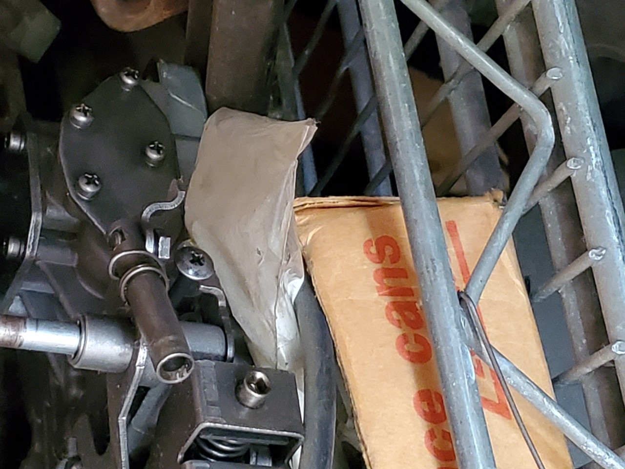

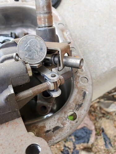

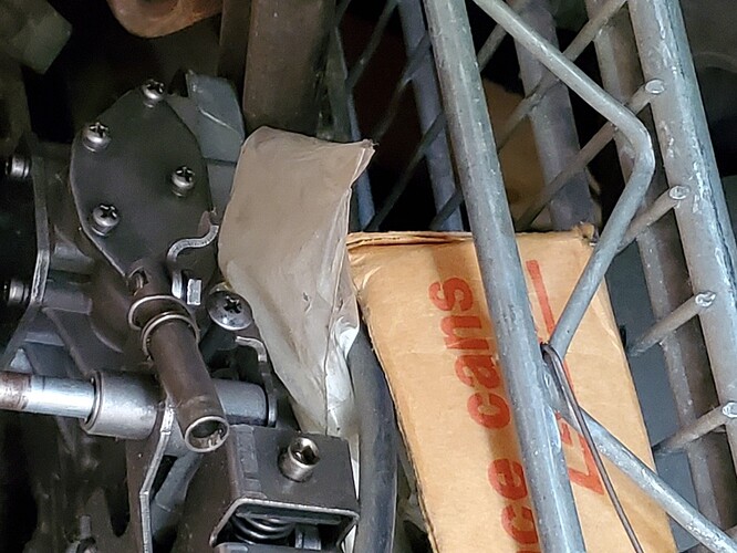

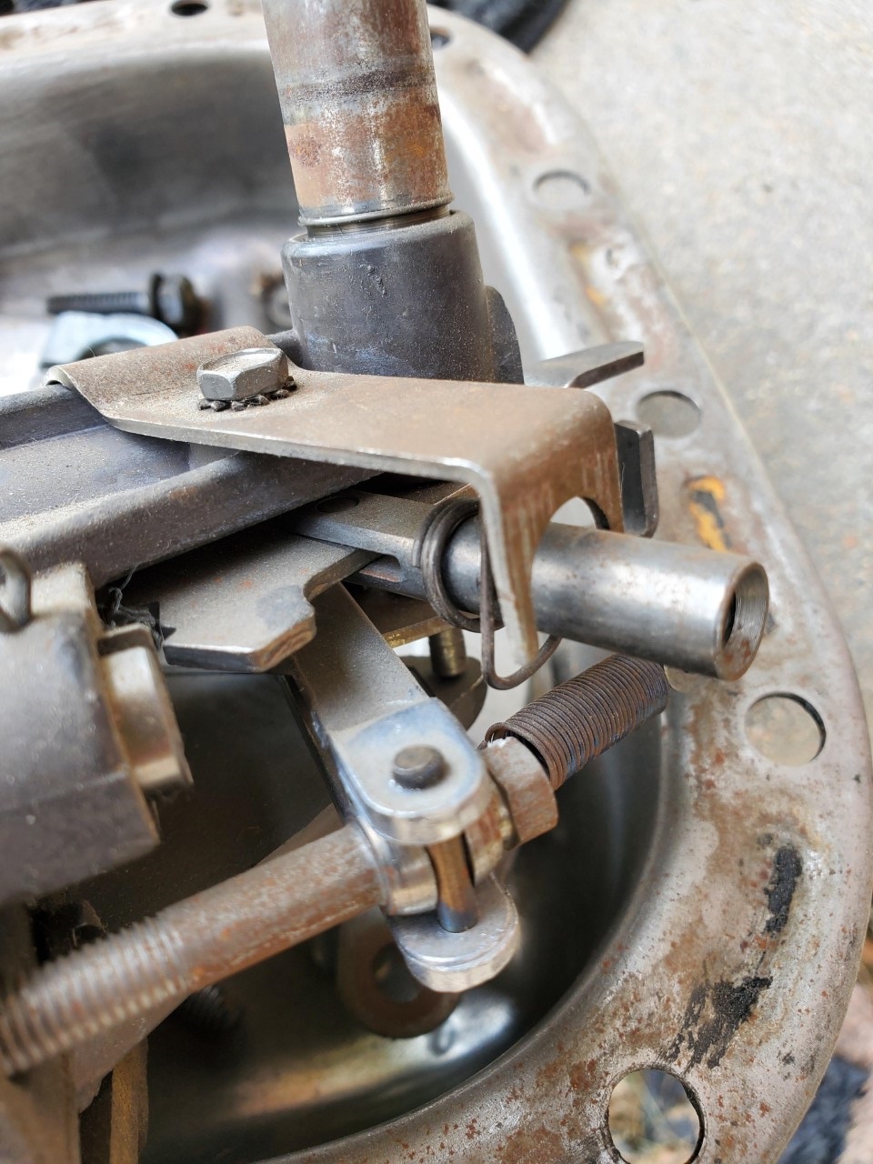

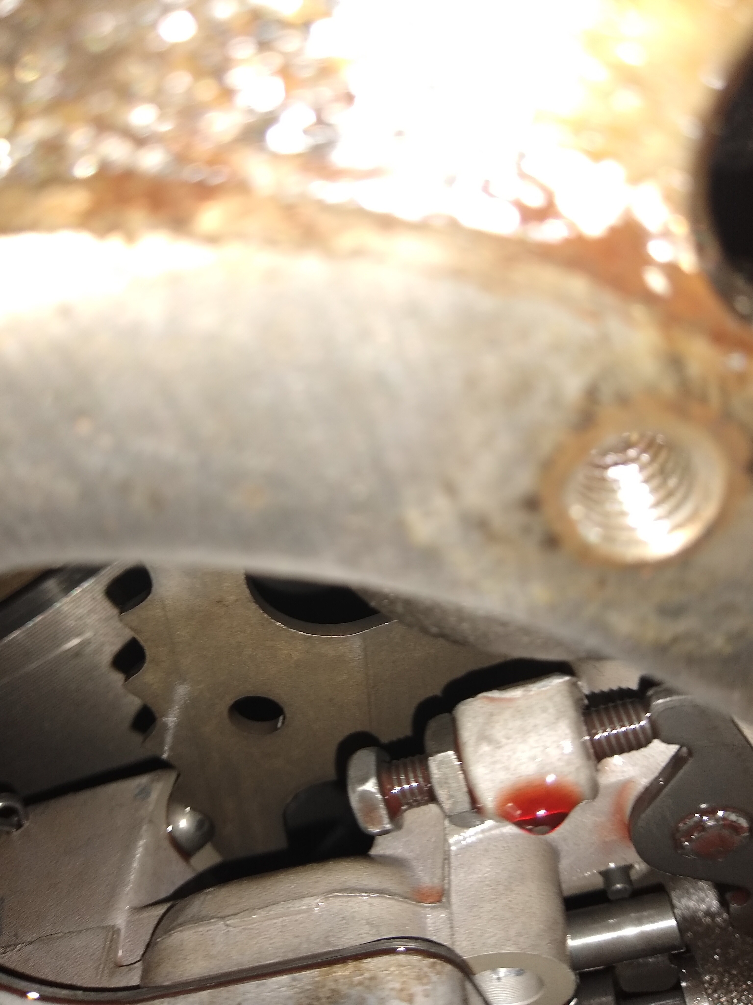

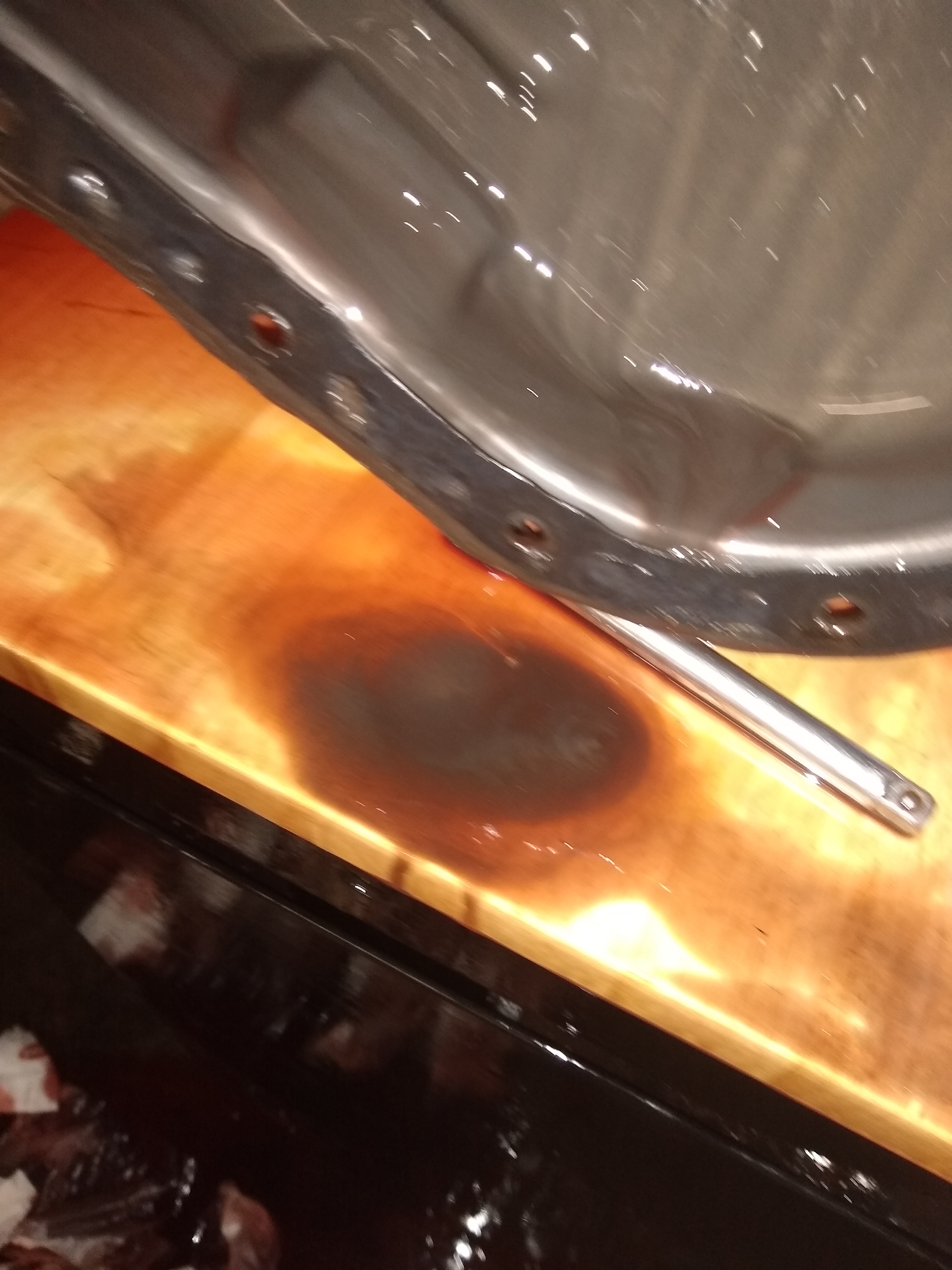

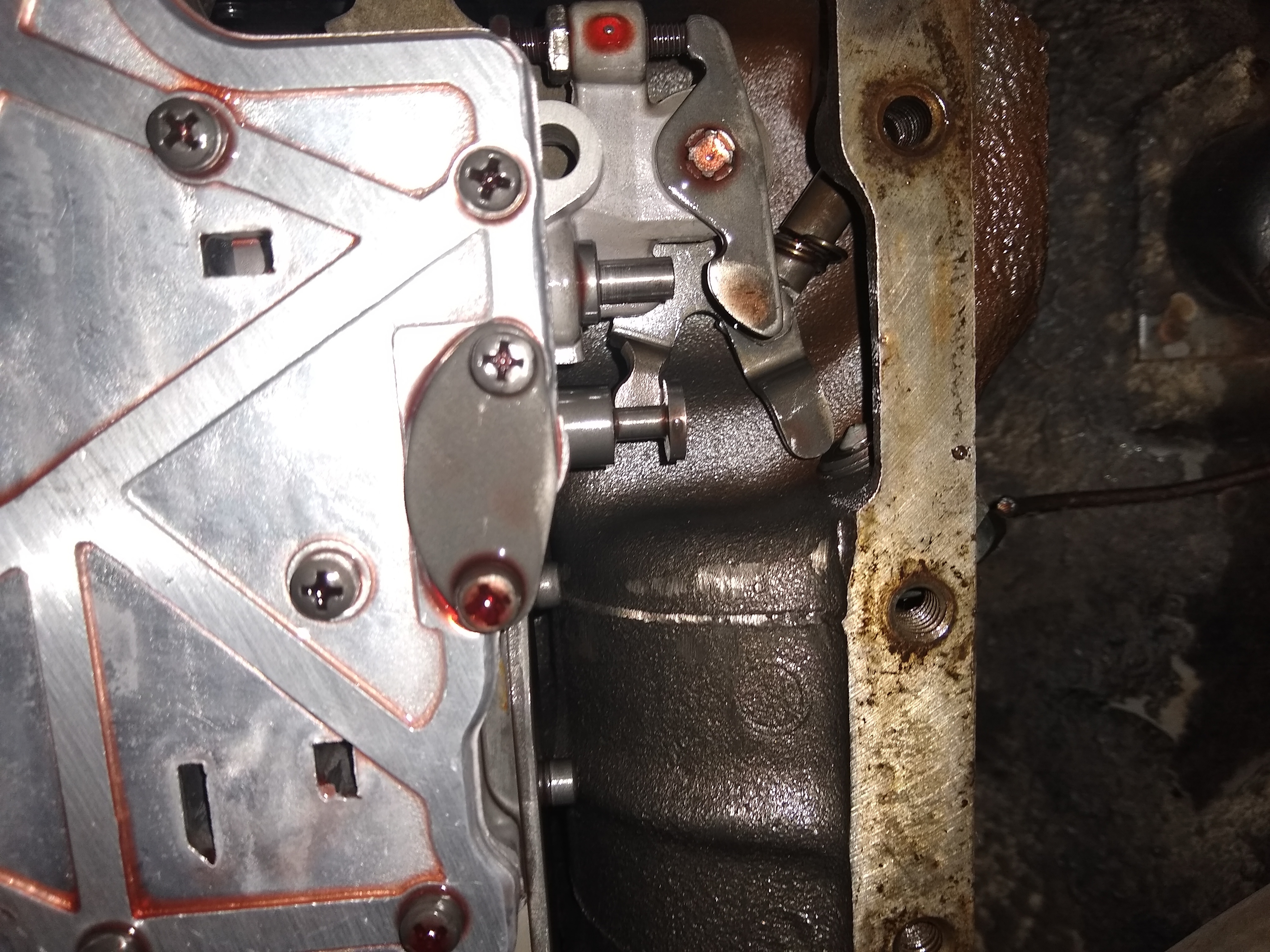

Anybody see anything amiss in these pics?
Well, it’s been 17 years since I followed these instructions - but, at the time, they worked for me. My memory has faded, but perhaps this will make sense to you with the pan off:
looks good, just confused with picture #2 I see feet and can’t scale if this is debris or what. think the description of the cable release being a ‘Hairpin’ is pretty good. Do you have a Factory service manual? I have even used the local library to research this type of thing… Amazing what you can find here. I will look and see if I have a valve body to take pictures of.
**The cable connection was used from 1956 to 1965. I used a pocket screw driver to unclip the ‘Hairpin’ on the connector to release the ‘Shift Cable’.**top two are 1956 powerflite but the connection is the same ‘Hairpin spring wire’. last picture is 1962 to 1965 showing virtually the same connection.

1 Clean the cable adjuster wheel at the transmission, remove the lock bolt and pull the cable out of the transmission housing, making the shift detent go to first gear.
2 If it wont pull out and make the rooster comb move to the first gear position, try pushing in the detent ball to release the rooster comb. If it moves reinstall the adjuster wheel and try the push buttons again.
3 If the cable slides the cable is not the problem.
4 Rooster comb won’t rotate sliding the manual valve in and out, you may have to drop the one segment valve body. early 59 valve body’s were two segment. This transmission is a 1960, or late 59 cast iron A 466 valve body.
