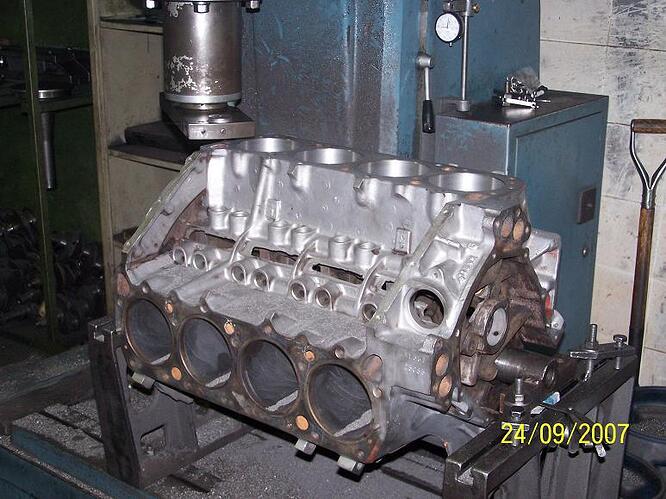

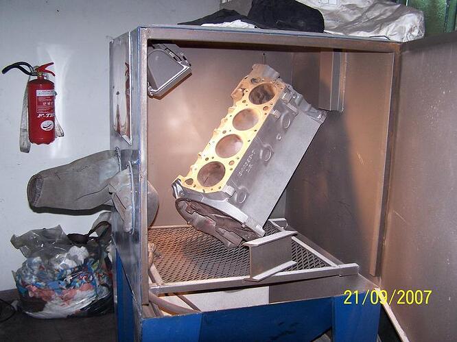

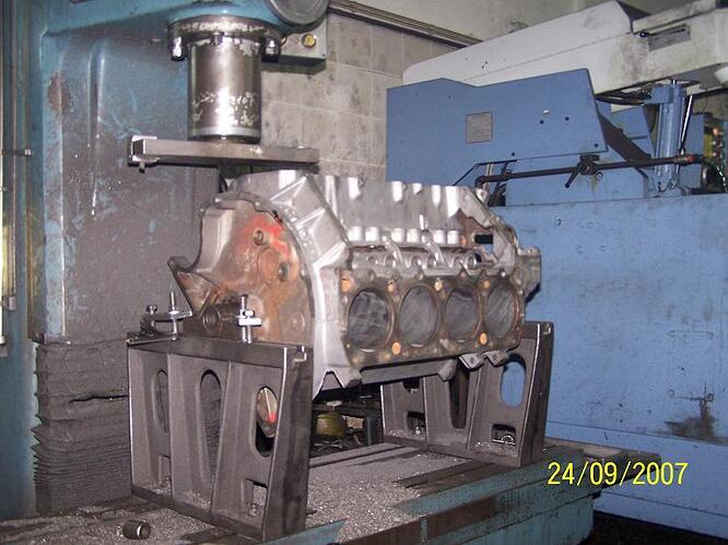

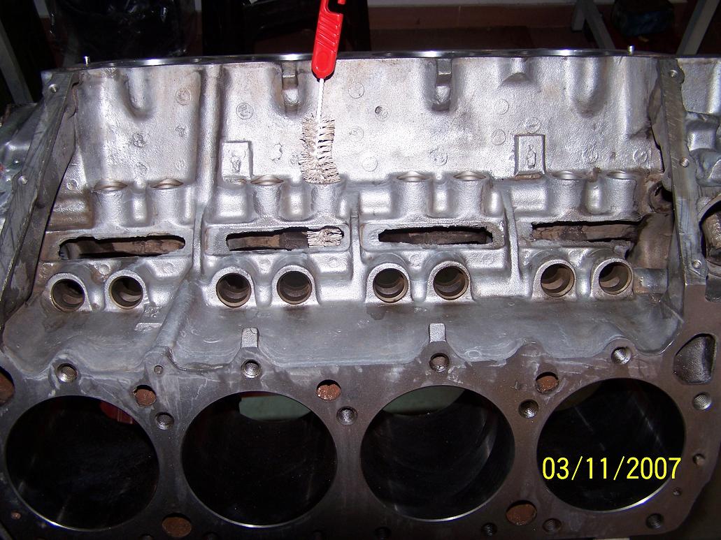

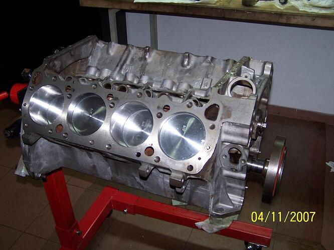

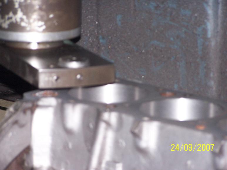

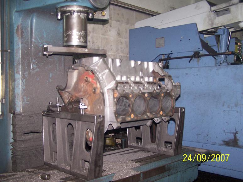

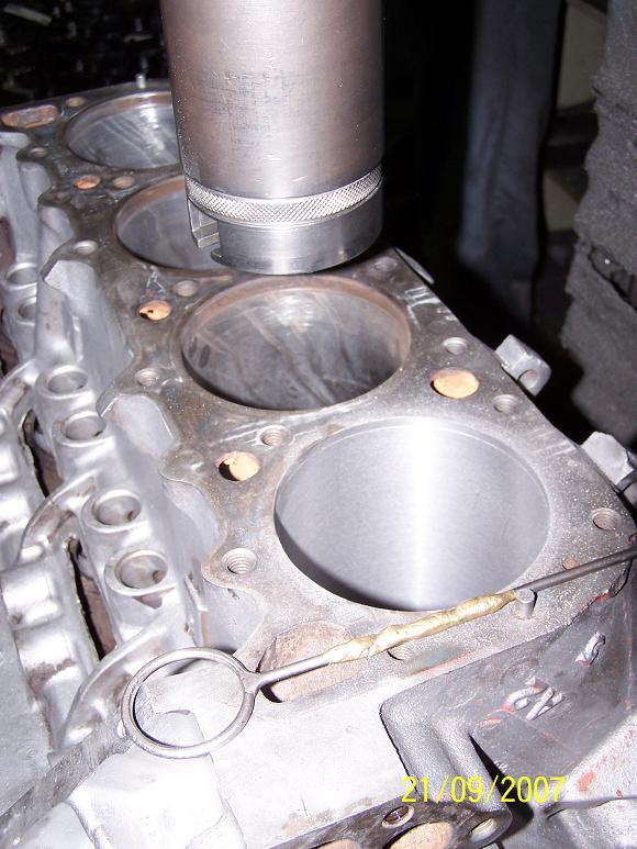

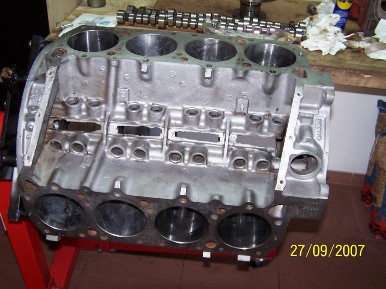

As promised, here come the first pictures of the 361 bottom end in the machine shop. The block was cleaned and rectified. It took the man four hours to remove all the sludge of the inside walls. Then the block was mounted on the bench and bored to 0.030” over. See the pictures before and after. What a difference!

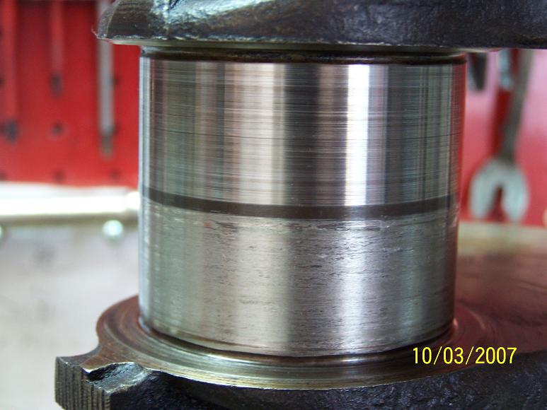

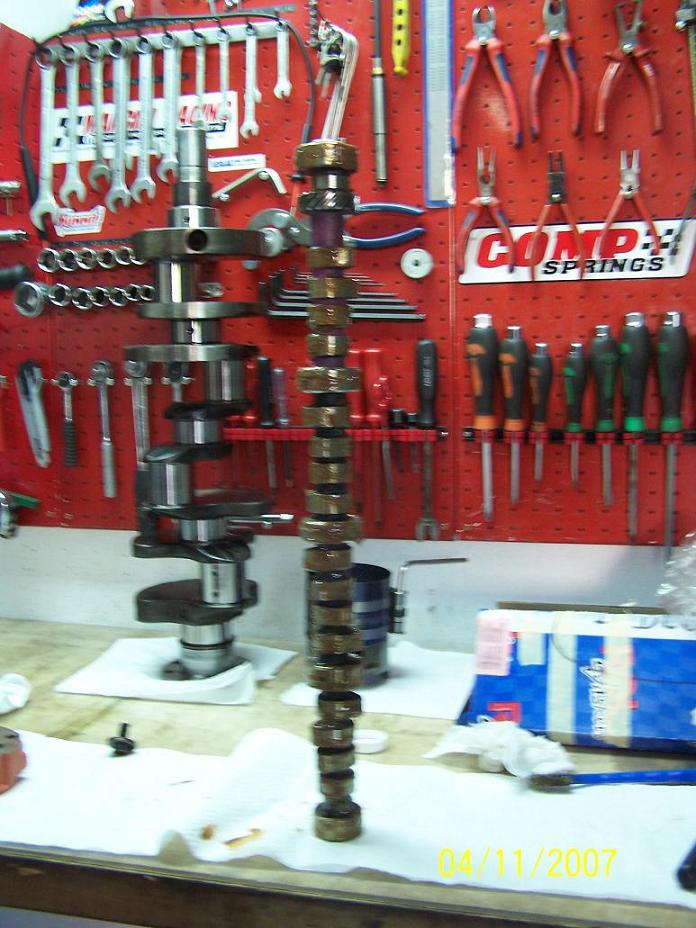

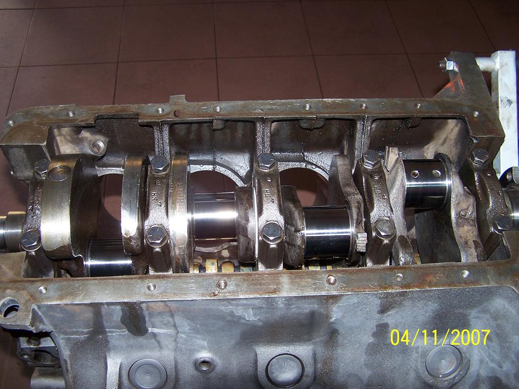

The rod journals were pretty bad. We had to remove more material from the inside than from the outside otherwise the journal would have been too thin. Now it has a little more stroke than original - something like a mini-stroker. Which one is the Mopar shaft?

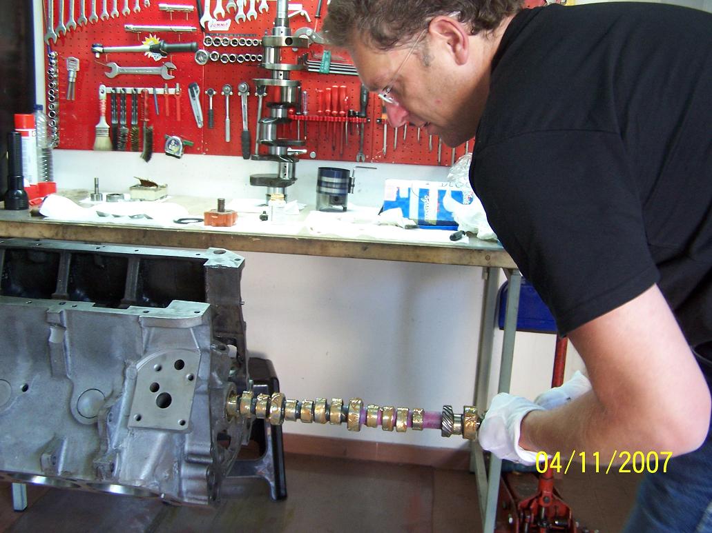

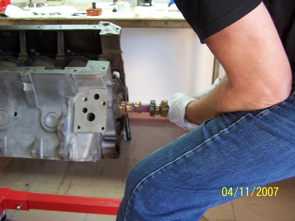

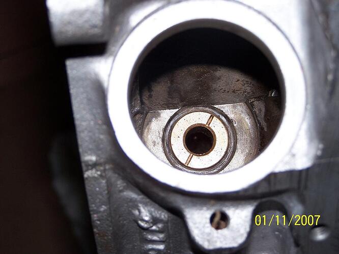

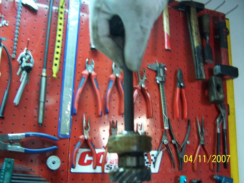

The oil pump intermediate shaft bushing had a little gab and also the shaft has some wear. I better replace them too. The sliding hammer shaft is a good tool to drive the bushing out.

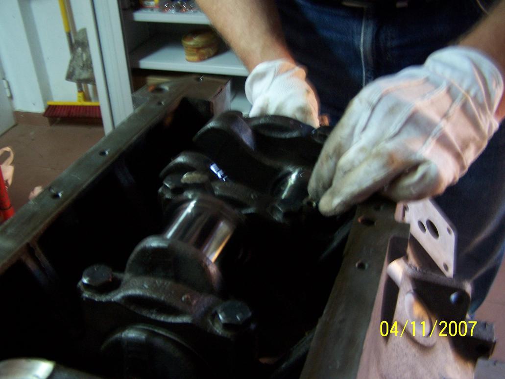

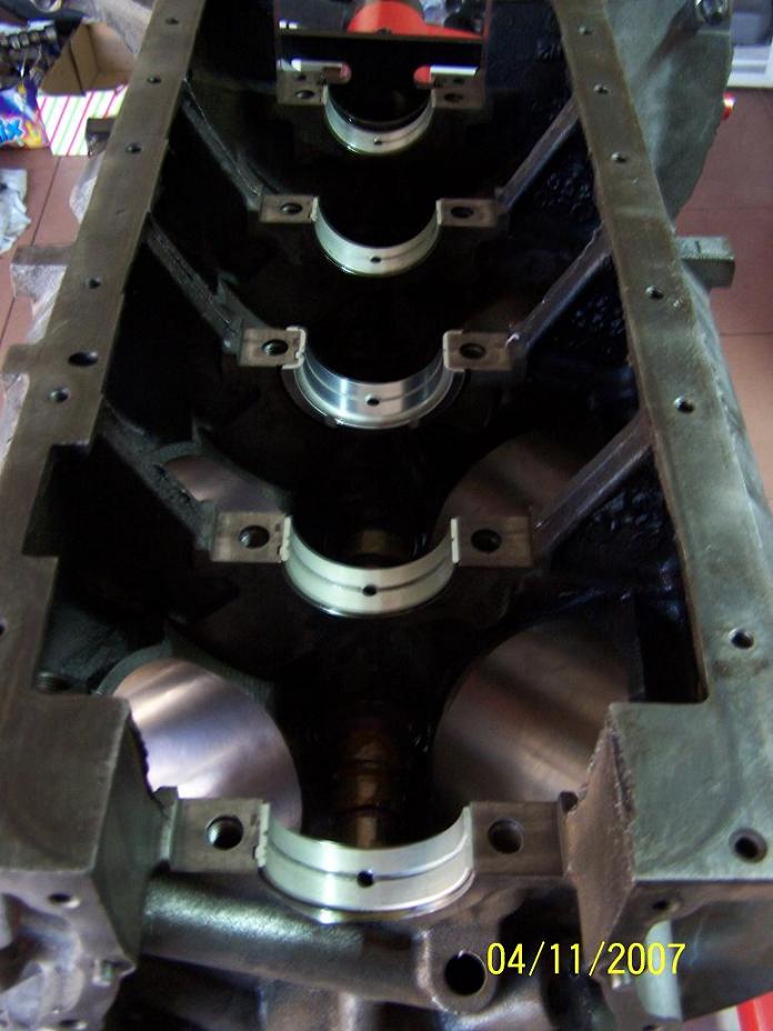

Finally the bottom end is clean and free of sludge, carbon remains or anything else that doesn’t belong into. Needless to say that this is the fun part – working without gloves and no dirty fingers so far!

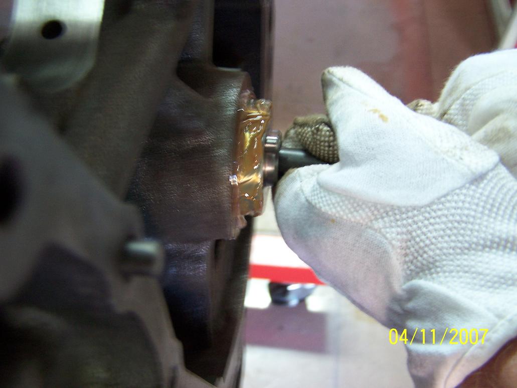

Installing the rear main seal

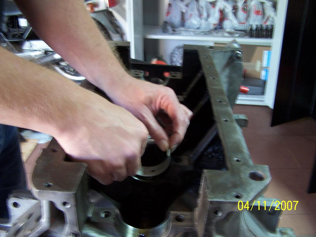

Crank shaft bearings (Only the top bearing has the groove)

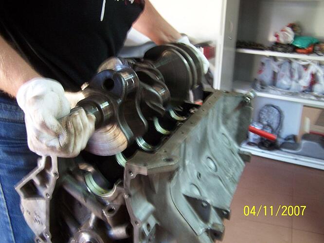

The crank shaft was one of the worst pieces of this block because the #7 connecting rod bearing was completely burned. What I’m trying to say is that when I disconnected the rod there was simply no bearing in it anymore. Also the #7 rod journal was severely carved. Simply reworking all the journal to the same stroke would have weakened the whole crank shaft and was therefore not an option. In order to save the crank shaft we had to remove more material from the centre side of the rod journal, than from the side away of the centre. This way the engine has now not only .030” oversized pistons but also a 0.020” higher stroke.
Is anyone smart enough to calculate the new displacement? -
Crank shaft – reworked and posihed – sorry for the bad quality of the images. I promisse to teach my son to take better ones.
Crank Shaft
