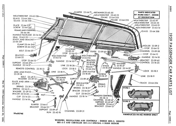

Trying to re-assemble my front window regulators and am not sure I have all the pieces in all the right places. Can anyone point me to a schematic or diagram?
59 Plymouth Fury 4dr ht

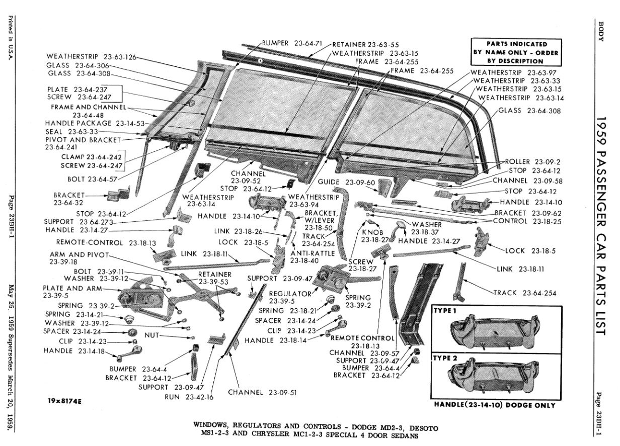

Hmmm… I don’t see a schematic in the parts manual for a Plymouth four door hardtop. There is the attached diagram, however, for a non-Plymouth four door sedan. Poke around page 47 here, though, and see if you don’t find something close. (The link is to a pdf icon - you’ll have to click on it to open the document.)
Perfect. Thanks!
