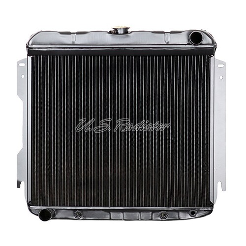

I’ve been looking around for (3), and not having much luck. U.S. Radiator is interested in adding a '59 Fury to their catalog, for $500 + shipping they’ll reproduce mine. Here’s one of their products:
