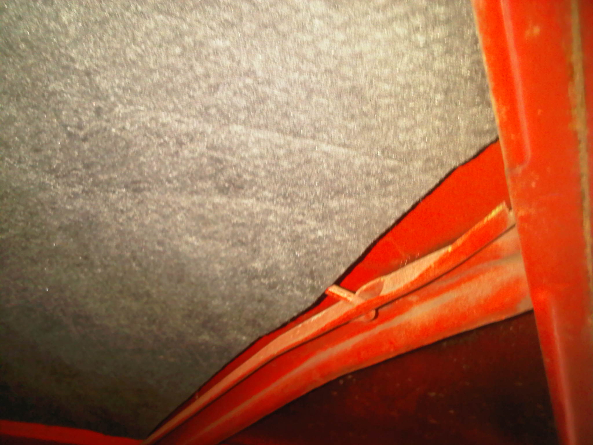

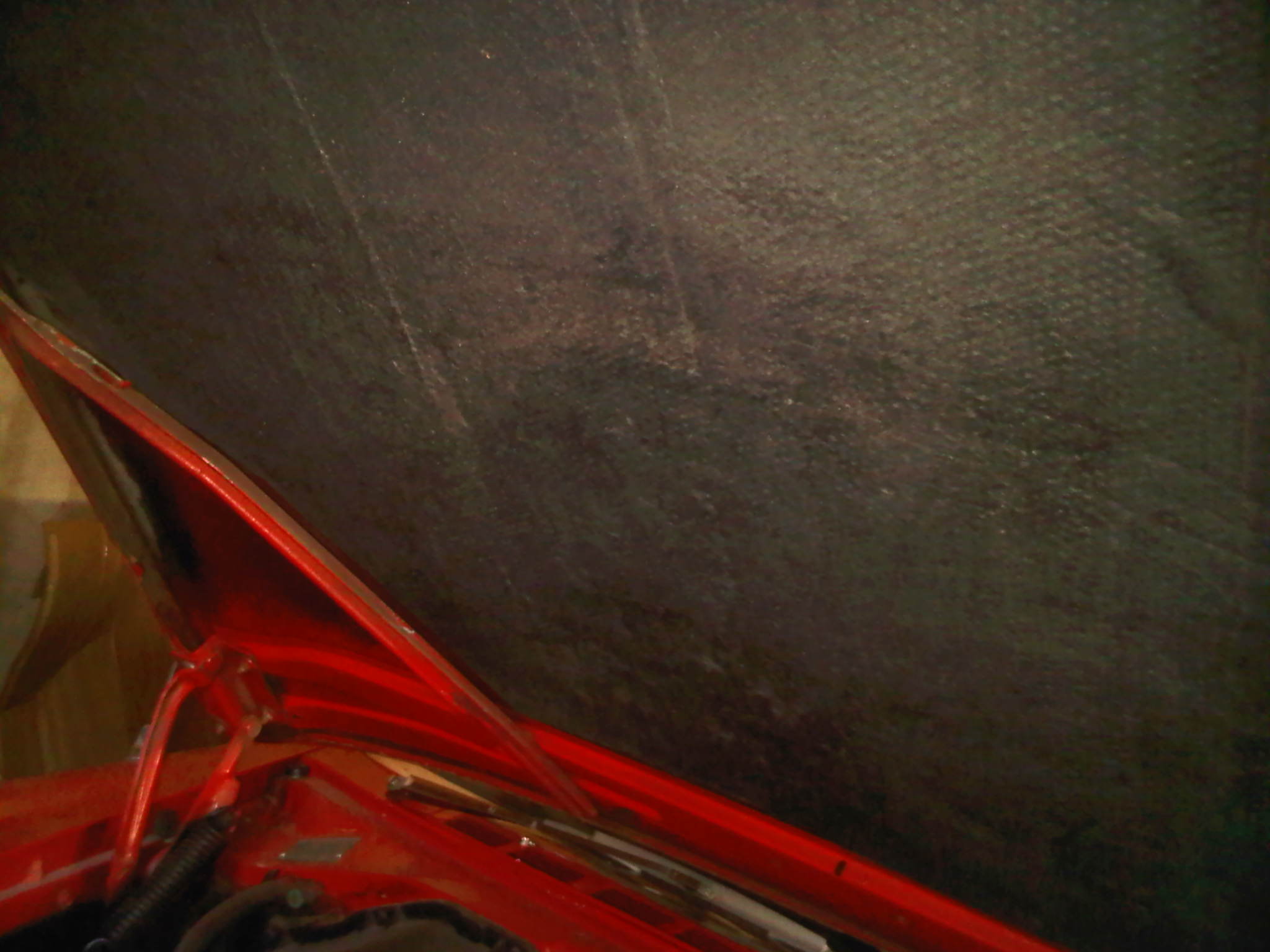

John, I was able to feel under the one corner, that indeed the one side was fuzzy (and not smooth on both sides as I had mis-remembered). I don’t know if it’s wrong or right, but we glued the fuzzy side up; but I think that it must be right. Fuzzy side down would tend to collect a lot of dirt…

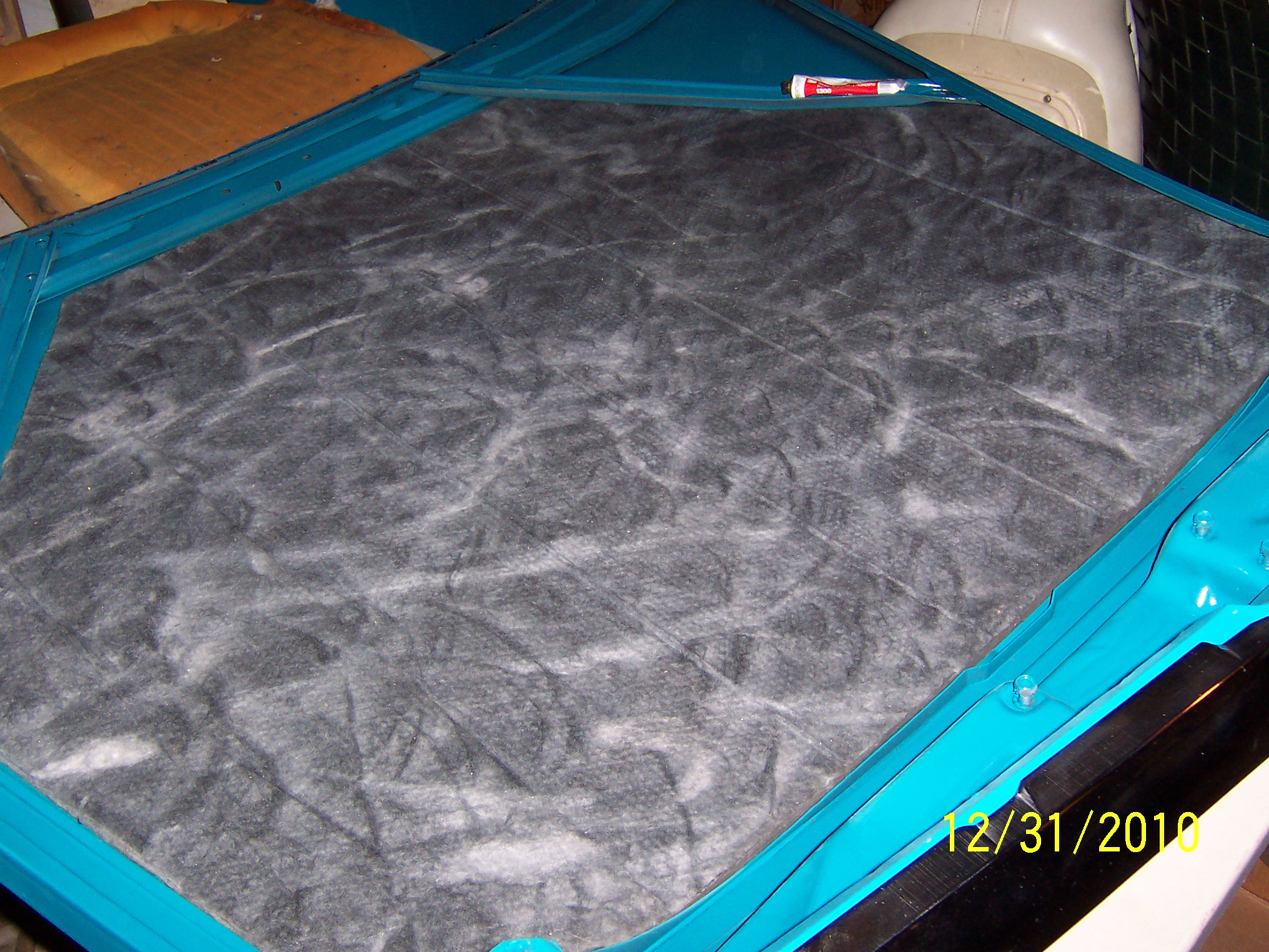

Since I have both fenders and the hood in the basement waiting for final installation. I have place the hood upside down on a cardboard table (actually a plasic one) so I won’t have to fight gravity on a hood that is installed on its hinges. I have the outline of the perimeter of the old pad residue I could not get off. So location of the pad will be a snap.

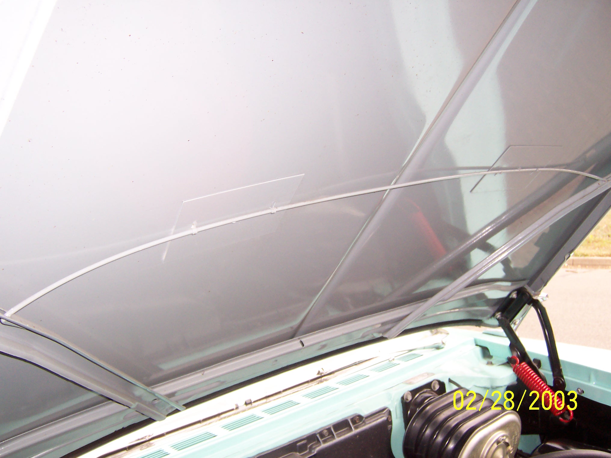

Thanks Dan for the picture of your car. Fuzzy side up to be glued is how I will roll with this.

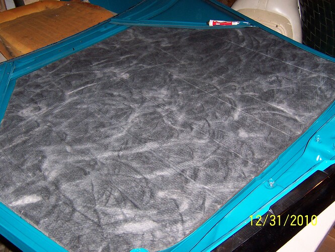

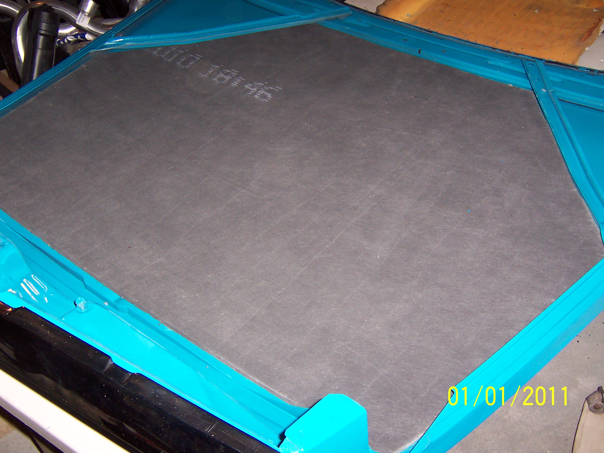

Rick, we will have to do another Instructional video on another subject. I applied the 3M adhesive to the insulator pad and installed it with the hood upside down on a table. I have boxes weighing down the pad to put pressure on it till the adhesive drys.

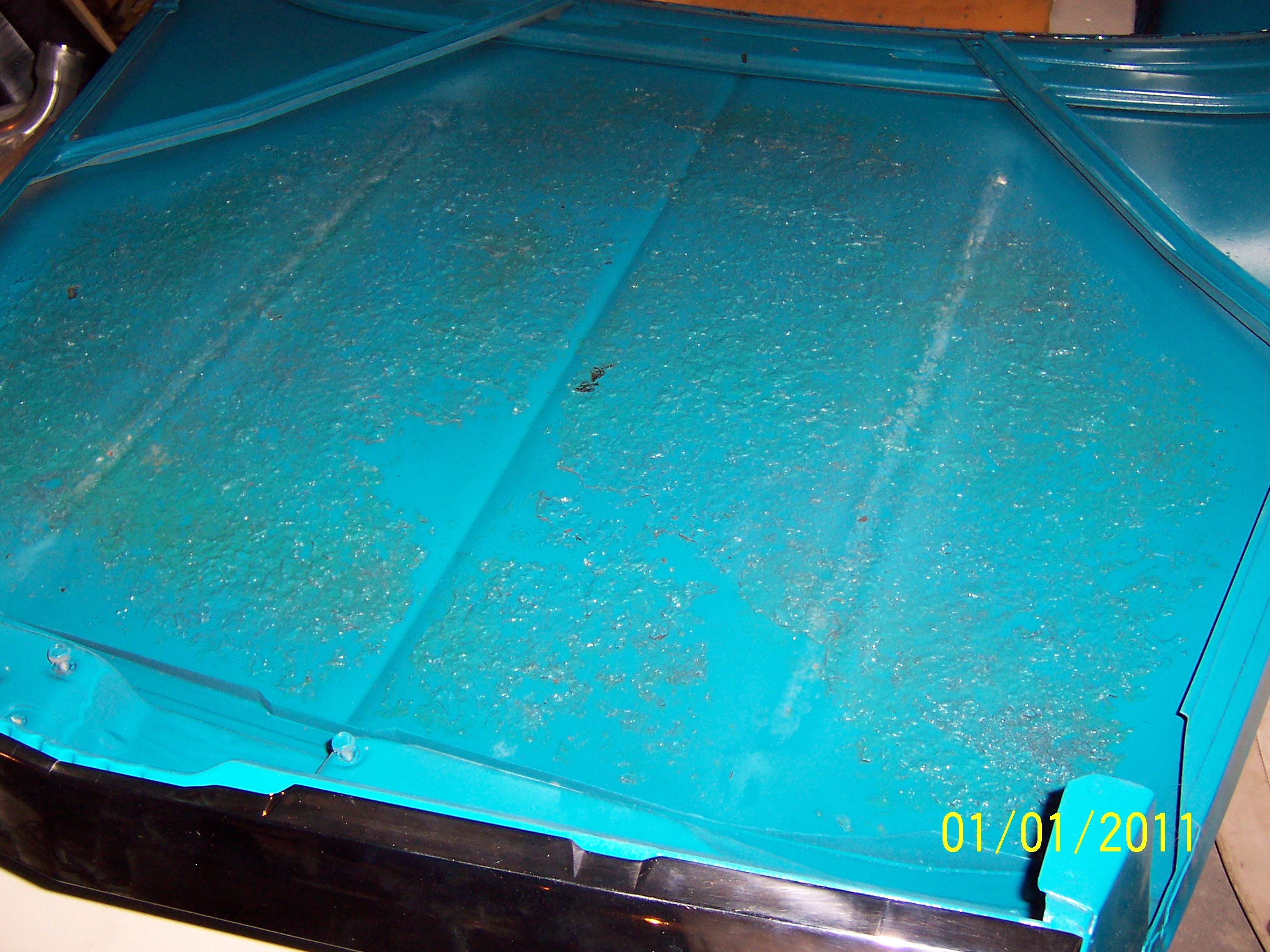

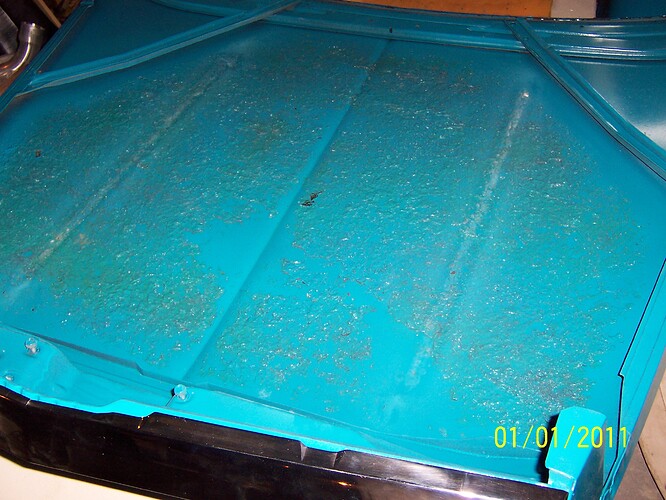

Here are some pictures of my underside of my hood with the old glued on residue that I could not get off that we painted over with the Turquoise (59 Spring color) I did not want to go the correct argent gray color underneath since this will be a driver car (and I was to lazy to mask and paint again!)
You can also see my style of underhood bracing is the vesion with out the Welded pad/spring rod style that prevents oil canning of large un-supported steel area’s. Both are correct production styles.

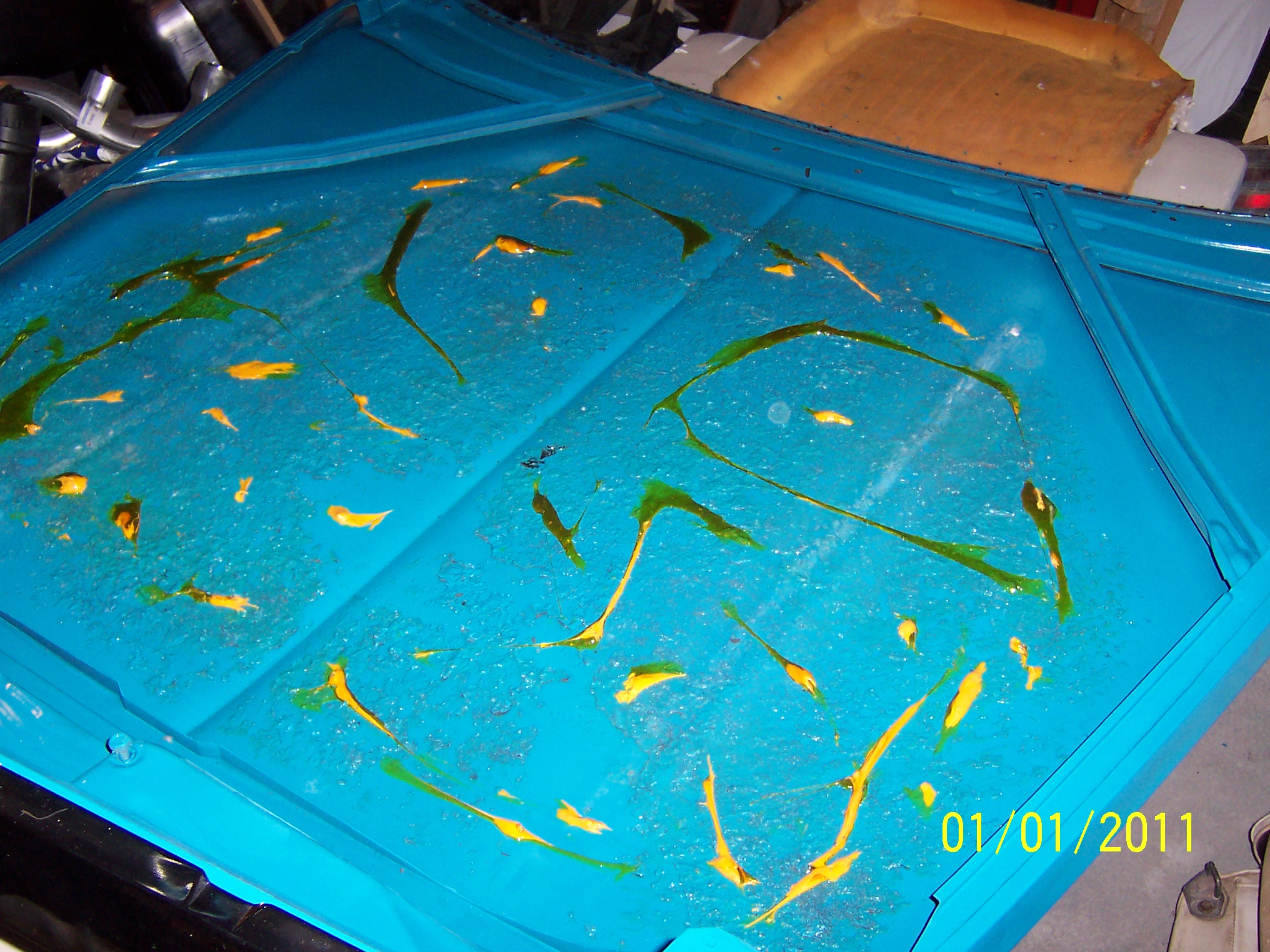

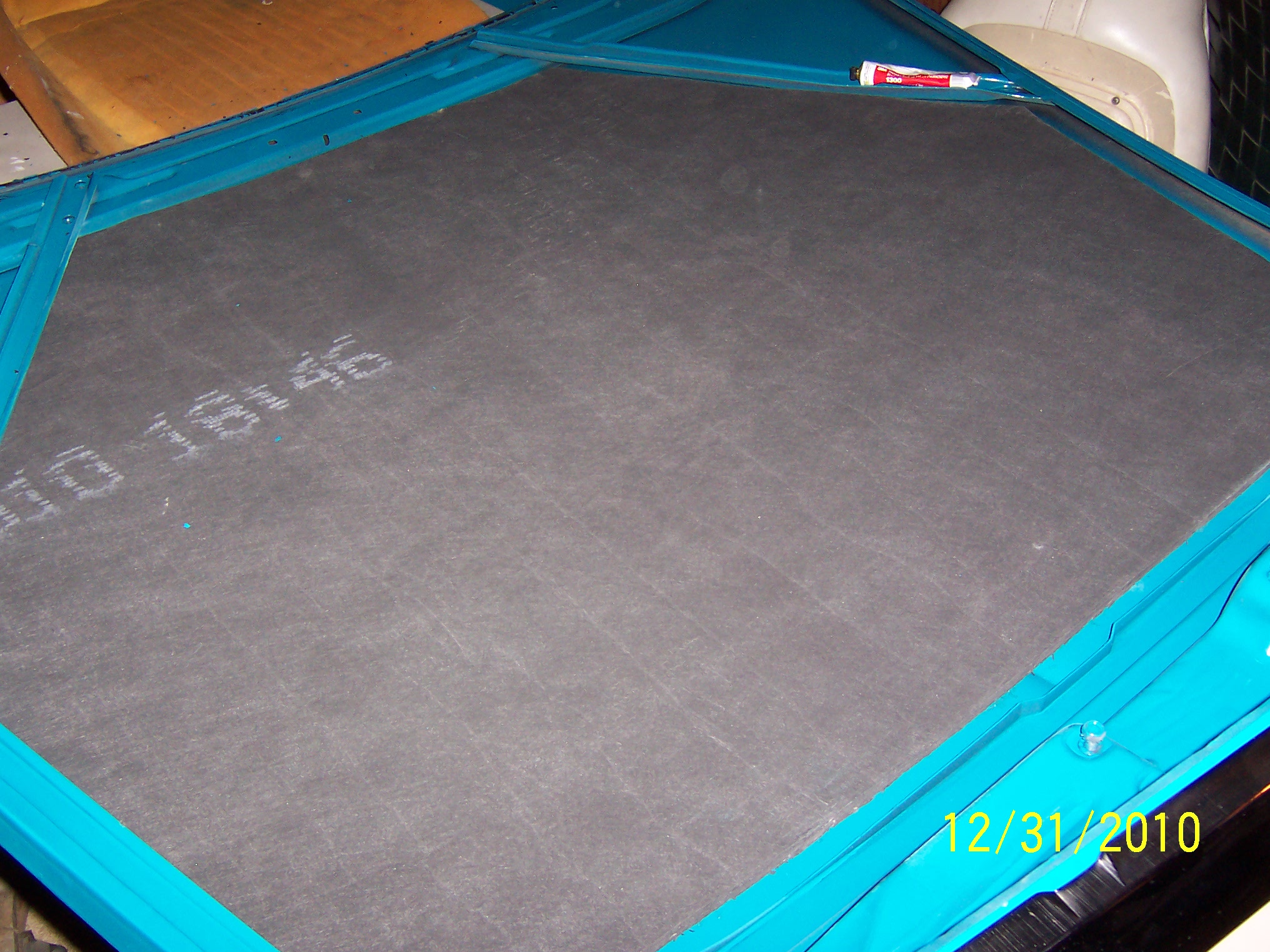

I then put down on both surfaces 3M adhesive. For some reason it looks like yellow snot and other areas just yellow adhesive. I then positioned the pad using the outline of the perimeter from the residue of the former pad and then but some boxes on it to hold it down till it cures.
I went down and checked and the pad firmly attached (as Dan said it would be quick acting adhesive)

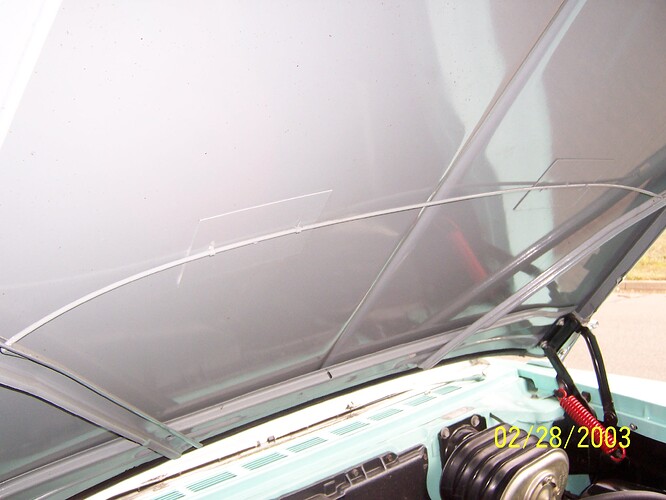

I have also put a clear picture of Tom Fox’s beautiful Belvedere convertible which shows the spring rod support with out a sound deadening pad applied, just for a comparison of my style with out the support rods.
you can see the old outline of the sound deadening pad in the paint. No spring rod support underneath.
Applying the 3m adhesive
Pad is placed using old location outline and fits where the old pad went.
Spring rod style of support on Tom Fox’s show winner!
