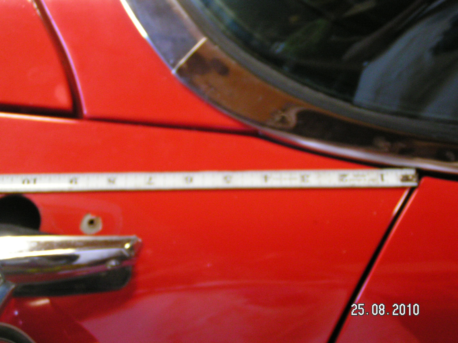

I’d be willing to take my drivers side mirror off so as to measure the exact location of all three holes. Let me know, okay?
Mine is a Belvedere, and it does have the remote mirror on the drivers side, pretty neat option for the era…
Bob
Well, that’s nice to know…would you be able to verify my measurements for drivers side mirror?
Hey Roger,
That would be great! I’m trying to stop by the bodyshop Friday and give him good measurements. If you can accomadate, that would be most appreciated. Thanks!
-Frank

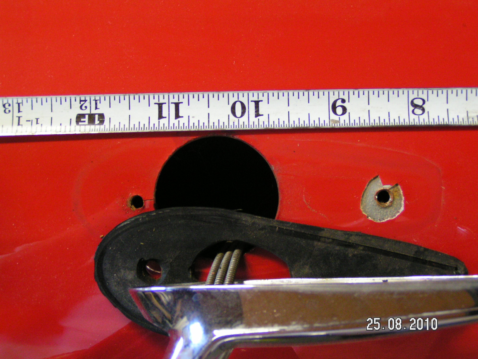

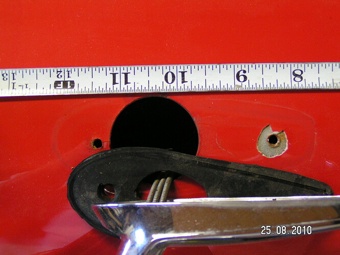

unscrewed drivers side mirror, had to take a moment to realise how much skim coat of bondo this painter used.
okay that was blurry, I will try again soon
Roger and Frank, I did measure my hole and it is 1 3/8 diameter and the center of the hole is from the inner fender edge, is 3.4375" to the center.
On the distance from the rear edge of the fender, I went down the fender and measured from a spot that was parallel from the hole center, down the rear edge of the fender, ( I just saw that Roger did his diagonally. Mine is just from a different spot. From that parallel spot to the center of the 1 3/8 dia. hole I show a dimension of 9.6875" to the center or 9’ from the parallel edge.
My main diamenter hole came from a paper template I made from my old rusty fender and transferred to the newer fender. I think Chryslers tolerances will allow for both Roger’s and mine locations to be used. They look pretty close to each other.

It’s probably too late to mention, Frank, but the large diameter hole under my mirror is barely covered by my mirror, this is why I wanted someone else to send in their measurements. I dont know if the hole is too large or the mirror should have been more precicely located over the hole---------------- :frowning:
