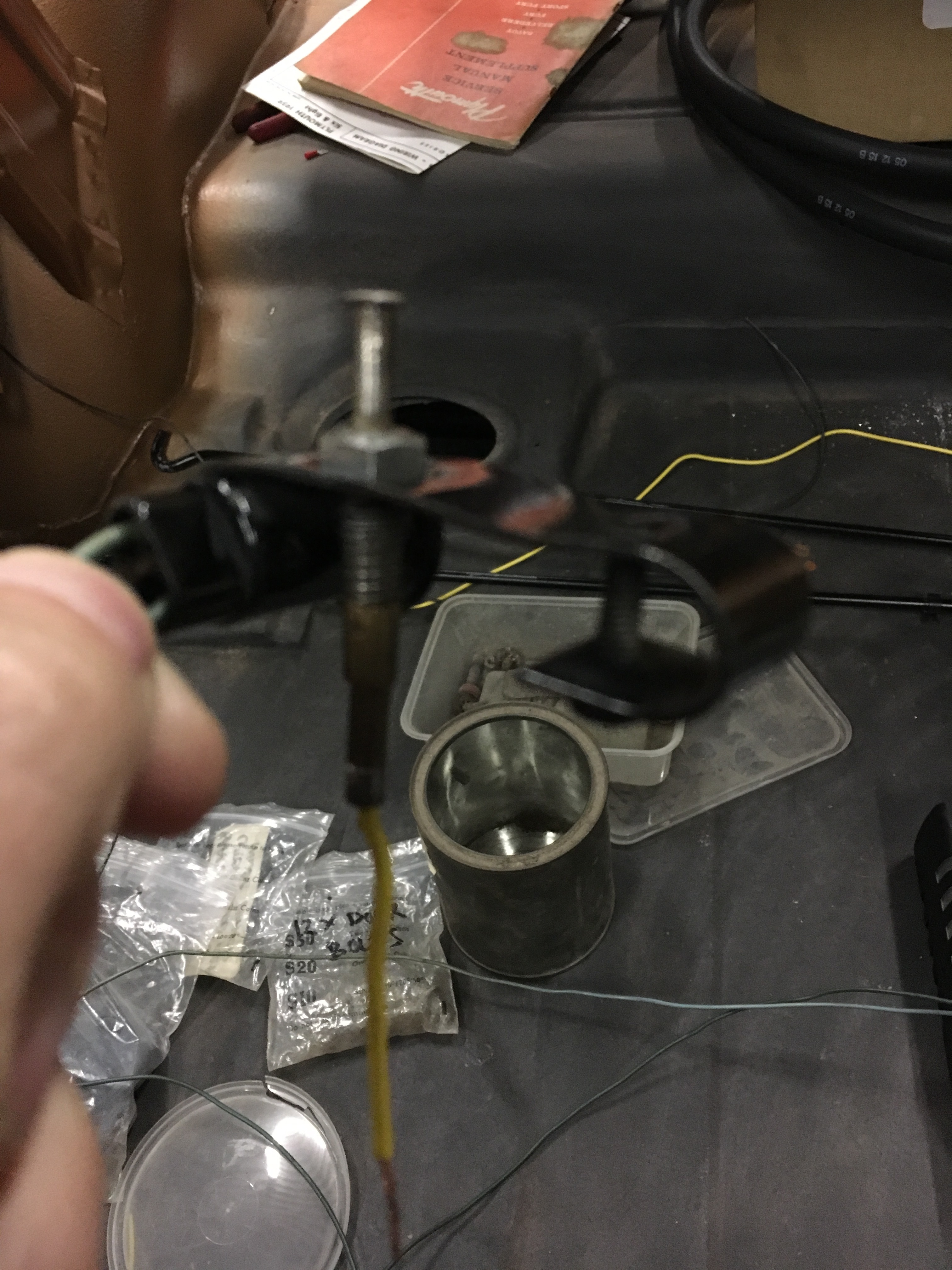

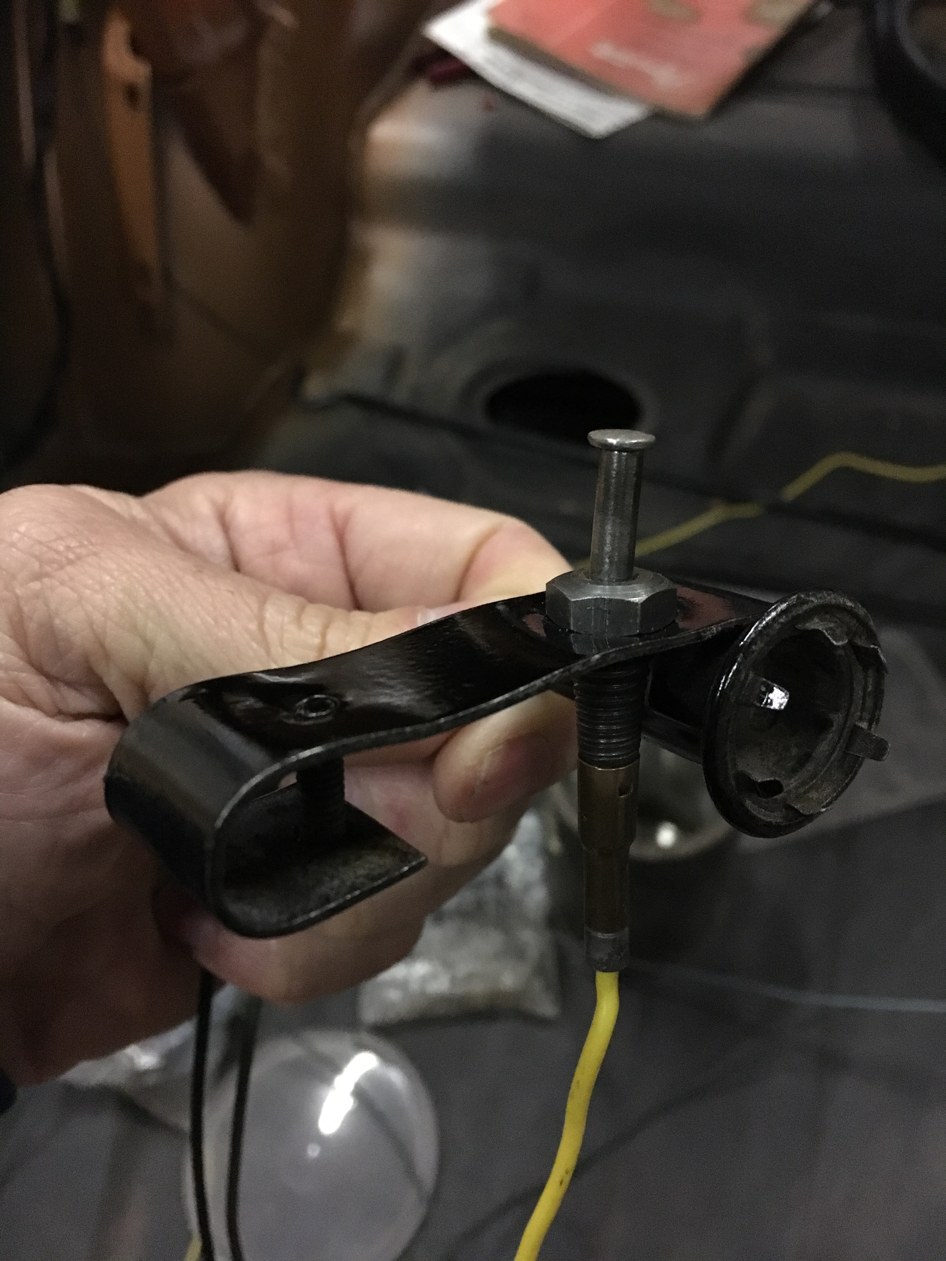

Believe it or not i got one out of an Australian assembled RHD 59 plymouth
it has a bracket on it that looks like it connects to the trunk tension rods
Its a switch type - im thinking of taking the feed off of the interior lights
will keep you posted and take some pics
Post some pics! I’ve never seen one before
Howdy
Pics of the light attached

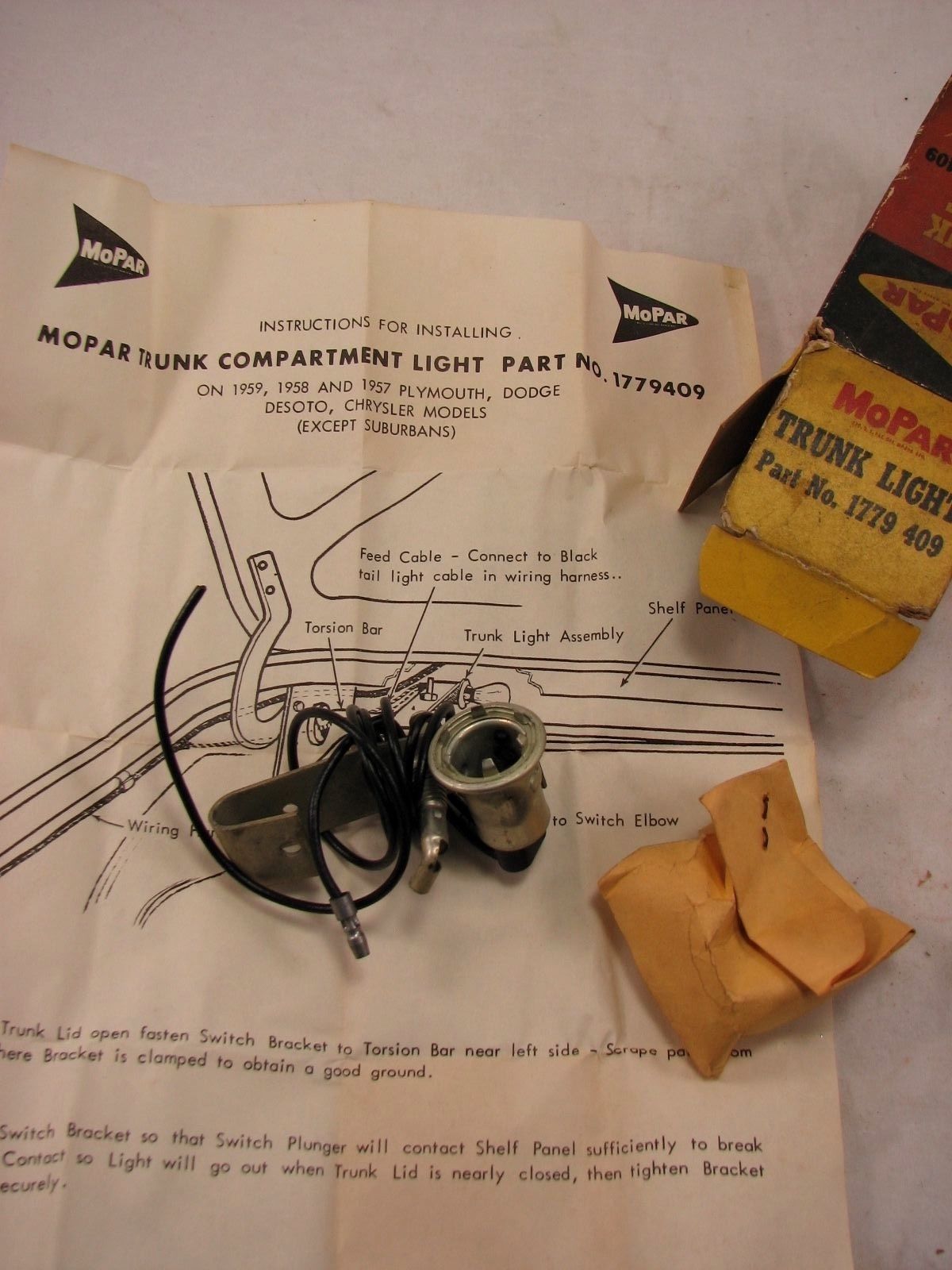

Vic, there is an instruction on a just ended Ebay auction. Already found it last week as we were going to bid on it and didn’t want more competition, did not help as we didn’t want to go higher than $80. Pardon Our Interruption...
Thanks Ron
The link was of great use - i thought that thats where it goes
Cheers
Vic
Adding a pic from Ron’s eBay link to this thread, just because it’s a cool pic!
