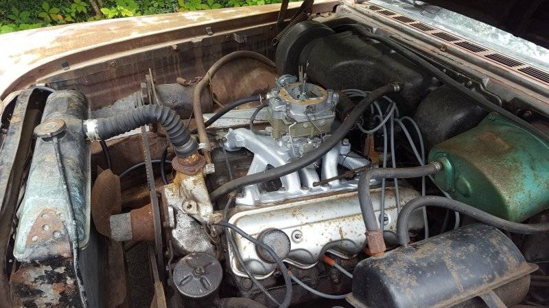

Is it possible to transplant a 383 auto out of a 65 Polara, with the column mounted cable shifted auto 727, into a 58 Coronet that currently has a 325 push-button?

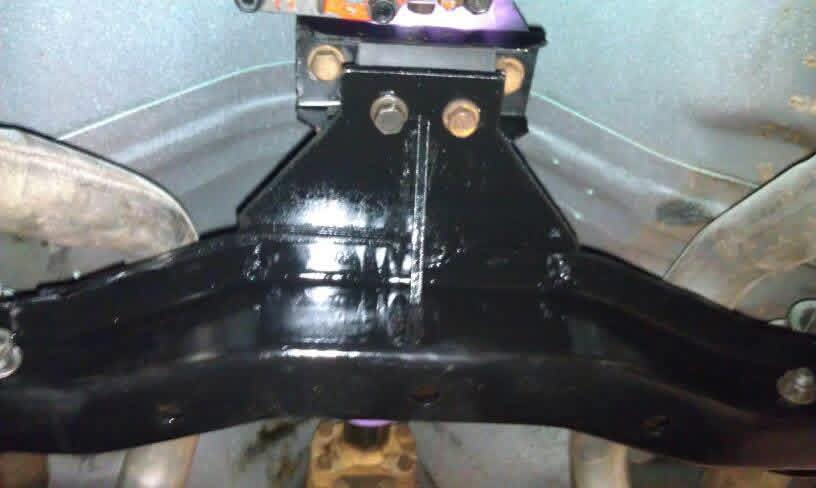

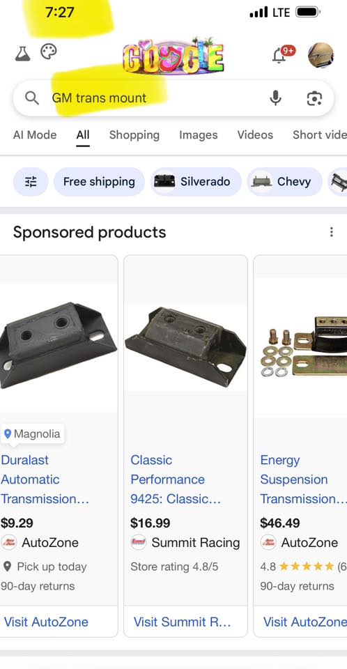

Here’s the trans mount/perch. I have a pattern for it if you use stock mounts, I’ve loaned it out probably 20 times now and also cut out a dozen for people but not in the position to get to the plasma table until later in the year. You use an abundant 68-up GM trans mount, 2 bolt. Just look up 70 Chevelle or go online and type in GM trans mount. Endless options will pop up!
What are the chances the time was 7:27 looking this up as an example!!!

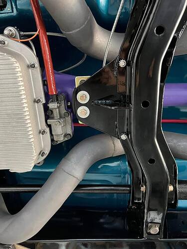

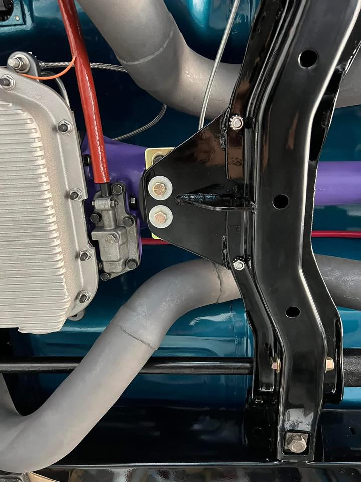

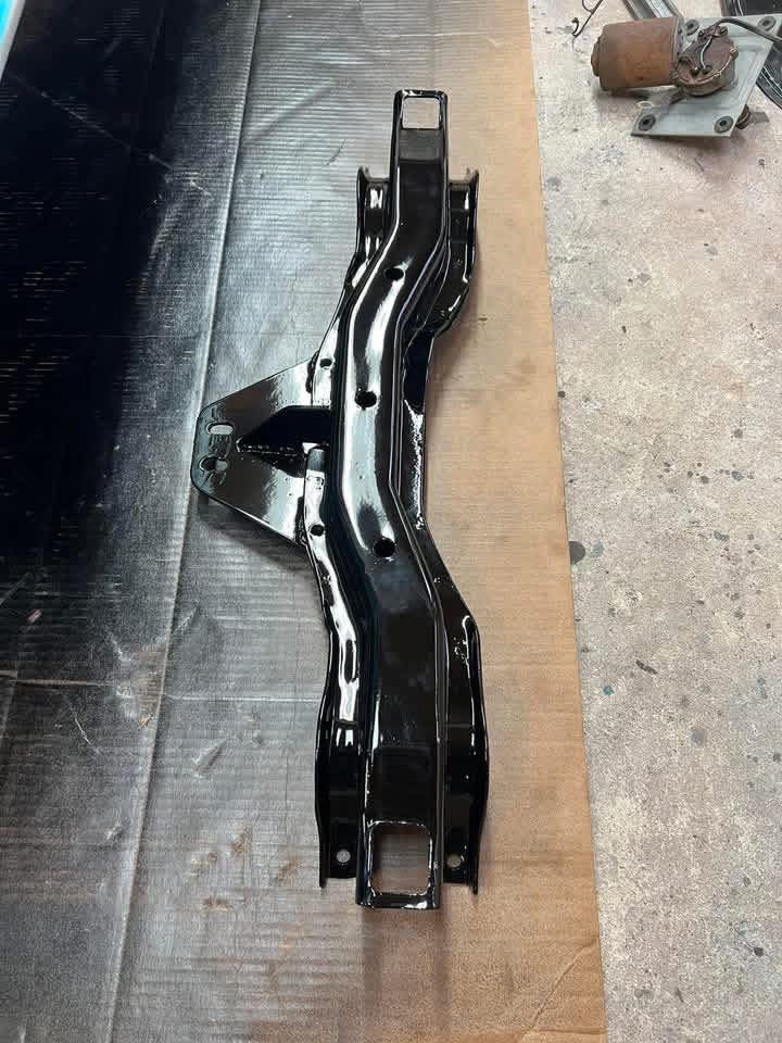

A few more pics of the x member perch…
