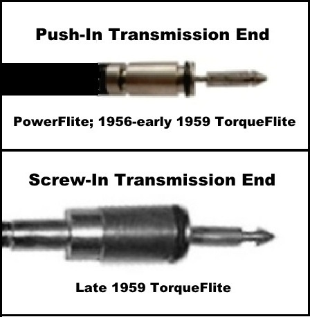

Yes an A-466, not A727…1959 had 2 models, early and late.
How would I figure out if this early or late edition?
I think the shift cable difference would be the easiest check.
