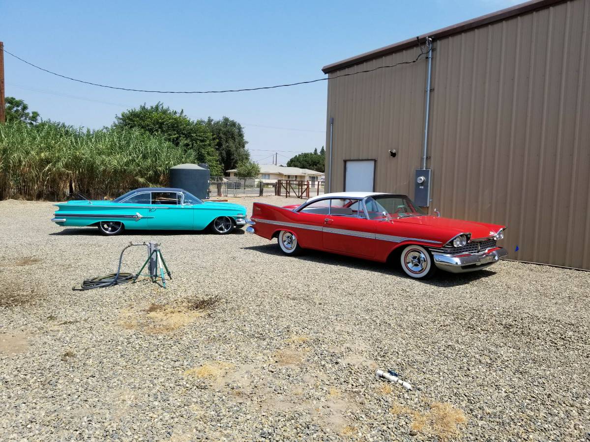

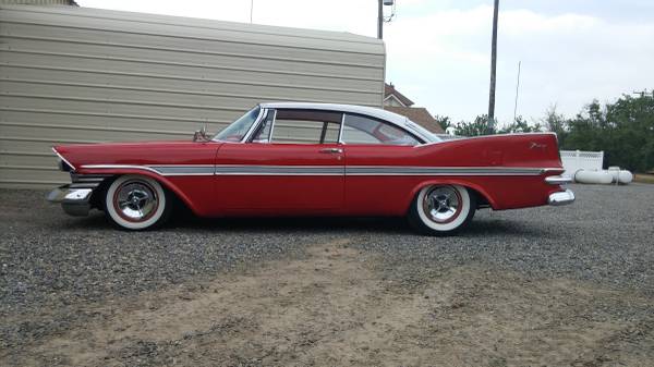

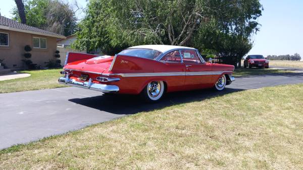

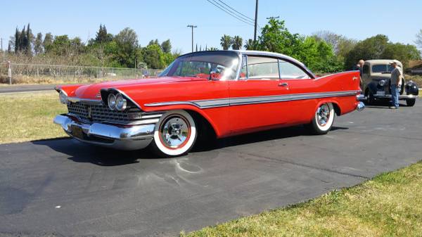

for a little drop you would probably be ok just using the torsion bars to adjust height, as long as its not drastic (1 inch maybe 1.5) before it really affects the spring rate. This red 59 was listed for sale few months back (with a blown trans if i remember correct) any way it looks low in the front to me or maybe the rear is high, not sure but just looks like it has a forward lean stance to give you an idea. Just keep in mind that front valance is already only a few inches off the concrete at stock height, part of the reason its imposible to find one that is not mangled all to hell :confused: of course then there is always the other way to go hahah strait axle and sky high hahah :laughing: .
I can’t say I’m crazy about the chrome hub caps, Will. But, how the wheel paint matches the body, well…
…that’s a real eye-catcher! :wink:
The caps look like repro 57 Dodge 4 bar lancer caps (one of my favorite hub cap designs) so I kinda dig them.
Dan…those wheels!!! Blasphemy!!! Are your trying to start a fight! I will have you know Sir that this is a good clean forum, we will have none of this dirty “painted wheel” talk here! :laughing: :laughing: :laughing:
