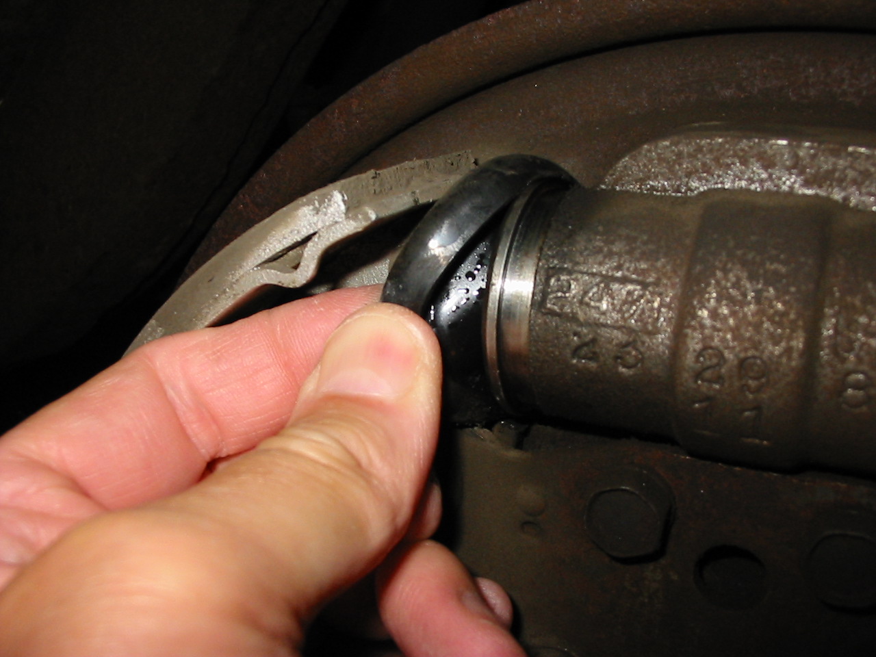

I popped the driver’s side rear again, because that’s where it seemed to me the noise was coming from. Again, more dust, not damp, but not dry either – and somewhat gummy on the lower part of the rear shoe. But, no sign of a leak. I popped the cover back, looks dry… but wait! Little droplets of fluid on the neoprene cover! A sure sign of a minor leak…
Gotta hand it to Roger, he’s the best 3,000 mile diagnostician I know of. I’m not gonna fool around with rebuilding, I’ll just order a new one. Thanks, Rog!
Hmmph, what do I know..anyhow, typically the individual cylinders are the sneaky culprits of brake problems…look at them first before anything else. they need to move freeely in and out., with no leakis
