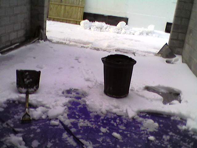

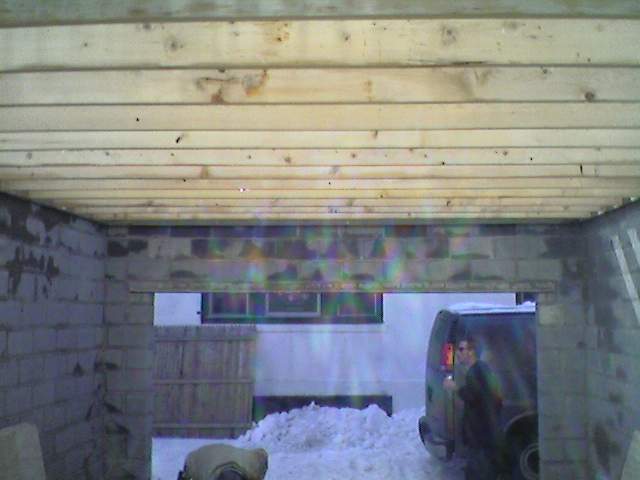

Disaster struck – in a classic battle between Winter and Spring, icy sleet turned to snow and dumped six inches of ice and hard-packed snow in my garage. And I had a lumber delivery lined up, and a carpenter coming…

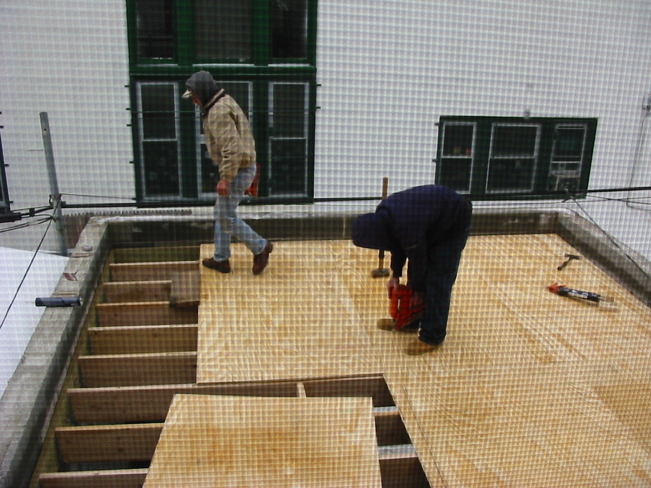

Fortunately, I had the good sense to lay down tarps. I was out there 6am this morning, shoveling – by the time the carpenter arrived to help unload the truck, the snow was in garbage-can-size snow men, lining the alley! And now the carpenter is going to town… Says he may even lay some plywood today!
The roof should be completed early this week – h*ll, it’s almost done now! Then for the vinyl deck, then the mason comes back to put on the cap, then the garage door and alley door goes in, then the steps to the deck and the deck fence goes in, then…

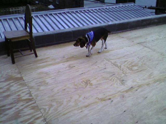

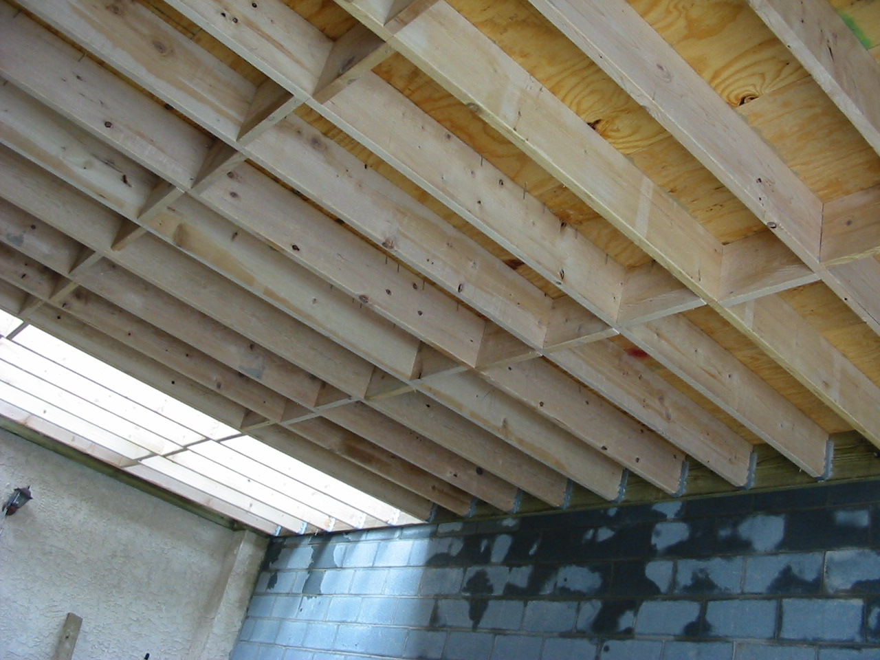

The plywood is all down… If the weather can stay dry long enough, the roofer will come out next week and glue the vinyl decking material down. But the block has to be good and dry – the contact cement they use when they wrap the vinyl up the wall, won’t stick to wet block (although the latex cement for the plywood is fine). Here’s some pix, with Bailey enjoying his new habitat… You can see I have to move some cable television wires, too.
Meanwhile, the garage door is a bit of a mess. The floor isn’t level, so a strip of cedar needs to be fixed to the bottom panel. And the side boards need to be replaced with non-pressure treated (it will corrode the metal rails, I’m told); and they need to go all the way up, and tie into the rafters. Furthermore, because they used extra-heavy angle iron for the header (it’s a 12 foot garage door, doncha know!), the block sticks out further than it should on the inside, and needs to be ground down…

Oops – Sorry, guys, for not being clear. The garage door is 12’ WIDE (to allow the cruiser to turn into the garage half-sideways from the alley. It would never make it through an 8’ door. And the door is 7’ high.

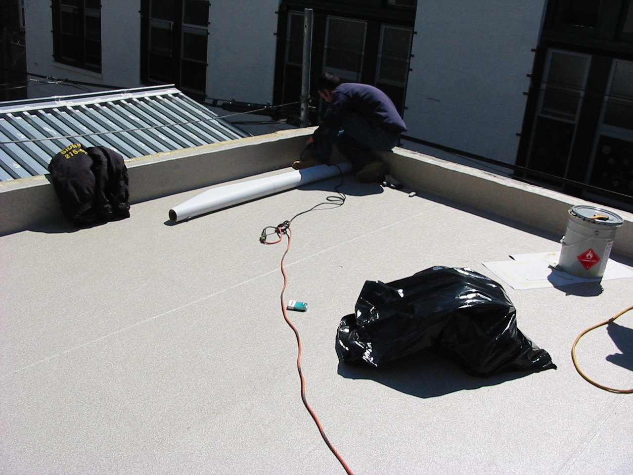

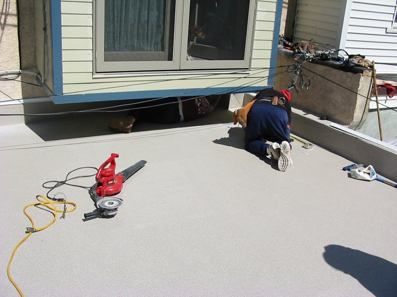

Here’s a couple more pix – we’re waterproof now (or, as we say in Fildelfya, “wooderproof”…) :sunglasses:
Looking good Dan - I’m jealous, one question, I don’t see any drains on that roof. splain me!
I’m counting heavily on evaporation, Dick.
:smiley:
There’s a scupper through the wall just to the left of the bay window. (There’s a couple “crickets” in the sloping roof to direct water to it.) I still have to tie it into the drain, but at least the water won’t stay.
I realize you can see the hole for the scupper in this post, the second pic…
