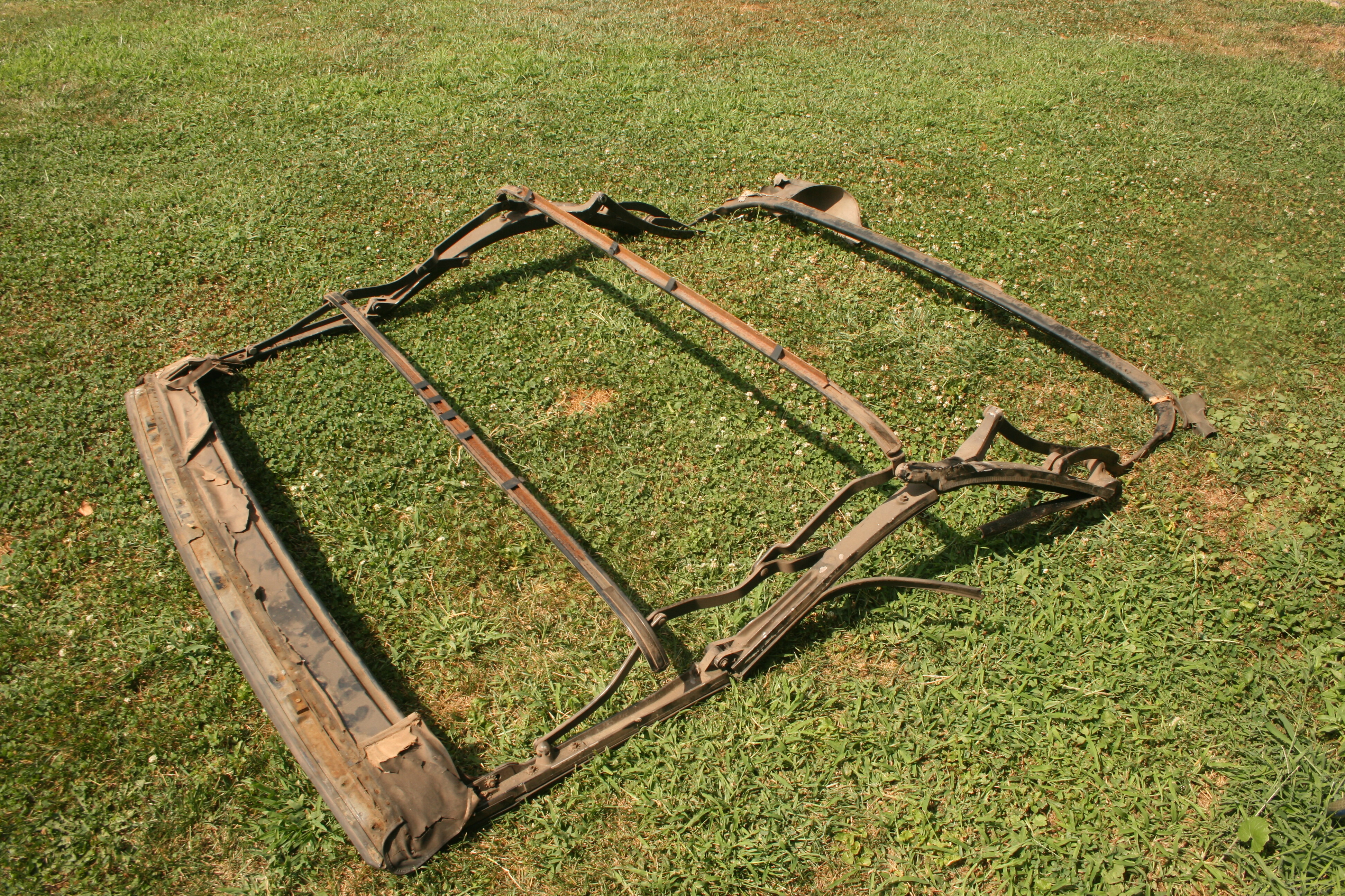

Outstanding that ACE Hardware still has our convert tops frames available…Not! :unamused:
Good score Matthew!
Wow! I just think of poor Vic Barone down under, paying his bodyman a king’s ransom to have his header bar re-constructed.
You have an exceptionally rare piece of hardware there, Matthew! Guard it with your life! Put Bode on patrol!
All the parts that won’t fit my suitcase are going into a container that is shipped to the Netherlands.
I am keeping everything as spare parts.
These parts are hard to find here but impossible to find I Europe!
I have myself on guard here :smiling_imp:
Excellent find, Matthew!!
It took me a year and a half to find a good header bow, and it cost more than the car did!

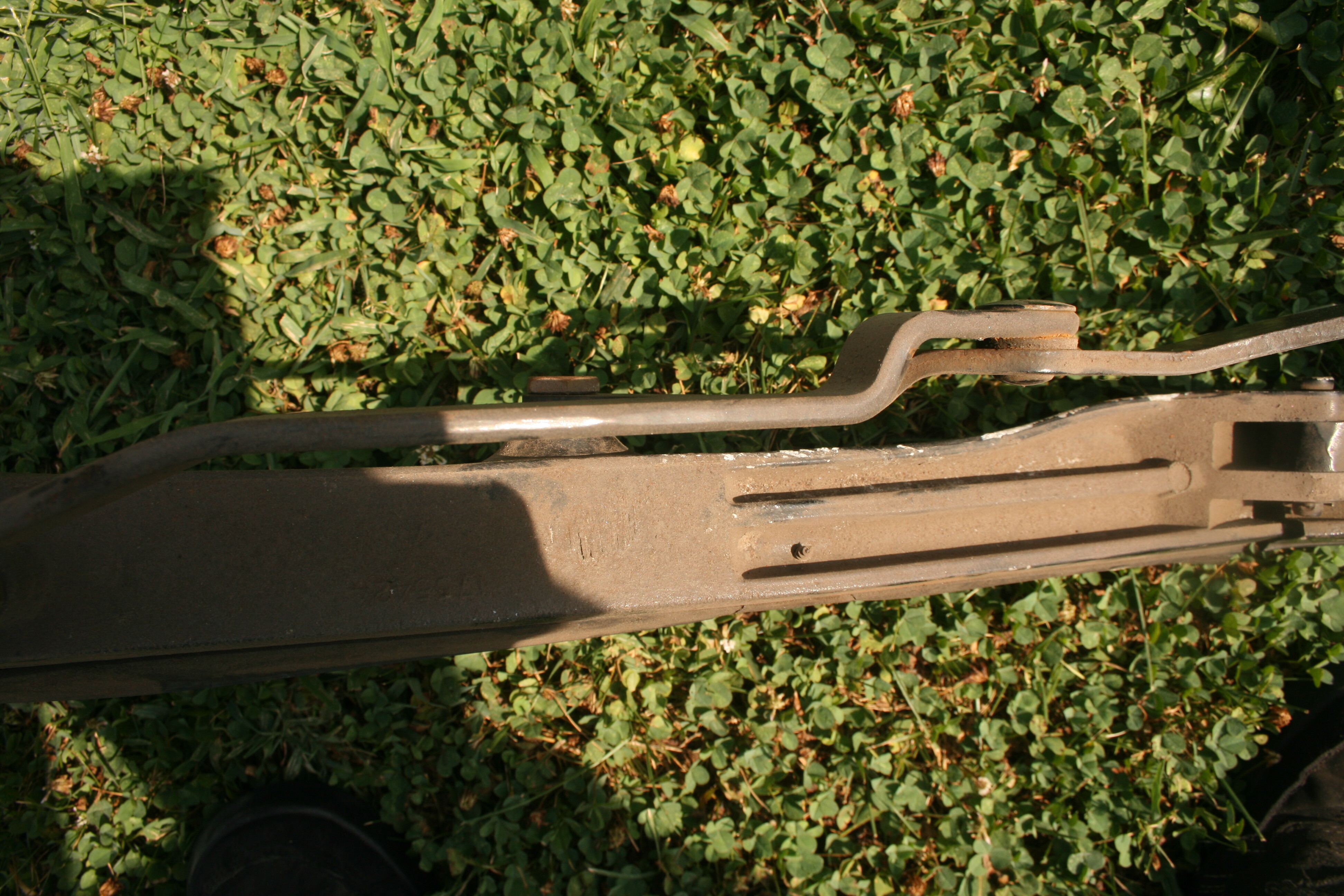

The rest of the steel pieces I will have to probably make, as they are so rusty. Luckily I met some Swedish fellows that crafted the other bows, so I have them on hand now.

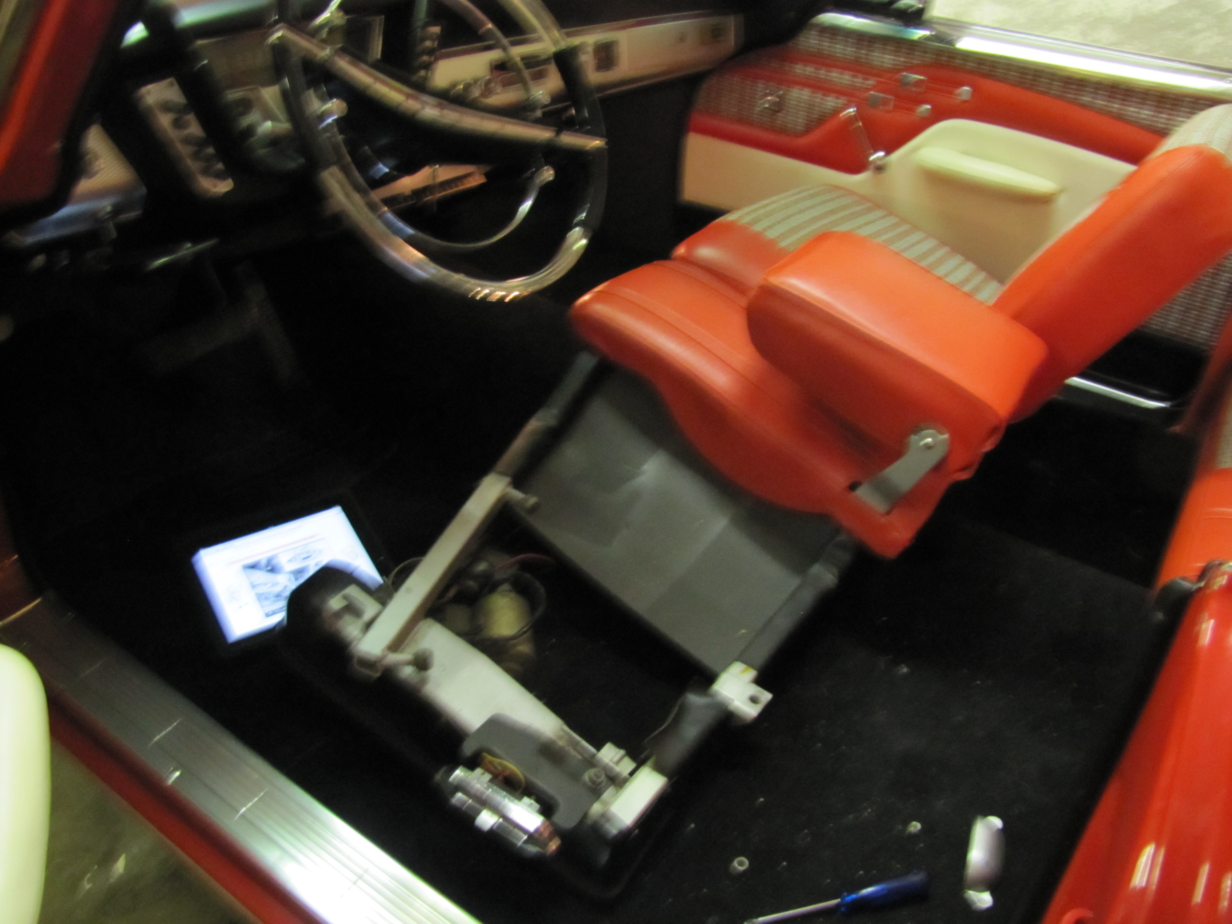

Of course it’s really hard to operate a power seat :laughing:
She finally figured it out a little bit

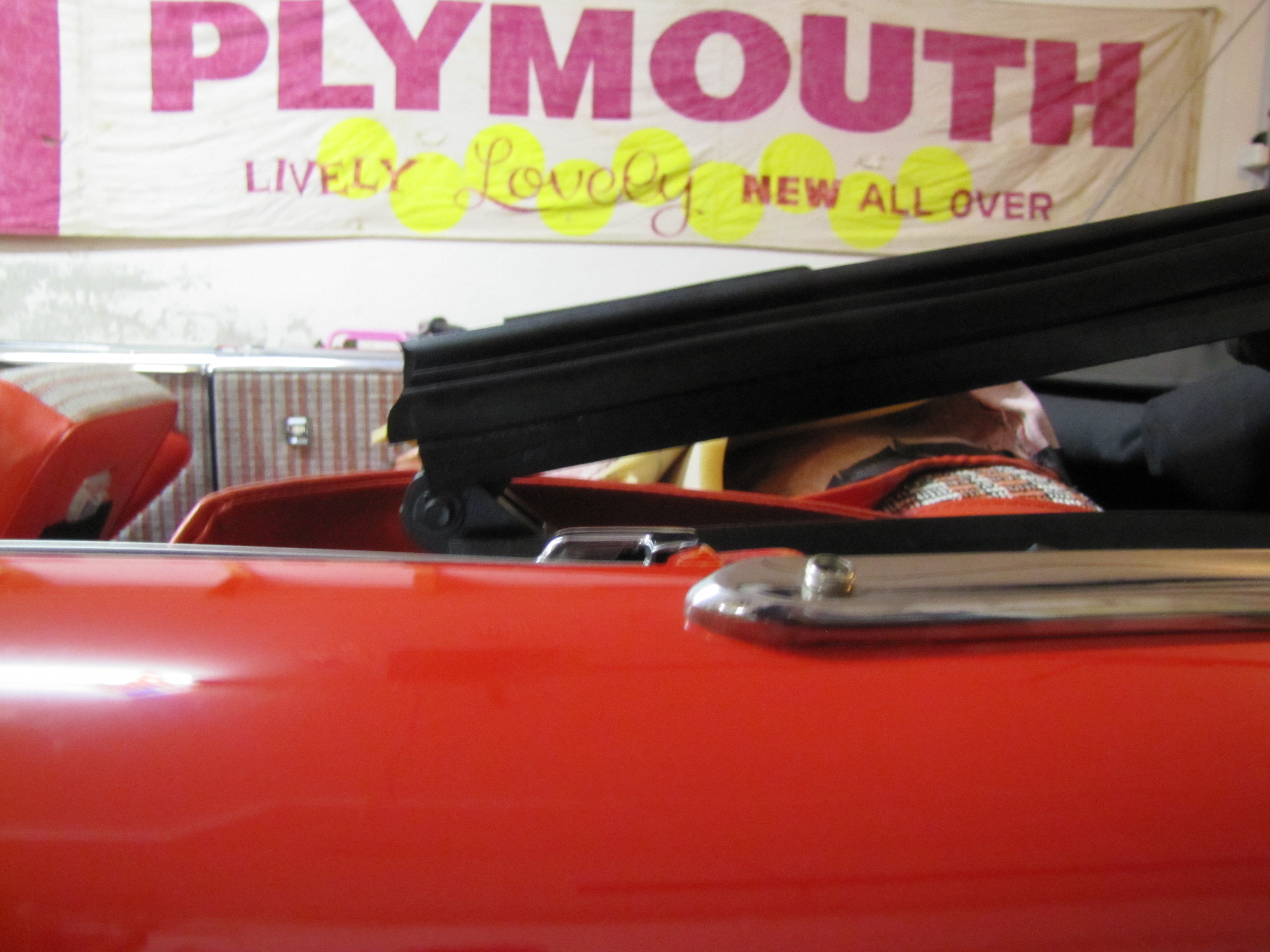

Top really sits lower
Working on the power seat

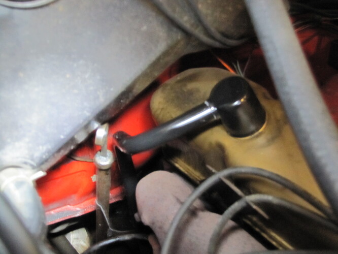

Got the breather tube on

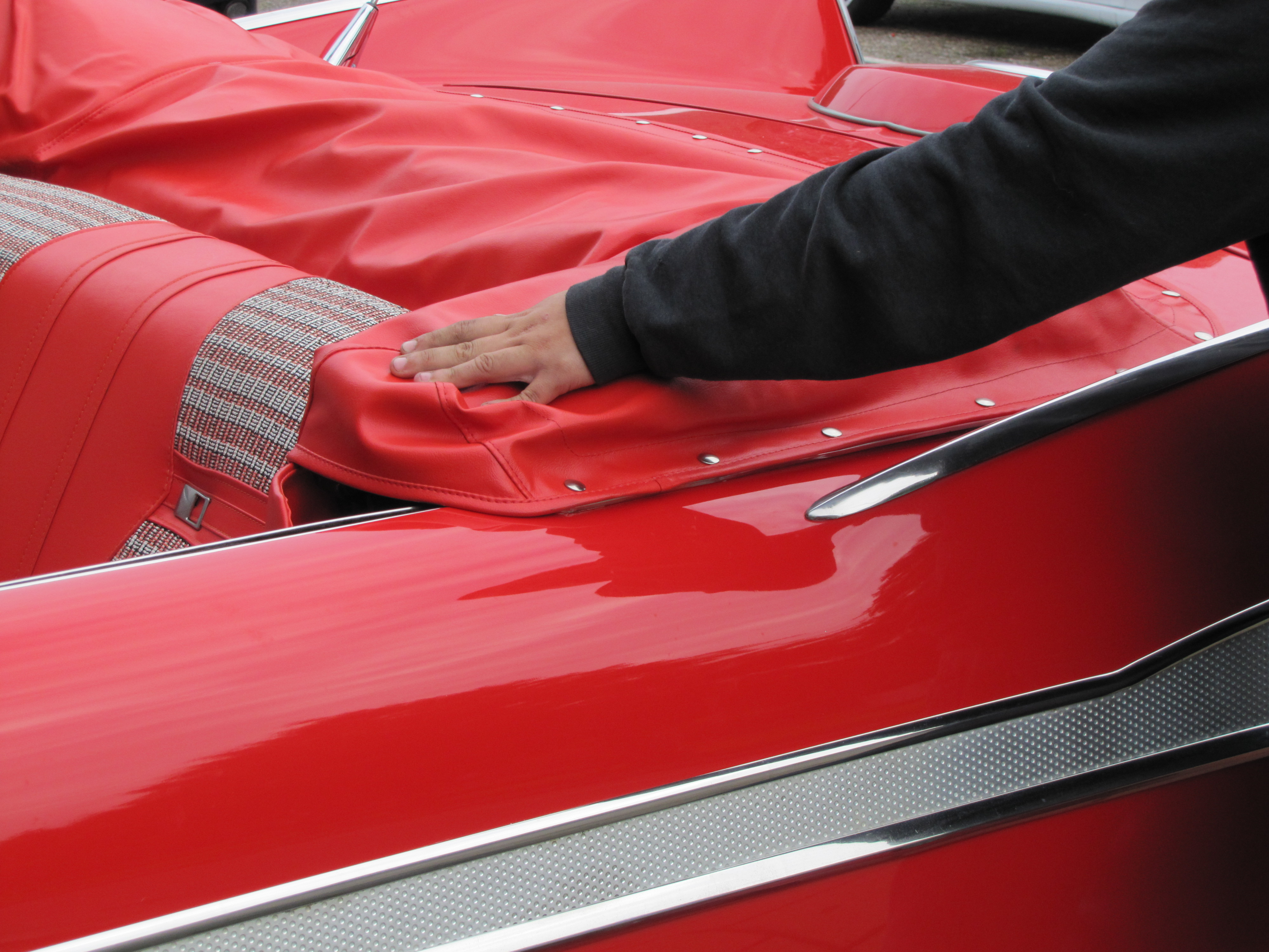

With the top cover on
Folds down pretty good

  2. Yes, the power seat never worked well for me. Glad to see Matthew is fixing it!

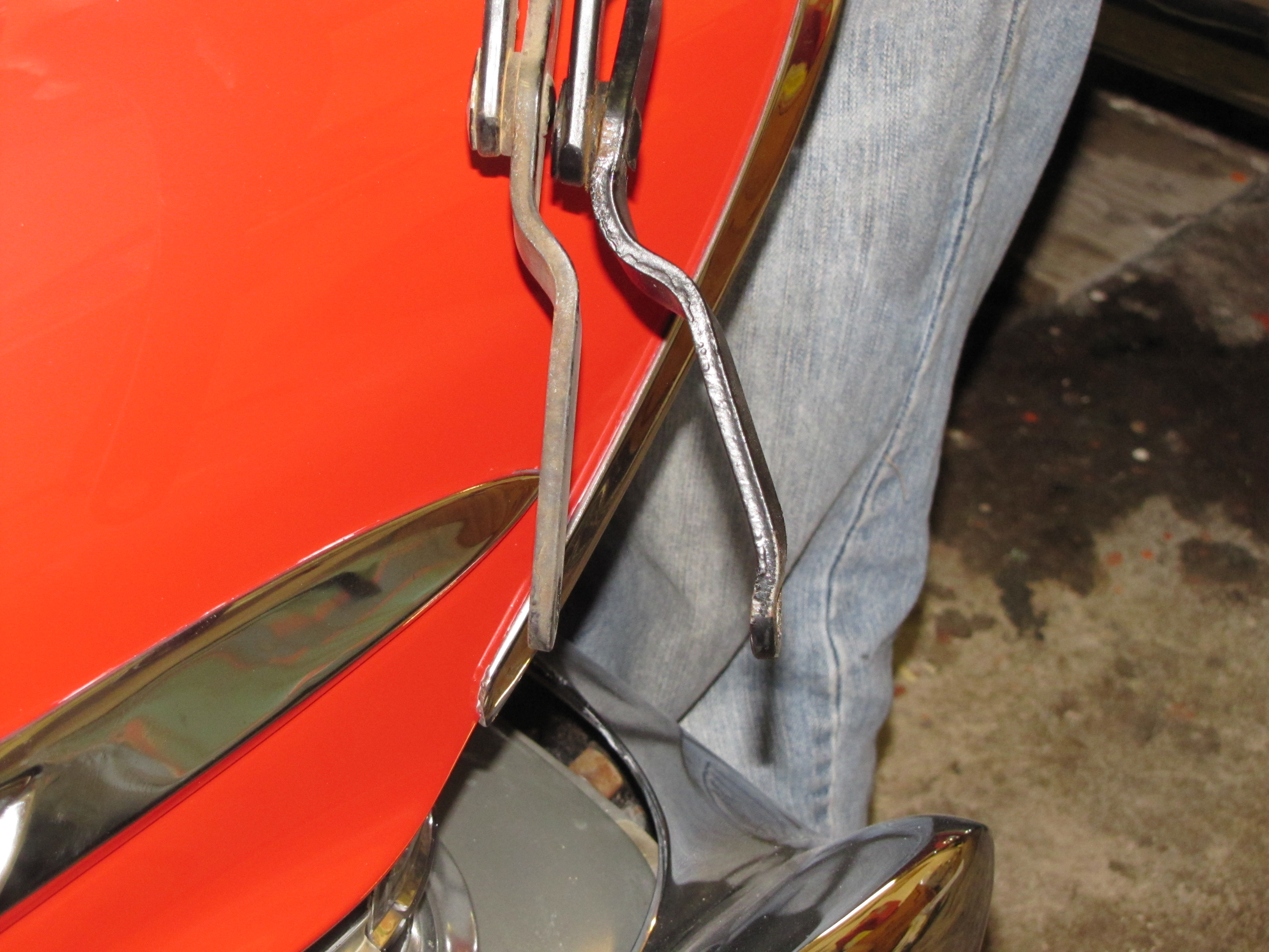

    3)Just one replacement convertible top arm made all that difference in the folded height??? or did you do something more?

  4. Draft tube looks great.

2: took me an hour or 2 but it works. Still have to lube some things and the circuit breaker kicks in every now and then. Motor stays cold so have to figure it out.
3: I replaced both arms. I couldn’t get the cylinders in (put new ones in including motor) and found out that the arms going all the way back were set up different. Passenger side was all the way to the front and drivers side was all the way to the back. Had the adjust them both but it’s perfect now.

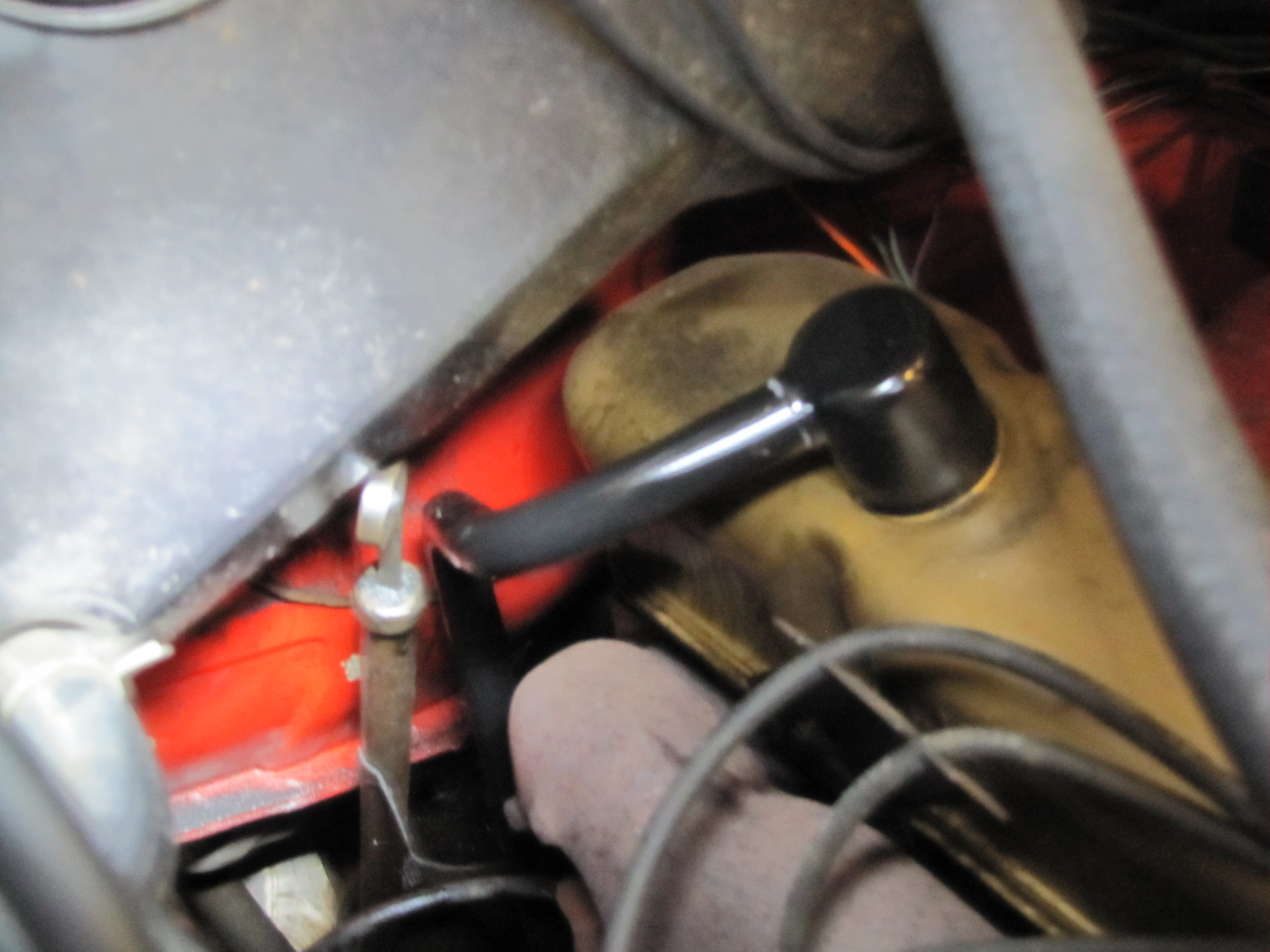

4: me too! I will get to that later. Want to do the power steering pump first.
5: yes! Have to do some touch up on it but it makes a huge difference there. The old lip of the tube was still on the bracket. Who knows what happened with it

The folding top mechanism may have been adjusted by the people fitting the new fabric, but I recall just prior to selling it trying to improve on the folding by messing with the adjustments.
