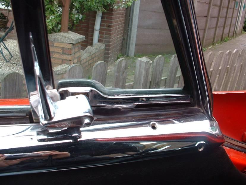

OK Folks, here’s the problem Matthew is talking about:
Matthew writes:
It is that piece with the piece of paper behind it. The thing where you can open the window it attached to it.
That’s the vent wing handle, Matthew. I’ve seen them on eBay from time to time… Anybody have any luck repairing these?
Hmm, I believe the handle is pegged to the pivot shaft (see the small hole with drift pin in the picture). If you could pull it entirely off, then epoxy it back on?
It is not the handle. It is that piece where the handle is attached with. I don’t know how to explain this good cause my english isn’t that good. It’s the piece of chrome that is under that window (not on the door!) Can you get that handle off as well? I believe it could be more to the chrome strip going up so that the window closes better. That piece of paper is there because if we are driving and that paper isn’t there it is like somebody is running next to you with a whistle (spelling?)

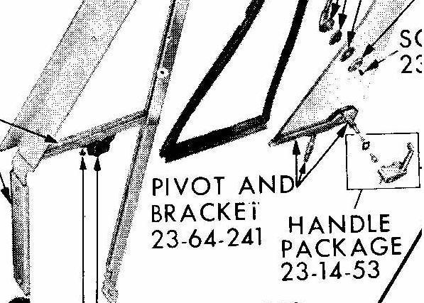

Here’s a pic from the parts manual:
Matthew, if you snag the pic and draw an arrow or circle around the piece you think is the problem, I’ll repost…
It’s the part with the number 23-64-241. That’s the part what is loose. I’ll save the pic on my harddisc. Maybe i need to take the window out to fix it?
Matthew,
The window pivots on an axis that is determined by the post that extends downward and is welded or brazed to that bottom chrome bracket. If the vent window is loose, it sounds like that post is broken, in which case you would have to remove it to repair.
