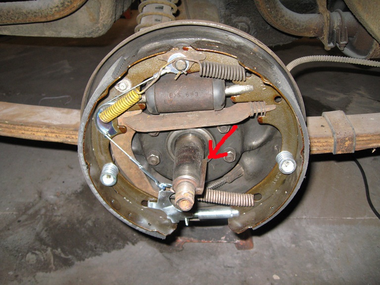

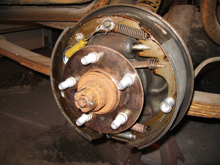

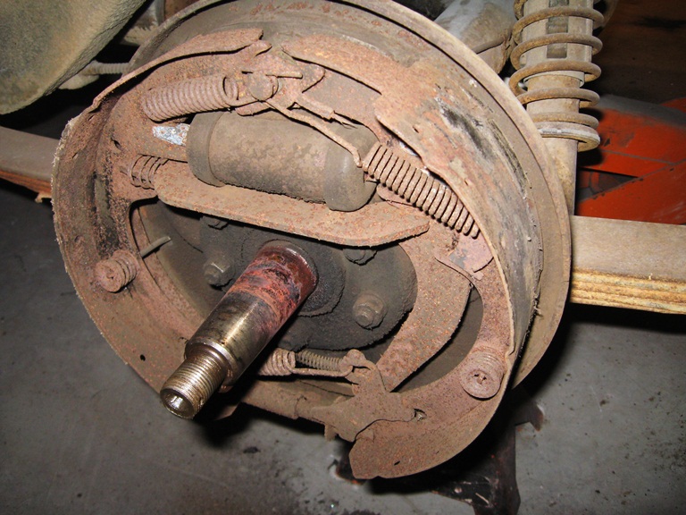

As you can see above there is literally no brake material left on these shoes. The difficulty of removing these units is why people tended NOT to service them as often as they should… and never in some cases. As you can see in the picture below, the hub is “keyed” in position on the axle. Although this is kind of an “old” way of doing things it still works very well. Don’t lose this key…they are very hard to replace. The brakes are pretty much typical for any Mopar 8.75" rear end so there will be no surprises there.

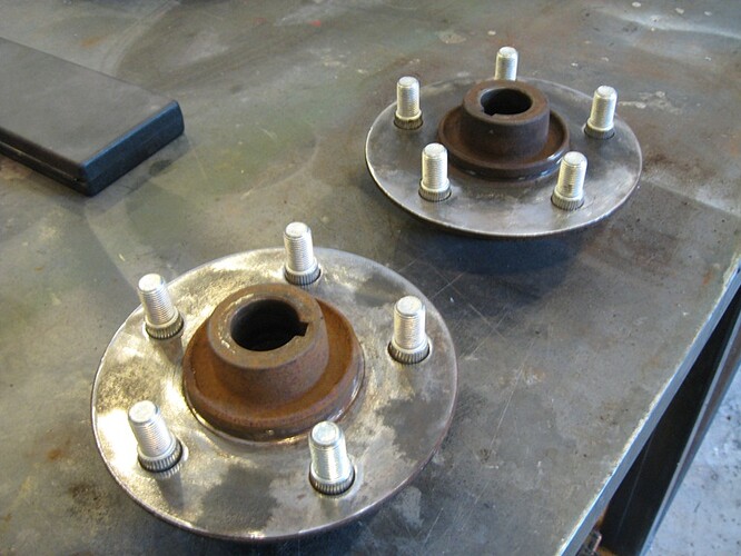

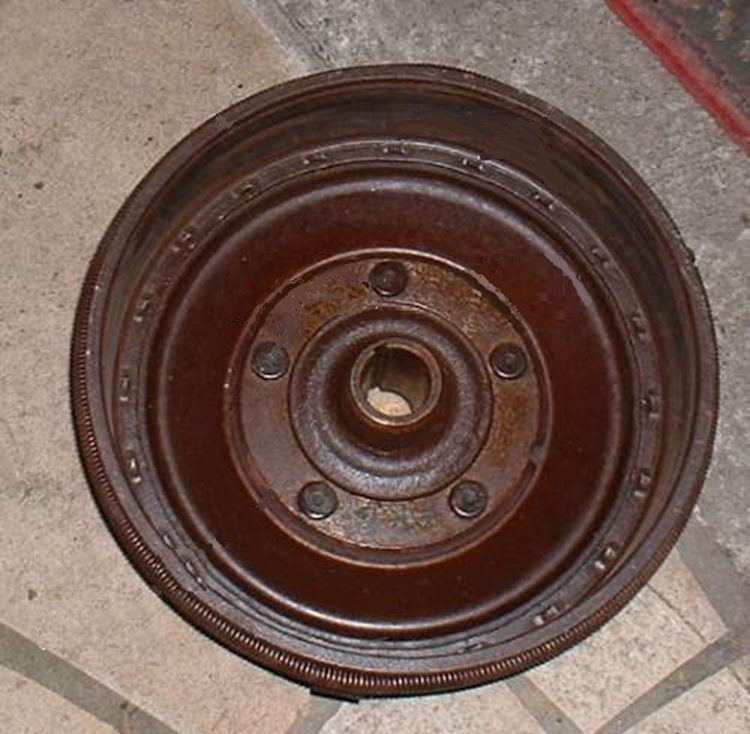

On to the hubs. When the hub/drum unit is removed it will look like the photo below. This unit is all one piece because the lug bolts are swedged onto the brake drum. This is a procedure where the hub and drum are assembled, then the lug bolts are expanded where they contact the drum. This, for all intents and purposes, rivets them together.

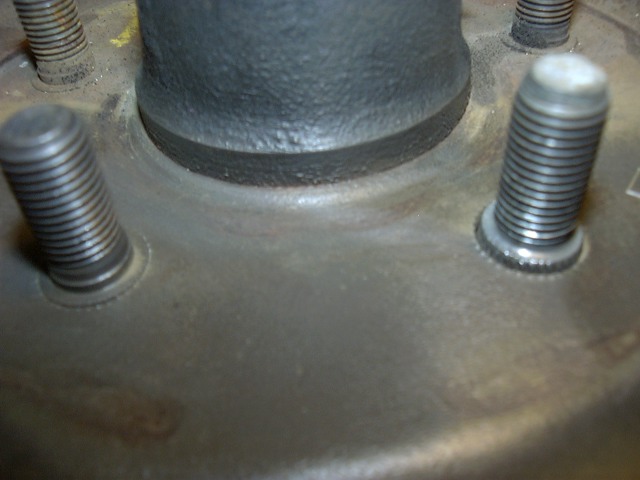

Below is a picture showing what a swedged lug bolt looks like when compared to one that has not been swedged. The lug bolt on the left has been swedged and the one on the right has not. You can see how pressure has been applied and the lug bolt has been “riveted” to the drum. Certainly not the way to do things if you want to make servicing easy.

First, you need to cut the stud off flush with the outside of the drum. You can use a cut-off wheel for this or a hack saw; just make sure you have them flush with the drum surface. Then, center punch each one and drill a 3/16" - 1/4" hole in the center of each stud about a quarter inch deep. This will relieve the stress and allow the swedged area to curl in on itself when the stud is pressed out of the hub. You need to do this for all five studs. Then from this point, it is a simple procedure to press out the studs. With this done you now have the hubs and drums separated. Remember this procedure will basically ruin your drums so don’t use it unless you plan to replace them.
Here’s where the fun begins. You now need to press in new studs. The stock lug bolts on these old Mopars are 1/2-20 UNF thread with a 0.622" knurl. The knurl is the ridged part of the stud that fits into the hub. In order to have a good tight press fit you need to make sure whatever stud you use has a knurl size of at least 0.622", but it can’t be too large either. If it’s too large, it will be difficult to press in and you stand a chance of damaging the hub. NAPA has studs that have a 0.623" knurl (part number BK 641-1128) and these work very well. Below is a picture of the hubs with these non-swedged studs installed.

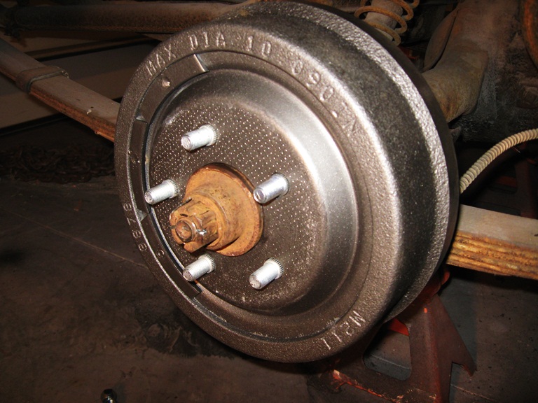

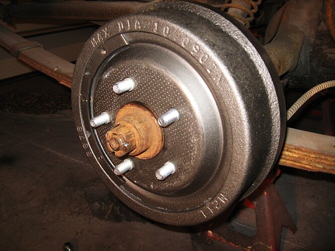

Now for the best part. NAPA lists the rear brake drum for a tapered axle car (in this case a 1964 Dodge), part number ND 4401056 for $92 each. You no longer have to use these expensive drums. You can now use the 1965 and later drums, part # ND 4401129 for $37 each. All that’s left to do at this point is to adjust the brakes and slide the new drums on. If you ever need to do brake service again, just slide them off… it’s that easy.
