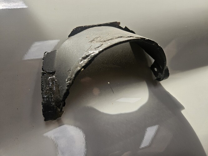

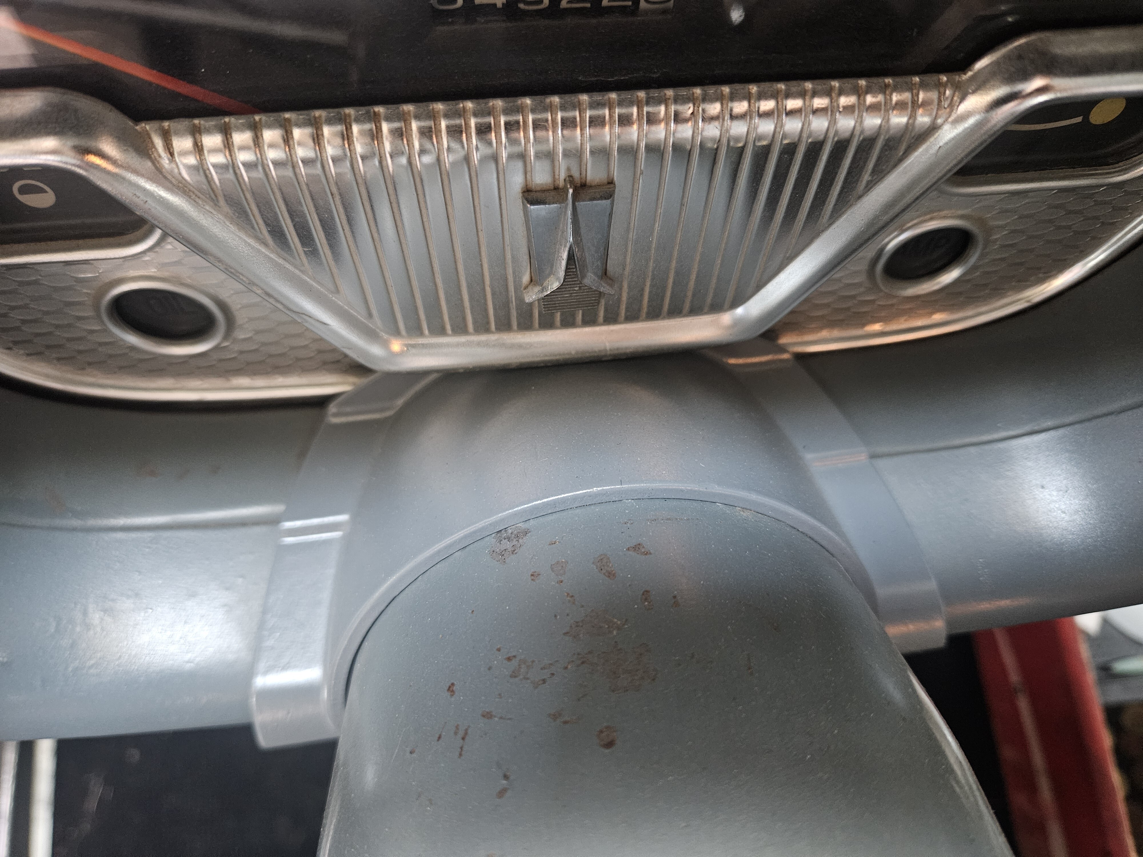

Hi, the plastic part between the instrument panel and the steering column was on really poor shape so I build it up in 3d and had it 3d printed. Fitting is really good now. Let me know if I should send you the stl file for 3d printing.
Old plastic part
New 3d printed part

Printed, looks great, fits perfectly.

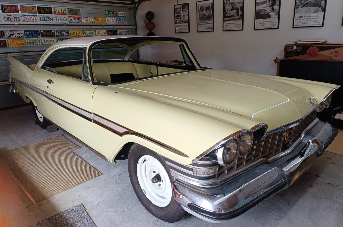

Here’s my car. My window seal was completely worn out. I bought one, original good condition gasket from another car. I’ll be reinstalling the windshield soon.

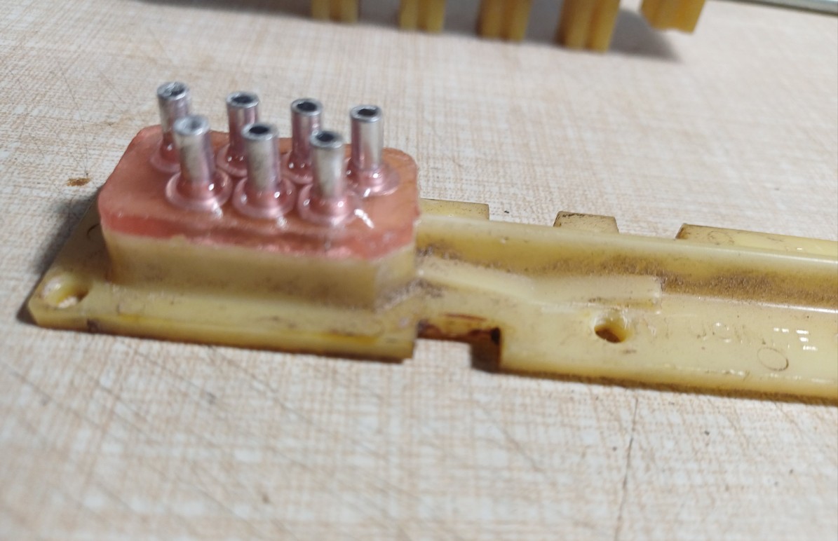

Now I’m trying to rebuild the heater control unit. All the vacuum ports were broken off. I used rivets and epoxy to build a new connector.
Beautiful Fury, @Robert_Chrysli! Where do you live?
…and a very creative repair job on the heater vacuum unit!
Thanks! I live in Poland, Europe
