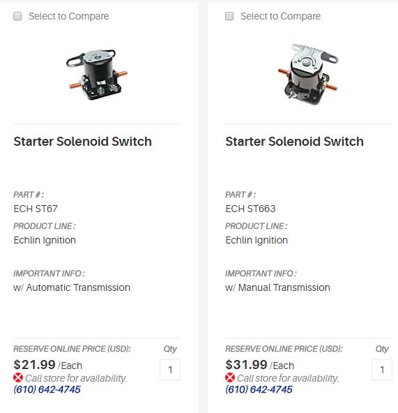

Here are the part numbers from the Parts Manual found here, Leonard. Do you have a manual or automatic transmission?
In any event, it looks like NAPA has the part:
My car is automatic[ powerflite ] tried the st67 did’nt work,maybe it was defective. Does the neutral safety switch go to the small terminal,that is the way it was when i got the car.

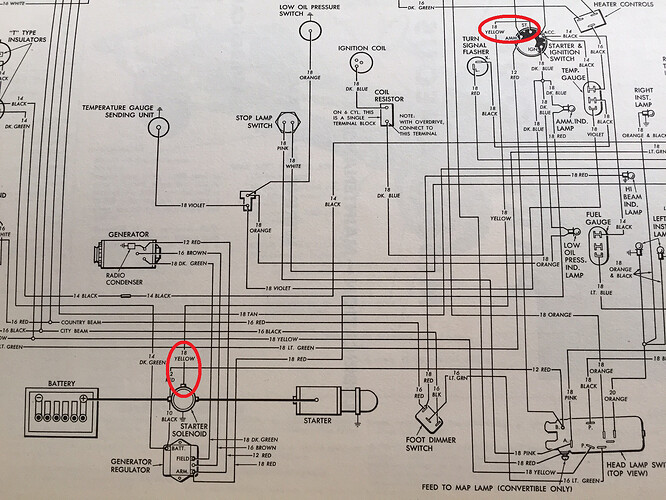

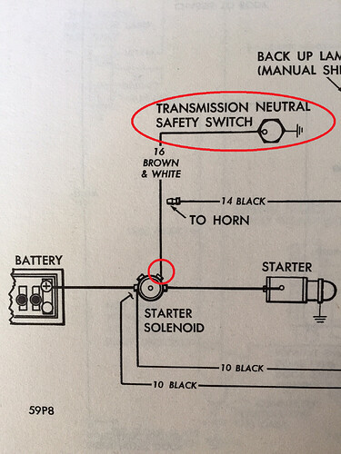

OK. I put my Electrical Engineer hat on, and reviewed the wiring diagrams. Sorry for the confusion, Leonard. Here’s what’s going on.
This picture shows the solenoid with a safety switch (for automatics). For standard shift, there’s only one small terminal, because the other terminal is grounded internally in the solenoid. No safety switch.
The picture above doesn’t indicate what’s on the other small terminal. It’s the ignition switch, shown here:
So, one of these things is wrong:
  1. You’ve got a bad solenoid. You’ve replaced it, but it’s still not working. Can’t rule out that the new one’s bad - but first, some differential diagnosis.
  2. You’ve got a bad ignition switch. It could be failing to deliver 12 v to the solenoid when you turn it to the start position. Hang a light bulb or voltmeter on that terminal (where you can see it) and see what happens when you turn it. If the bulb lights up, your ignition switch is good.
  3. You’ve got a bad safety switch. Even in neutral, it’s failing to close. You can test this by grounding that terminal, and turning the ignition switch (make sure you’re in neutral!). If your solenoid is good, the starter should turn.
  4. Oh yeah! Can’t rule out that you’ve got a dead spot on your starter commutator. To rule this out, take your light bulb or voltmeter and hang it on the large terminal that goes to the starter. If it lights up or swings, you’ve got starter problems.
And, like that. Let us know how you make out.
