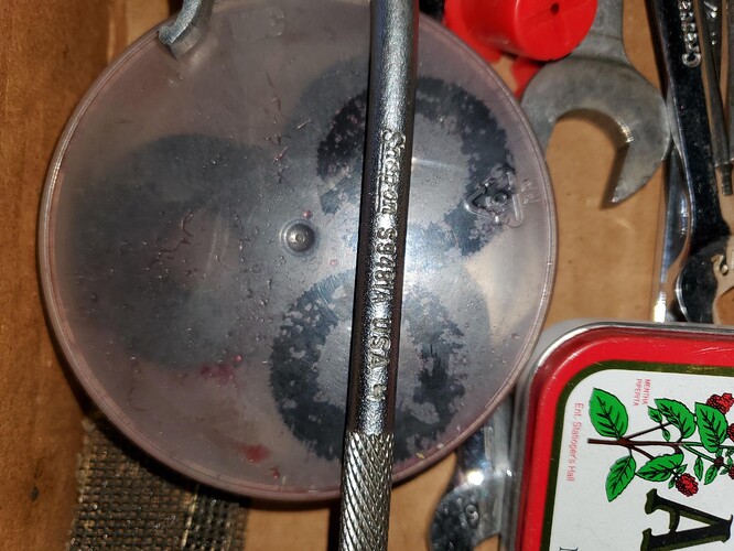

I guess I should give the tool number… Snap On S9481A Used this Thursday before last to pull drip rail molding off an old Dodge Dart. don’t forget paint stick or old clothes pin for back-up.
hate to be a whiny baby but the number doesnt come up on snapon website. Tried every combination of 8,4,1, nothing. Looks likeB8487A but that doesnt come up either, Even got out magnifying glass. Any chance it has been discontinued??
They were discontinued about 35 to 40 years ago. I see them on ebay, craigs list I have used them on 59 Plymouths, Vans, motorhomes, cab over Dodge and Hino trucks. even on old tip toe matic and Gyro torque emergency brakes… Rick Postscript there are 16 on ebay now. make lower offer.

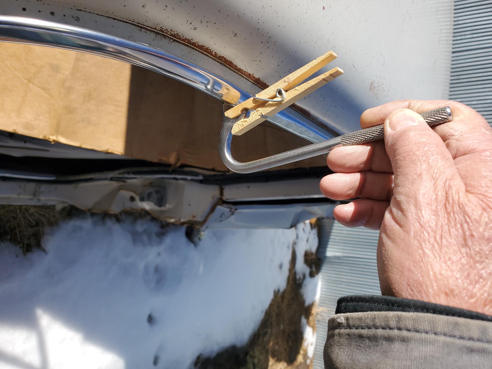

Tool in action, curved parts require addition of paint stirring stick for extra trim protection.
So cool. So that’s how it’s done! :smiley:
