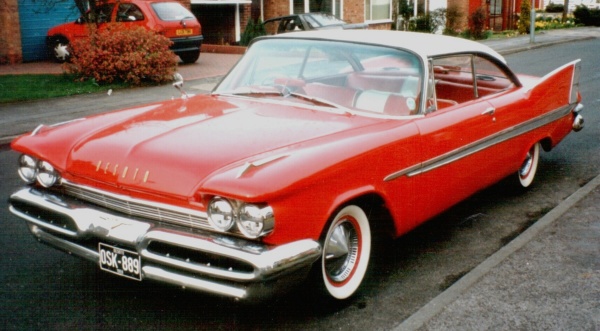

Hi Stefan, heres pic of desoto the lads over here all say different things, and to get a worm made up new its going to cost around £600. cheers Doug
sorry Stefan, early morning here I thought you meant a pic of car I haven’t taken the worm out yet, the show season has just finished I didn’t want to take it apart if I couldn’t get another one. Doug.

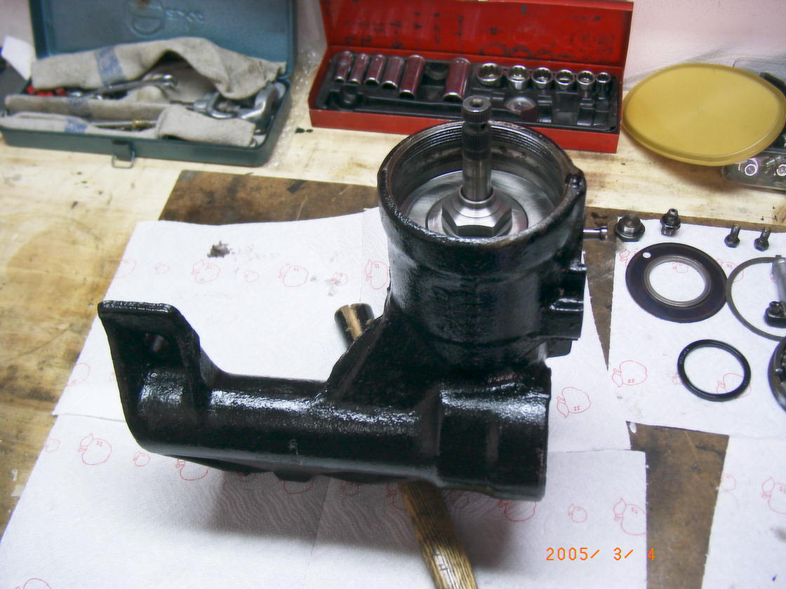

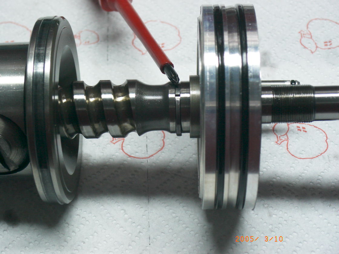

Dough,
Here are two pictures for you. One from the housing, that might be different to the one you have. The other one is of the worm. What makes you think you need a new worm shaft?

Hi Stefan, Thanks for the pics, I will take photo’s tomorrow (thurs) and post them, showing steering box outer casing. I think I need the worm because I don’t know if its the same as yours, but mine has a nut with grub screw in the middle of it and this is wound right in.
When I was restoring it the chap in the garage who done the brake system said it needed a new box and there is a least 6 inches of play on the steering wheel back and forth without the wheels moving, it drives like that other famous chrysler The Sherman Tank.
