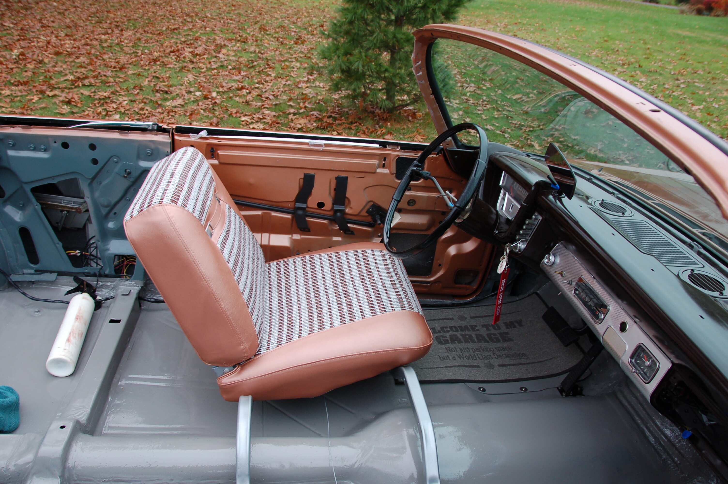

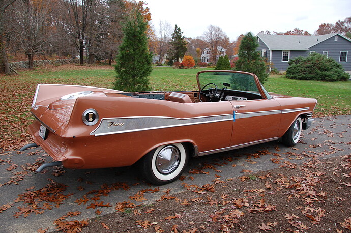

With the Dash , wiring and all systems completed , I rolled my S Fury out for a test ride which was big success ,no major issues.
I forgot how much fun they are to drive and the kick you get in passing gear.
Now to finish the interior and Top over the winter.

Mark - What a beauty, I didn’t know you were building a SF Convertible. Wish mine was that far along. Magnificent work. Hope you finish it during the winter.
The copper color fits very well with the autumn leaves seen in the backround.
I remember what you mean by that boost of power when it kicks down!
Keep protected from Hurricane Sandy, and keep up the fine work.

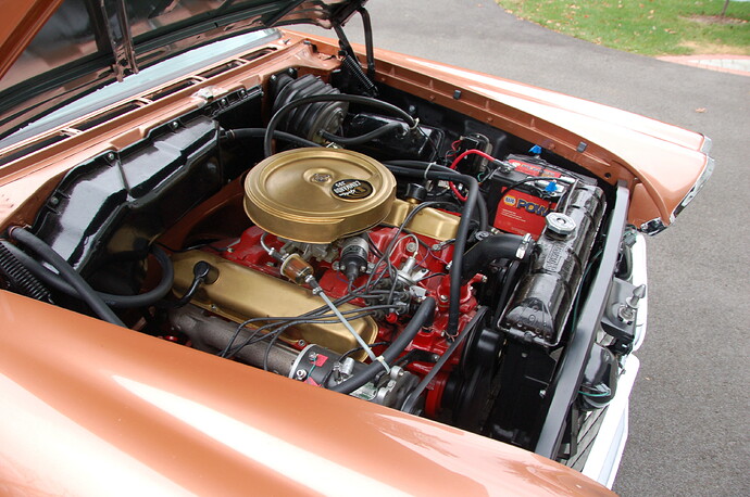

(Looks like you painted the under-hood black, rather than the more traditional grey?)
Looks great Mark, Glad you were able to take the spin in it before Hurricane Sandy hits with its rain bands.
The engine compartment looks great! We will pass the hat around the forum to raise funds for the passenger seats and interior seats and panels! :astonished: :laughing:
Glad you carry that fire extinguisher with you after my mishap…

The Hood and all the interior panels are the Green/Gray primer, must be the reflection.

Mark - Is SMS doing your door panels, If so do they do the metal arm rest/cylinder cover also. Hey John Q. what about a collection for me???
SMS is doing the side panels but not the arm rests or covers, My local Uph has completed them with SMS material.
Lead time is an issue with SMS but what can you do. My upholster did the rear arm rest too with the material from SMS, they put the padding on the side area and the arm rest of rear pocket panels. The door panels did come back super nice but wished it was quicker. I did have my local upholster make up some door panels too, that turned out well also. So I have a back up set for my convert.
On the front door arm rests, I had extra white bolster material from my seats and had another local upholster, who did my sun visors (out of the same material too!) do my arm rests, I painted the plastic bases and he did the stretching of the material over the old padding material. He did build up some of the low areas on the front armrests where over time it was squished down. But it turned out well…

Mark, what size and mfg did you get your tires from? They look great!

The Tires are Coker Classics P215/75R14 , I bought the Rims and tires as a package good to just be mounted from Coker
My rims are Black because that is how the came.

Mark - The rims are the same color as the Valance and Splashpan. SILVER ARGENT.

Wheel color depends upon whether full wheel covers or just hubcaps came on the car. With full wheel covers, standard on Sport Fury, wheels were painted Argent on the outside, and Black on the inside. That can be seen on the “Two Mile Tryout” video that many folks have, when they discussed Safety Rim wheels (first used in 1941.) With smaller hubcaps, some body colors had matching wheel colors, but not all. Certain colors, like black, also got Argent wheels. Probably all were black or gray on inside, but if anyone has a body-colored original 59 wheel that isn’t rusted beyond recognition, please let us know. I’m going by what I’ve read and seen in old photos, movies, etc. to identify. So the factory choice was Argent or body color, if you want to be original. I agree that black looks better as an open-face wheel, especially with a wide whitewall tire, a very common look in the 50’s and 60’s. That’s how mine was when I got it - black wheels, and the wheelcovers were in the trunk.
