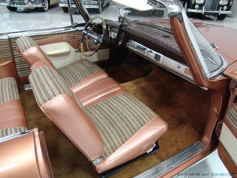

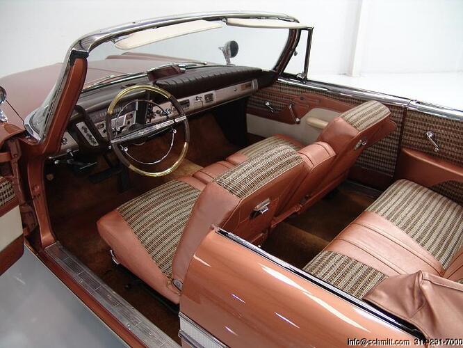

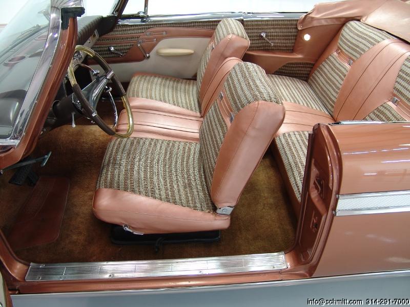

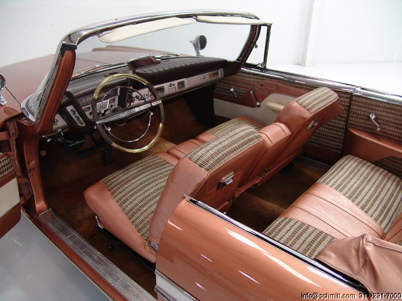

The front seats would be the same as any SF hard top guys would have so hopefully they will chime in. The rear convertible dimensions I have some pictures of but it is of a restorations but might give you a better idea of look.
Pictures I got off the Internet of a SF Convert for sale.

Is that floor color carpet on the Ft seat backs? If so, same color as the floor I assume.Is this Orig

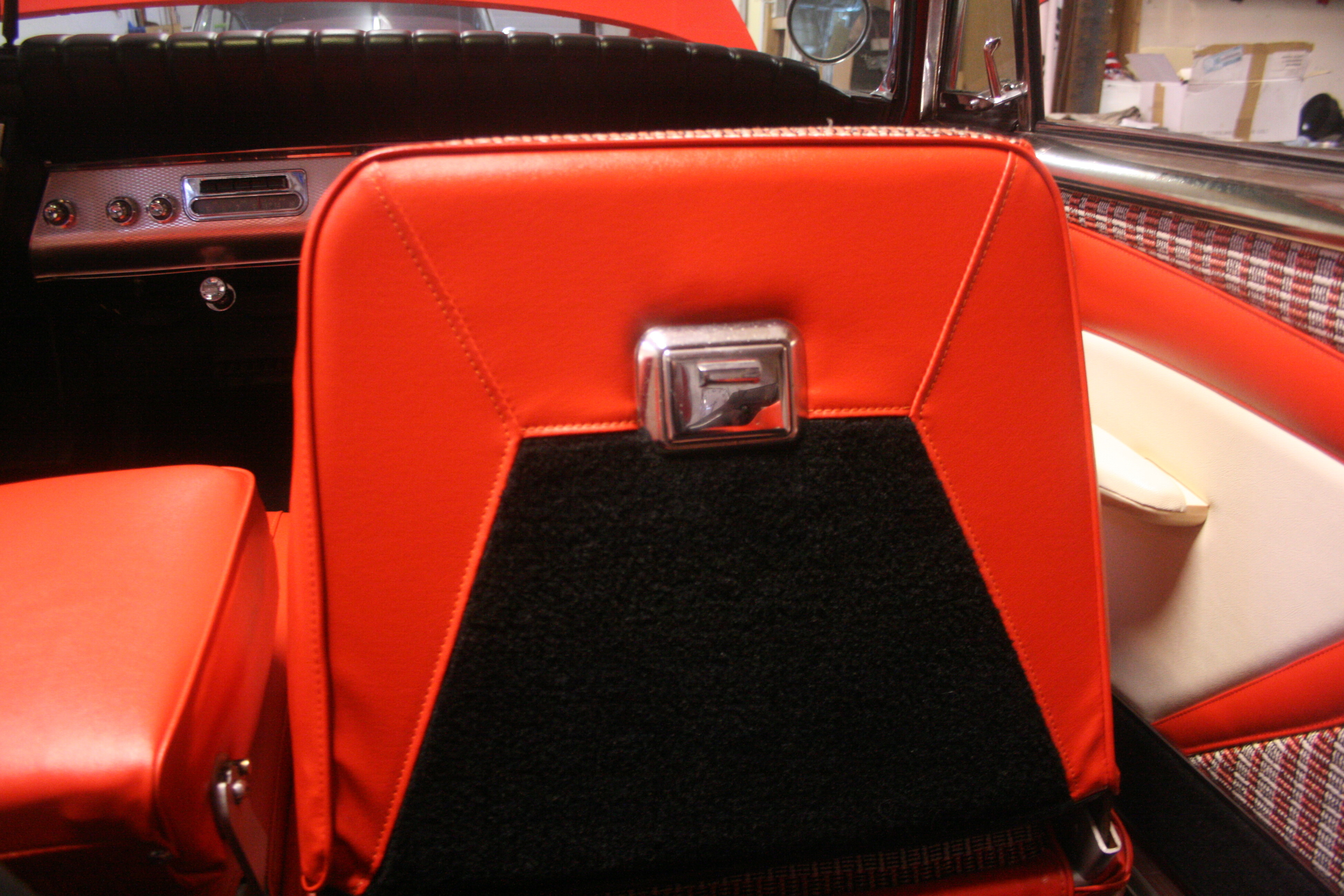

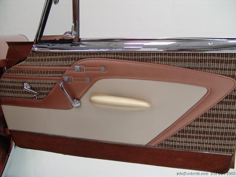

I don’t remember carpeting on the swivel seat backs? There IS carpeting on the lower portion of the doors.

Roger, if you look at Wil Eichelberg"s SF webpage, you"ll be reminded that there is carpet on the seat backs. The carpet is the same as the floor and bottom of the doors. You might also look at his very original 318 with silver/gray valve covers.

I did not supply the upholsterer with carpeting for the seatbacks or doorpanels, so obviously he used some black remnants he had in the shop. I don’t recall where I got the carpet kit..it wasn’t that great. I remember asking Tom if it should be loop-pile or short nap (or something like that), but I don’t recall what the answer was.

Here is a pic of the seat back.

The seat shot is helpful
