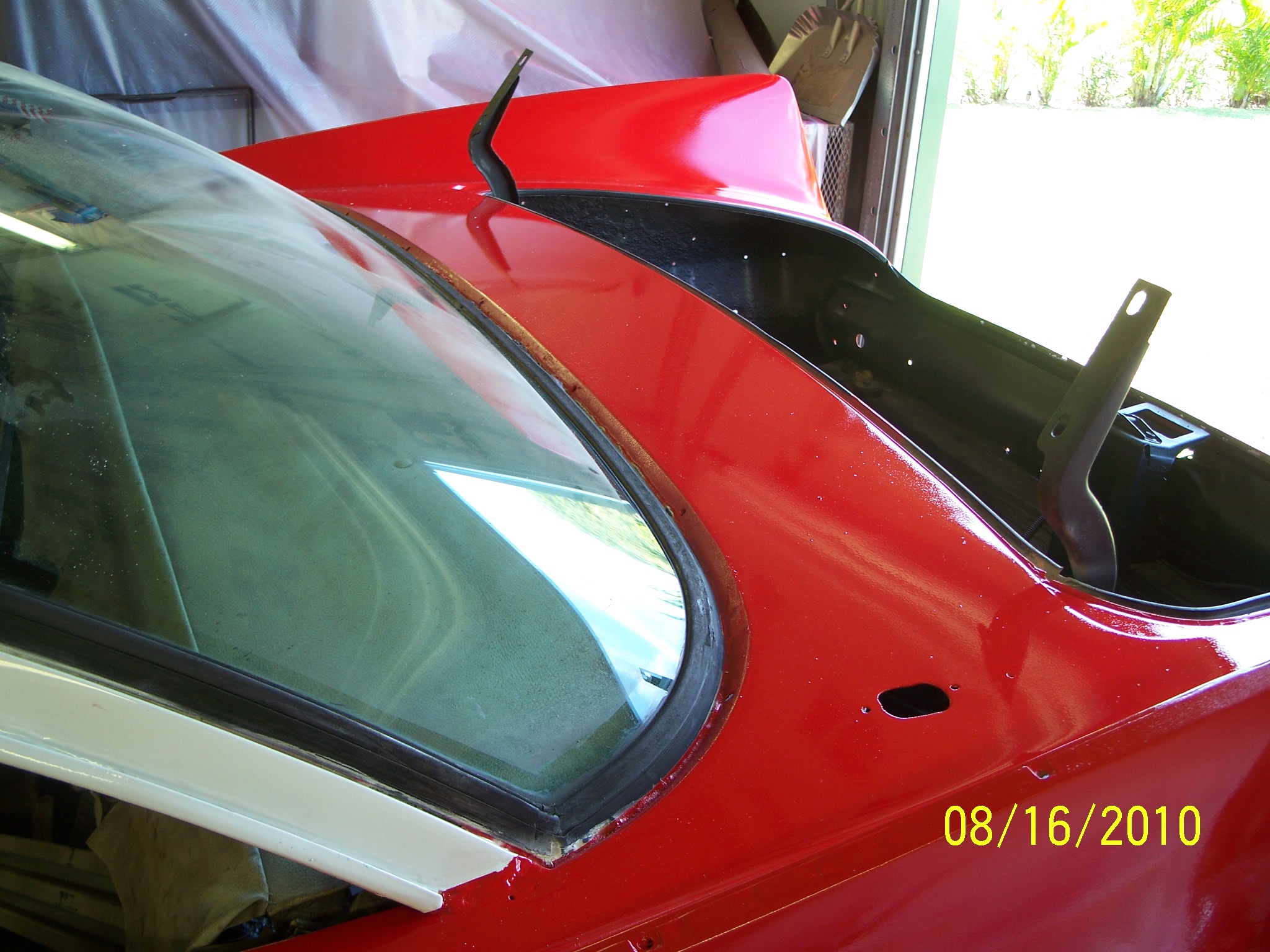

At the bottom of the rear backlight/windshield is a V groove channel with holes that the bottom moulding clips go thru with a washer nut on the bottom side. How do you seal those holes from water leakage into the trunk. The previous owner had filled the groove with clear sealer and then glued the molding down. I have all the correct clips to do it correctly and assume there is some sort of rubber washer backed by a metal washer on the bottom side but how or is it necessary to seal the top side, i.e. in the channel. I would also assume the front bottom windshield moulding holes are sealed the same way. Any and all suggestions or proper procedures are welcome.
