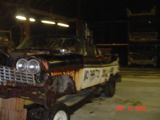

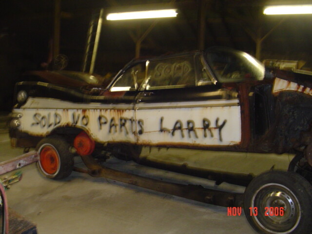

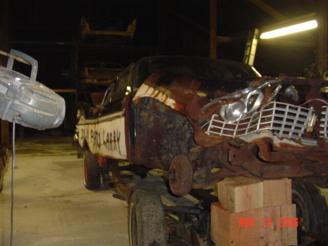

Well, I finally got the convertible dropped off that I bought last summer. Believe it or not, it is in slightly better shape than I expected. This will be used in conjunction with a good solid hardtop body that I have already. —John
Uh, um, thanks, yeah, I guess, for those, um , photos…did you use a Funhouse Mirror to photograph the car? Seriously, I cannot make out anything…was that your intent? I am Truly interested in your project.
Actually, Roger, the poor photos were not done purposely. We were having wind gusts of over 40 MPH that evening, so there was a lot of dust and some mist blowing through the barn. And yes, the right front of the car was crashed, bending the grill in that strange way. The rear end and front hubs are locked solid, so in order to get the car under cover, I set it onto a '57 Chrysler chassis I had laying around. I would have brought it in with the forklift, but I just poured the cement, and didn’t want to trust a 40,000 LB lift on the fairly fresh floor. One bonus was that my buddy I got the car from must have stripped out several Furys from '56-'59, as there is a slew of moldings within the car. I will keep you posted of any progress, or as time permits. —John

I can actually see that this car has potential. You mentioned that it did not look all that bad - what does that really mean? For example are all the top bows and header present - without rot?
How are the floors and trunk area?
It sure appears the front right took a good whack!
Will you be using another frame from your supply barn???
Sorry for all the questions - I am just being nosey.
It must feel great to have a convertible in your fleet!
Congratulations,
Curt in Maryland
Thanks, Curt. Being that this will be used as a donor to a 2-door hardtop body, the most important thing was that the rear deck area [in front of the trunklid] was solid. The floors and trunk were totally gone, but it was no concern since they are good in the hardtop. The top side rails were still good, but the cross bows are shot as is the header bow. I have about enough of it left for a pattern to fabricate a new one, and I have other convertible bows that can be modified to match the missing ones. When the time comes, I will probably need some measurements of original bows in order to get the correct width. One question I have is I noticed the VIN plate is affixed to the firewall cowl. Was this just done on cars from an eastern assembly plant? On all the cars I have here, the tag is within the driver’s door jamb. —John
