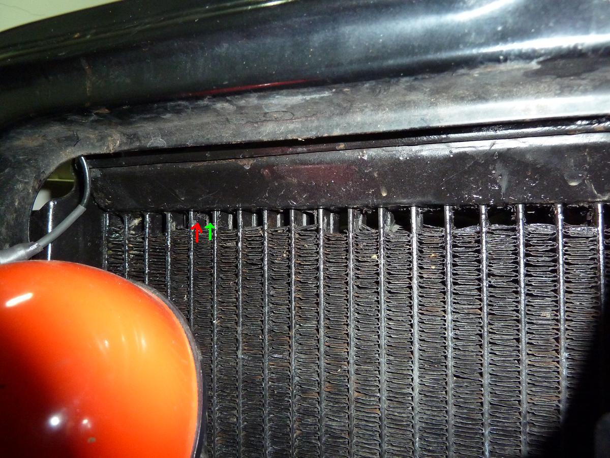

Besides: It’s easy if you want to find out if you have a 2 or 3 row radiator. Just take a flash light, look under your hood and count the rows of the water passages. See the picture. Red = first row, green = second row and if there is another row behind it…., but you probably have only two rows.
